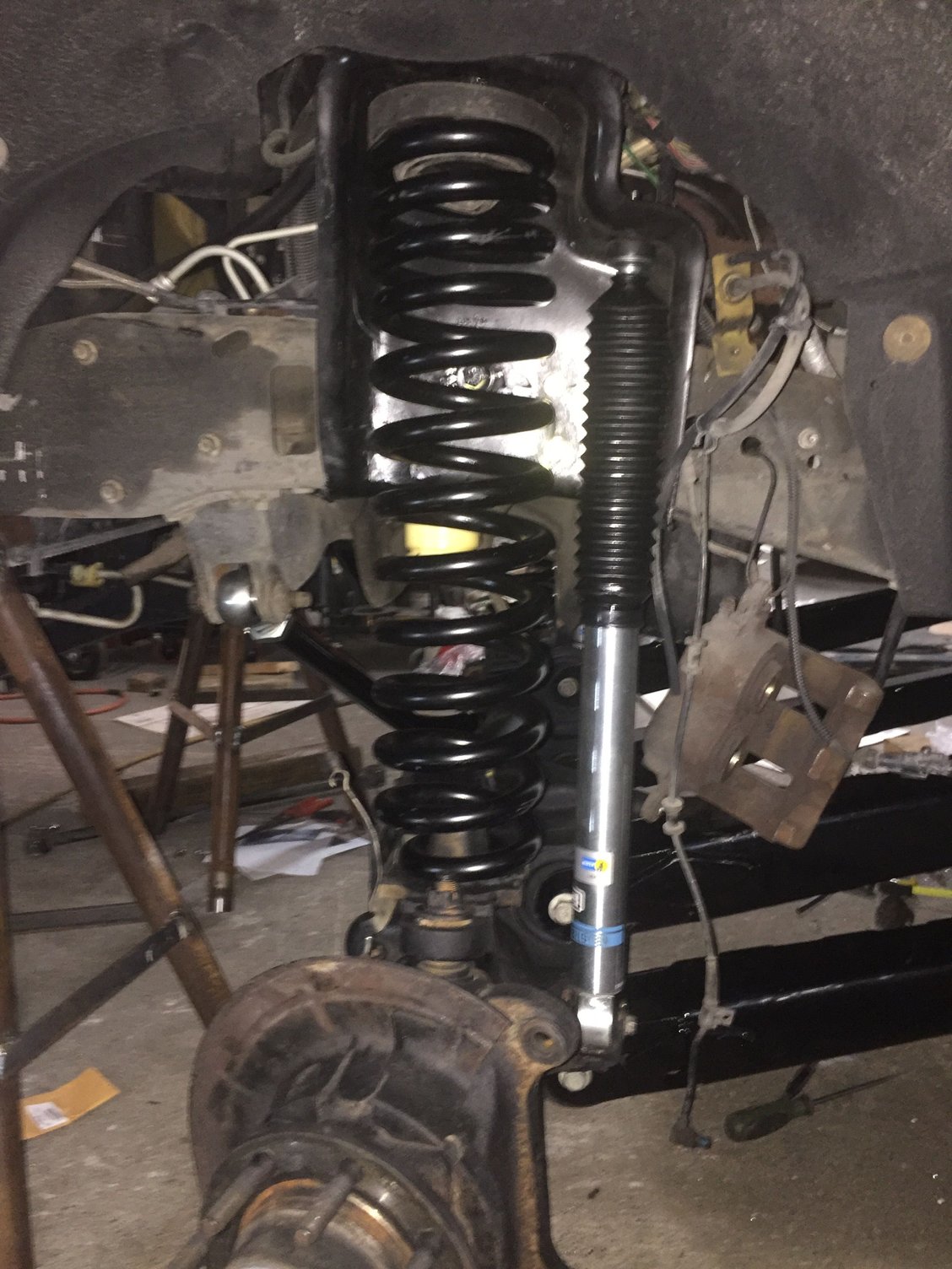

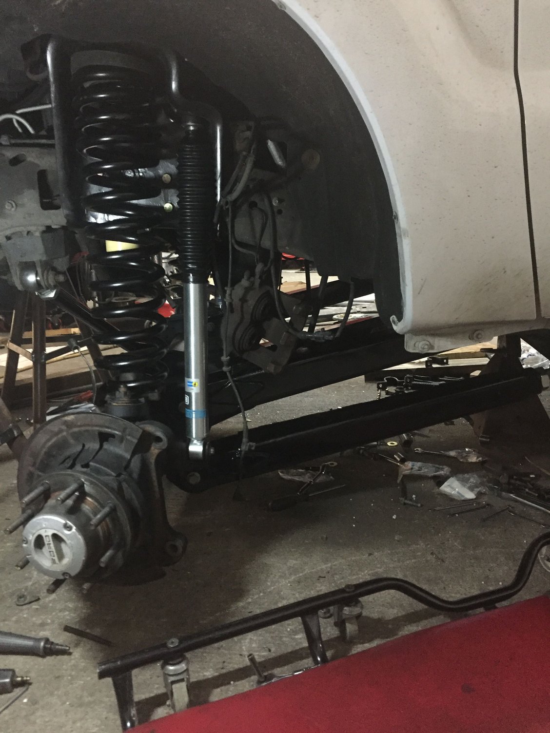

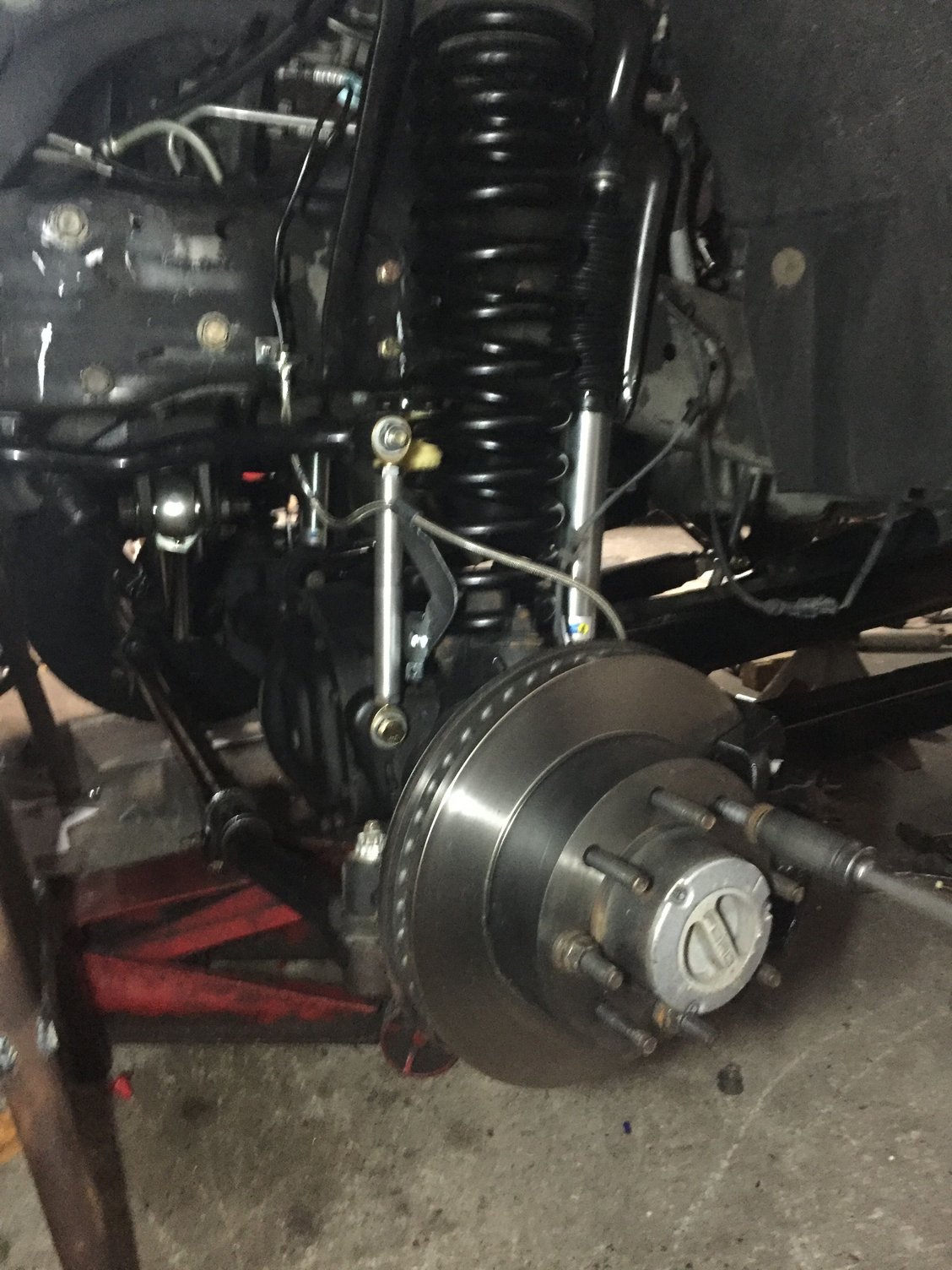

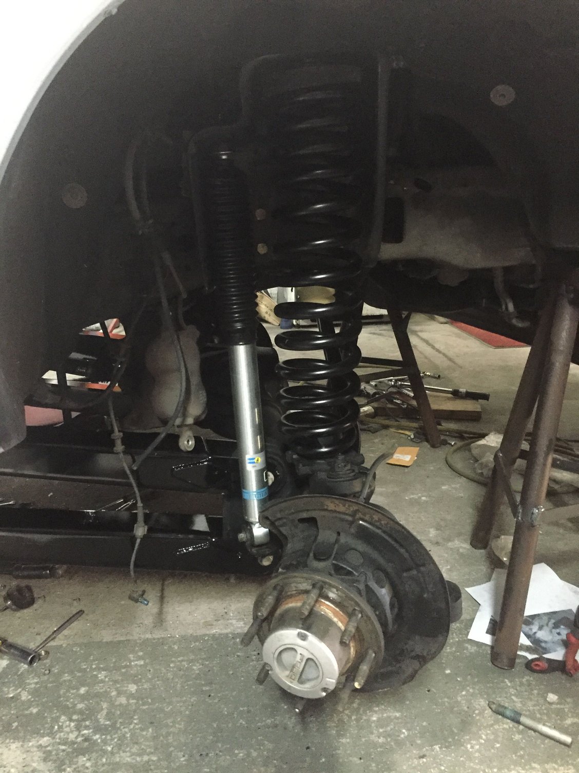

Coming along

Looking good, although the fact that the axle is seemingly left hanging at full droop makes me cringe... It's not the best thing in the world, especially since from what I can tell the shocks and trackbar are what's limiting the travel. At least get a pair of small jackstands underneath the axle tubes

Yeah, snapped some pics before stands were put back in place

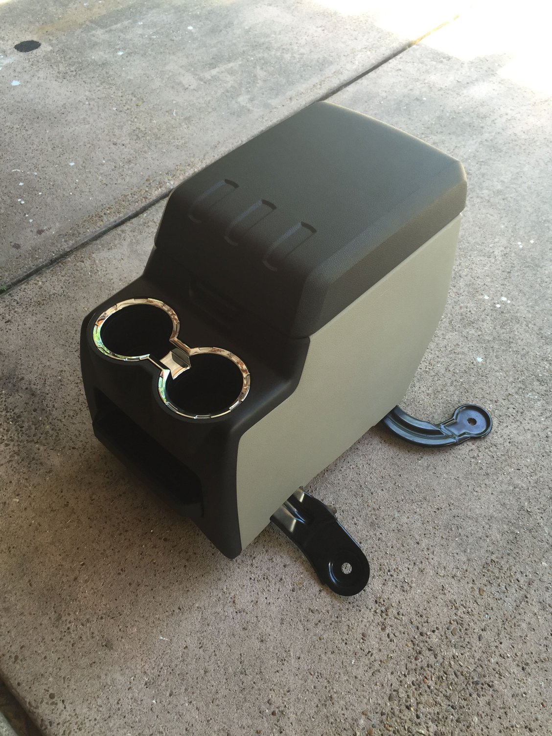

Nice craigslist find today
Jealous. .great find.

Your armrests on your seats will be in the way, you should just sell it to me and save headache. Lol

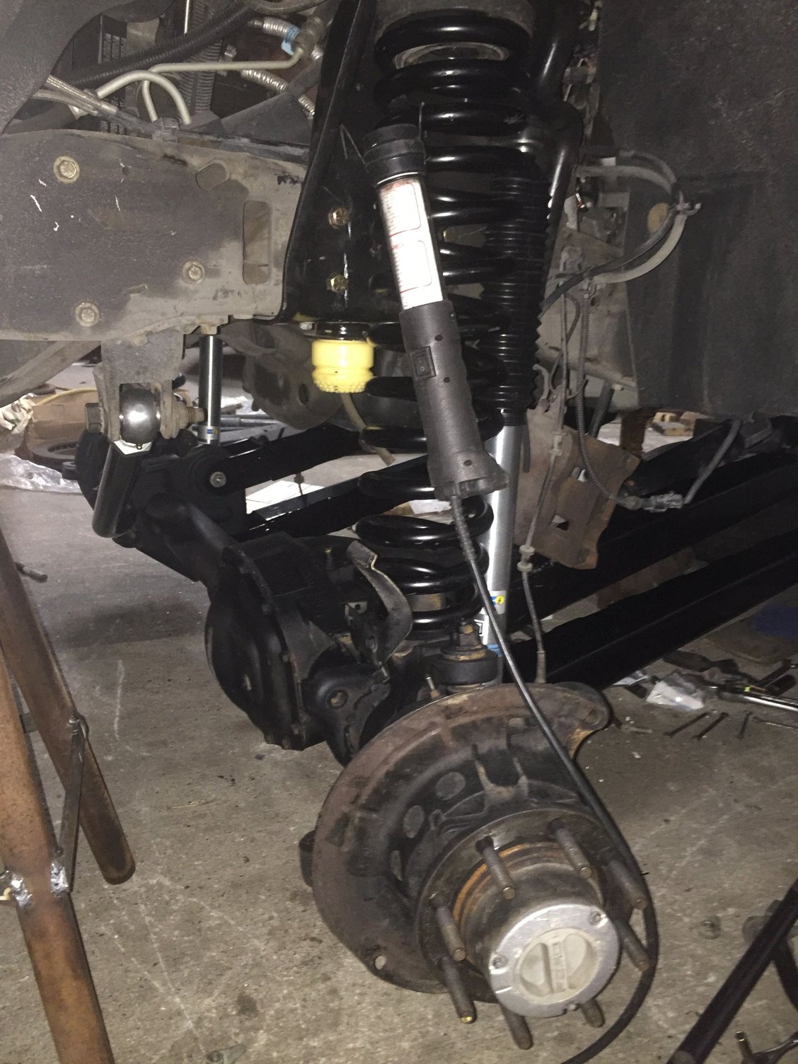

So the donor 2010 steering box done not have the same steering shaft as 05 Excursion.
Did I get wrong box? Am I missing something?

The box/pitman arm changed in 05 on the trucks. The Ex still has the older style to go with the leaf springs.
The 08+ has a new frame so I'm assuming another new box too. Probably be easier to find an 05-07 one as it bolts right in.

Ok, so I'll get an 05-07 Super Duty box. Any recommendations?
Ford or ???

Personally I'd go OEM, others have tried RedHead and been happy. I wasn't, back to stock for me.

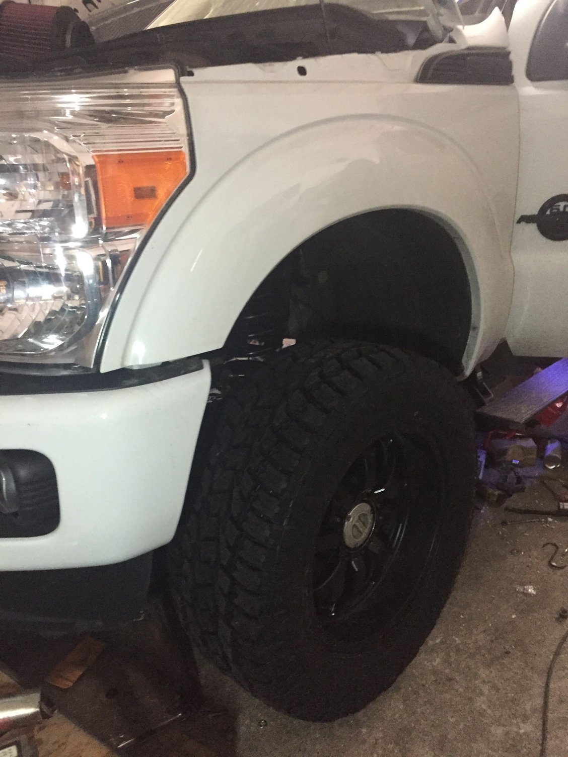

Getting closer to finishing. Picked up some 35 Toyo A/T II today. MBRP 4 inch exhaust and Hellwig Rear Sway Bar.

That looks AMAZING!!!!!! Mucho great job bro!
