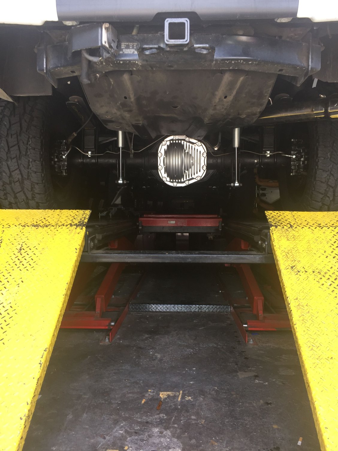

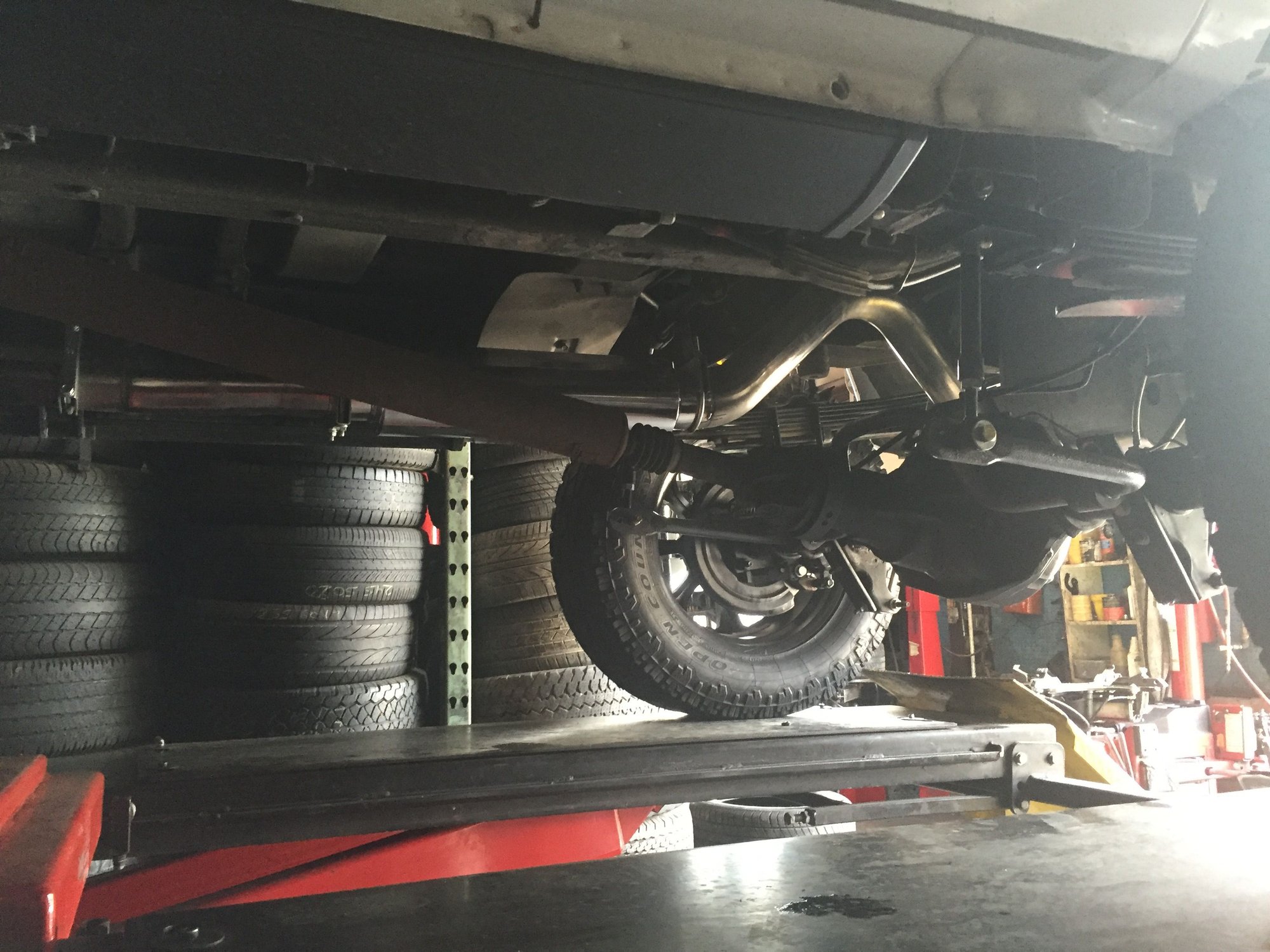

Needing to order rear sway bar from Hellwig, not sure which one I use for 2010 rear axle swap. Stock excursion or 2010 F250?
Old May 20, 2016 | 12:01 PM
  #122
gots_a_sol's Avatar
gots_a_sol
Joined: Nov 2014
Posts: 582
From: Charles Town, WV
What did you do for the rear shock mounts? I re-used my ex's shock mounts and hellwig bar on the 05 axle.
Old May 20, 2016 | 03:19 PM
  #123
5HUB's Avatar
5HUB
Joined: Jan 2016
Posts: 194
From: Houston, TX
Haven't stopped by the shop but the 2010 shock mount was modified. Using the 05 Hellwig sway bar.

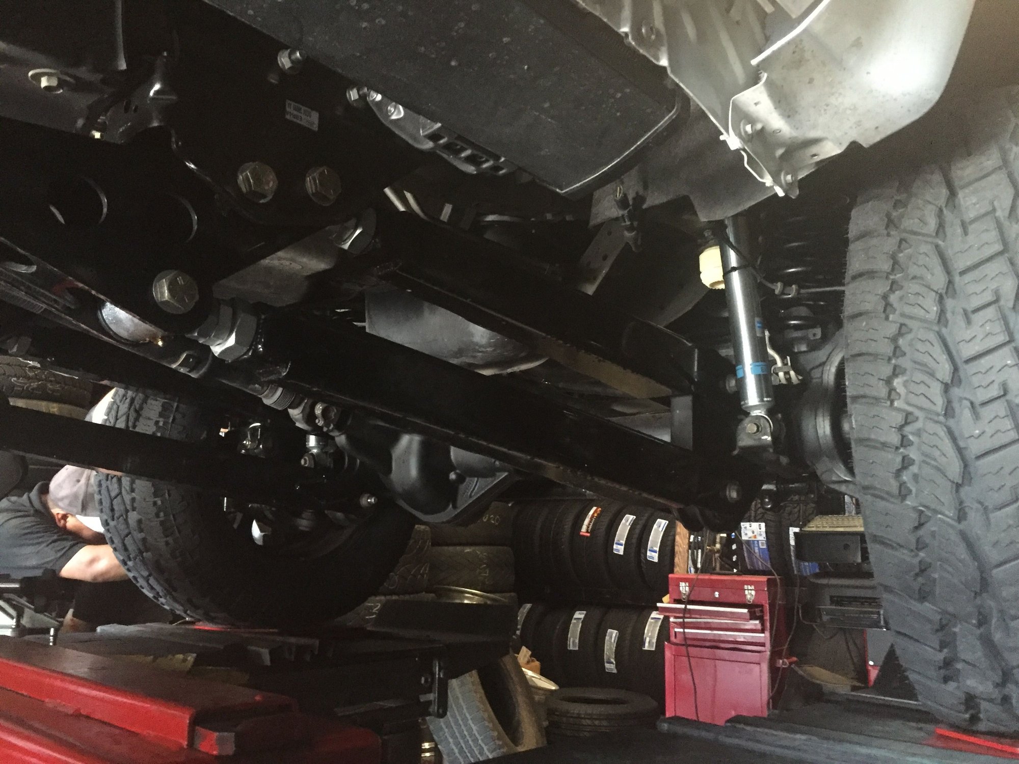

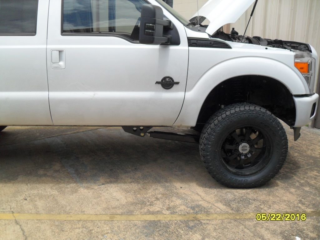

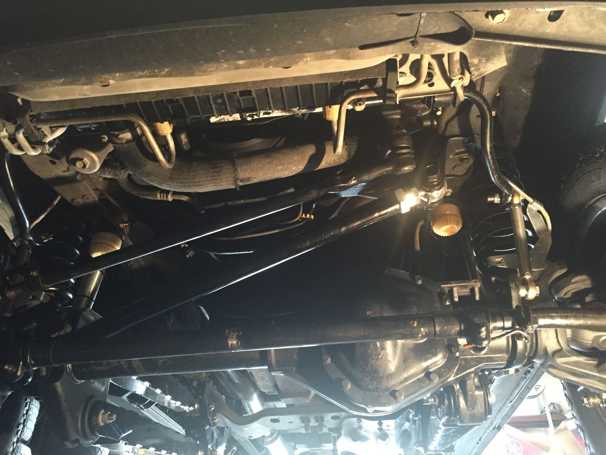

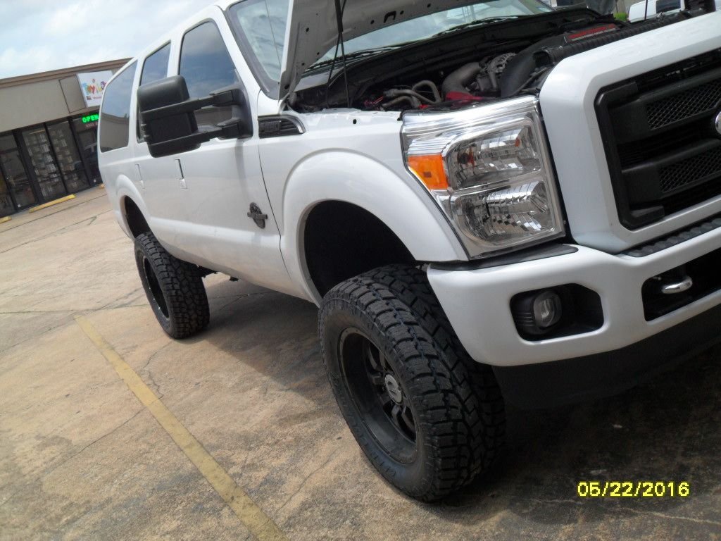

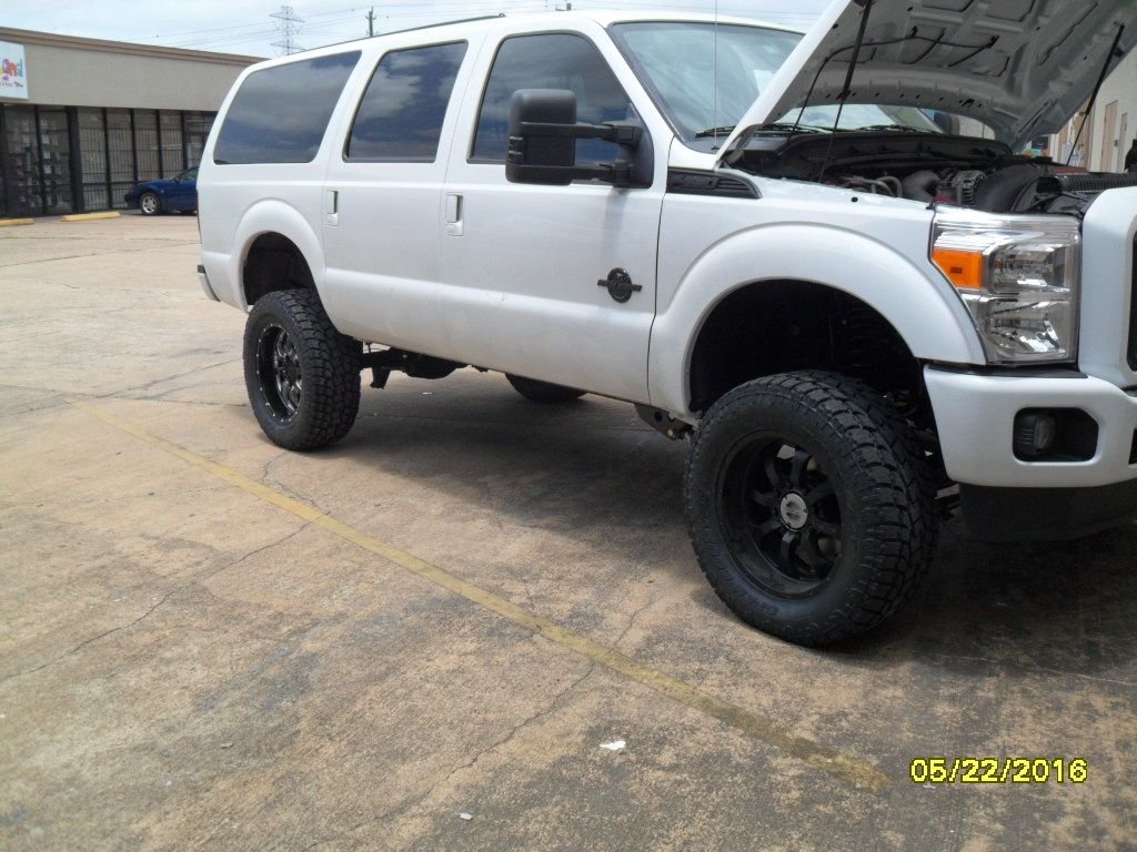

Couple updated pics.

We need a drool emoticon...
Old May 26, 2016 | 08:41 AM
  #126
Greenscobie86's Avatar
Greenscobie86
Joined: Feb 2005
Posts: 1,344
From: NYC
Thing turned out badass man!

Were you going with Amp Research steps, or did you have another plan?
Just curious because to me it now seems like there's an abundance of white, and some fixed black steps would look pretty damn good.

I already have the AMP steps installed. And now I saw that they have some rockslider type AMP steps. Not sure if they make them for Excursions but look good on the Jeeps.
Waiting on correct front sway bar and correct dual steering stabilizers but at least it's finally home.

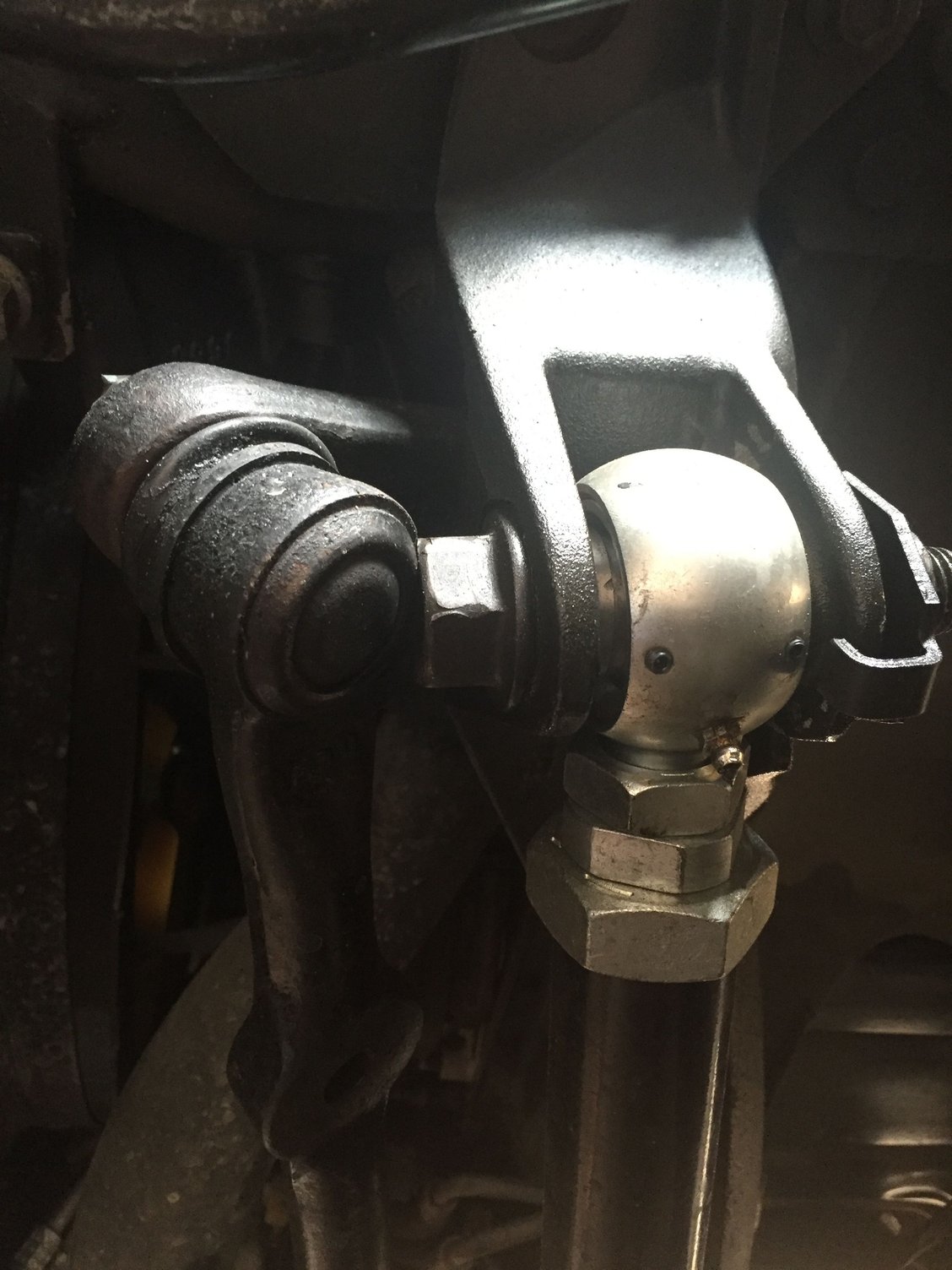

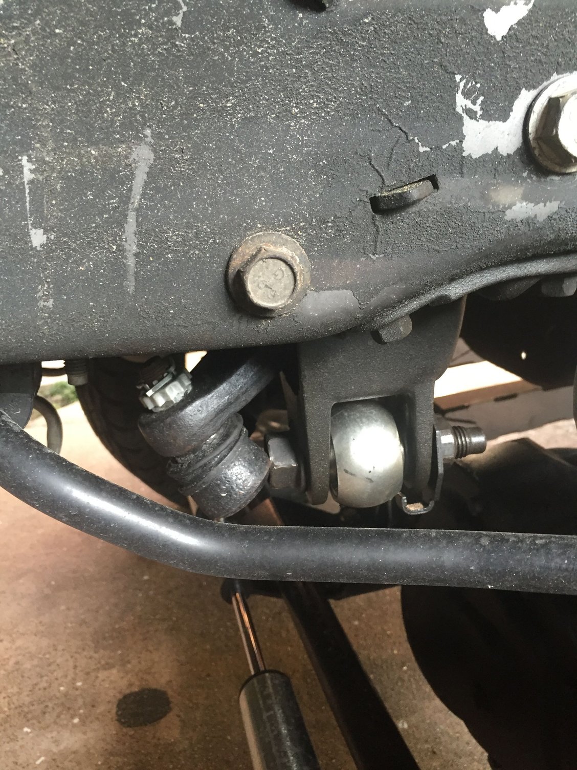

So I used 2010 Stock box and pitman arm, what am I doing wrong? Can't get full turn to the left. Hitting bolt head.

Did you change the track bar bracket to the newer one also? Mine doesn't look like that.
Old Jun 7, 2016 | 09:38 PM
  #134
5HUB's Avatar
5HUB
Joined: Jan 2016
Posts: 194
From: Houston, TX
Can't remember but thats probably not the newer one then. I'll look through my pile of parts and swap it out.

From: Houston, TX
Should I go ahead and get some sort of relocation bracket or just go with factory bracket?
