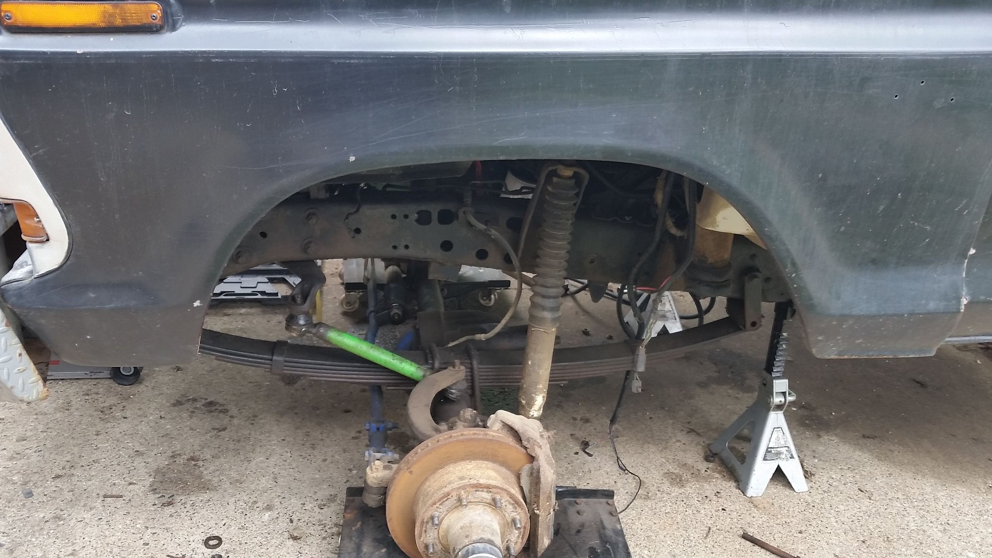

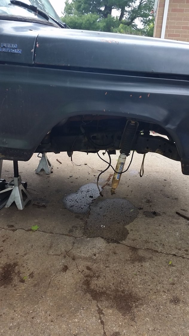

front axle is in!
So, that was fun. Finally had some decent weather. Decided to put in my Dana 60 and new springs.
You know, you make plans and the Big Guy upstairs laughs...
What should have been a 4 hour job (tops) started off bad...my floor jack decided to die on me. Today.
Got the jack situation rectified.
Getting the old axle out is fun! So much crust and grime. Ya me!
Without further adieu , I present: pictures!
Old May 17, 2016 | 08:32 AM
  #219
1KILLERZ's Avatar
1KILLERZ
Joined: Aug 2014
Posts: 776
Likes: 30
From: Zeeland, MI

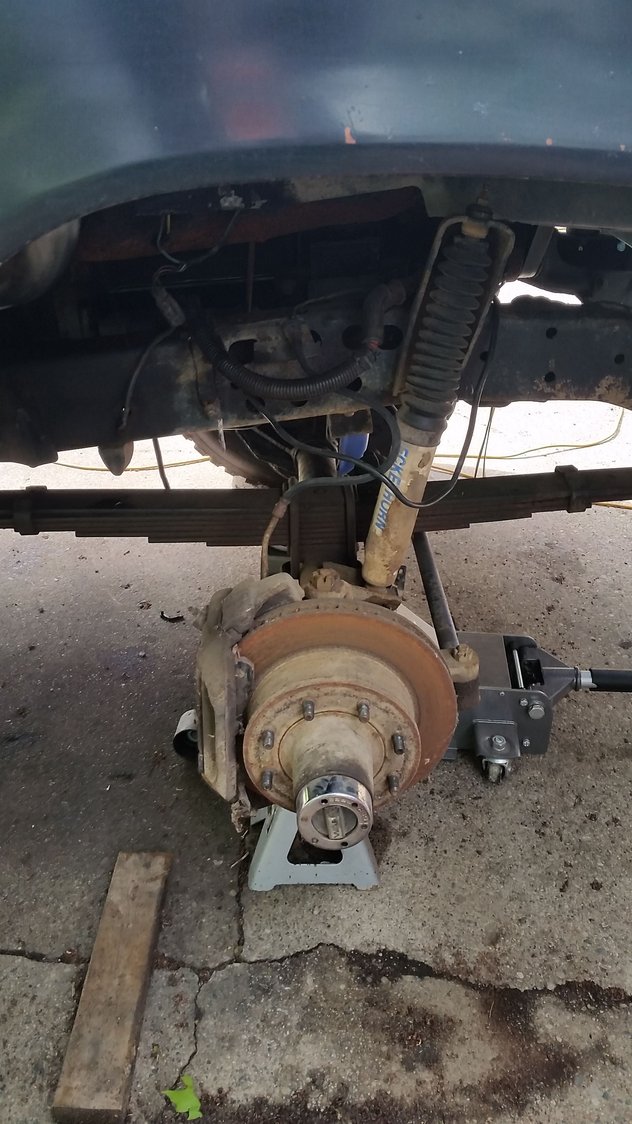

Here we see the D44 in its natural environment...
So step 1, remove 37 inch MTR's.
****, step 1, borrow a floor jack as mine is now dead
Step 2,Disconnect brake line, lower shock nut

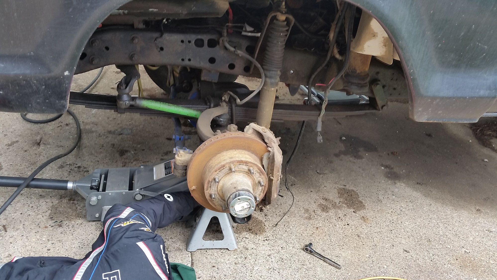

Step 3, support frame.
Old May 17, 2016 | 08:43 AM
  #220
1KILLERZ's Avatar
1KILLERZ
Joined: Aug 2014
Posts: 776
Likes: 30
From: Zeeland, MI

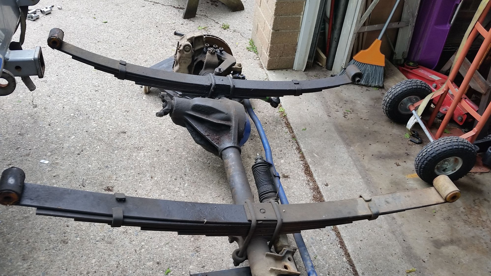

Support the axle with your arm. Ok, not really. If i need to explain how to swap an axle out to you, maybe you should go read a shop manual instead of reading this build.<br/>See how taxed that rear shackle is? Thus the spring upgrade.
Love these little dollies.
More funky colors.
What, wait. Where'd it go?
Old May 17, 2016 | 08:48 AM
  #221
1KILLERZ's Avatar
1KILLERZ
Joined: Aug 2014
Posts: 776
Likes: 30
From: Zeeland, MI
I seriously heard the 4 inchlift , 3/4 ton springs collectively breath out a sigh of relief. Or was it that mexican food i had last night? Either way, there was something in the air...
Freedom!!!

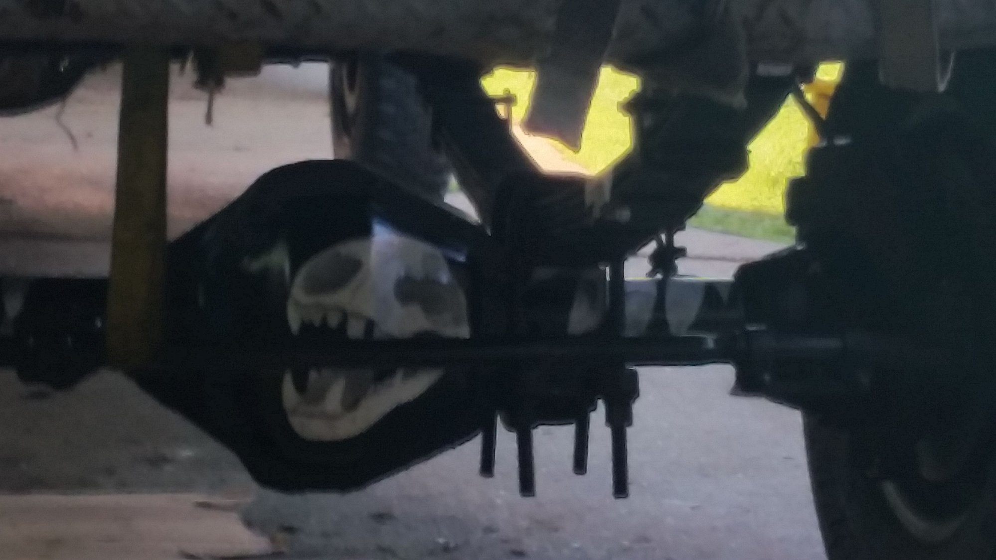

For those that are curious, these are the springs i used based on skyjackers technical support.<br/>5-6 inch lift spring, to accomodate for my new found girth (thats what she said) from the powerstroke drive train and tree killer front bumper.
Ready to put this big pig in
Its in!!! Springs are at home.
I had to reuse the u-bolts that came with the axle. Will be shortening these in the near future.
Bear skull's love eating track bars. Delicious.
