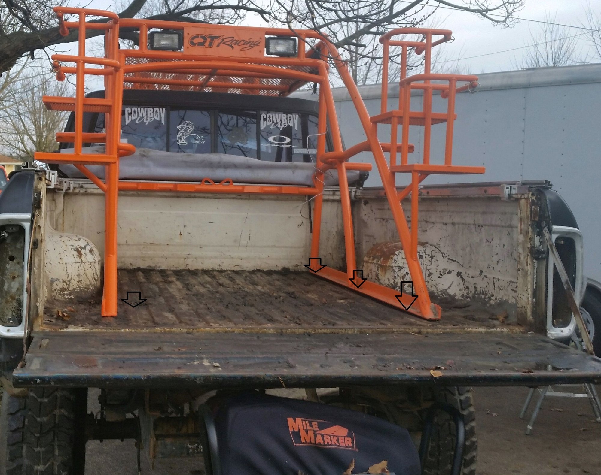

mounting on the baja rack
The black arrows show the mounting location. 3 on each side.

Got it. I don't think I'd seen a pic of it from that angle yet, so wasn't sure how far down it came.
Unfortunately that layout does eat more bed space for sure, but you can still build boxes into some of the space between the rack tubes & the sides of the bed if you want. They can make for good, lockable storage.
