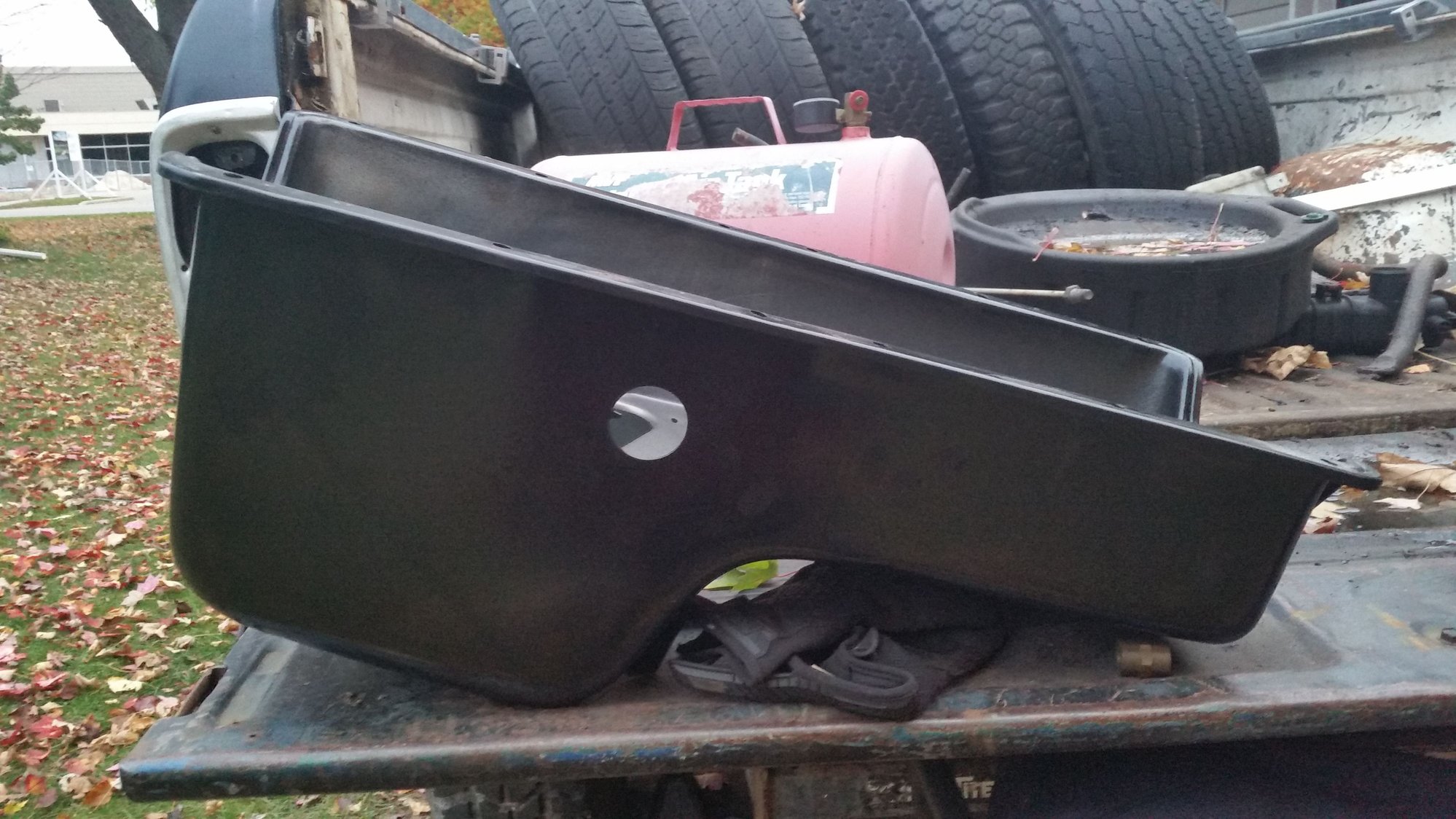

From: Zeeland, MI
New and unscathed oil pan.

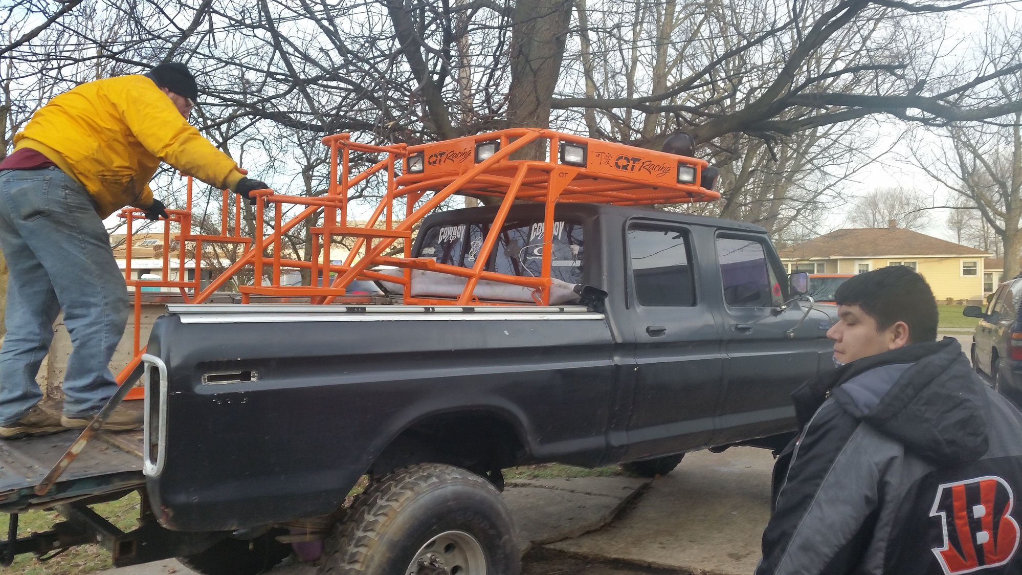

Baja rack
So I haven't had it powder coated yet. But, needed the room, so decided to put it on for now.
Mounted the solar tech lights up top (for now), and put the 4 KC day lighters from my Carr bar on it. Mounted them so when time come, I will pierce the night and offer 180 degrees of viewing.
