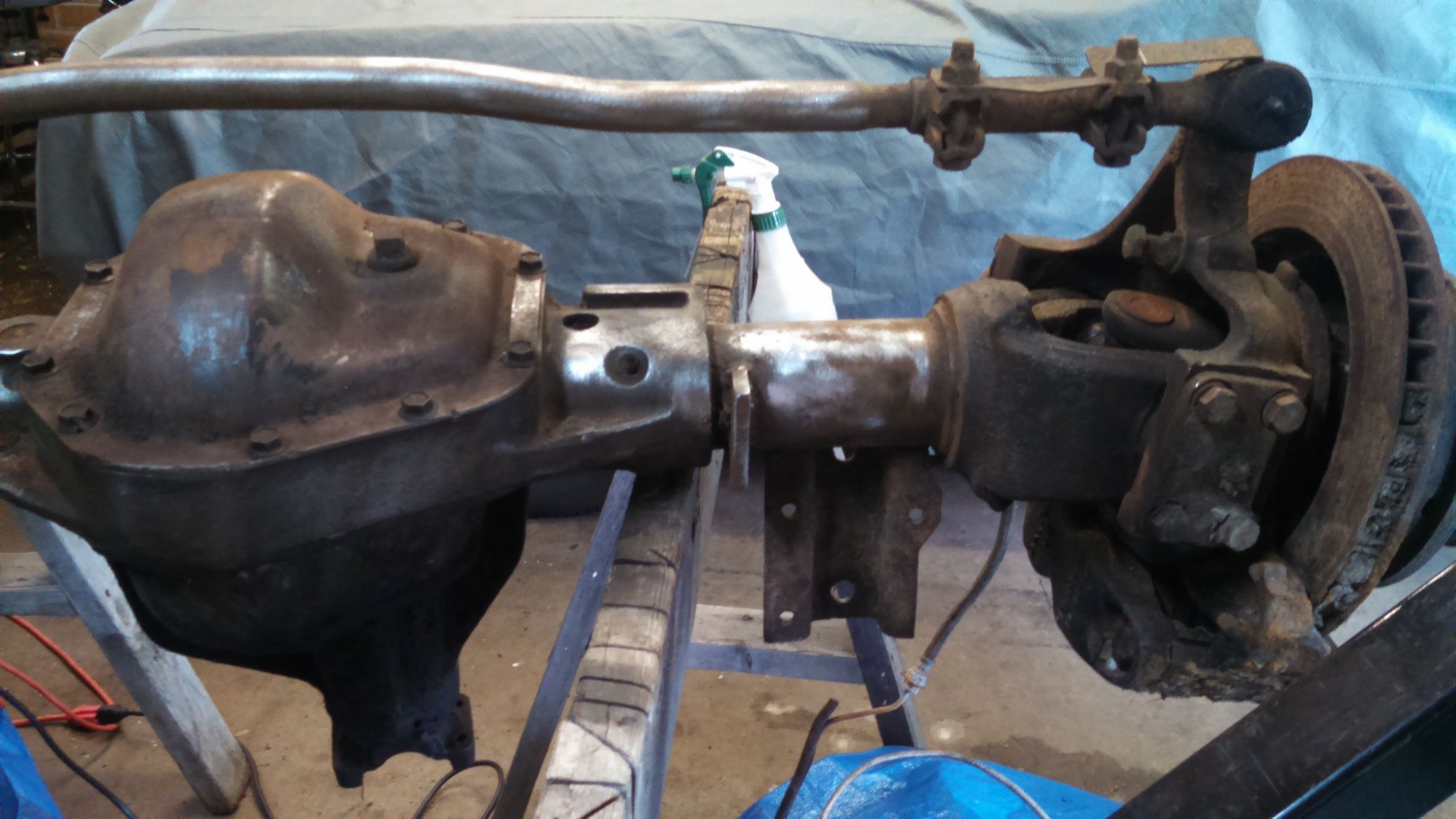

axle time..
So my little guy has Vacation Bible School this week, so I figured I might as well as start on the axles now as opposed to waiting for this weekend...
so the fun begins. Forgot what powdered rust tastes like...yummy...
And then, in my haste, I forgot one element...will the bedliner material adhere to raw/cast/uncoated metal, or do I need to get a primer/etching?
Anybody here know that answer?
Knocked all the junk off, probably shaved a year off my lung capacity, but its getting done...
Even found the factory numbers...
Well, back at it tonight...

I always prime before I use bedliner, but that just seems like the right thing to do to me. I don't know if it will go on bare steel

I know every line-x and rhino guy I have talked to says they prefer bare metal for the best adhesion...

Thanks for the input on this. I thought the same thing in regards to priming. Just want to be sure.

Thanks for that. I will call the customer service number and see what their tech recommends, as this is the stuff in a can, maybe that would make a difference.

No problem. Again it is just what I have heard from the guys behind the counter at the shops that do it...
Granted I have never seen the professionally done stuff peel... roll on thats another story.....

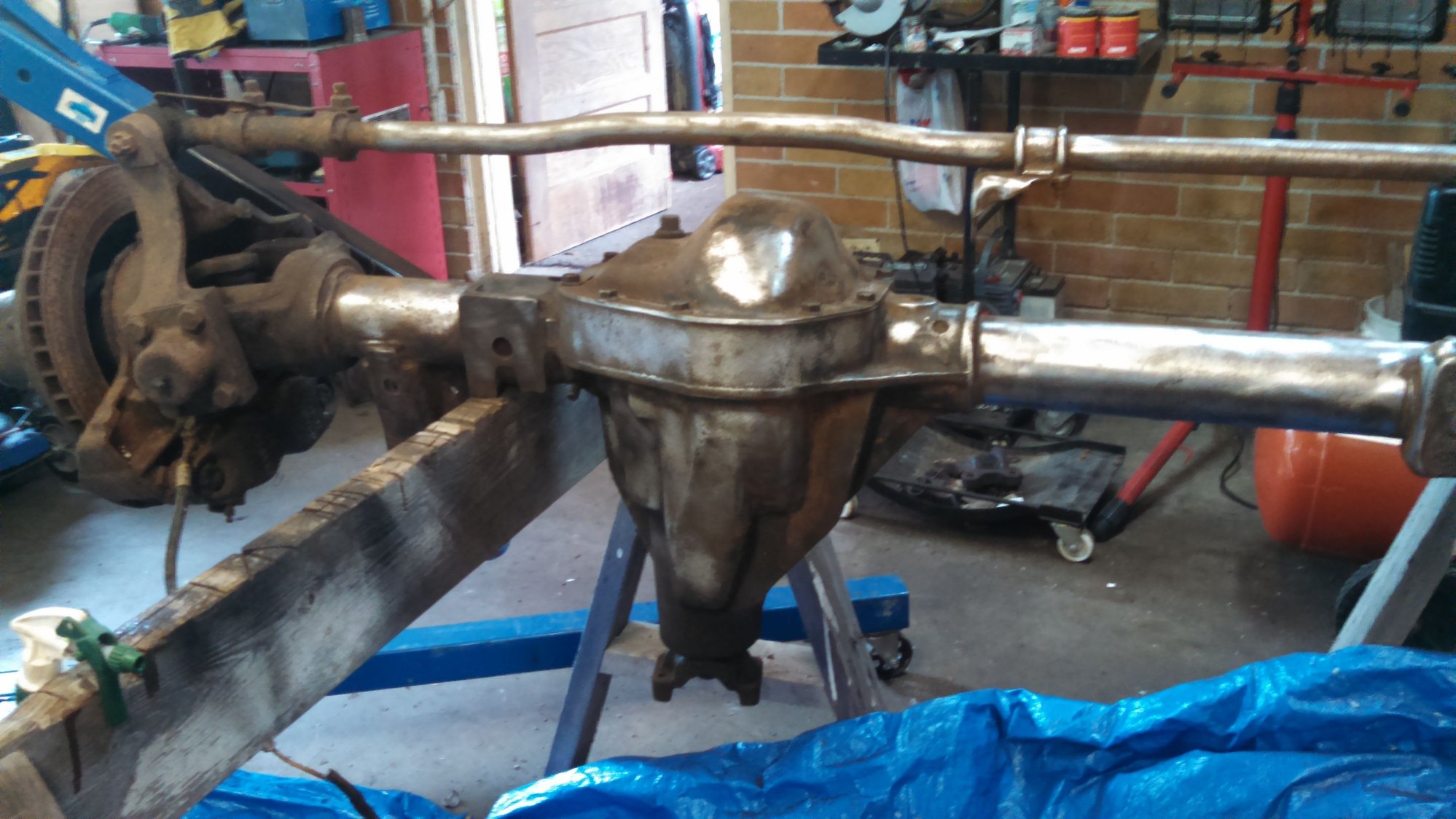

day two on the D60
Keep on keeping on...
I am not planning on keeping the diff cover. Looking to upgrade/customize that part of it. But other than that, hope to have completely stripped down tonight. No painting, as humidity will be too high due to the upcoming storm. Maybe tomorrow night I paint, whilst I am enjoying libations...as most of my best paint work happens when I can't remember shiite from consuming too much fermented grains...
