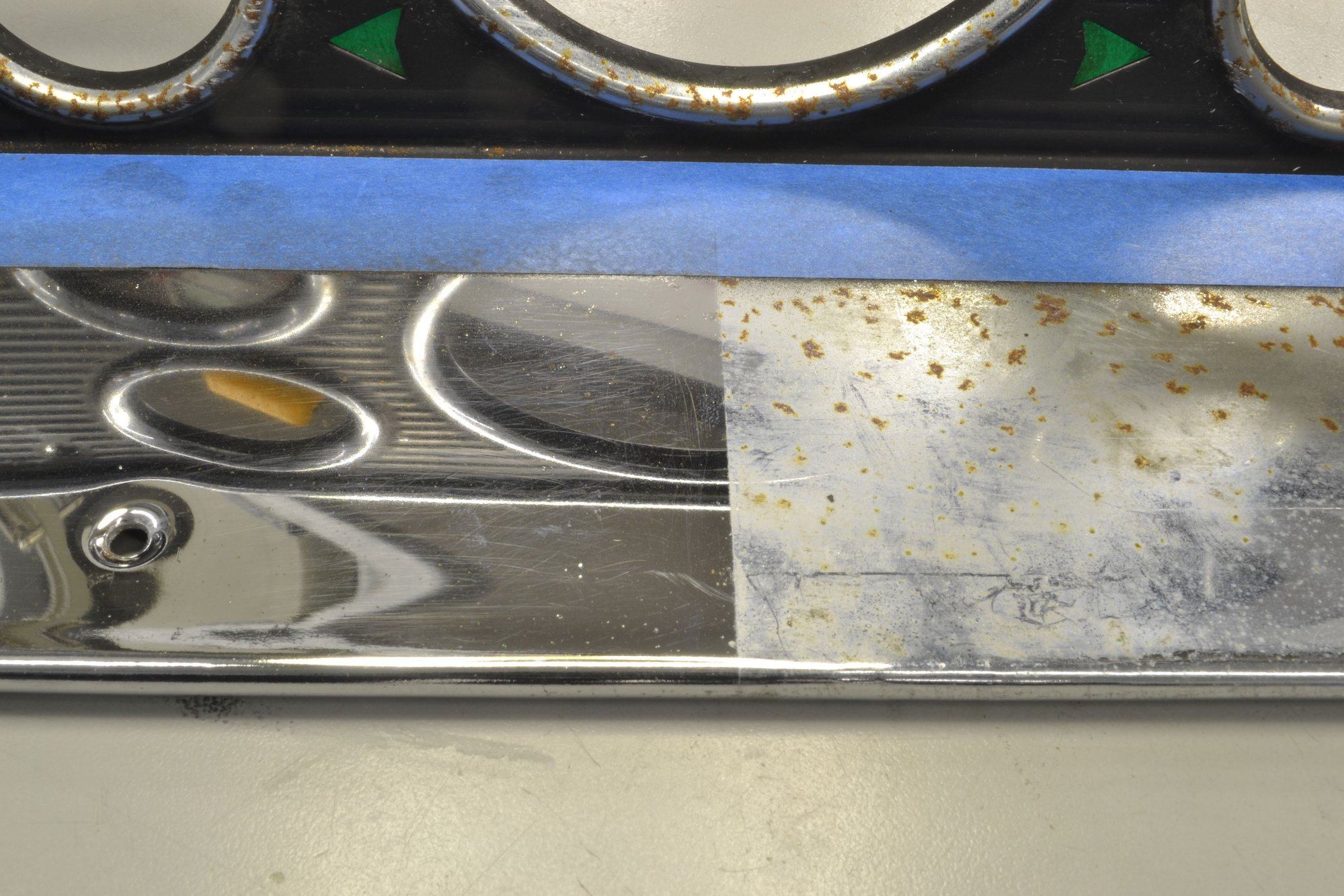

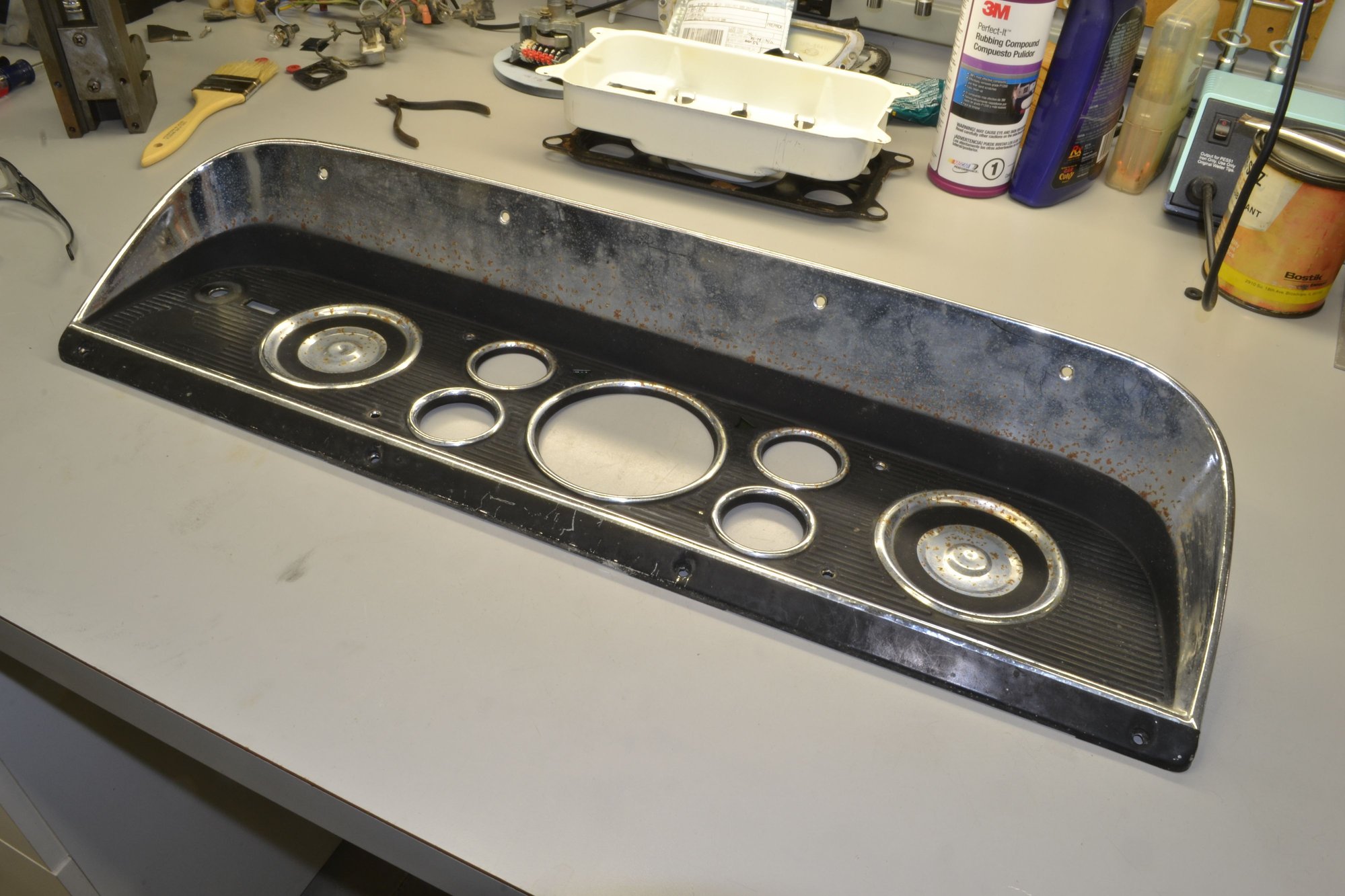

I got my second cluster today from ebay for $75. I can't wait to get it cleaned up.
The rust blotches on this bezel all come from pinholes in the chrome so I started by lightly scraping them off with an Exacto knife.

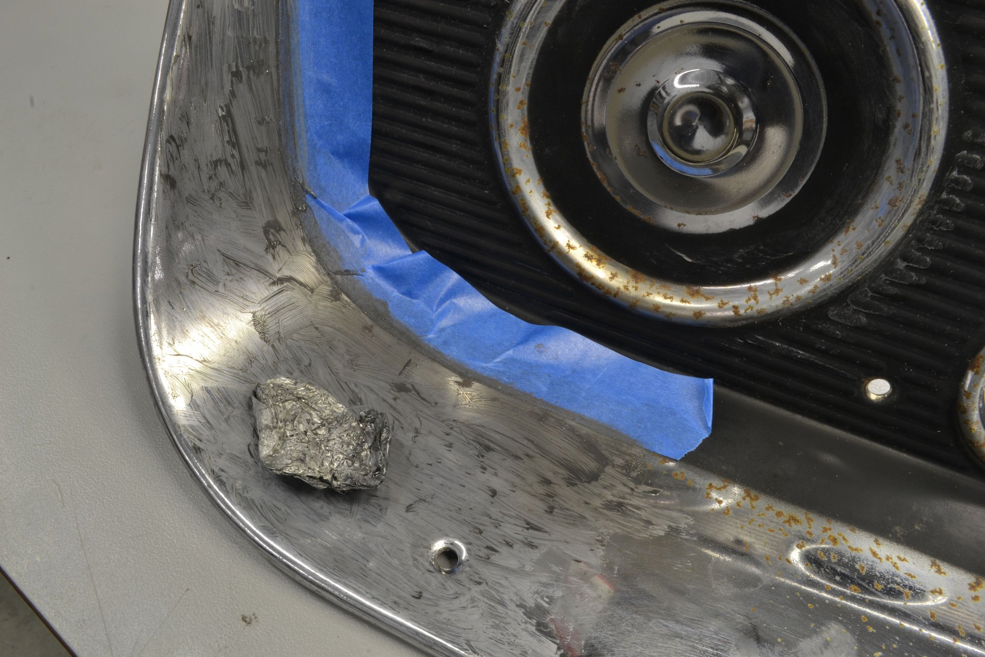

Then I took a ball of aluminum foil and some Mothers aluminum polish and lightly scrubbed off the oxidation layer. Next I used more aluminum polish on a soft cloth and buffed it out.
Between each step I wiped down the surface to remove any loose rust particles. If you don't clean them off they will scratch the chrome while you are polishing. I found out the hard way.
The tape keeps me from rubbing the paint off. I was hoping to get it a little cleaner but I think this will be alright. You can still see the pinholes.
After and before.
Take your time and experiment on a small area first. YMMV

Thanks for posting that Tomahawk. That cluster really turned out great from how it was. I'm going to have to try that to acouple of my clusters that have some rust spots on. Did you only use mothers aluminum polish for the whole thing?
First I flaked off as much of the rust blotches as I could then I used Mothers with the aluminum foil ball and then more Mothers on a soft cloth to get it completely clean. I also tried some 3M Perfect-It #1 rubbing compound and that didn't seem to help or hurt the finish. I was very lucky that the finish wasn't too far gone.
