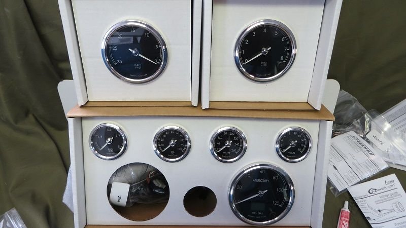

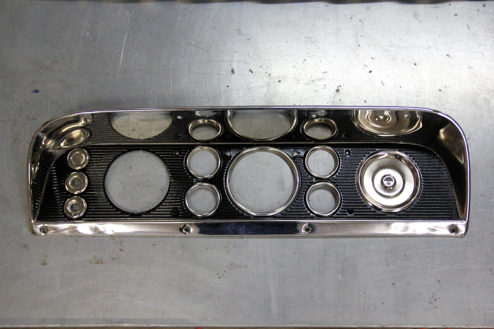

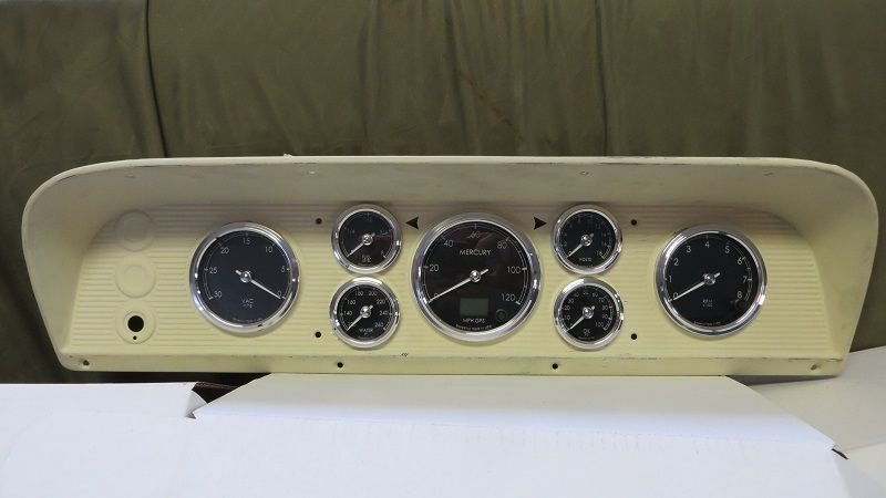

My gauges arrived!
The best part of any performance parts purchase is the stickers you get with the parts, right?!
I opened up all the holes to fit the gauges, while the bezel is still in primer. I have to figure out something for the signal lights, any ideas?

That gauge cluster looks awesome!!! The CCW vacuum gauge and CW tach. look sweet!

Looks great!

Good looking style of gauges in that cluster.

Nice gauges.

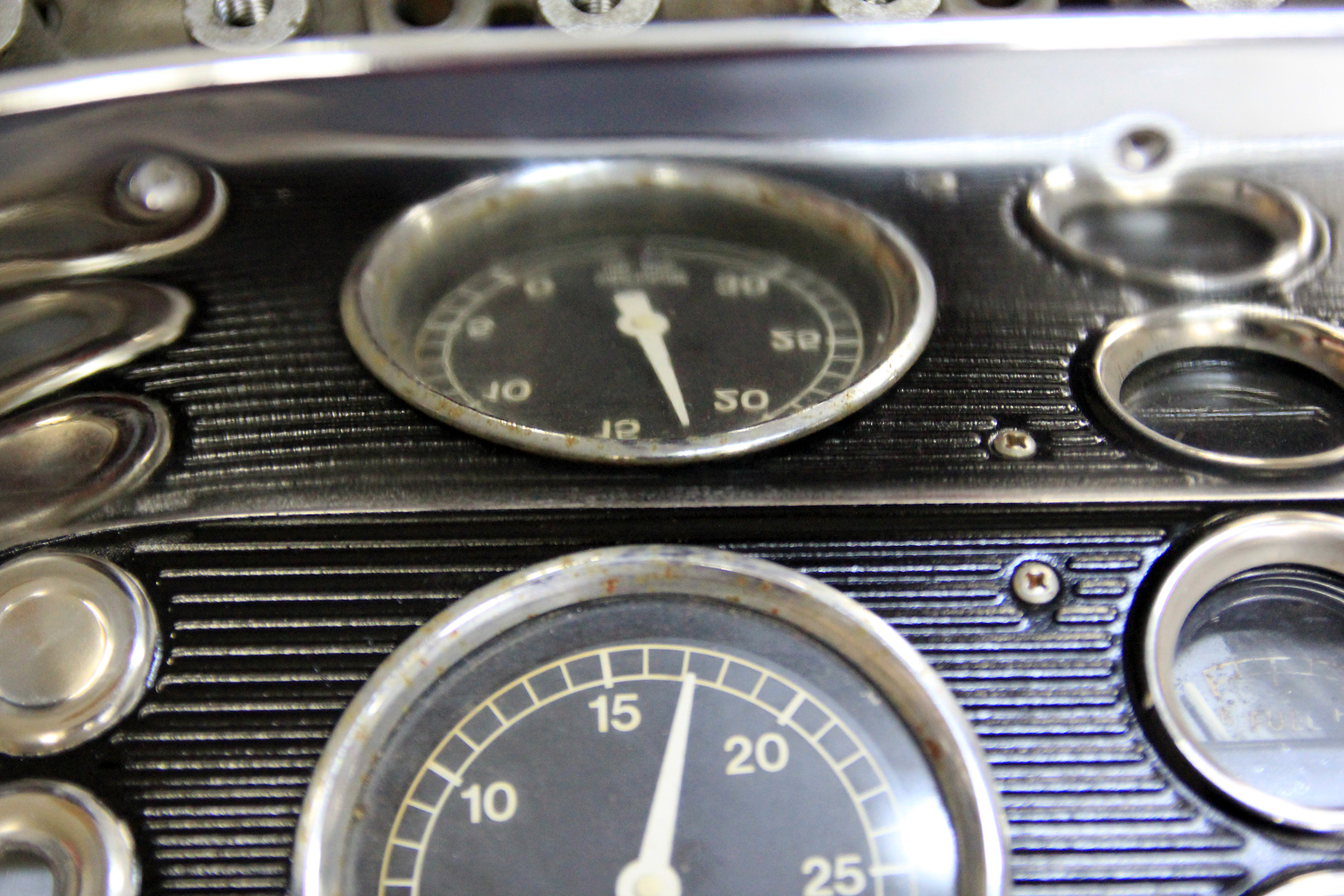

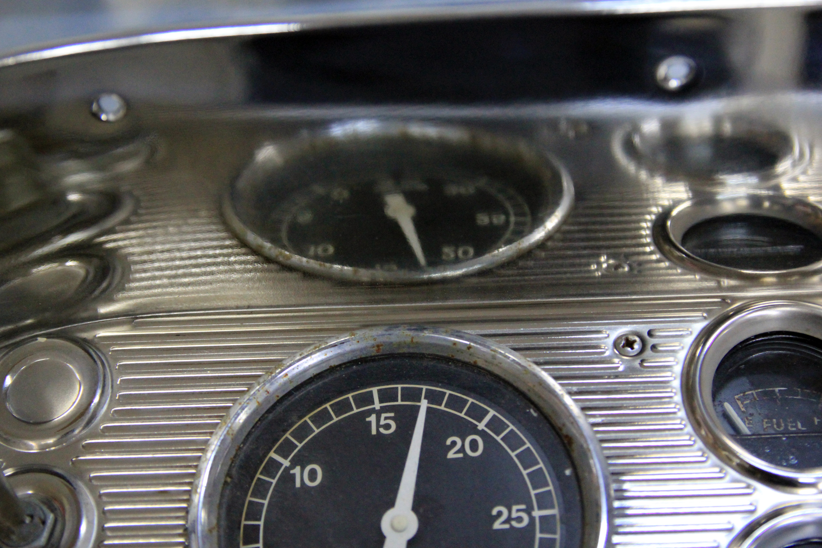

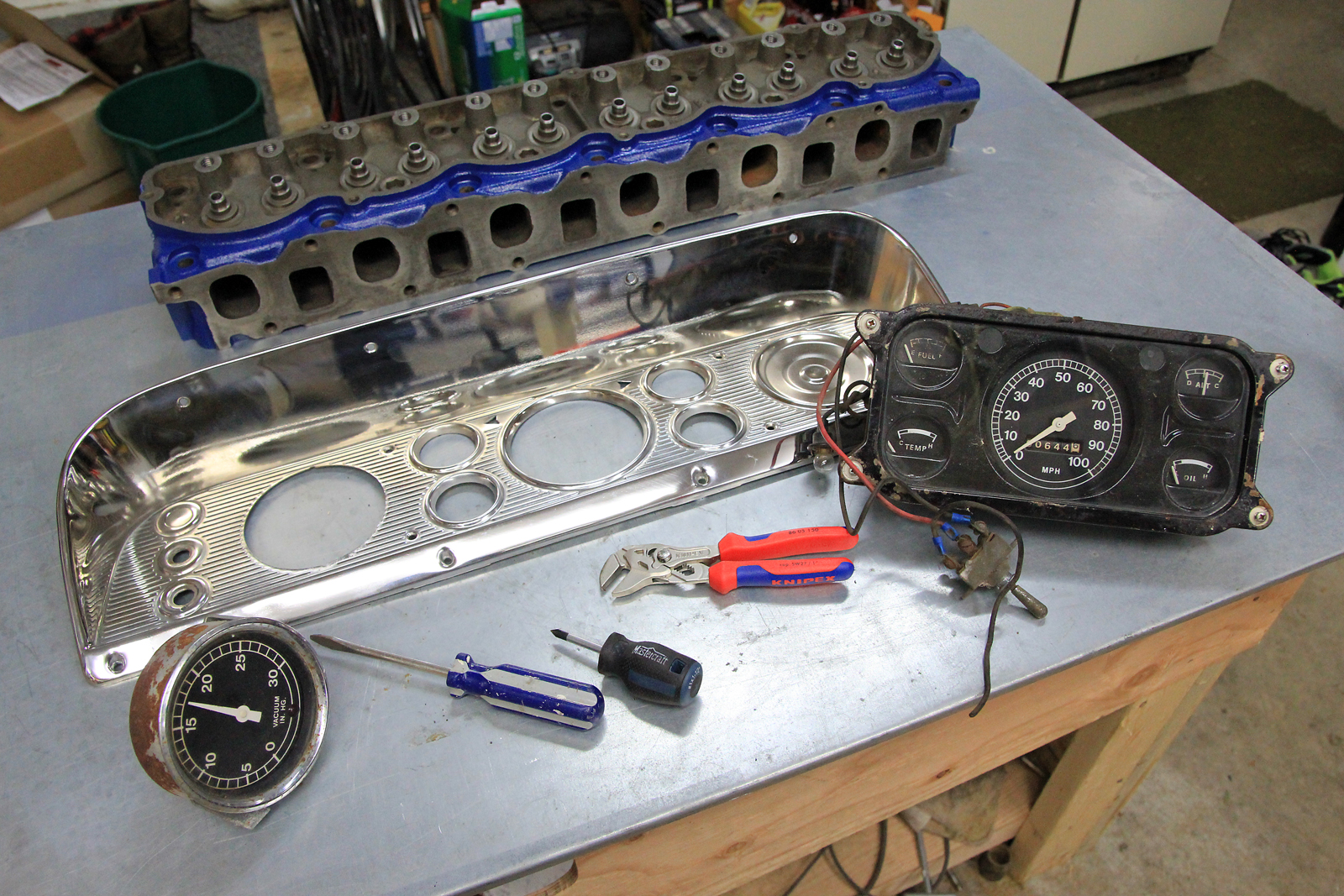

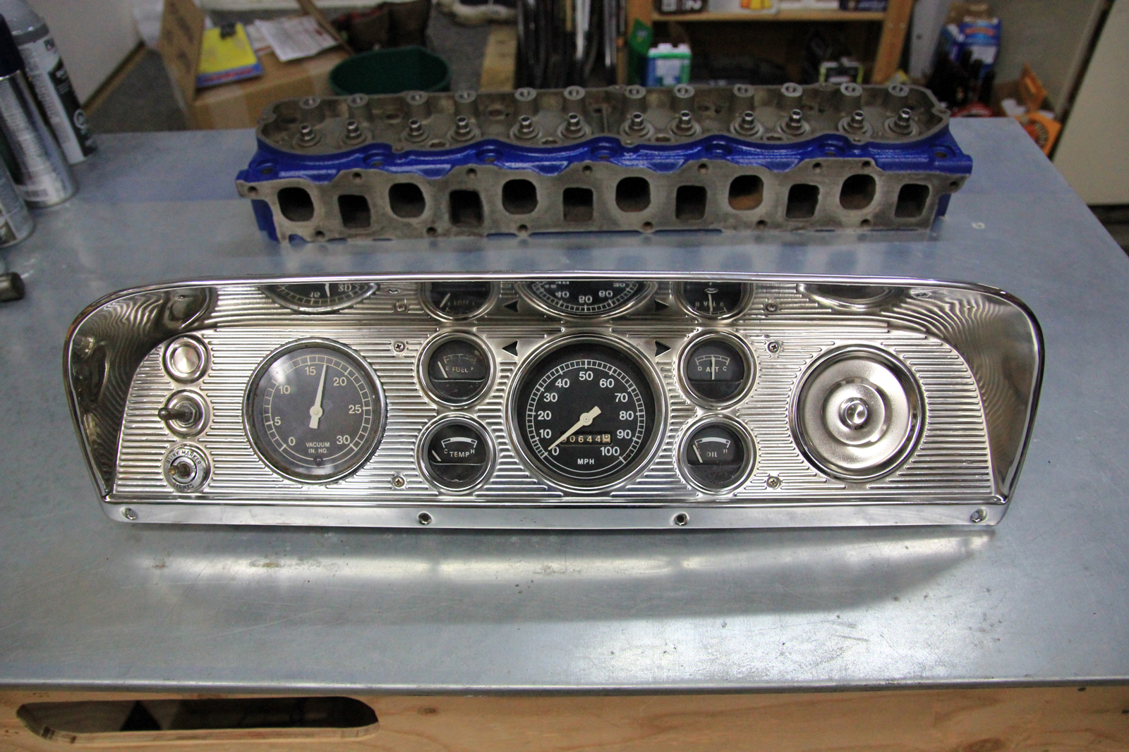

This is a direct copy from my build thread, but I'm posting it anyway.
Before starting. I love chrome but only in moderation. This was too much to leave alone.
Attachment 290635
Disassembled.
Attachment 290636

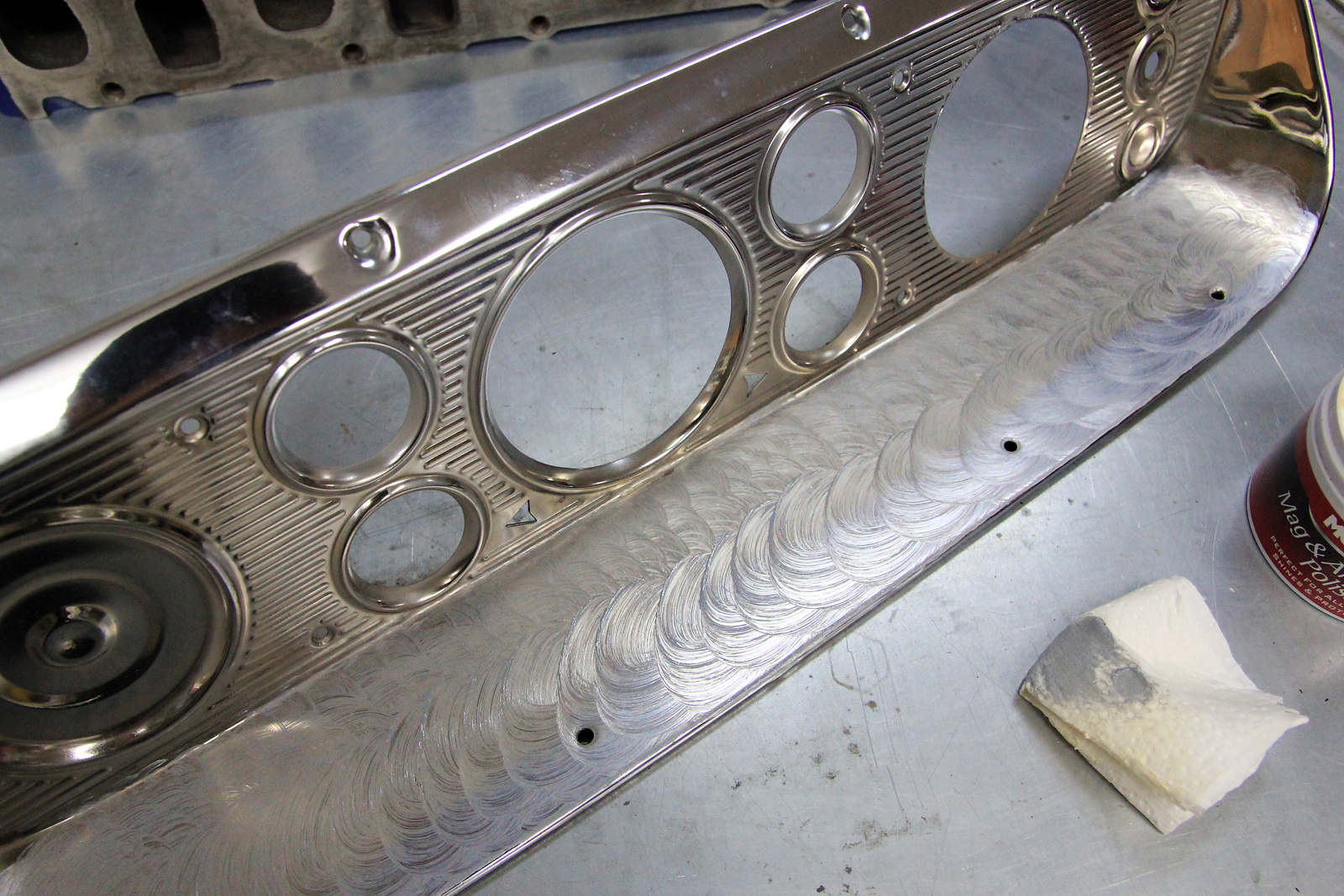

The chrome was a bit hazy so that's what I was trying to fix.
Attachment 290637
Attachment 290638
I have about twelve hours in polishing on this gauge cluster.
Attachment 290639
I sanded down the faceplate, using sandpaper wrapped around a pencil to get in between the grooves. I used 320 grit.
Attachment 290640
Paint doesn't like to adhere to chrome so I made sure to scratch it up real good.
Attachment 290641
I used these 3D printed rings made my user Tomahawk and generously sent to me for free. Thanks again.
Attachment 290642
They sit like this.
Attachment 290643
After paint.
Attachment 290644
The paint I used ended up being super tacky and I found out after peeling it a bit that the masking tape needed to be cut off first before I could pull it off, like when you remove a baseboard in a house and don't want to pull up the drywall.
Attachment 290645

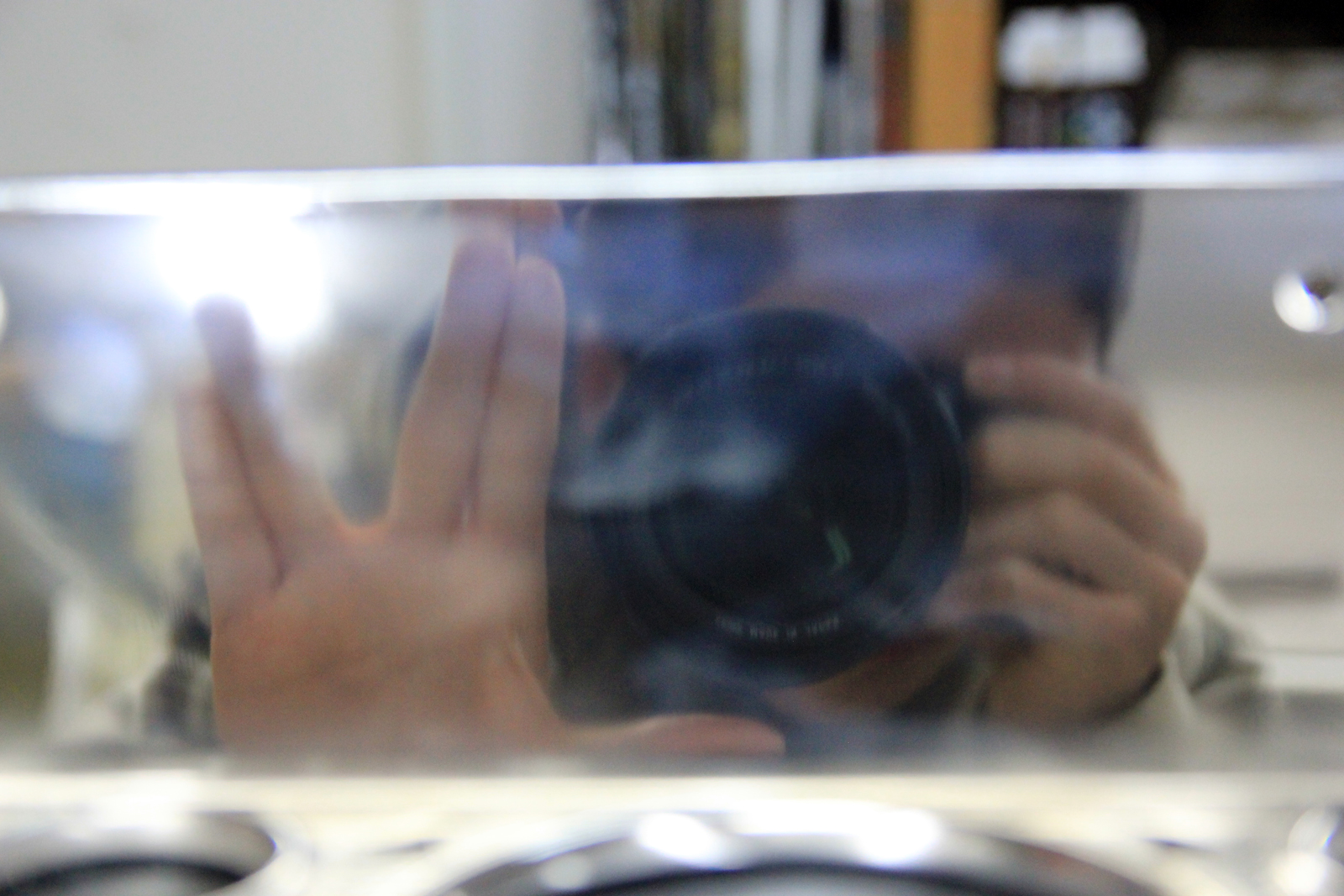

Attachment 290646
You can see that it's much more reflective but it's still not a perfect mirror.
Attachment 290647
Here's the pre-polish again for you to compare.
Attachment 290638
I might have missed it but what szes did you order? 4 inch for the center, 3 3/8 for the sides and 2 1/16 for the little ones?

Those gauges do look sweet. Good choice Mon.
Now what's he got planned for those three spots o the left. Let's see....push "START" button, "FIRE" out the tailpipes, and "EJECTION" seat? For those who refuse "A$$-Gra$$-or Cash, nobody rides for free?
I have to figure out something for the signal lights, any ideas?[/I]
You'll need to make yourself some sort of box that encapsulates the pointed arrow from behind and allows a light socket to be mounted at the back. That way, the only light that can escape is through the arrow slot. I would put a little LED in there because they're so small.
Old Feb 25, 2015 | 06:15 PM
  #224
JEFFFAFA's Avatar
JEFFFAFA
Joined: Mar 2013
Posts: 14,255
Likes: 199
From: Phoenix, Az.
Jackson has a point. LED's light points forward. Not like a Laser but more than a standard bulb. So if you fab something to hold a left and right LED over the 2 arrows you can use the top two screw holes to bridge across.
Old Feb 25, 2015 | 06:37 PM
  #225
trozei's Avatar
trozei
Joined: Nov 2012
Posts: 2,806
Likes: 8
From: Langley, BC
Originally Posted by JEFFFAFA
If you fab something to hold a left and right LED over the 2 arrows you can use the top two screw holes to bridge across.
I love this idea. Those screw holes aren't needed anyway with the aftermarket gauges. Makes perfect sense to put them to use. All you would need is some thin and narrow sheet metal bent like this _|--------|_ bridged across, viewed from above. Tap the flat portions for your screw and it will be plenty sturdy. Mount the LED with double sided 3M tape and you'll be set to go.
