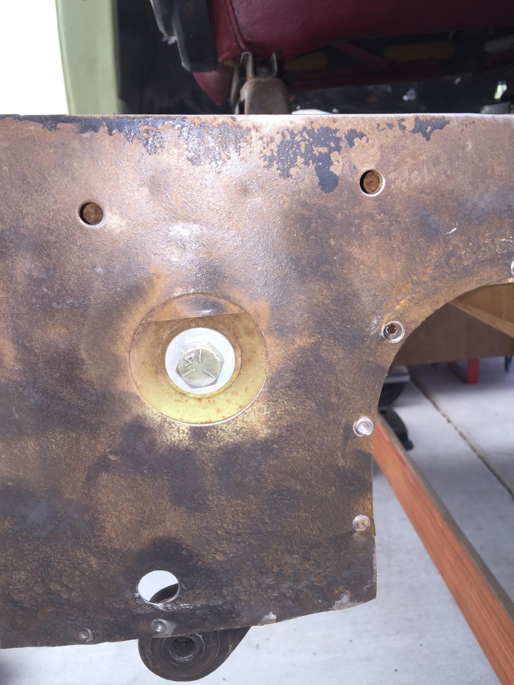

It's been a while since I posted. I'll try to update as much as possible. Mostly prepping the cab for paint.

Smoothed the firewall

Are you doing anything for a cross member at the front cab mount area?

For the frame or cab?
http://api.viglink.com/api/click?for...%20Forums&txt=

I have two. Tranny dogbone mount, and the tubing directly behind that.

I really wouldn't let the T.C. hang on the flexplate like that.

It's bolted to the flex plate. And I took it off right after transmission was moved out of the way

Sorry, I should have dug deeper into you build so I wouldn't have had to ask. I'm planning on using a 351W/C6 in my current built and looking for all the info I can find

I like the tranny mount because it's adjustable and makes tranny easily removable. Came from shop in phoenix "industrial chassis". Steve is owner
