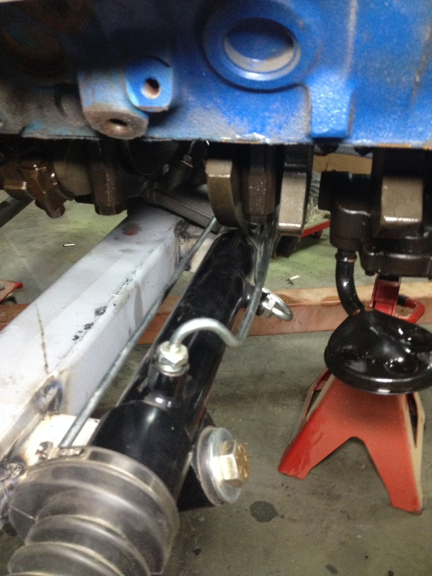

Well, I worked on the rack tonight. Not good. I made my own 3/4" spacers and tried to mock up the rack. It just won't fit. The rack housing it hitting the oil pan. Looks like I need 1/4" clearance. I'm thinking about cutting the rack mounts that are welded to the crossmember and moving them down 1/4". I know that it's important to keep tie rods parallel to ground at ride height, or you introduce bump steer into the equation. But would 1/4" really matter that much??
in the picture, it's not the tube hitting the oil pan, it's really the rack housing barely touching...

That exactly what happened with me, and this is what I did
Raised the engine as high as possible and changed the motor mounts with thicker ones
Rerouted the oil pipelines in the steering rack
This photo before installing the new oil pan

I think I'm gonna move the rack down 1/4". I'll try today and report back. I don't think 1/4" would make that much of a difference. I rerouted one of the rack lines, which helped a little, but still need maybe 3/16"

They make off set rack bushings, would be better then changing mounts. But it would also be easy to shim motor mount, and not worry about having bump steer problems.

finally finished the suspension. moved rack up 1/8". added another joint for steering shaft to fit around exhaust. i added a gusset on the heim joint bracket that's not included in picture. Name:  060A11ED-7531-4FB0-99D6-652DFBD2BC48_zpstngowlb7.jpg
