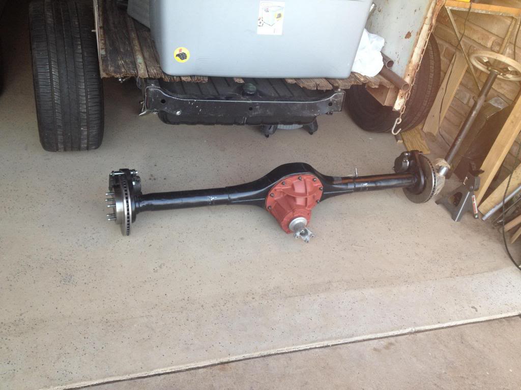

Thx Giesterfarher- don't have much free time these days with the new baby boy. I did get the new rear end last weekend. I had to put the wheels on and mock it up. Now I'm just waiting on the no limit 4 link.
Widened to fit without tubbing my bed.

New moser axles with disc brakes.

I used the housing Garbz gave me and the third member housing. New 3 1/4 gears with all new bearings and seals. New trac lok posi too.

Had to put wheels on just to see what it looks like!
