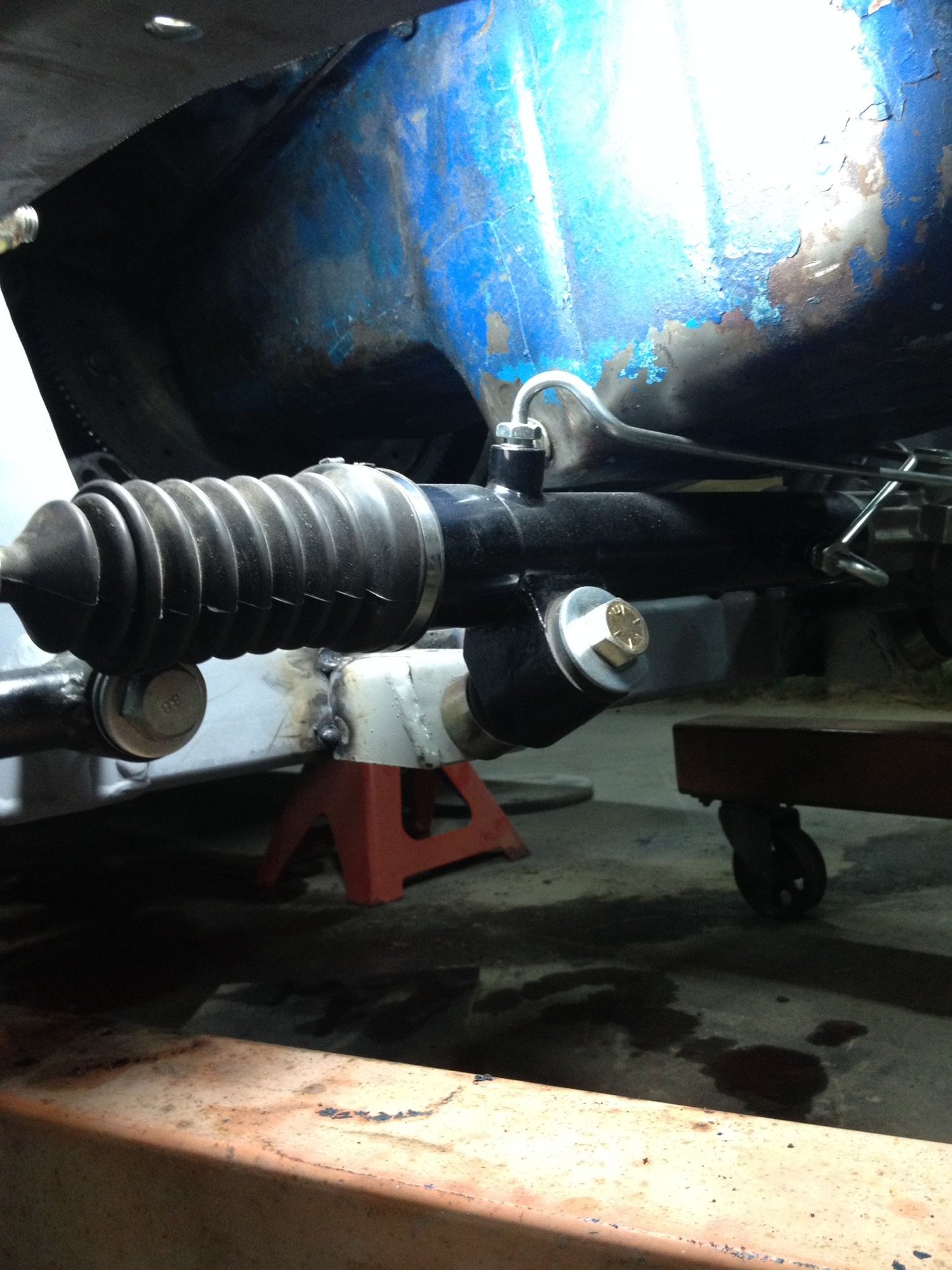

Got a new power steering rack because mine leaked like a SOB. had it rebuilt 3 x's. never buying from CPP again. With these tubular lower control arms, the bolt is rubbing against the dust boot. not sure what other guys are doing for this issue. i have a heidts crossmember, and i believe the control arms are TCI. Are people modifying the rack and pinion mounting point to move the rack a little bit??

I had the same problem and ended up by using spacers between the rack mounting points and the cross member, I don't know if this was ok or not but its not effecting the steering and not rubbing the bolts any more
