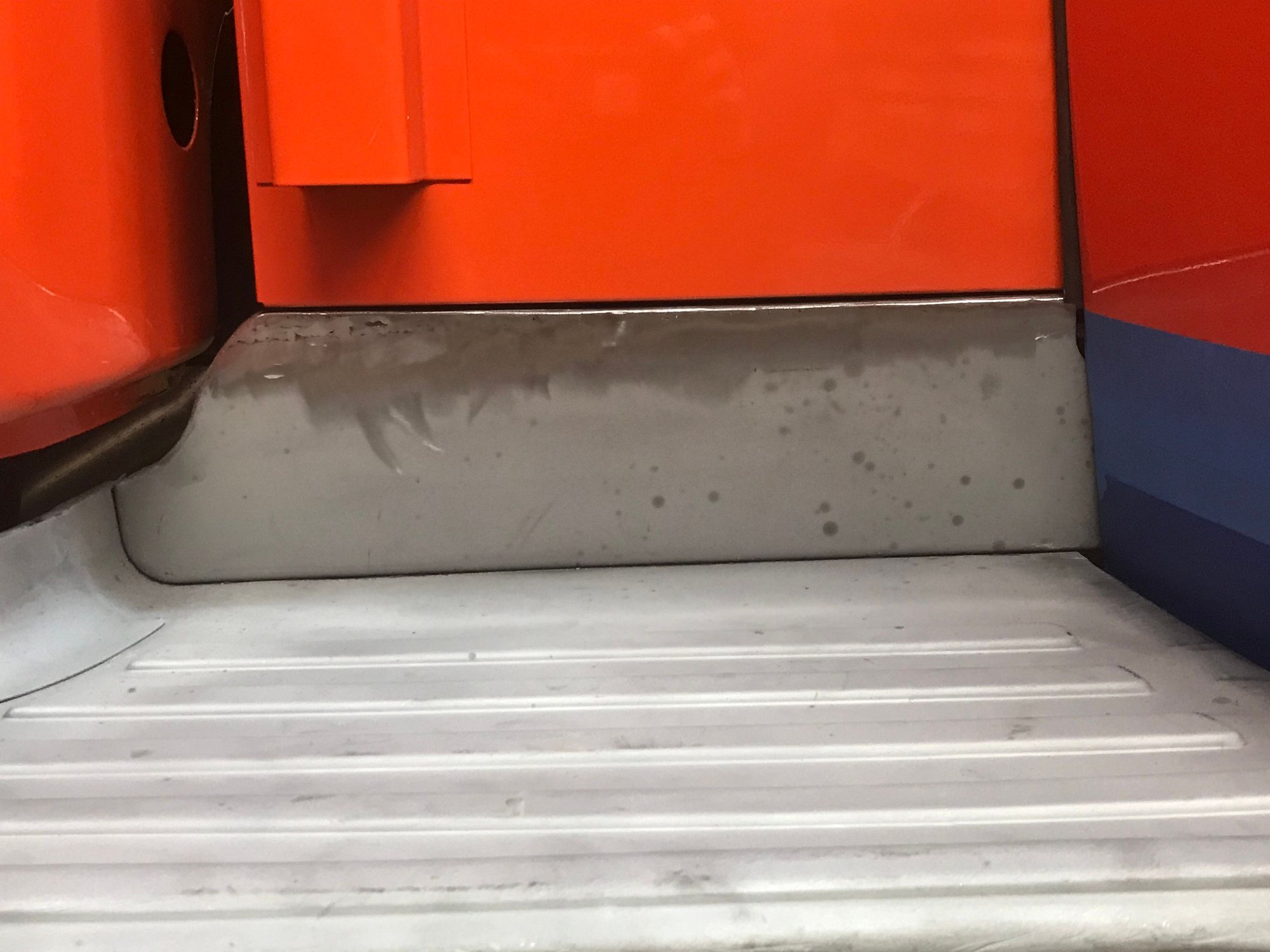

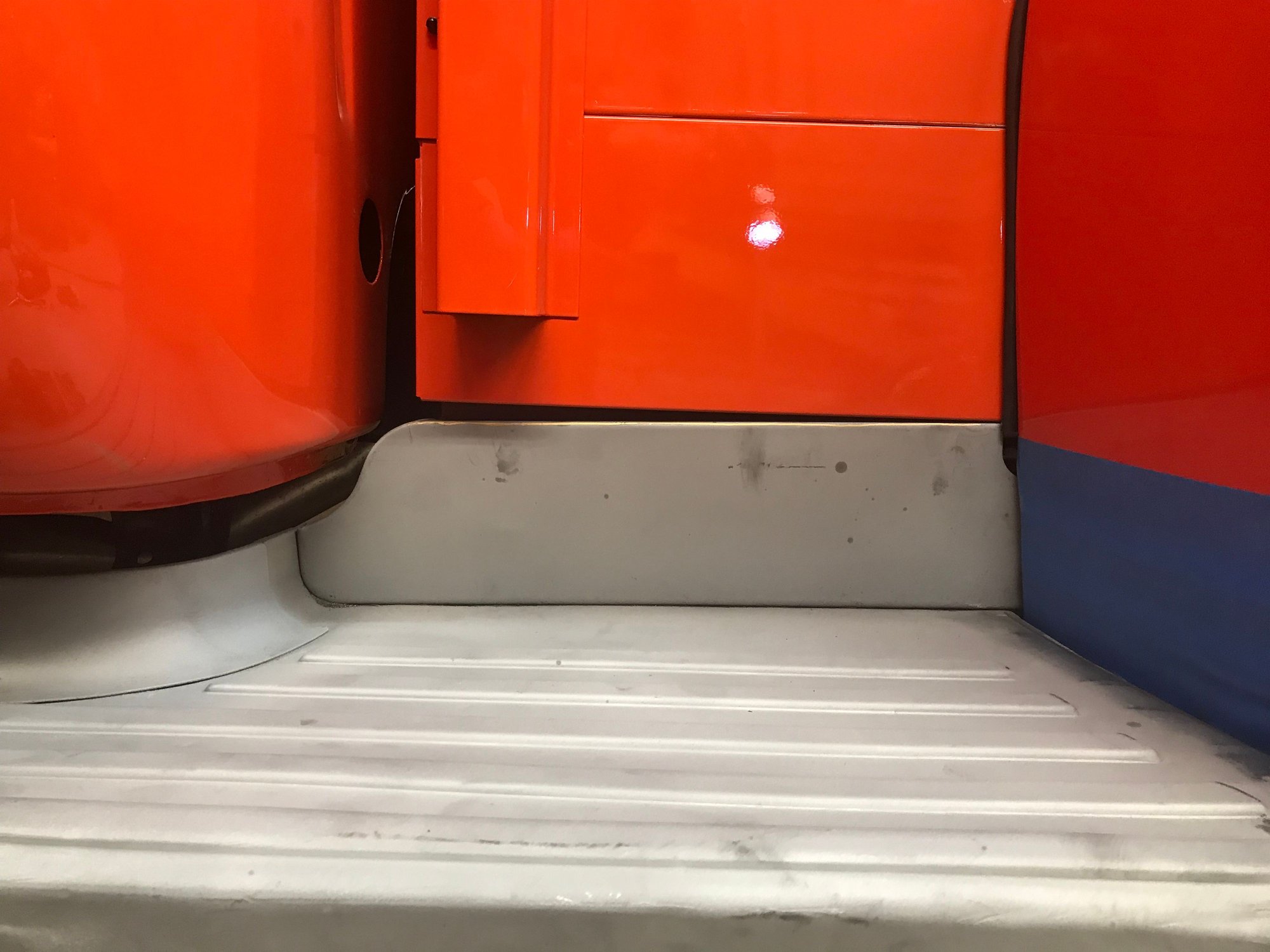

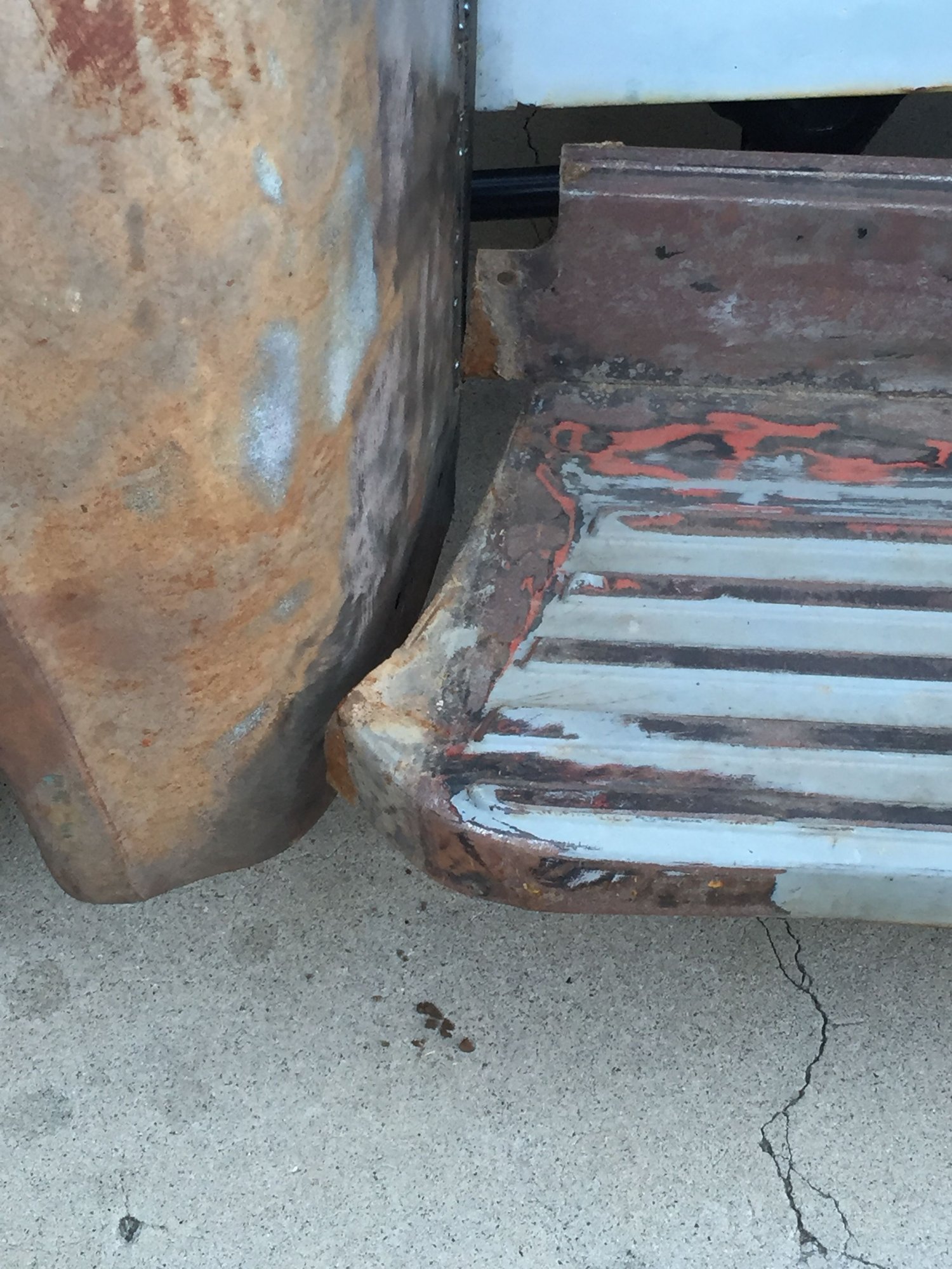

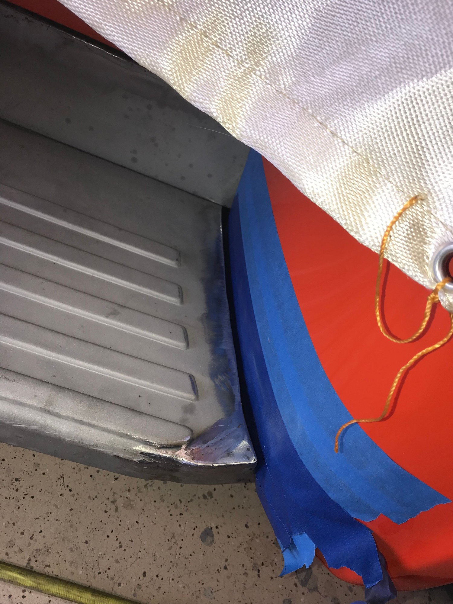

Just an update, I’ve been finishing up the repairs on the hood, front fenders and running boards. Almost time to finish painting this darn thing.
Old Jan 4, 2018 | 07:58 PM
  #267
jrockdiddy's Avatar
jrockdiddy
Joined: Dec 2012
Posts: 1,257
From: Scottsdale, AZ
Before
After
Before
After-had to modify running boards to fit 3" widened fenders.

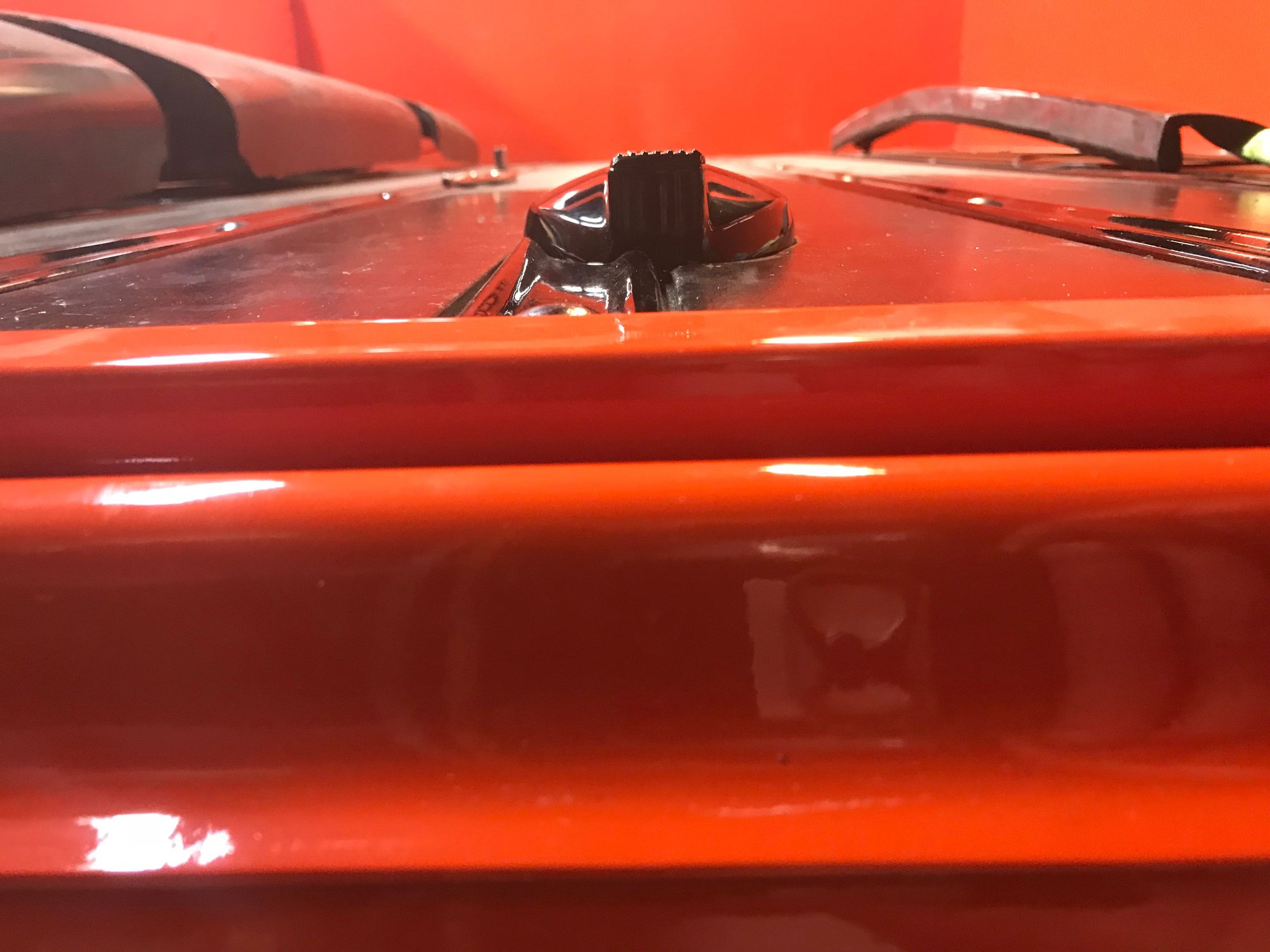

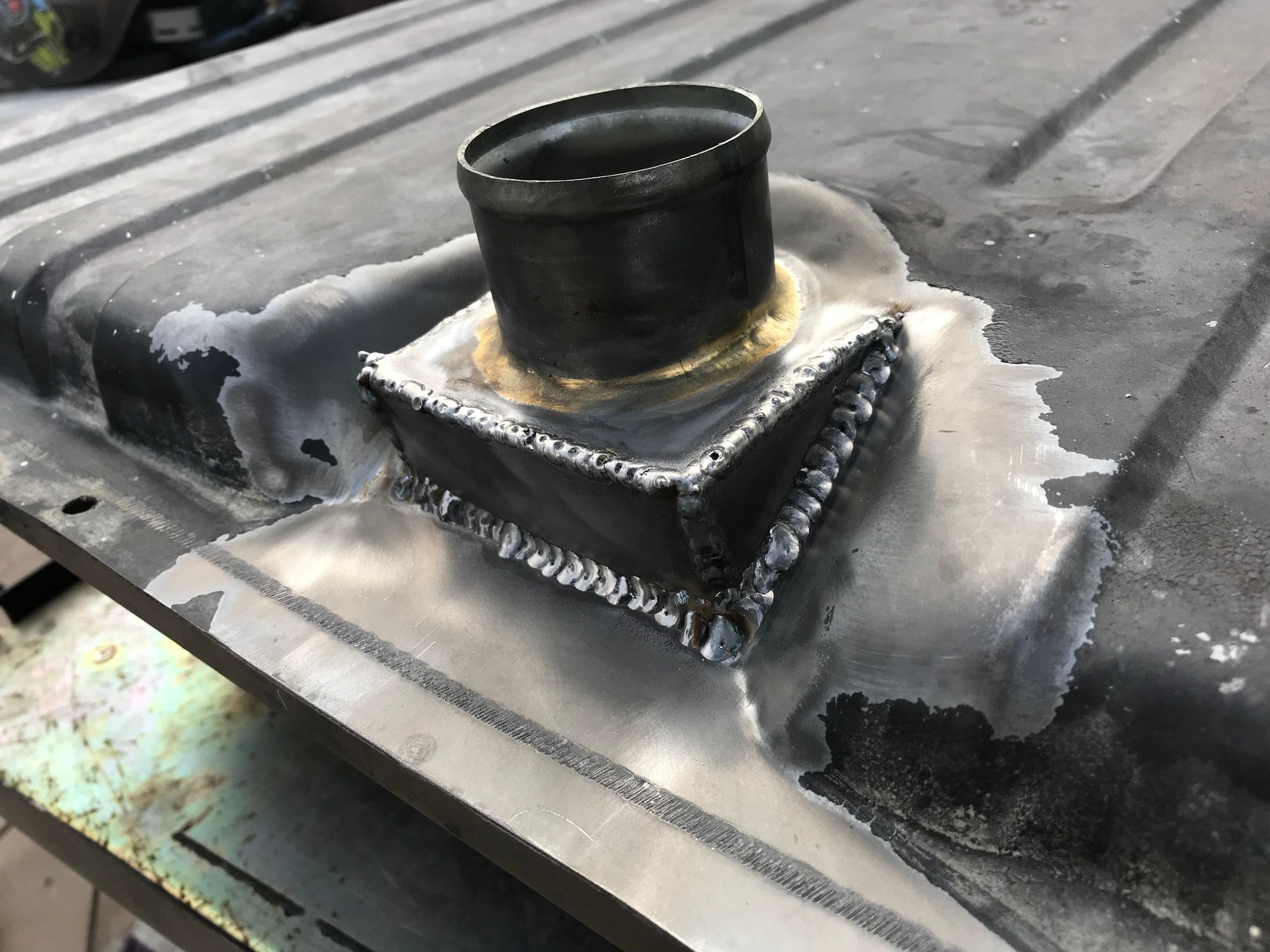

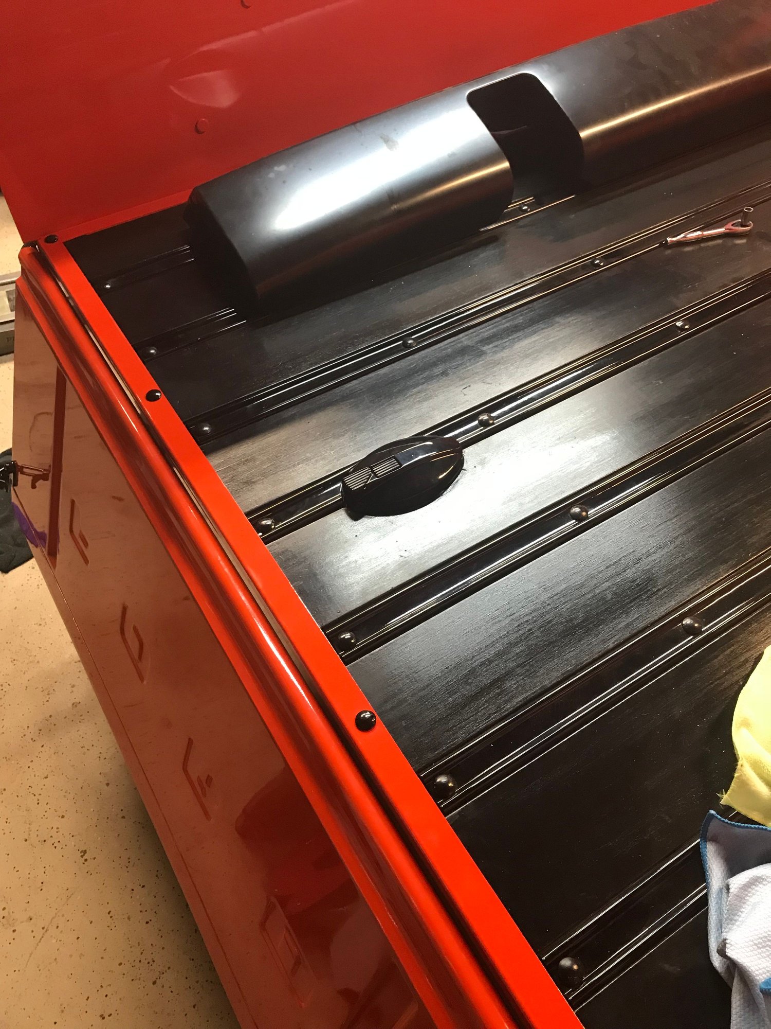

Also finished the gas cap.
Modified to 22-gallon mustang tank so the filler neck was straight up and down.
powder coated the cap
