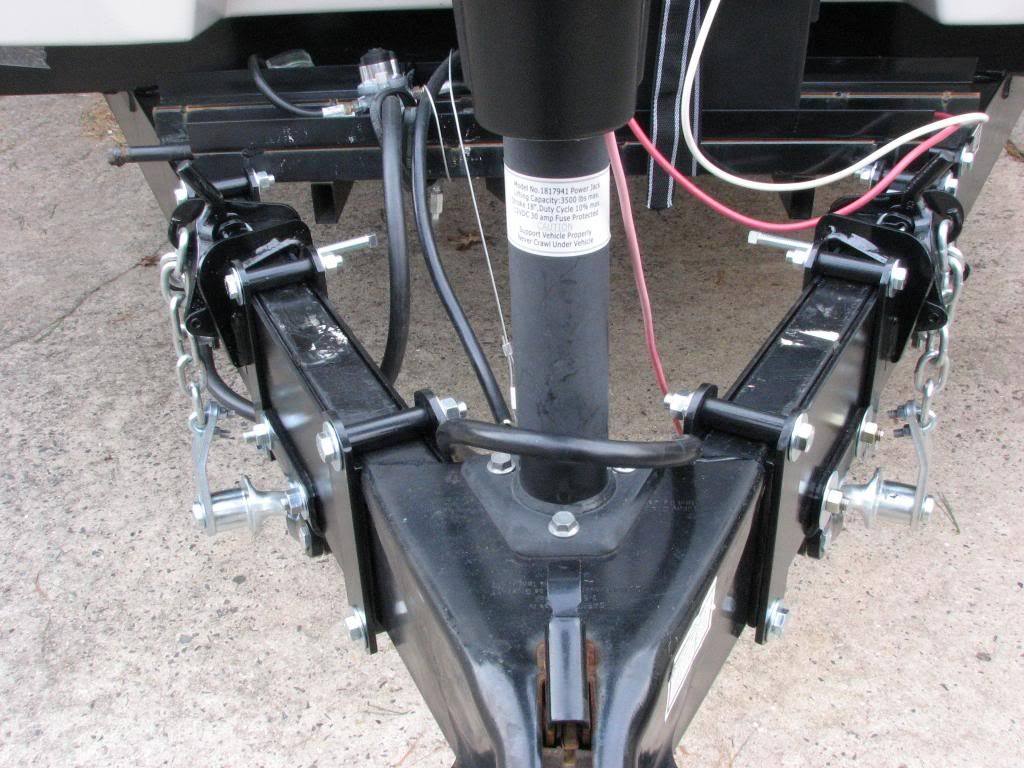

Okay so I think I got the WD hitch taken care of today. I used rivet nuts. After trying to locate the rivet nuts (July 22nd back order from Reese), trying to find an 11/16ths drill bit (couldn't find one, 5/8ths with a sloppy hand got it done) and finding the time to do it, its done. Took it down to the CAT scale and had it weighed. What do you guys think? It was weighed with 1/2 a tank of fuel and no passangers. Truck front 3980 lbs rear 3860 lbs for a total of 7,840 lbs. Trailer front 3580 lbs rear 3620 lbs. Truck with trailer steer axle 4000 lbs drive axle 4820 lbs trailer axles 7300 lbs total combination 16120 lbs.

It seems like you did pretty good with the WD setup. My understanding is you should return front axle to the same weight. You pretty much nailed it.
Does the trailer sit level on flat ground?
Also if you hit the scales again, get a 3rd ticket with the trailer hooked up, but the WD disconnected. You can compute the actual tongue weight from that....
I don't think the self tapping screws should ever be used on a tube frame, especially on a heavy trailer.
If you're trailer is heavy, you may want to look into securing the snap-ups too.
I also like the idea of somehow protecting tube frames from the pinch bolts digging in.
I also had problems with the DC self tappers in a tube frame. I created a no drill solution, but it was a lot of work.

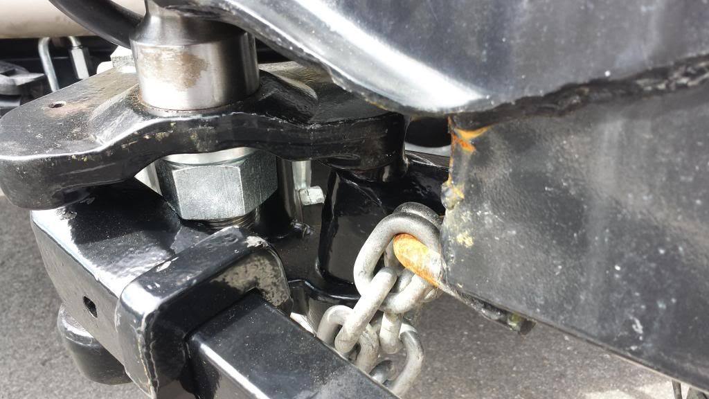

A good exercise to go through is to find an empty parking lot and go there with the trailer. Make left and right hand turns with frequent inspections as the angle between the EX and the trailer gets closer to 90 degrees and inspect for binding.
Some examples:
WD Bar/Ball Nut:
Clears:
Does not clear (Different hitch head):
Bar to frame: Clears Below
Friction Ball mount on passenger side - there's no fix, but it's good to have a feel for when you're getting close and to see if that's your limiting factor:
Of course, also watch for the bumper hitting the trailer, propane tank, frame and for the inside bar to be in a position to fall out (depending on the type of bars you have).
