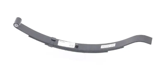

I said not to forget spring shackles for the rear, but I forgot about one option. When I did mine it was a fairly light duty trailer, so I got "slip springs". The front end bolts to the bracket and the other end rests under the frame with another bracket that keeps it from sliding off sideways. That makes it ride an inch or two lower than it would with shackles.

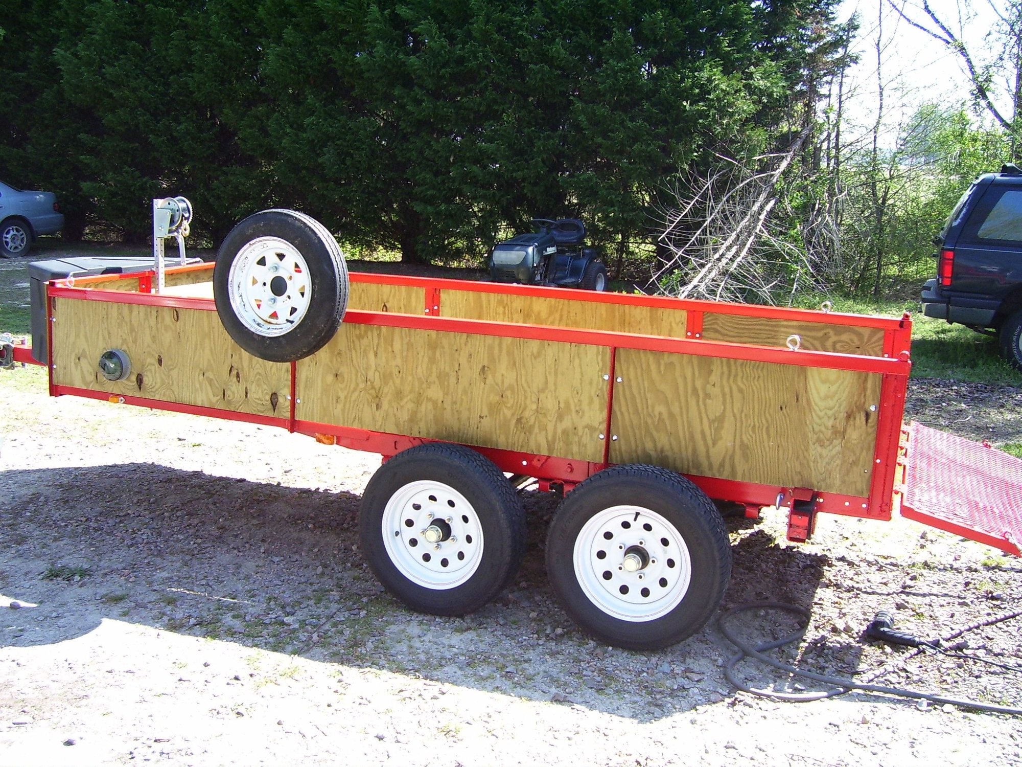

This was my old light duty utility trailer, before and after I cleaned it up repainted it and added a second axle.

The only thing with that slip spring that slip end has to slip on a harden surface or it can wear into the trailer frame.
Some take a old spring and mount it, weld as drilling spring steel is not happening, to the trailer for it to slip on.

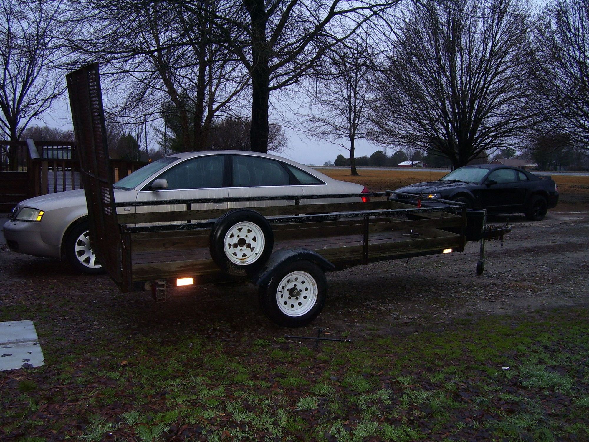

This is the way I did my slip springs. This was back in 2010 and I took a lot fewer pics, back then I had to go inside, get the camera, put fresh batteries in, and THEN take pics. Not like today where everyone has a cell phone with a high quality camera in their back pocket! But zoomed in, you can kinda see. I bolted a bracket to the frame which cages the spring from being able to slip out the side, plus lets it rest / rub against the bracket instead of the frame

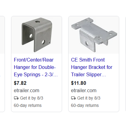

This is the kind of bracket I bought:

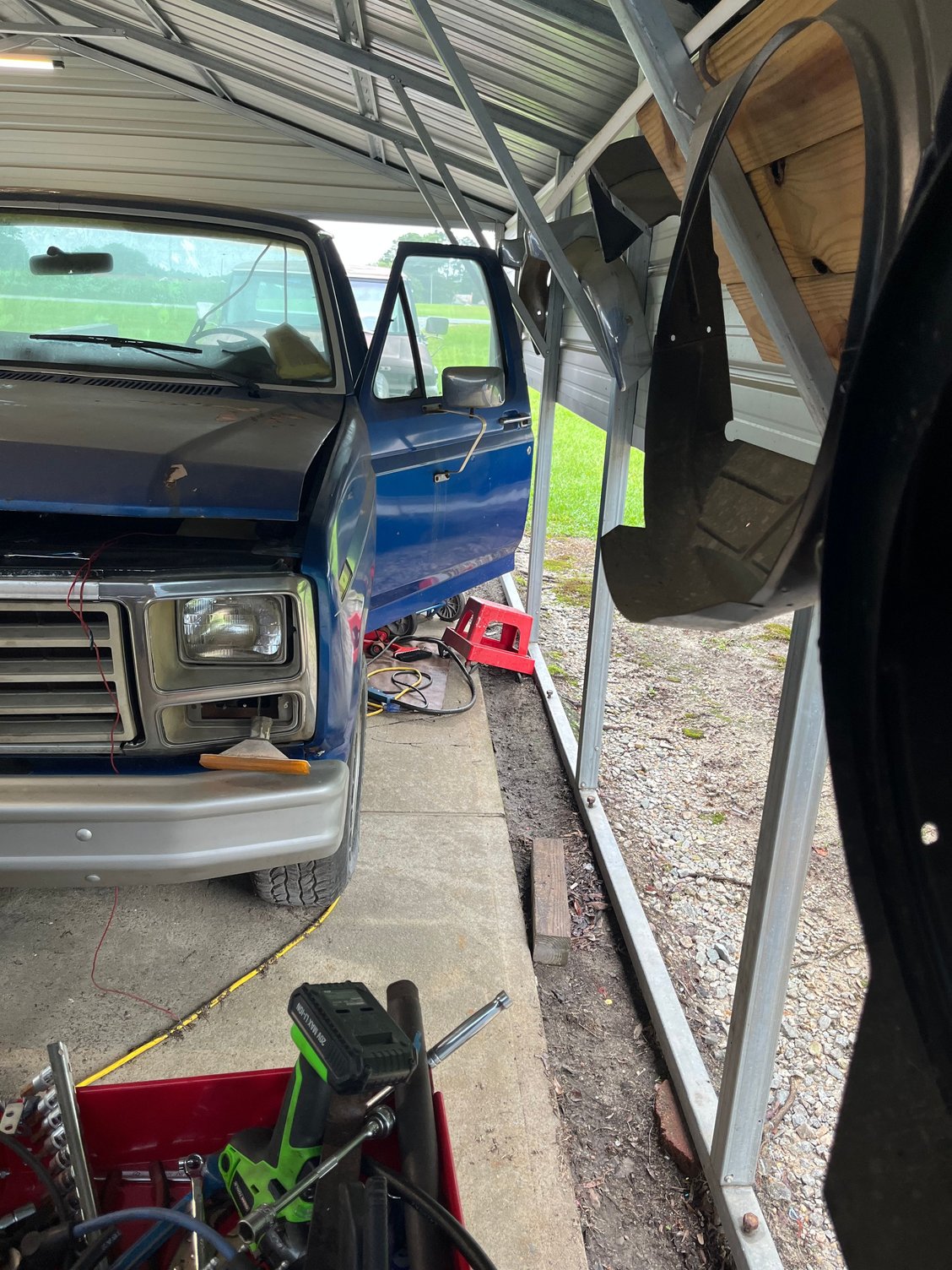

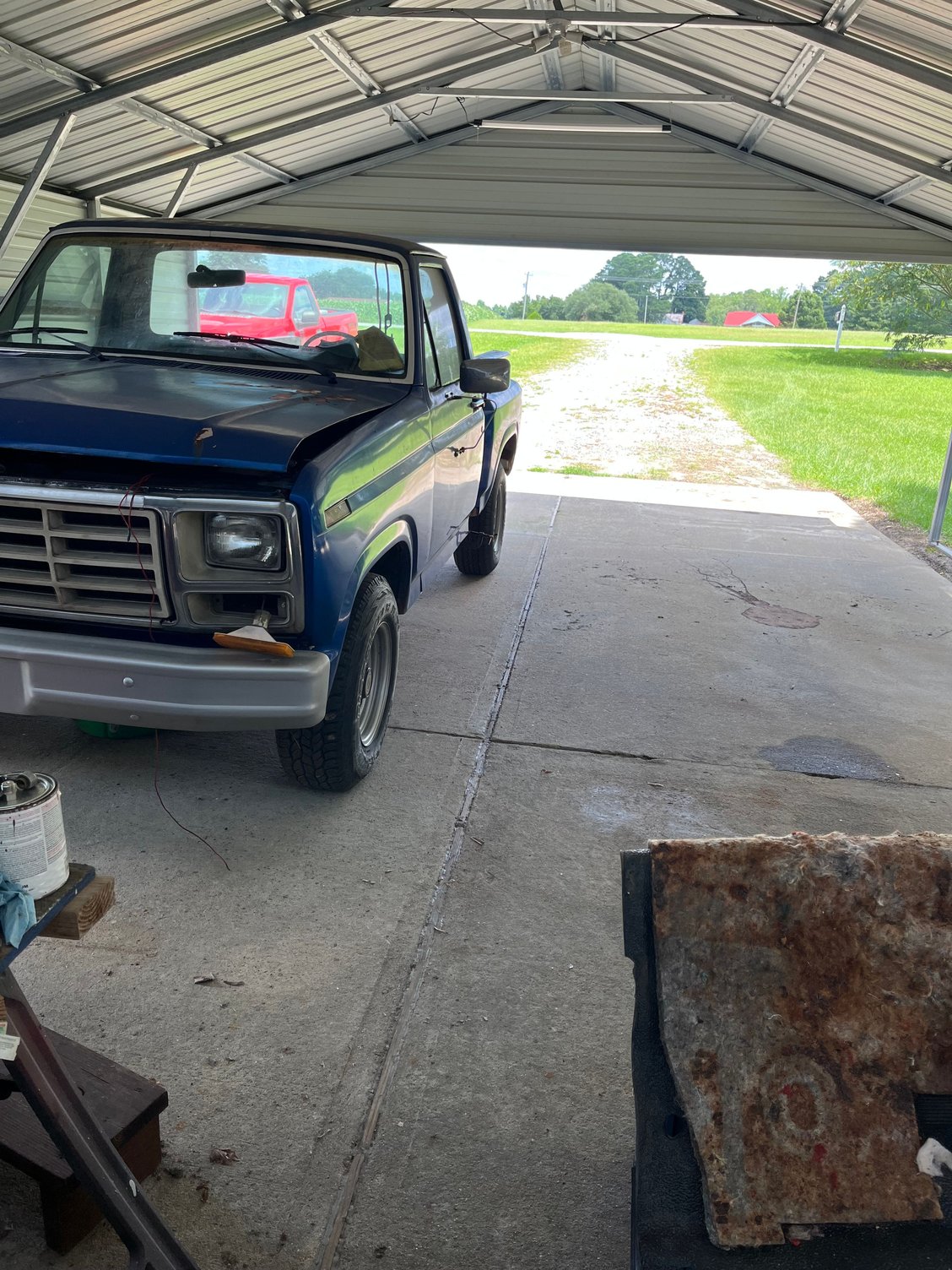

I even made some progress with the 83 pickup today, dang I have been avoiding doing anything with that cab corner and truthfully it's because so cramped, can't even open the door all the way, and my seat rolls off the cement which might not seem like much but it actually puts my back at such an angle compared to the legs that it will be like sitting bent over instead of sitting up straight. So I told Sherry me and her going to change carport sides for a week so that I can have better access to the drivers side. Was a pain in the a$$ to move the truck and the driveshaft that I use as a push-pull bar got into a bind and snapped a piece off, and also bent a grade 8 1/2-inch bolt, and it will still in too much of a bind to remove that I had to cut the dang thing! But having the truck on the other side really let me get in there and I did a lot of welding and sanding today. Another day or two and I'll be ready to put body filler and primer on it.

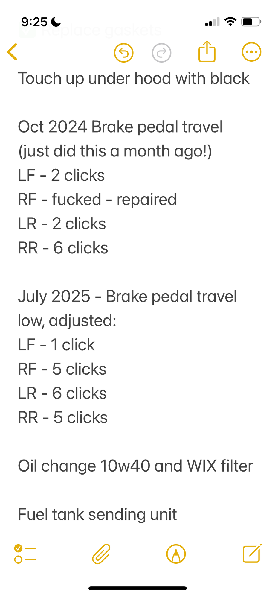

On the Mustang brakes they should not need adjusting that soon.
I believe they should be self-adjusting so when you back up and hit the brakes a few times if all is good they should adjust.
I also dont think 5 to 6 clicks is a lot. Next time you have them apart or of you have an adjuster handy turn it 6 clicks and see how much longer it gets, it's not much.

It doesn't seem my self adjusting brakes ever work properly. Although did I tell you about when I first bought this car in 1992? Brake pedal was very low. Tom (who I had just met for the first time) says try backing up and hitting the brakes. So I was in the street in my wife's old neighborhood in NY doing that. And Tom says "no no no.. can I drive?". I said ok.. He gets it stomps it backwards about 25mph then JAMS the brakes hard and it screetches a little bit as it stops. Does it again and it catches more. After 4 or 5 times you could feel the difference in pedal height. But even after that it would always pull to one side or the other, difficult to get all 4 to grip at the same time, and to keep it that way!

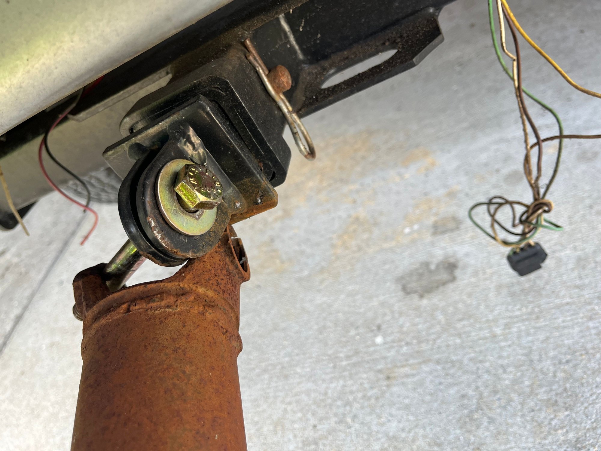

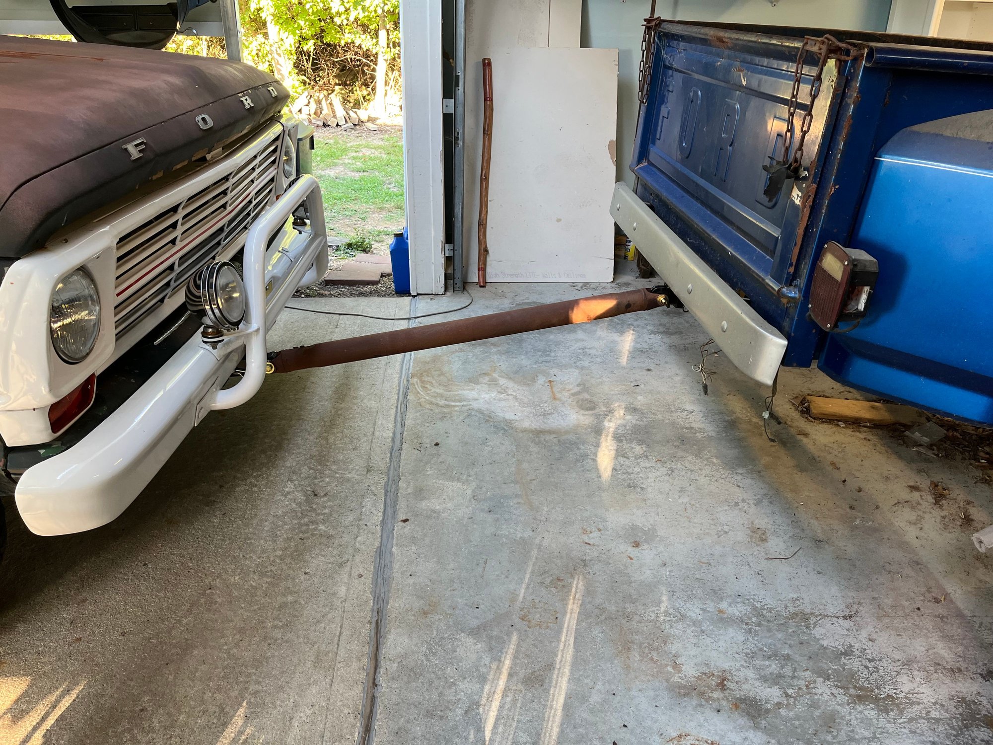

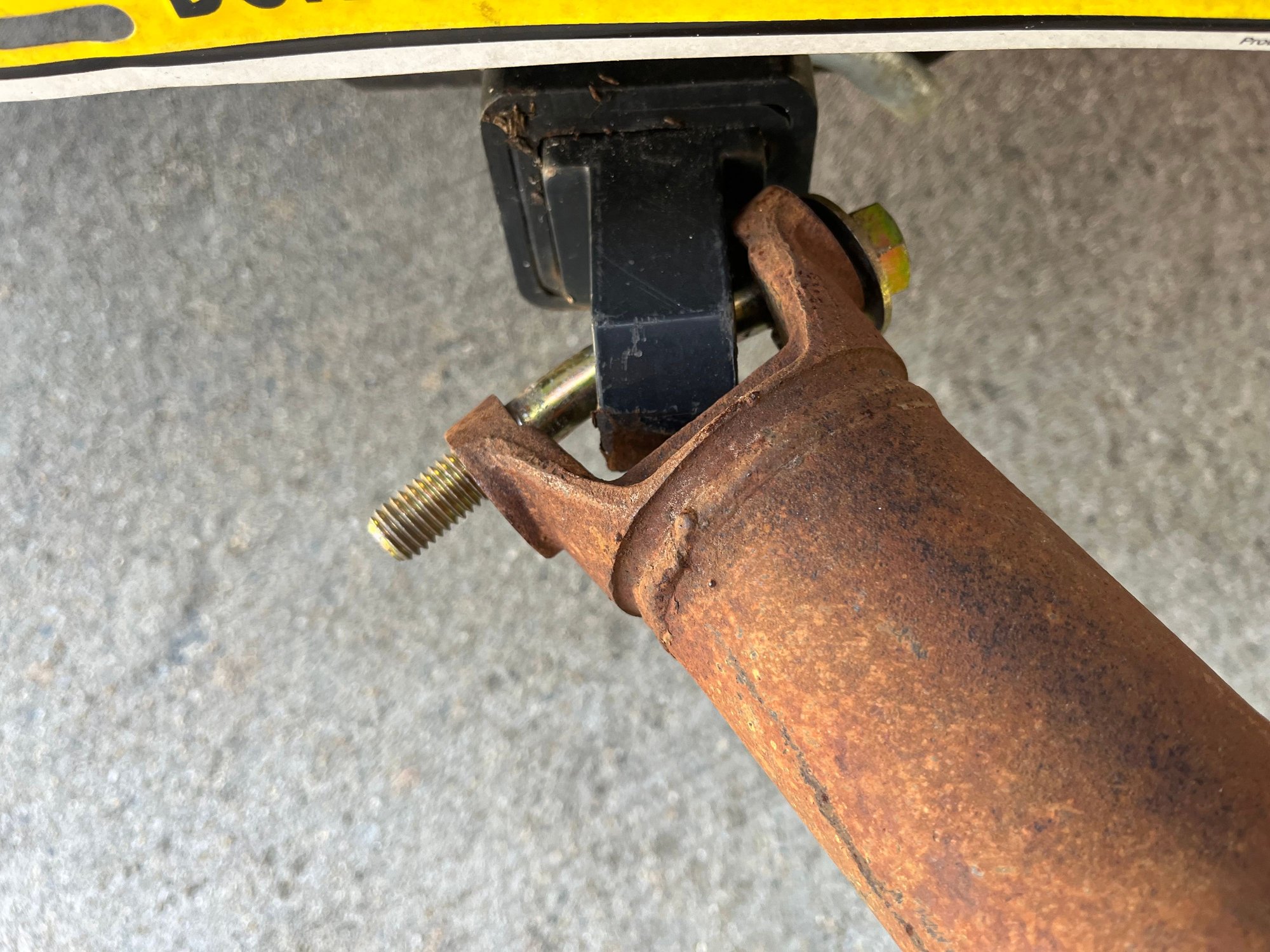

James I do not see any damage to either hitch, my old driveshaft was the weak point. Probably the old "chain inside a pipe" setup would be better. It's always worked fine for me to pull it straight back and push it straight back in but trying to turn & go to the other side of the carport didn't work very well, as the behind truck might be at a bad angle and there is no way to get it straight without taking the pole off and then lining up and trying again. Going forward is no problem you let the pushed truck steer the way and the pushing truck just try to stay approx in the middle. Just backwards is where I got myself discumbobulated.
This is what my pushy-me pulley-you setup looks like.
