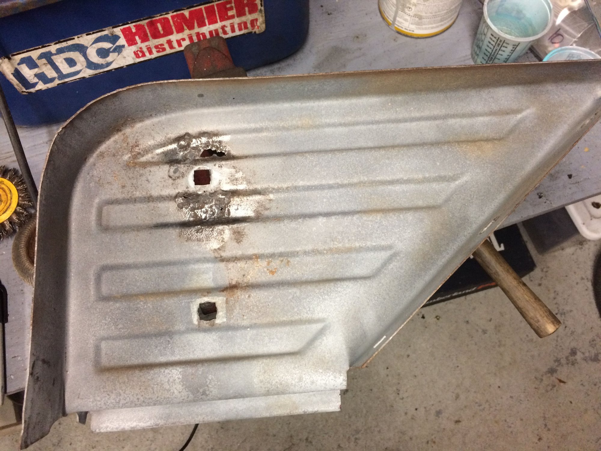

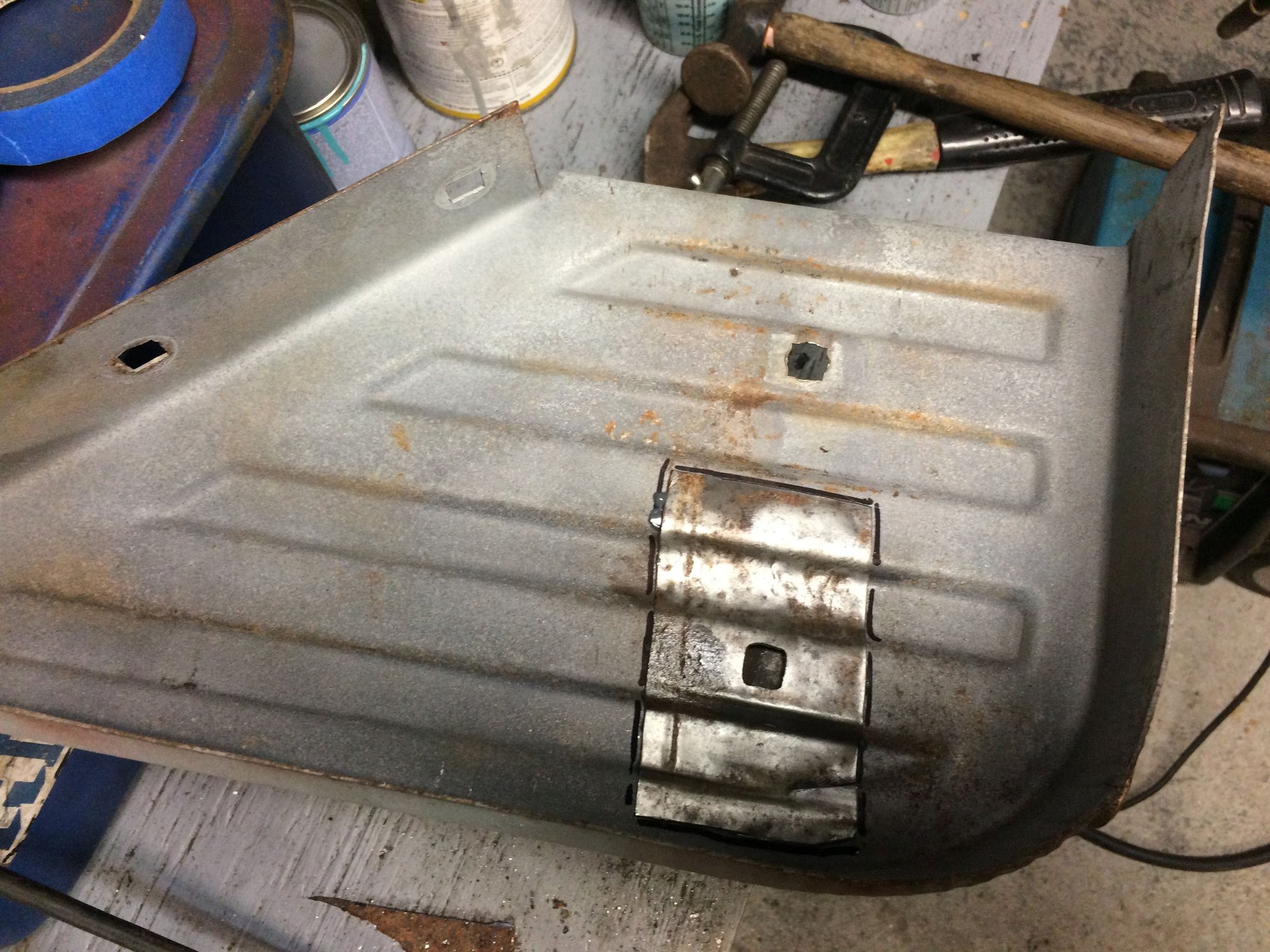

Well I see my message partially went through, without the last few pics. Oh well you have seen rusted stuff get welded together before I know!

John I was wondering what happened to the pictures but you are right rust is rust

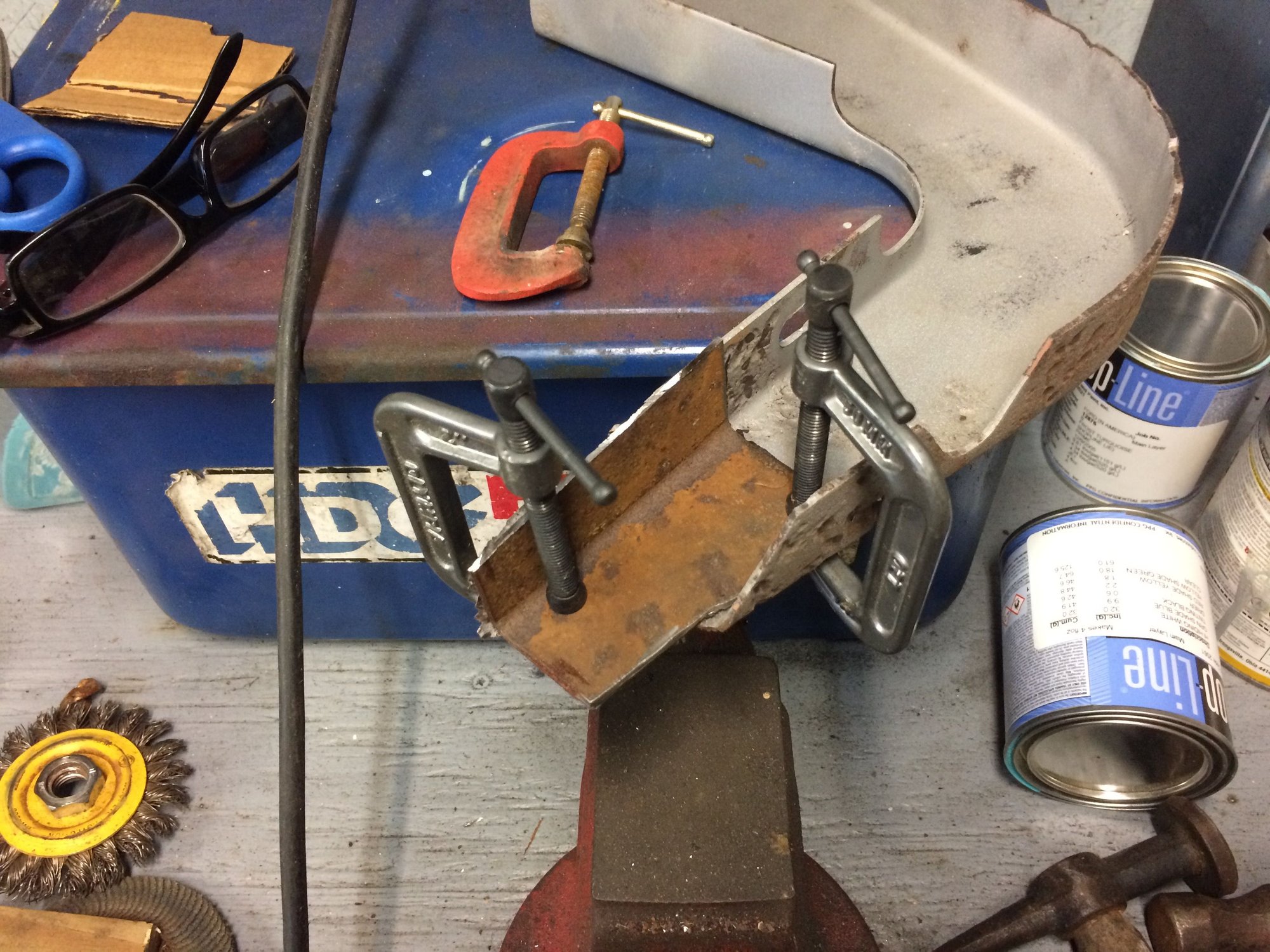

Here are the rest of the pics from my post yesterday.

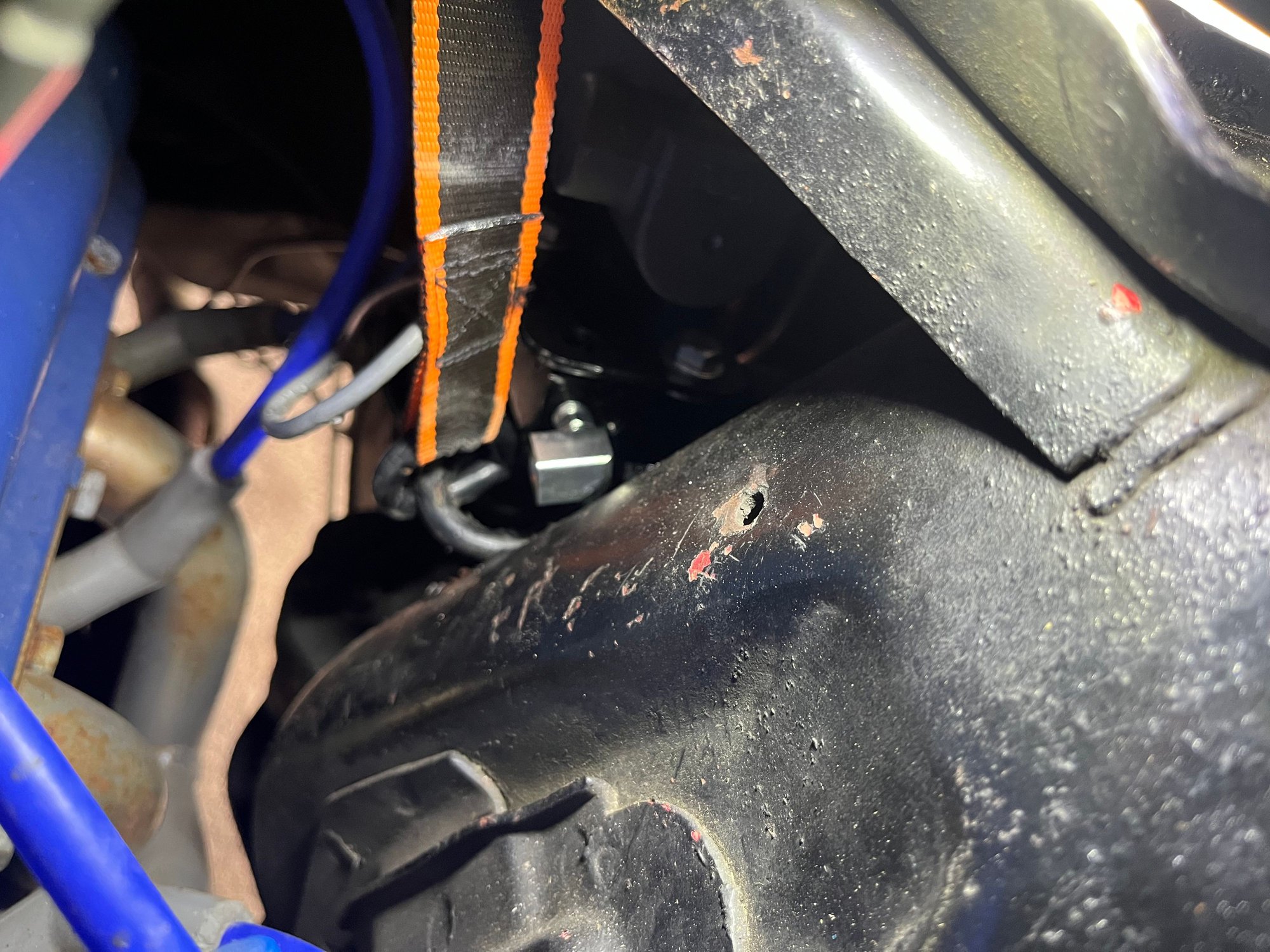

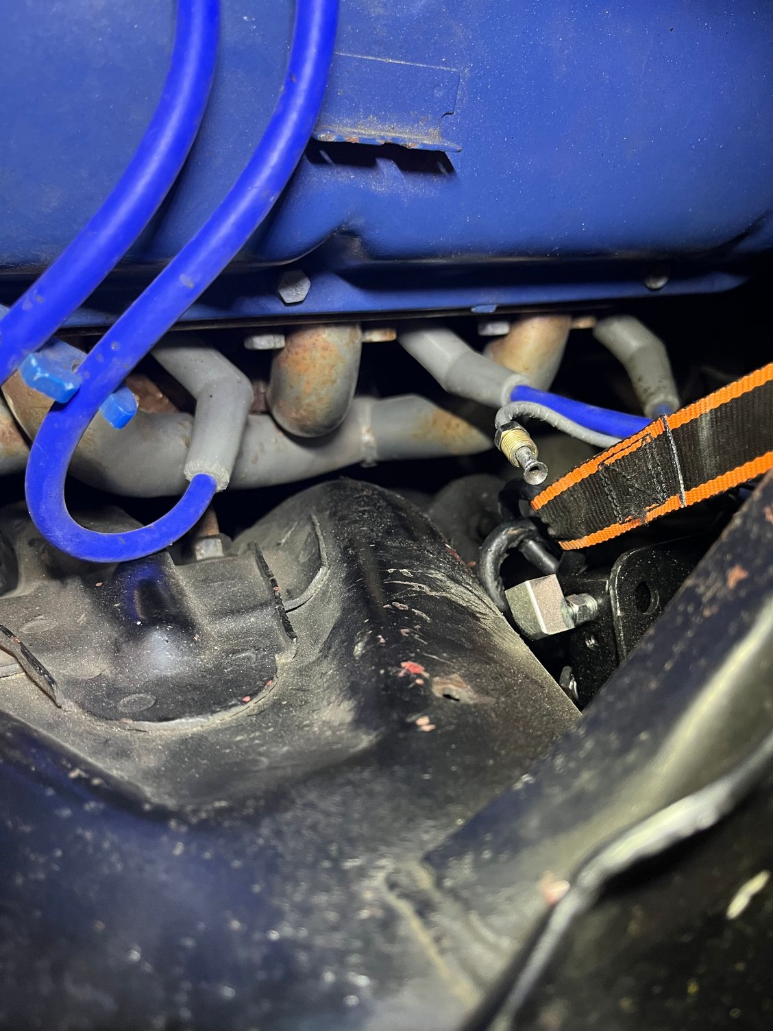

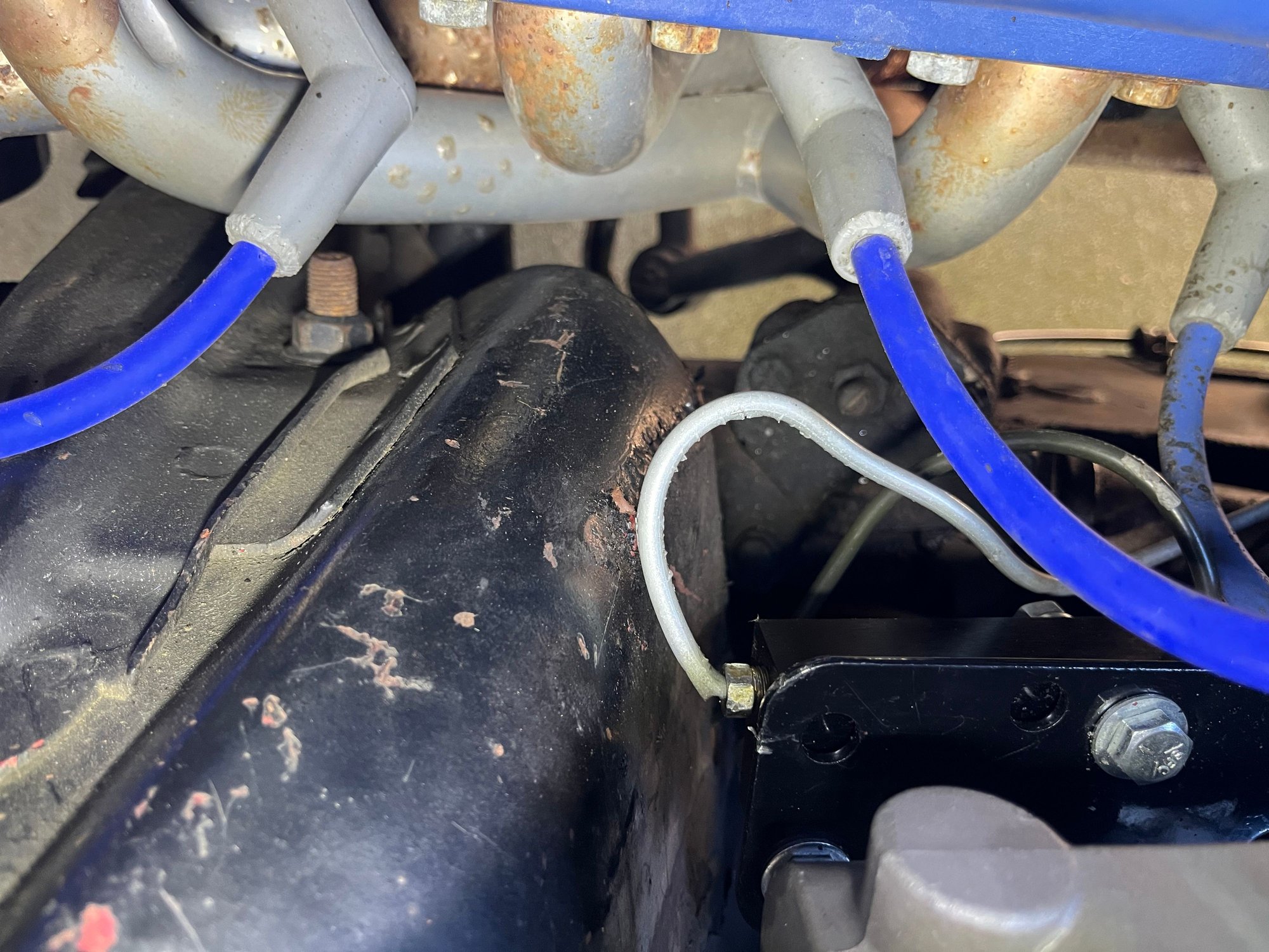

More work on the 66, the 90 degree fitting I was waiting for arrived Wednesday afternoon, but I didn't get a chance to work on it until Thursday afternoon.
I disconnected my master cylinder and the crimped brake line. It was a real bear to get out, I could only squeeze one side past the studs, and then twist it a good 45 degrees and use a flat tip screwdriver to force it past the other stud in order to gain enough room to adjust the pushrod from the booster. Given how difficult that was I didn't want to have to repeat the process, so I hope I turned it enough. I gave it about 3 full turns outward.
Here is a pic of that rear brake line from a different angle, you can see its definitely not in a comfortable position.
Here is a pic of that rear brake line from a different angle, you can see it's definitely not in a comfortable position.
In order to give myself as much working room as possible I cinched the whole master & bracket & proportioning valve up together (it's in place, but with the nuts loosely started so as to allow as much movement as is reasonable).
I ground down the corner of my 90 degree piece, just to give as much clearance as possible, and was able to get it started easily.
My tubing cutter was too big to get in this cramped space, I know Fuzz had a small one but he was out of town! I got in there with a cutoff wheel and chopped off the end, then I used my brake flaring block backwards for a flat edge and smoothed it off with the sanding disc. That kept it straight and flat, cleaned up put my fitting on and made a nice pretty flare.
Connected line with new flare to my new degree block and everything looks good. The only issue is the fitting to the proportioning valve doesn't have enough space to fit in a flare wrench, so all you can do is use a regular open end wrench to tighten it. But I did the best I could and haven't detected any leaks yet (knock on wood).
Now I just need to bleed the brakes again because I don't have much pedal.
