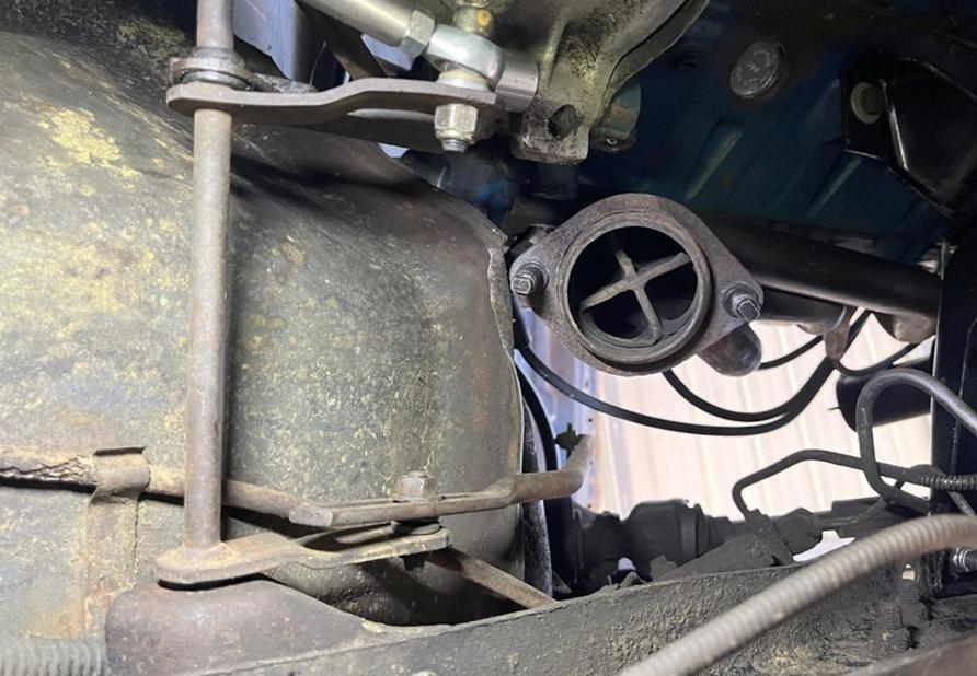

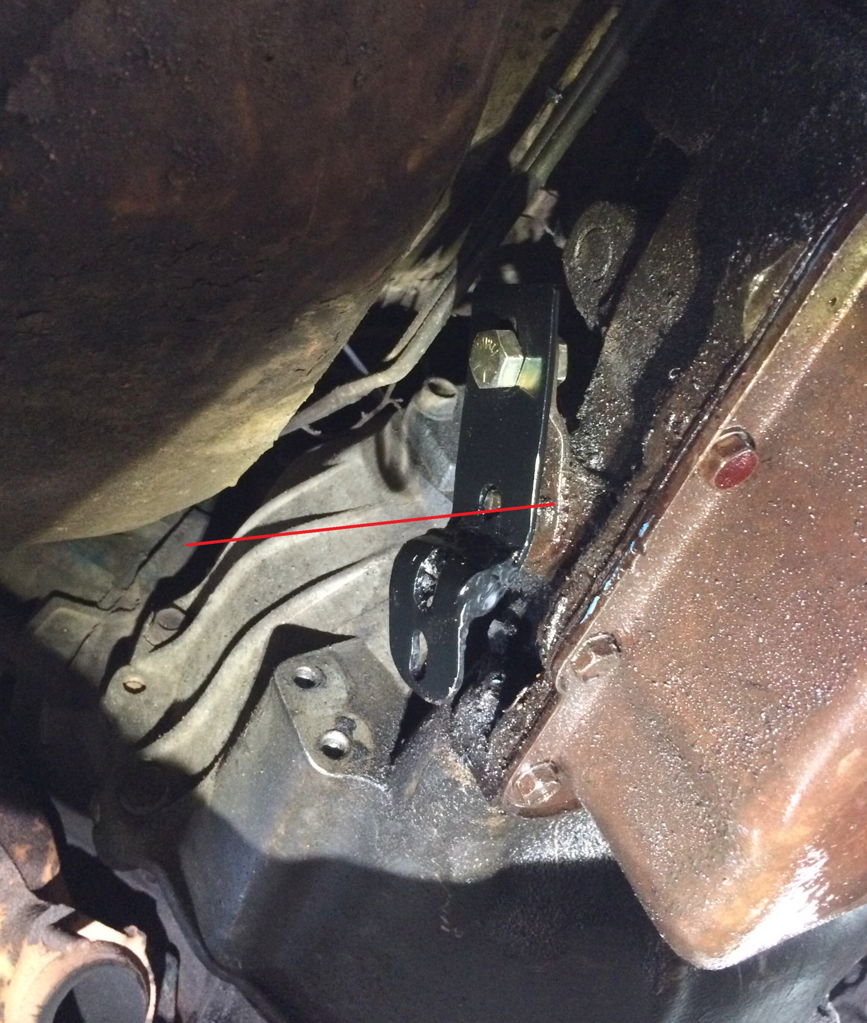

The arm of this bracket connects to the linkage coming down the firewall from the column. Looks to me like it's been bent inwards, and if I could straighten it out then everything would look better and work smoother. But that is thick metal and I'm not sure how to go about it.
Is it removable? Some heat cycles a BFH and an anvil? That should move it. Never mind. I see the line you drew now.
What about a plastic spacer? Or more washers. Or an extra bolt on the "line" side?

When you posted what that part was called if looking for it, it reminds me of the ones I seen for GM ALT to adjust the belt tension.
On the "bent" bracket I would think once removed and in a vice a little hammer should get it back into shape.
It also looks like the adjuster is close to the other rod? or whatever it is can you bend out the bracket in the upper left corner of picture to give more room between them and it would put the adjuster more inline than at a angle.

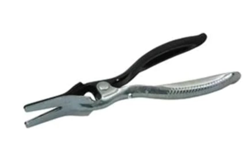

Dave, will a hose remover tool fit in there? I have one like this and it has saved me a couple of times. I will be happy to bring it by.
I should have made it clear, but I wanted to straighten it without having to take it all apart and remove it. I got a monkey wrench which was a very awkward fit because I had to go sideways instead of lengthways, but I got a little grip on it and twisted it downwards a tad. All in all maybe 1/2 inch which isn't perfect but it does look a little better and little more "in line" now. And I think I have a nice space to get the exhaust through there.

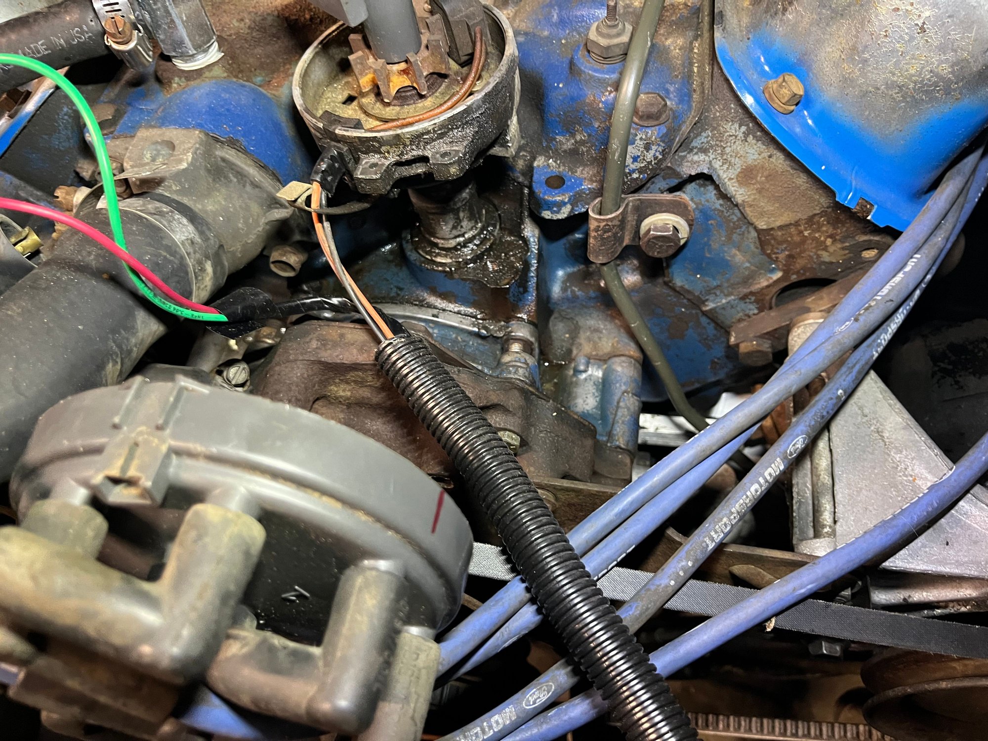

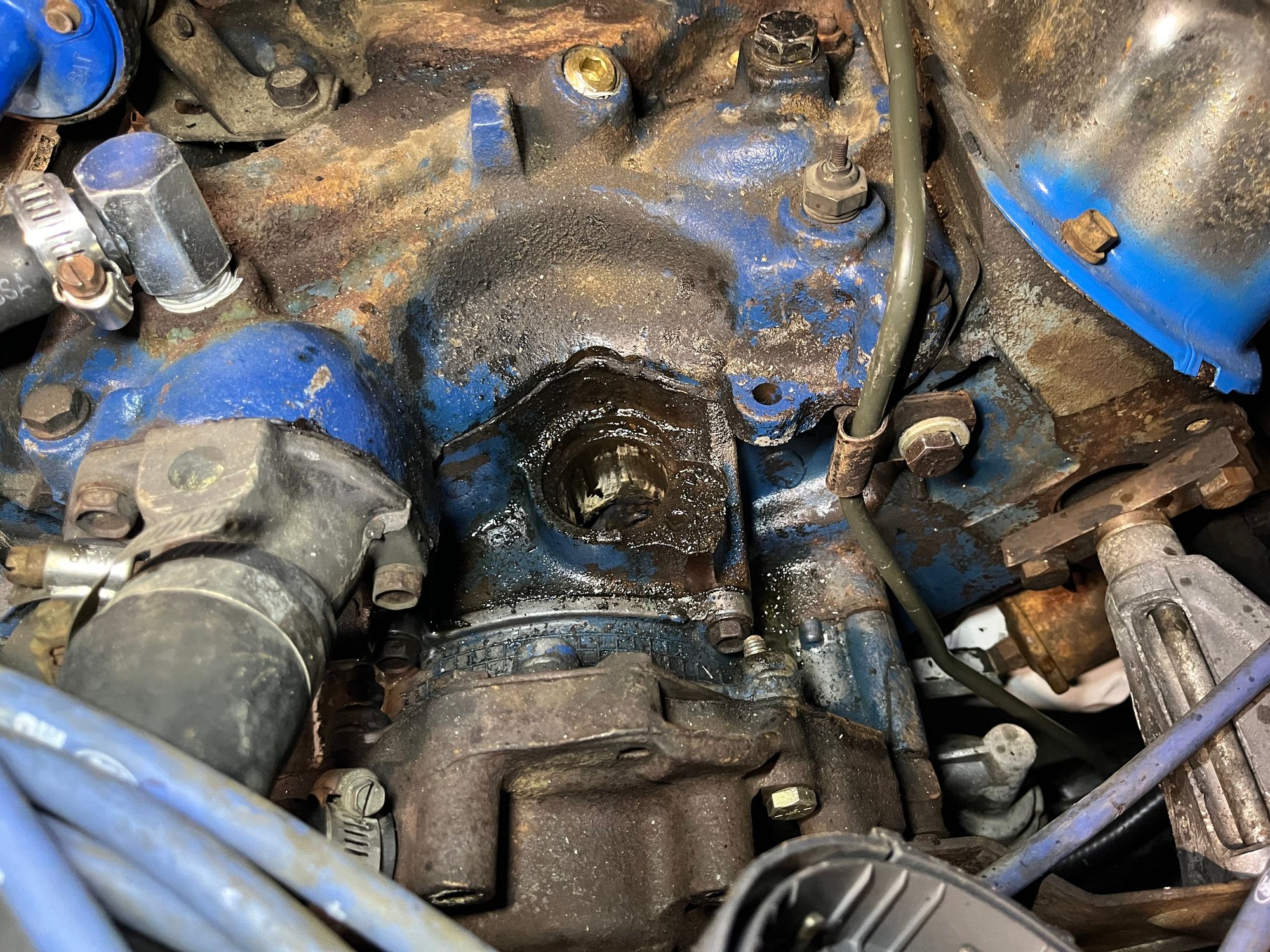

When I got home from dinner last night I took a few minutes to pull the old distributor, but that did not go as planned - it was frozen in place. So I sprayed it all down with penetrating oil and went to take my nap because I had to work later. So throughout the night any time I'd get a few minutes I would go mess with it. I took off the vacuum advance module so I could tap it with a hammer to get it to turn, but what I realized was happening was that the top was turning but not the base!
I fought that quite a bit, it was 4:30am before I got it out. I put a propane torch around the base to heat it up, sprayed it all again and let it soak, then used a pry bar on the left side while tapping upwards with a hammer on the right side. Eventually she eased upwards and revealed her grody hole.
After that, a little cleanup then stab the new one in, of course having to pull it out at least once to reinstall "one tooth over" to get the best line up. But she's in there now. Ugly yes, but should work. They don't provide a pigtail so it looks like I've got to go to Autozone or O'Reilly before I attempt to fire it.

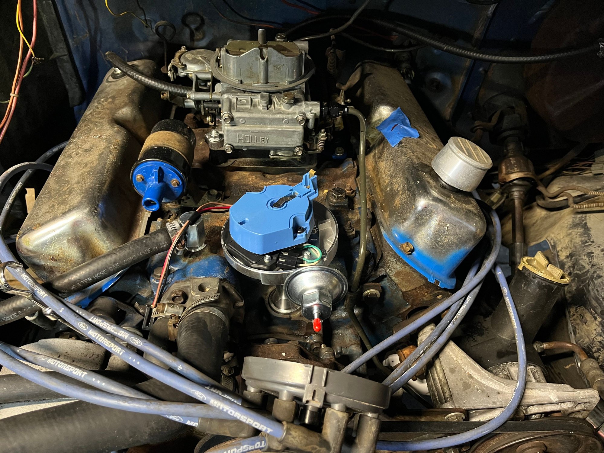

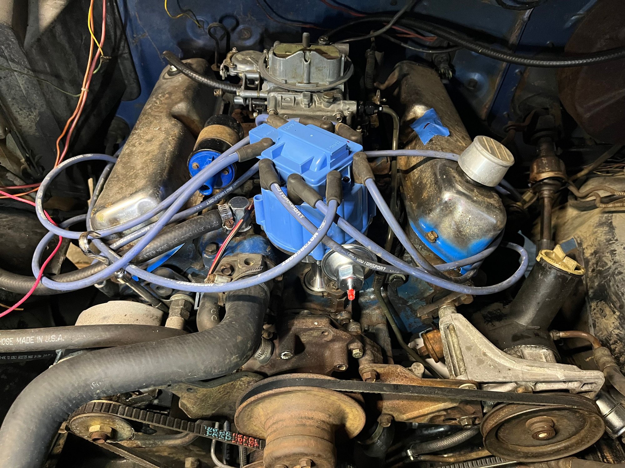

This gave me another chance to verify my wiring order, so it should be correct!

Well I did the 351w fire up today!
First attempt netted a couple of coughs like it wanted to fire, but nothing more. Tom was swinging the distributor wildly with a huge range of timing, I felt like it was pretty close where I had it at the start and should have just moved it a little back and forth to find the sweet spot.
Shut off the camera to work on the fuel leak, but had no luck stopping it. During a test fire with camera off the truck lurched forward a little. It was still connected to my 69 F100 at the back via the shaft I use when I pull it out & push it back in so it couldn't go anywhere, thank goodness. But that proves the shifter linkage is backwards, this happens often when you swap a car transmission into a truck (or vice versa). The car has the linkage above the rotating lever which is for a console shifter, and a truck has the linkage below the rotating lever which is for a column shift. I remember on the AOD I put in the Mazdaratti I had to remove the pan & filter to get in there, then remove the thing to get to the other thingy, slide it out, turn it over, then slide it back in (obviously put a new rubber o-ring on it while you're that far in). But in this case, now I know, all the way down to Low 1 position means park!
Even though we couldn't solve the fuel leak we decided to just run the pump until the float bowls were full then shut it off, so the leak would stop and then run it on the gas that was in the float bowls.

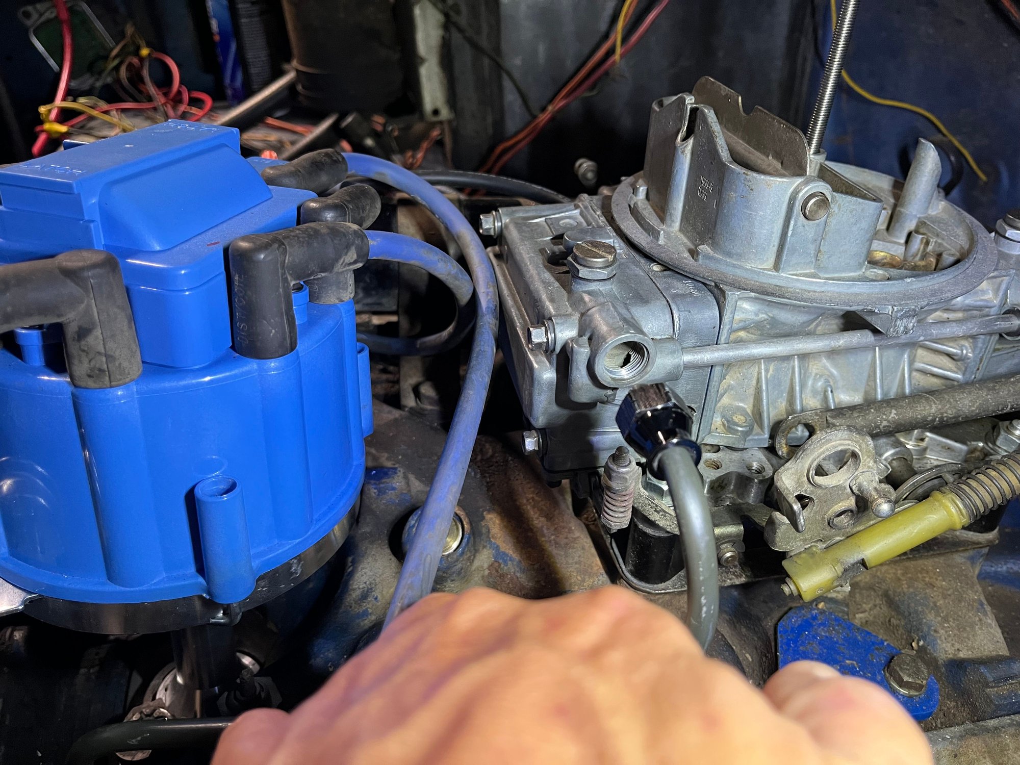

So this is what I found since the video. I took the fitting off thinking I can zoom in with my camera for a pic and find a hairline crack, but instead I found I have completely the wrong fitting. The previous had 3/8 inverted flare threaded in there so I just went back with similar connector, but that was wrong. It's not supposed to seat against the bottom and seal like a flare, and it's not supposed to seal via the threads like NPT, but supposed to seal against the surface with like a flange type fitting. So I've just got to verify the thread size and count and order the right one, there's a hundred different options and they're all like 16 or 20 bucks each so I don't want to get the wrong one if I can avoid it.
About the trans linkage, yes you can flip it around, but since Ford hates us they decided to make it to where you have to drop the pan and release it from the inside, then flip it around and reinsert it. This is what I did on my other old truck several years ago, to avoid the effort of re-clocking the shifter arm. I took a piece of gate bracket from Lowes and cut & bent it the way I wanted, then attached to the arm. So the red line indicates the pivot point, so then instead of mounting the linkage to the top and rotating it backwards I could mount it to the homemade gate bracket below the pivot point and have it rotate correctly.

Seems like an easy fix to get a new connector for the fuel issue. I couldn't see it leaking from the fitting on the video. Just saw it dripping from the bottom.

On that gas leak let me go thru my Holley parts and pit box to see what I got as I think I got a fitting and gaskets.
Yes that uses 2 flat gaskets and a banjo type fitting & bolt or 1 gasket and the inverted flare fitting but let me look.

I was happy I had the right fitting for the carb and was able to get a leak free gas line to the carb now.

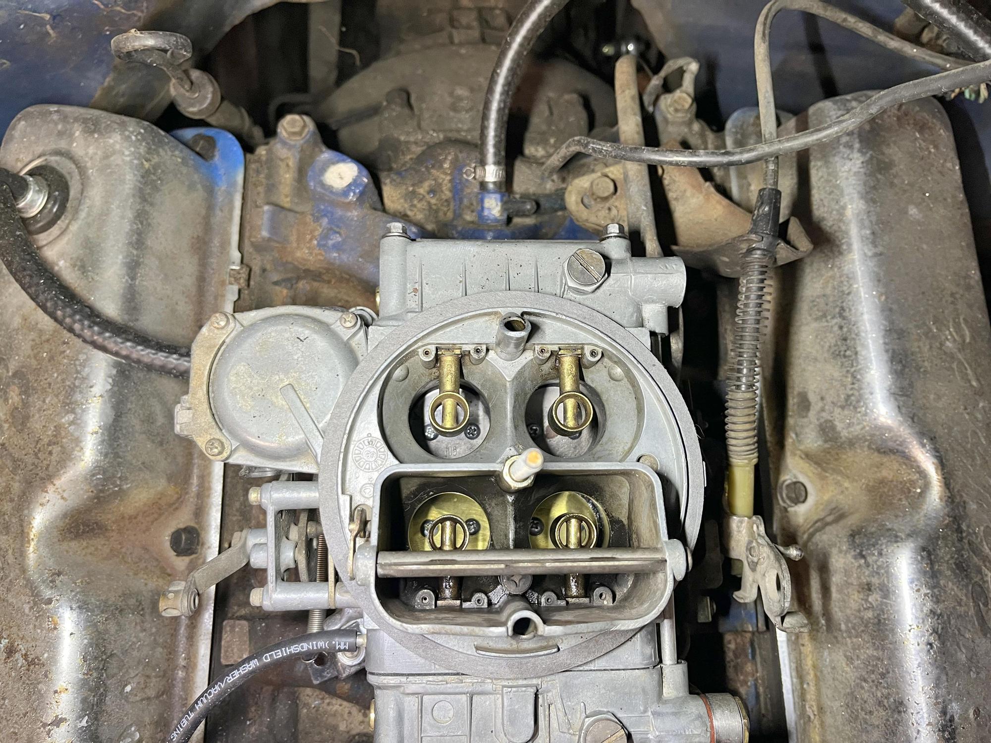

Forgot to say, about the door latch not working from the outside. That, and the front headlight trim coming loose, all that happened when I was underneath with the air chisel for all that time trying to drive those rivets out. It vibrated the truck so much everything was falling apart. Sh-t fell on the floor from under the dash, etc.
Ok look at this pic, it's scary. It looks like one throttle blade is askew with a screw missing! That would explain all of this. Now, where is the screw? I need to pull the carb off and see what is going on.
