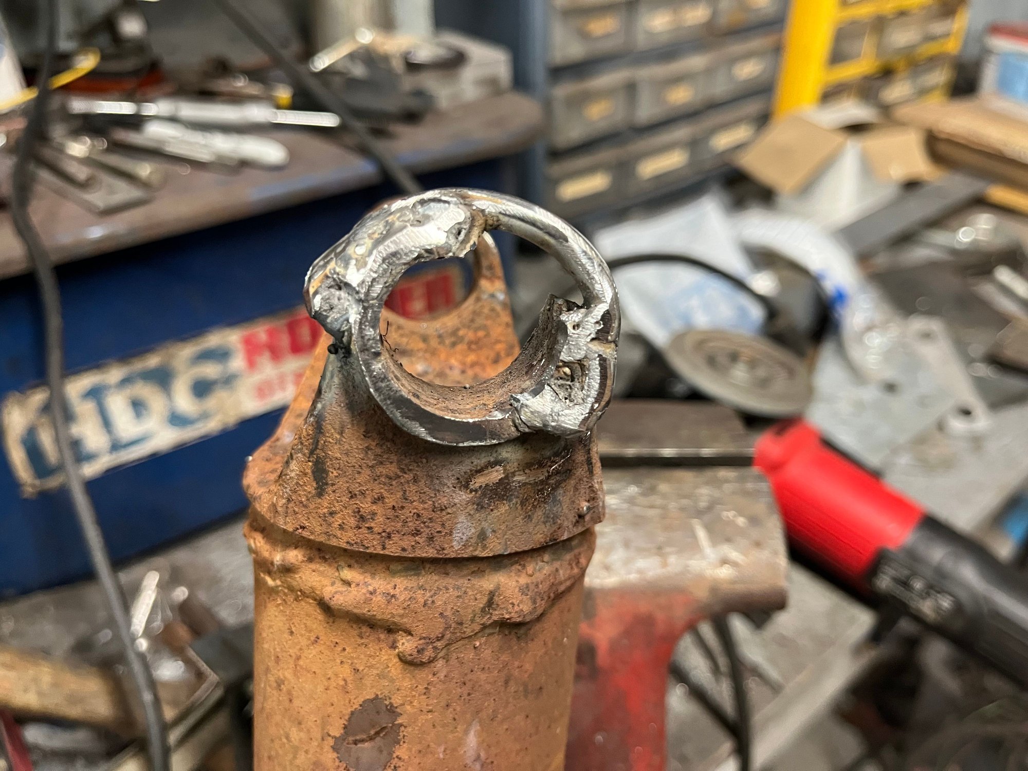

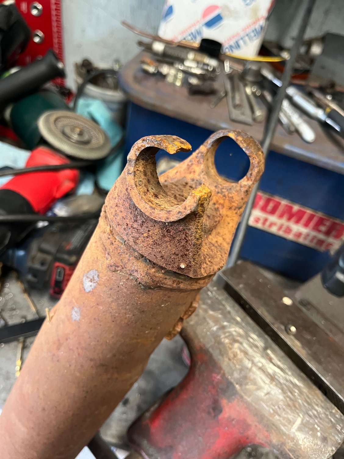

Made some repairs to my push-pull bar that I use on the project truck, when it got into a bind it snapped a chunk out of the loop. So I went through my pile of brackets and scraps and found something to jury-rig it.
Good as new! LOL
Good as new! LOL

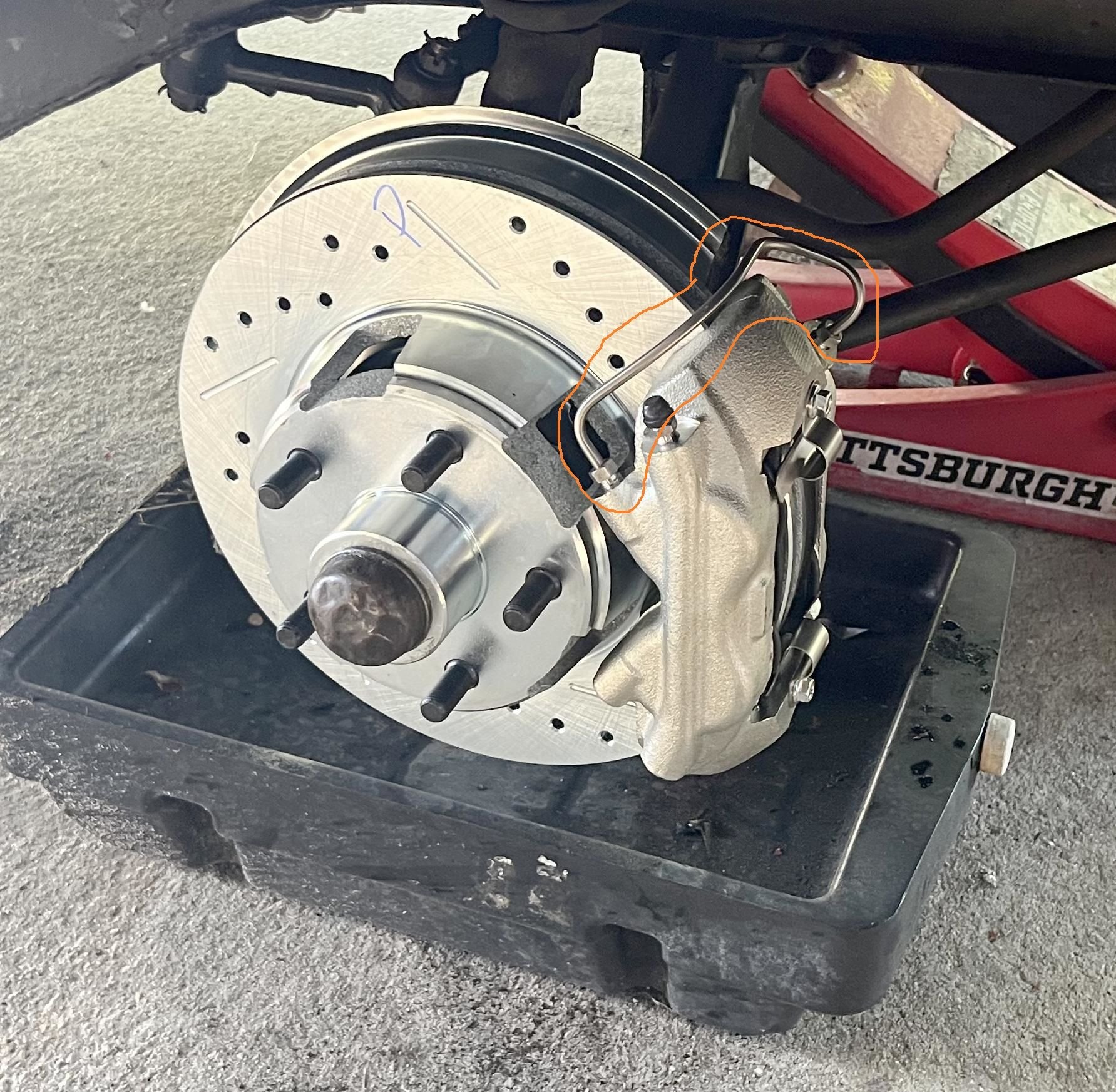

Here's how I bleed my airplane brake system, start at the caliper connecting this bleeder & bleeder adapter on the caliper bleeder, crack a line going to the master cylinder, open the caliper bleeder & pressurize the caliper with brake fluid until the air stops coming out of the cracked line at the master cylinder.

I can see where that line on the caliper could trap air.
What if you were to crack the line at the outer part of the caliper to see if that will help.
Only other thing I can think of would be to remove the caliper one at a time, stuff something between the pads, and then tilt the caliper to help get the air out.
If the factory calipers had that line I dont remember having that much trouble bleeding them on a 68 GT fast back I had when I replaced them but that was 100 year ago LOL
Bill
How dose that seal the bleeder threads to the bleeder as I have seen the threads bleed air when you use a suction type bleeder tool on the bleeders.
Then again I guess if you are pushing fluid from the bleeder to the master leaking bleeder threads is not a big deal other than making a mess from them leaking.
I say this because I have used a suction type bleeder that uses shop air to create the vacuum and it looked like it always had air because of the leaking threads.
John
I thought you had a bleeder bottle that hooked to the bleeder that Norm brought?
Have you given that a try yet? I have a Motive pressure new in box if you think that would work.
It has a bottle you fill with fluid and a plate you chain to the master. You pump up the bottle with the hand pump in the bottle and that pressurizes the full system.
You then crack each bleeder like normal farthest to close getting the air out.

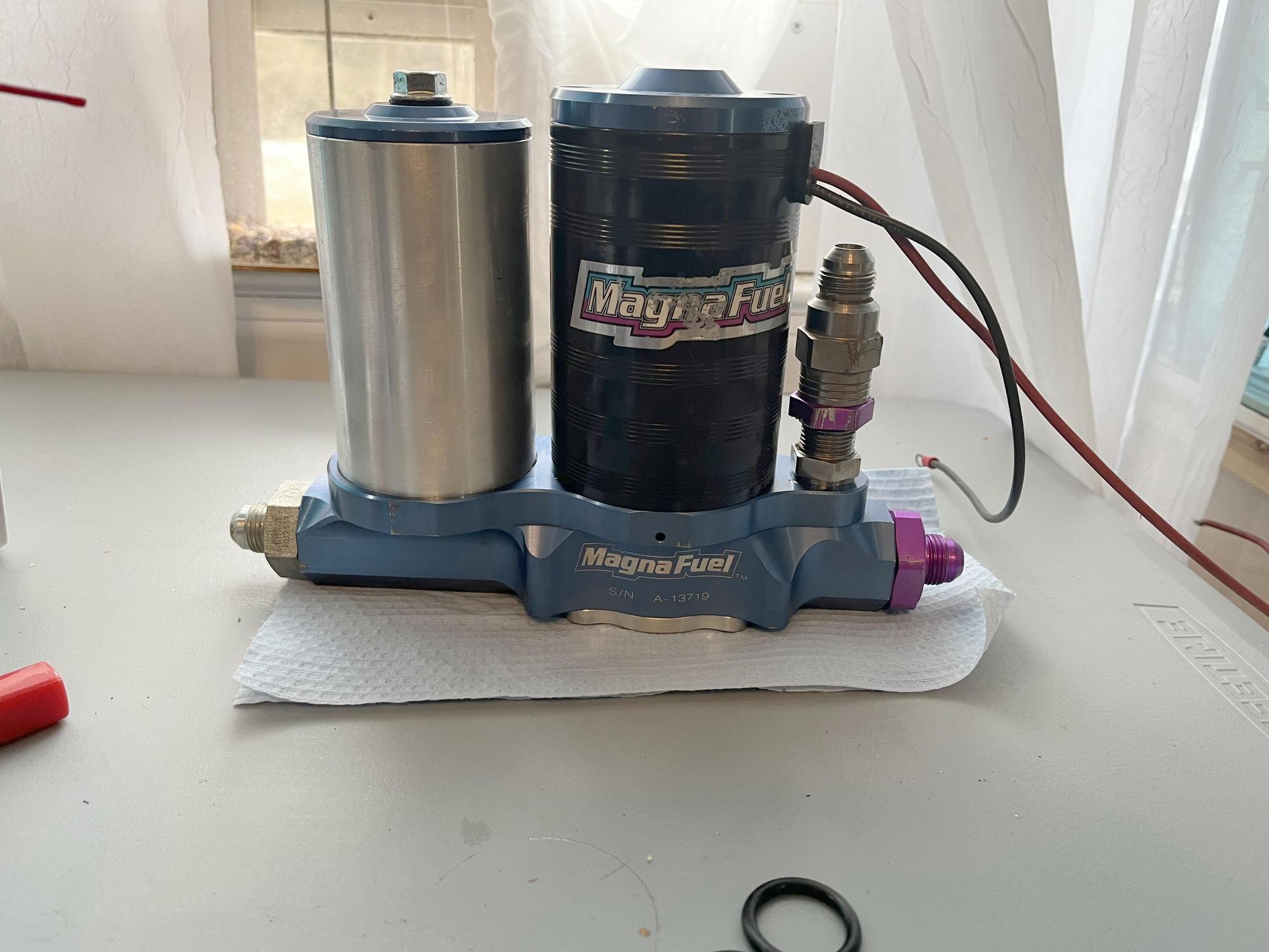

Bill, the fuel pump is a magnafuel and there are no other pumps in the system besides this one. I rebuilt it in January, it had started to drip / leak and I read that was an indication of the seal going bad. I drove the car a few times in January and Feb and March but it's been parked since then.
I'm looking at your setup, interesting. But I don't have anything like that. It's a hand pumped tank that pushes fluid backwards through the bleeder right. But why crack a line, why not just let it go backwards into the reservoir and watch until no more bubbles?
