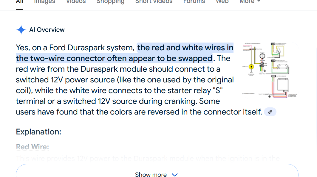

This AI thingy I found on google seems to be saying that inside the connector housing the wires may be flip flopped, so that in reality red goes to red and white goes to white?

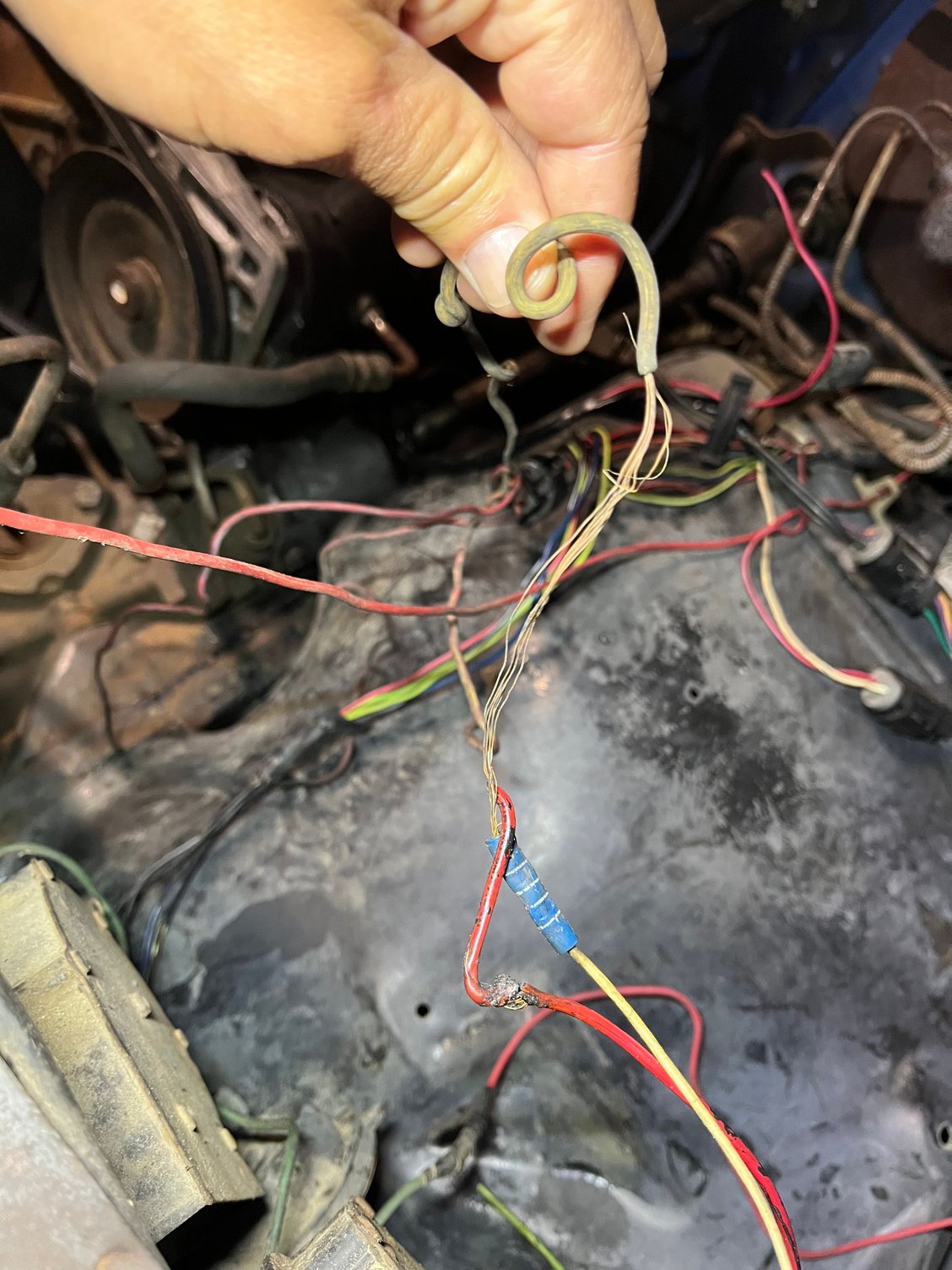

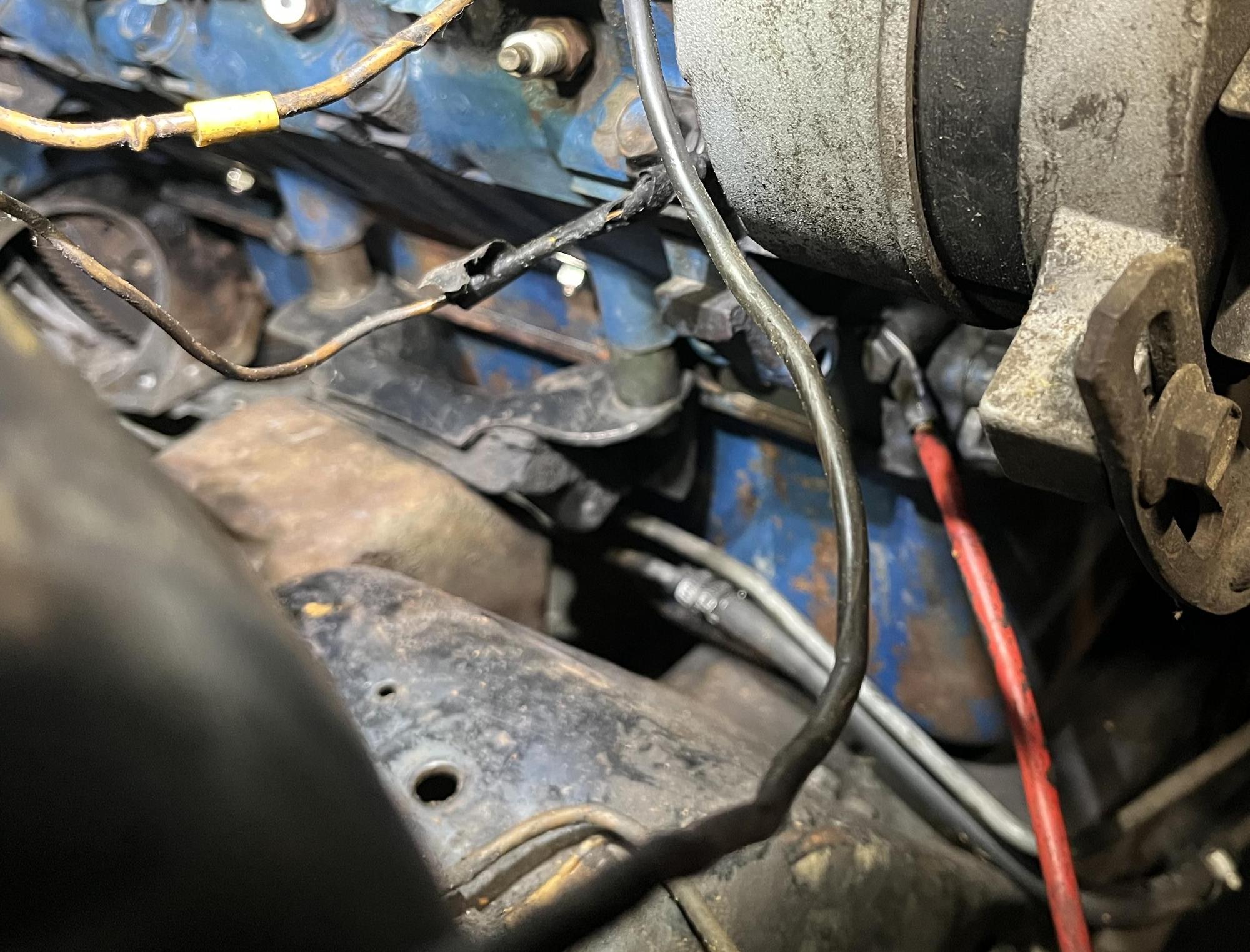

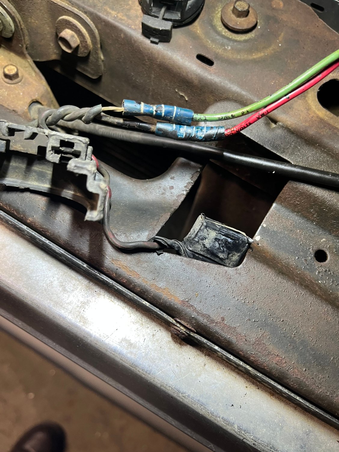

Whoever started building this truck, wiring was not his strong suit. Here are a few of my favorites. He definitely liked to skin wire and leave it exposed.

Holly **** cant believe it did not catch fire.
I can see why you said the harness needs to be replaced

The 3 inches of open skinned exposed wire coming off the back of the alternator has gotta be the worst.

That wiring was a short waiting to happen to let the magic smoke out!
I have seen some use wire nuts that were done better than what that truck was done.

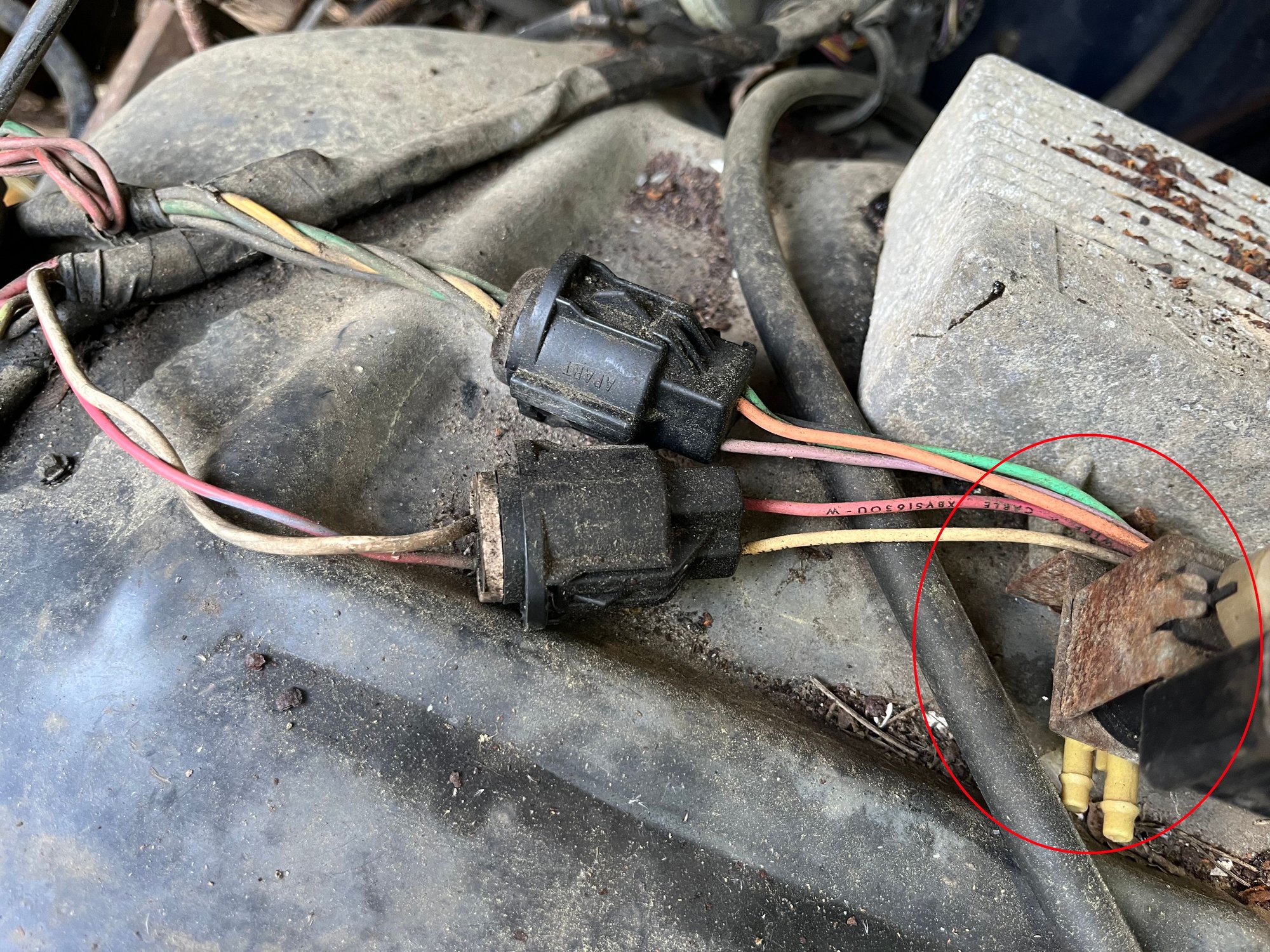

Duraspark question. First off, I think mine is bad, when I hot wired it it acted like a short (spark at the alligator clamp I used on the battery) and had a high pitched whistle or whine coming from the unit. I disconnected the coil to see if that was the problem and it wasn't, so I disconnected the red/white connector from the ignition module and the short went away.
Now I google for "Ford Duraspark Ignition Module" and find many options and many prices. Some as low as $24 some as high as $75. If I go to Advance Auto website or Autozone website and put in a vehicle (tried 1981 F100 4.9, 1982 F100 5.0, 1983 F250 5.8, and 1979 LTD 5.8) I get only the more expensive ones that are $65 and over. I kinda though they are all basically the same, why are there so many different part numbers and prices?
I believe the motor is a 79 so I'd guess the distributor is also a 79, I imagine my best bet would be to get an ignition module to match that. But is there any reason I can't just order a cheap one off Amazon that is more or less a general fit for a wide range of years?
No markings or part numbers, any label that was on it is long gone

On the ICM if the truck was running and used as a DD I would say you get what you pay for so spend the money but in this case yes you can get a cheap one.
Get for what ever your you want the only thing you have to worry about is the wire relief color, I see that is blue.
It also dose not have to be from a truck it can be from a car or van too.
What dose the other truck have or being a feed back it might be installed in the distributor and cant be used.
Maybe a junk yard will have one? Look at 75 to 86 cars / trucks / vans.
Now 83> the 300 motor went feedback so that one will not work. Any EFI will also not work but I think the 460 trucks still had the box on the fender.
87 everything went EFI so no need to look at anything newer.

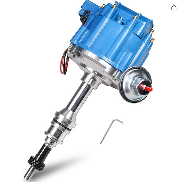

I know they get a lot of hate on the Ford pages but I am just going to get the cheap HEI distributor. 67 bucks, ugly as sin, but should work fine for this and I can always replace it later on down the road. If I buy an ignition module, there's no guarantee the distributor is good, so I might also end up having to replace as well. This way instead I replace everything at once and just have 1 wire to hook up.

For $70 bucks and a set of wires I guess you cant beat that for a HEI that you just have to give it 12 volts.

Jesus, that wiring is a disaster. Someone should be ashamed. Like Dave said, I'm surprised it hasn't already burned to the ground.
