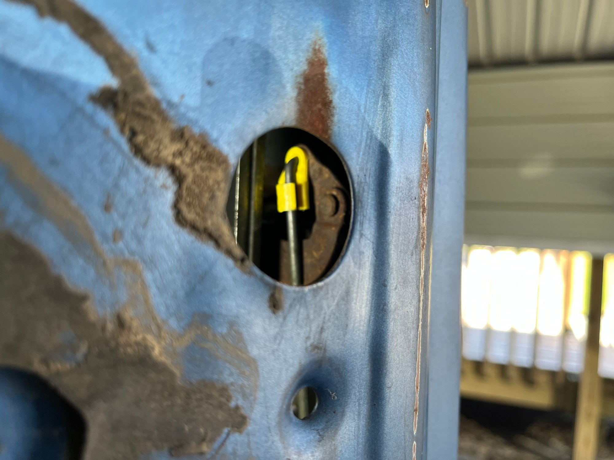

Remember how the passenger side door of my F100 wouldn't open from the outside, and I said later that the vibration from the air chisel when I was working on the rivets had caused the brittle clip to fail, letting the rod fall out? Well a new clip is only something like $1.49 at Advance Auto so I picked one up the other day. Problem is, I can get the clip in place pretty easily, but I can't get the rod to go in! I'm thinking you may have had to deal with this on your truck, do you have any tips or tricks?

Are you sure the rod fits the holes on the clip?
I dont remember having any problems with the rods and clips. I know they make metal clips but I cant remember what mine are, metal or plastic?
As long as the rod fits the holes you put the clip over the lever, pop the rod thru and push the clip onto the rod.
Just a thought I believe they make the clips in left & right hand. Maybe if the clip is flipped over it would work?
With out seeing it I cant say why other than what I said above.

Ok maybe there are different diameters? I see rockauto has a 5 pack of Ford latch clips in yellow, orange, brown, black, and white. Although my old one and the new one are the same shape and color. I should have made sure it would go through the plastic before I put the plastic piece in.

On the clip any way you can pull it off and see if the rod fits the holes?
That is the only reason I could think why it will not work. As for the colors I would have think the same color would work but who knows?

When I saw the rockauto item with 5 different clips that are 5 different colors I started assuming each color was a different diameter. But maybe a different shape. I will mess around with it, I kinda think if I remove it then I would end up breaking off some of the end pieces. I had an idea to just hold different size drill bits in my finger and see what size goes through and what size doesn't and then kinda estimate from there.

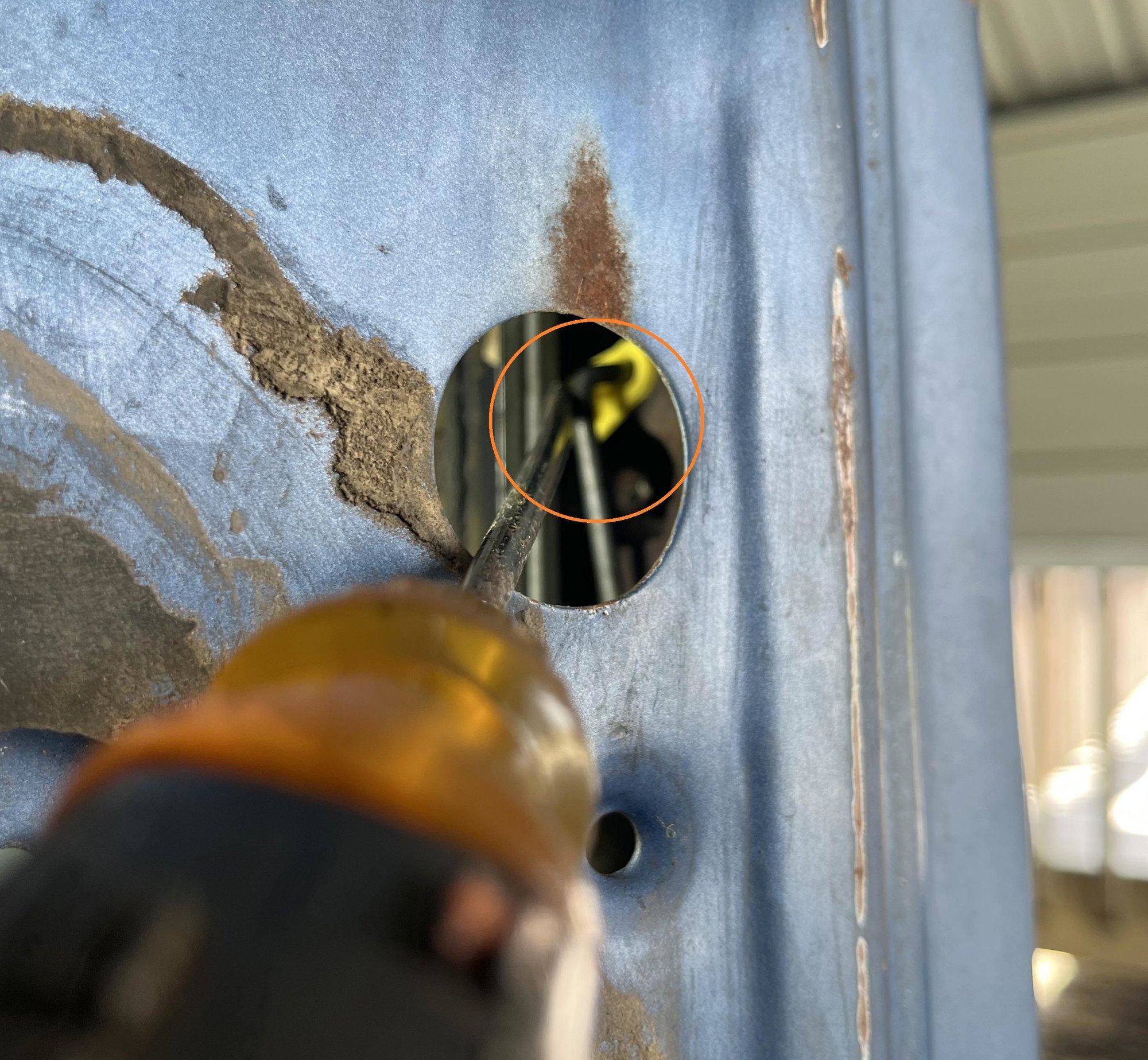

I got the door clip in place. I wish I had test fit it beforehand so as to avoid all the hard-to-reach work, but the drill bit did the trick. I think there was plastic casting flash inside preventing it from going in all the way. I tried twisting the drill bit through by hand but it got too hard, so I got the driver out and twisted it through. Not much came out but it did give me a clear hole to push it through with my thumb. The piece says "fits left or right" but I do wish it was facing the other way, then I would be PUSHING the clip it on instead of trying to PULL it, with the window frame in the way, but using a pick and a screwdriver I was able to force it in. Now it works great!
Voila!
Voila!
Tools of the trade....

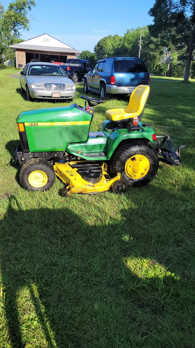

I spent yesterday all day working on the tractor LED head lights, this was after an hour at the gym.
I wanted to wash it as it was getting aa little crusty looking but had to blow the grass off it first.
I forgot how good looking the tractor is when it's clean. I may even wax it when I get it all done.
They are the factory lights but I removed the lenses and installed HF rock crawler LED light assy. They were not a upgrade from the factory light bulb when cutting grass in the dark.
I started this at 7am as it was cool and was hopping it would go quickly, not, as son and I called it a day at 6pm.
The lights both factory & aftermarket are mounted to a radiator type frame that the grille, hood and front part of the side panels fasten to.
Once off the tractor and the factory lights removed the holes need to be opened up for the 4x6 LED lights to set back some so I dont have to cut / trim the new grille.
From pictures from someone that did this upgrade it looked like the lights sit back flush on a lip on the lights, not true once I got the opening open and now sit back too far
We came up with a plan to bake the brackets to push the lights out so they would fit flush to the back of the grille.
Cut, bend, drill holes for screws into the lights of flat stock and tack weld, adjust, test fit and we felt it was good and son welded it up.
At that point we were going to call it a day but I had to mount the support on tractor to move it back into the tractor shed so it was just loosely bolted on and tractor & tools put away.
The plan was to finish it today first thing when cool but I forgot about the cruise the club had and me needing to tow the trailer there so maybe toning when the sun goes down and it cools off.
This way we can test the LED head lights. I hope this was all worth it as it was a lot of work.
