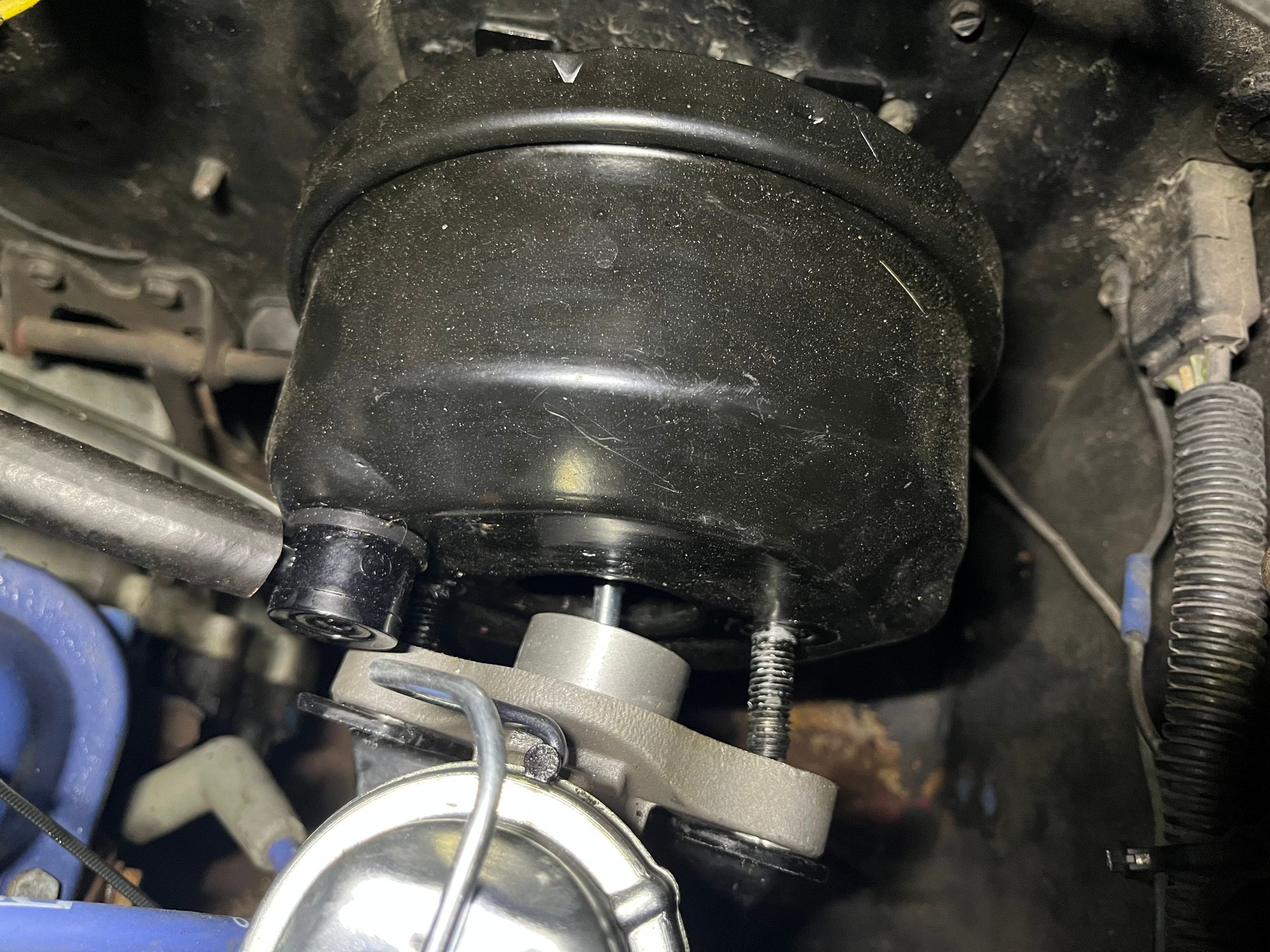

Well Dave you missed a fun tidbit at the show today as I fell over backwards. We were chasing the shade, moving our chairs every 30 minutes or so, and ultimately ended up in the grass near the school building. There was some mulch and I set my chair down in it, not realizing the back legs were in about 4 inches of soft mulch but the front was much firmer, so as I sat down the chair just toppled over backwards and smacked me right to the ground. You know the old joke, if you aren't sure if you are old, fall down. If people laugh at you then you're young, but if they panic and run to help you, you're old. Well nobody was laughing, at least not at first. Luckily only my pride was hurt!
I tackled the brakes, again, and this time I have to say I think I may have gotten it right. I wrestled with it for 45 minutes, loosened it and moved it as much as I could. I could get needle nose on it but nothing else, and it's near impossible to tell if you are turning it or not because the tool blocks your view. So I wedged a small pry in between and forced it apart just enough to fit my finger & thumb and then counted my turns, half at a time, and I am pretty sure I got 3.5 turns on the pushrod. A fight to get it back into place (specifically, a fight to get it in place far enough to get the nut started on the drivers side stud) but once I did, I was able to snug it all back down. I got inside and pressed the brakes, feels much better. Just a small amount of movement at the top before you feel the firmness of the pedal. I did not get to test drive it though as it was dark and my wife is parked behind me, but I feel like I got it where it is supposed to be.
This is all the room I can get; the front of the assembly is wedged up against the shock tower!
Of course I've scratched my new vacuum booster but you can't make an omelet without cracking some eggs.

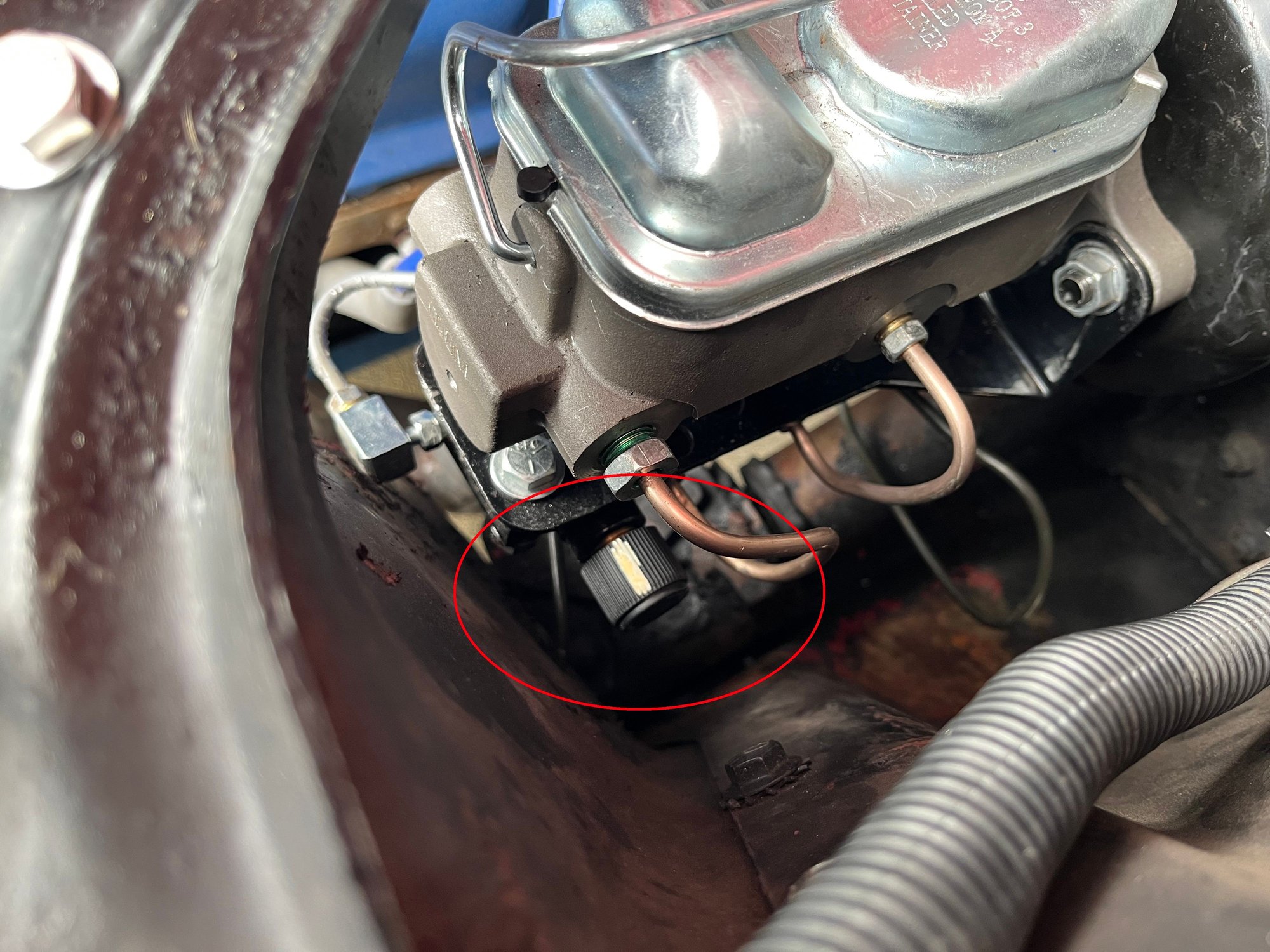

I put my adjustable bias valve at 5 full turns from
I put my adjustable bias valve at 5 full turns from "all the way counter-clockwise" which is approx half. I figured that was a good starting point. But until I can at least get the brakes functioning properly it seems like a waste to adjust it.
I verified my plumbing is correct, against the diagram from Force-10 brakes.
