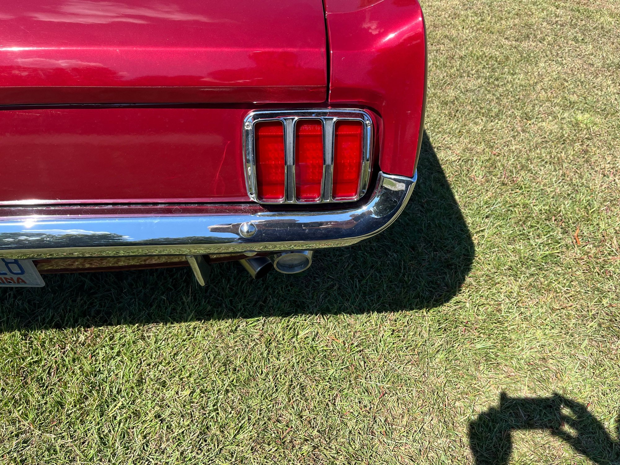

Inside the carport on an overcast day, you can't really tell how faded the tail lights are on my 66, but in person especially on a sunny day, you can see how bad they are.
These are replacement LED tail lights are and only 2 or 3 years old. By comparison the 60 year old factory ones were not this faded when I removed them. I was just about to order new ones for $99 a pair when I thought, what about some kind of transparent spray paint? So I checked and found this, available at Walmart online but not in the store near me. So for 11 bucks we will see how long this lasts!

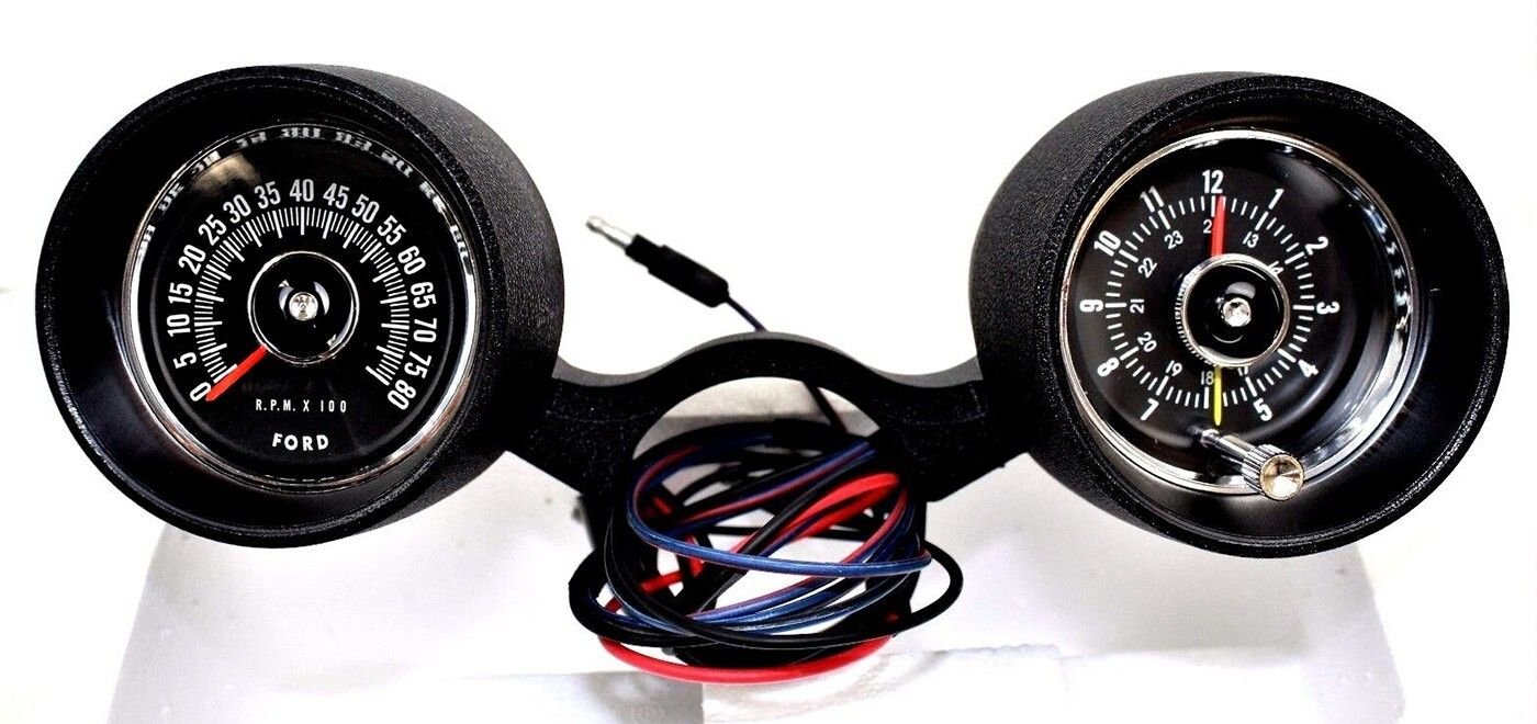

A couple of years I posted this video showing my tachometer "bounce".
I never replaced it, it still works the same way. It was a $15 tach from the JcWhitney catalog back in the 90's so it don't owe me any money after this much time. I've poking around looking at other options. The original style "rally pac" with the tach & clock on the steering column are very expensive, around $500. I found another option for a lot less scratch. This is only $45:
But these only hold 2-1/16 size gauges which is pretty small, I read that the original rally pac gauges were 2-5/8. Too bad nobody makes a 3D printed copy for cheap that has larger diameter pods, although maybe it was purposely kept smaller in order to not block the view of the rest of the panel behind it, which the rally pac always did get in the way of seeing the temp gauge and fuel gauge etc. I just need to find matching gauges that are a decent quality but not too expensive. If they have a green backlight and a classic font will be even better!

On your tach what size is that and dose it remove from the cup it is in?
I think you get what you pay for but I went to Speed Hut https://speedhut.com/categories/gaug...lphaasc&page=1
And gave a look to see what they may have as I know you could get any face & font on them you wanted and they came in different sizes.
I dont remember what size tachometer I have in the Javelin and I have it installed where the clock was to the left and the clock made smaller and to the center for the dash.
Just 1 option you could go with and you can get them with a shift light too.
Have you looked into Sun Super Tach that was used back in the day or Sunpro Tach?

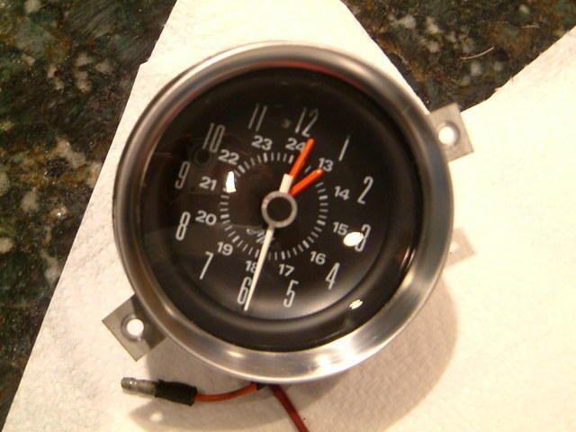

I just saw that the clock was marked in 24 hours and had to go back and see what the Javelin one was and it was also in 24 hours
There is a adjusting cable / **** that runs from the clock down to the bottom of the dash that always breaks and no one makes a replacement, I have a good one.
My clock did not work so I replaced the guts and painted the needles, did that to all the dash gauges, and it all look brand new but ..........
The fuel gauge had a "low fuel" warning light that did not work the way I thought it should every time, everything else did, so I replaced all the gauges with the Speed Hut ones to look factory till you looked close at them.
I mounted the tach were clock should be, speedo to 160 MPH and the AMC rally pack in the center is where I put the clock and vacuum gauge, I forget what was factory other than vacuum.

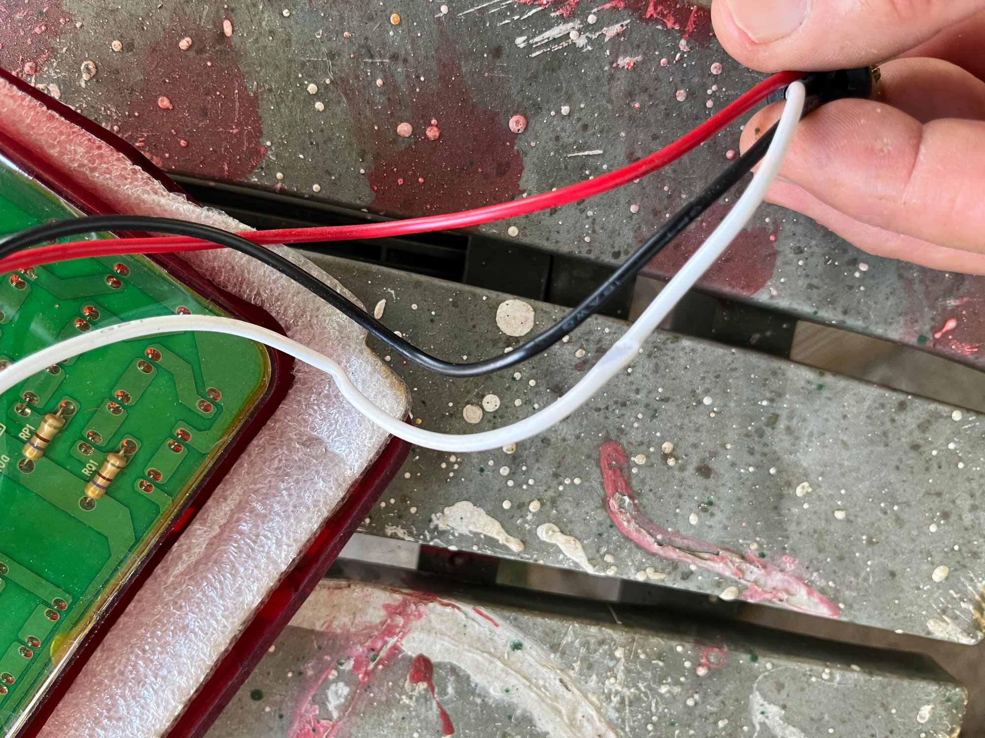

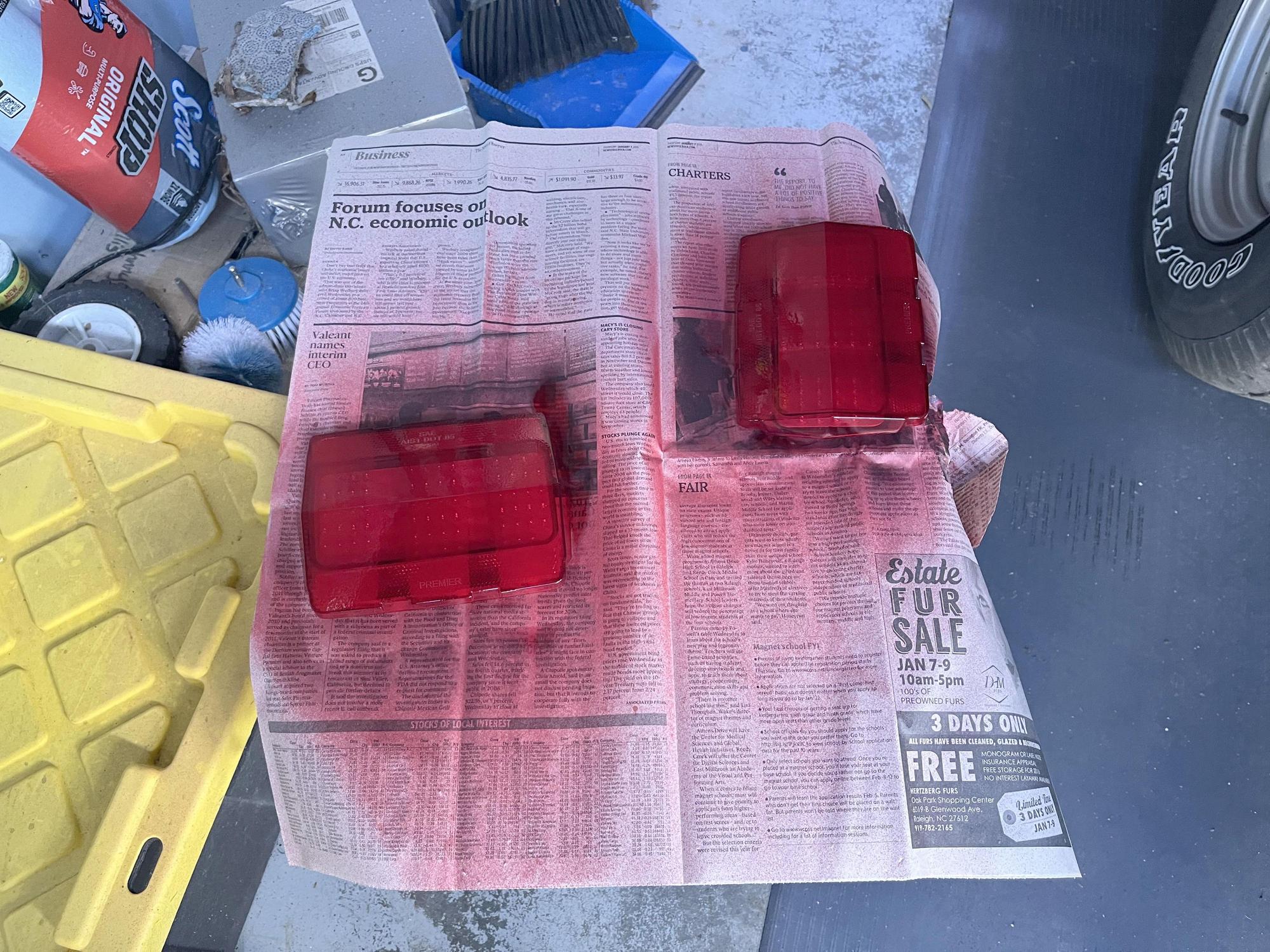

I did my 66 tail lights, I don't think clear coating them would do the trick, if you get it wet you get an idea of what it will look like cleared and it was still frosty. The red shade tint looks pretty good although I think I got a can with a bad sprayer, it would intermittently spit out large amounts in between spraying correctly. But not enough to cause any problems.
Before: frosty!
Before: frosty!
I found the white wire had been crimped in 2 places, it got caught between the housing and the lens!
You can see badly UV damaged it was where the chrome bezel was not protecting it.
Two soft coats of red shade tint and they look pretty good.
After: great improvement!

So the chrome dose remove from the light. It looks a lot better.
I think I would have tried to polish them first and then a few coats of tint.
Dose the tint protect from UV?
I know SEM paint makes a clear that protects from UV as I used it on the dash of the Javelin when I restored it.
