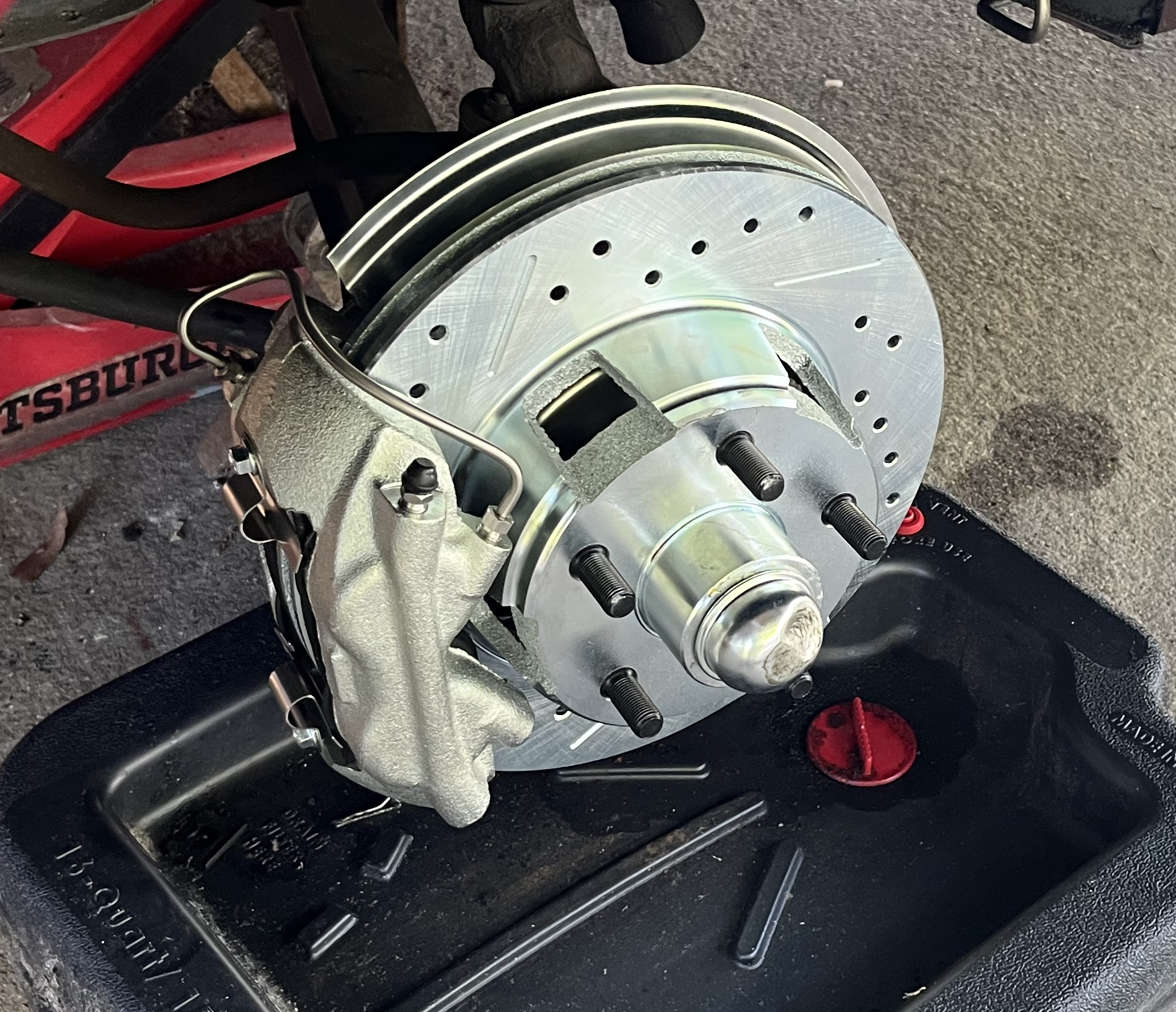

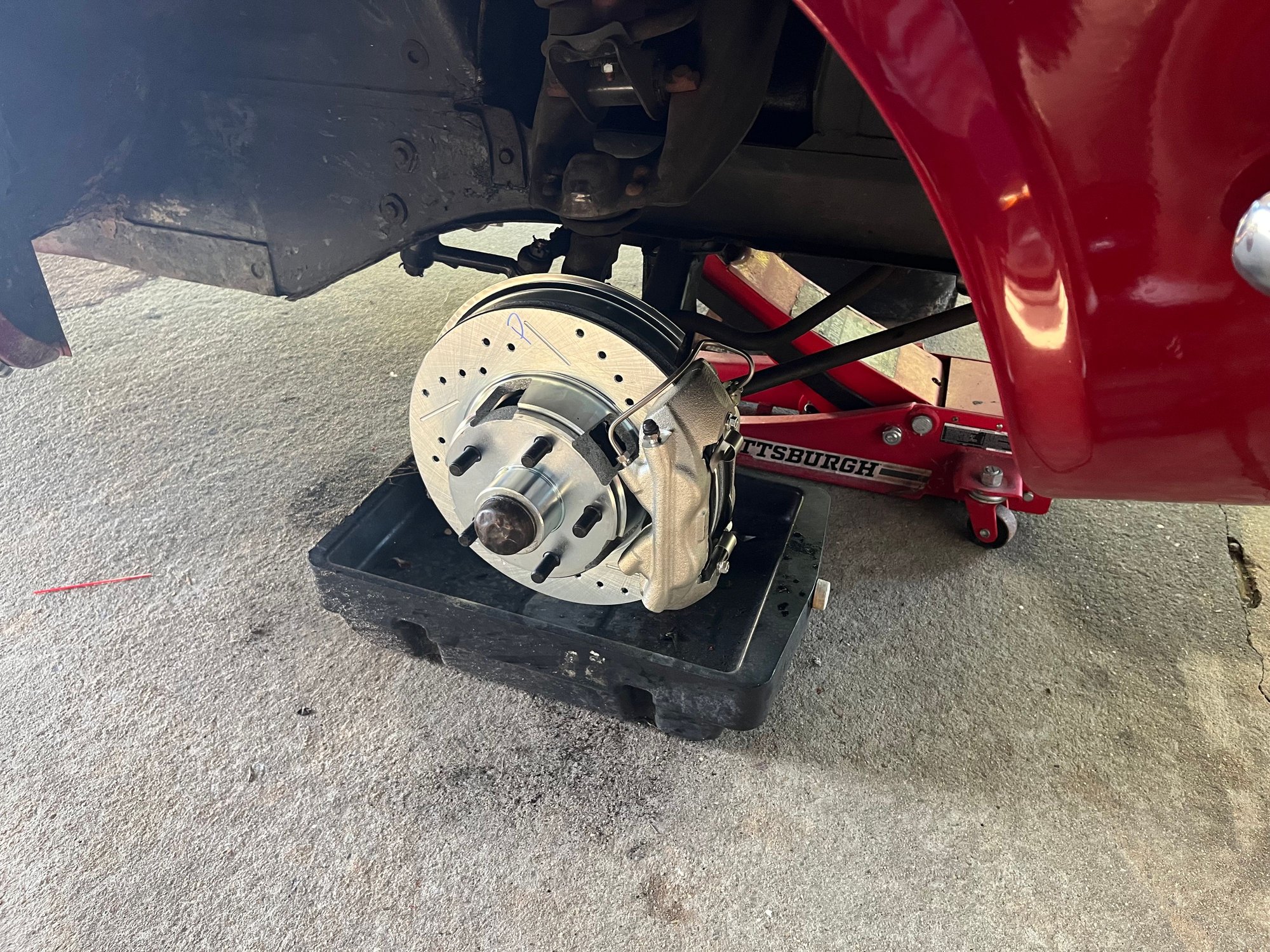

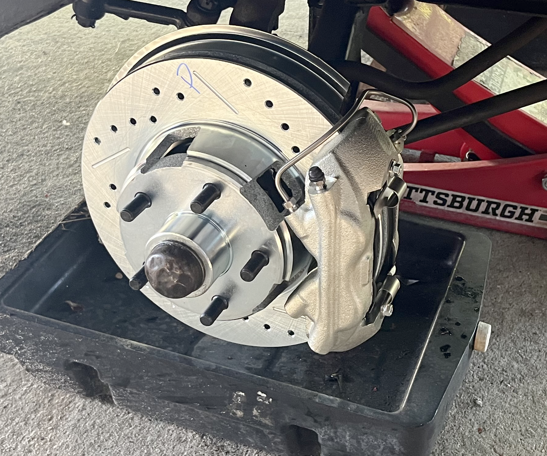

Many thanks to Fuzz for stopping by and helping with phase 1 of my disc brake upgrade for my old Mustang. I didn't mean to work him so hard, but he did one side, I did the other, and we had to fight some problems along the way.
First thing we found, the caliper mount brackets were labeled wrong. The one for R ended up having to go on the left side of the car, and the one labeled L went on passenger side. If we used them on the side they were labeled for, then either the bolts wouldn't line up or else they'd have to be upside down. The dust shields had to be trimmed as well, apparently a known problem since the 1960's. They must be designed for some other car and Ford just tossed em over and said "use these, make 'em fit".
The caliper bracket on the right (which was labeled L) was a little off, could not get both caliper bolts started. And the lower hole even with out the caliper, I could not run a bolt all the way in. It was getting into a bind. I got a tap and ran it down, but again, at a certain point it was like it bottomed out. I did some mathing, and the thickness of the caliper ear was 5/8, and the distance the tap went in was 7/8, so that SHOULD be 1-1/2 inches. The bolt they sent with the kit was 1-3/4 (which sticks through the other side of the bracket approx 1/4 inch), but even a 1-1/2 inch bolt would bottom out. I went to the hardware store to get 1-1/4 inch bolts, no bueno. They carry 1" and 1-1/2". So I got 1-1/2 and cut some off, then bevelled the sides a little. Turned out to be 1-1/8" after all was said and done, but still that's 3/4 inch of threads inside the bracket so I think it's good. Torqued all down to 56 ft lbs which is what google says is correct for 7/16 grade 8 bolts.

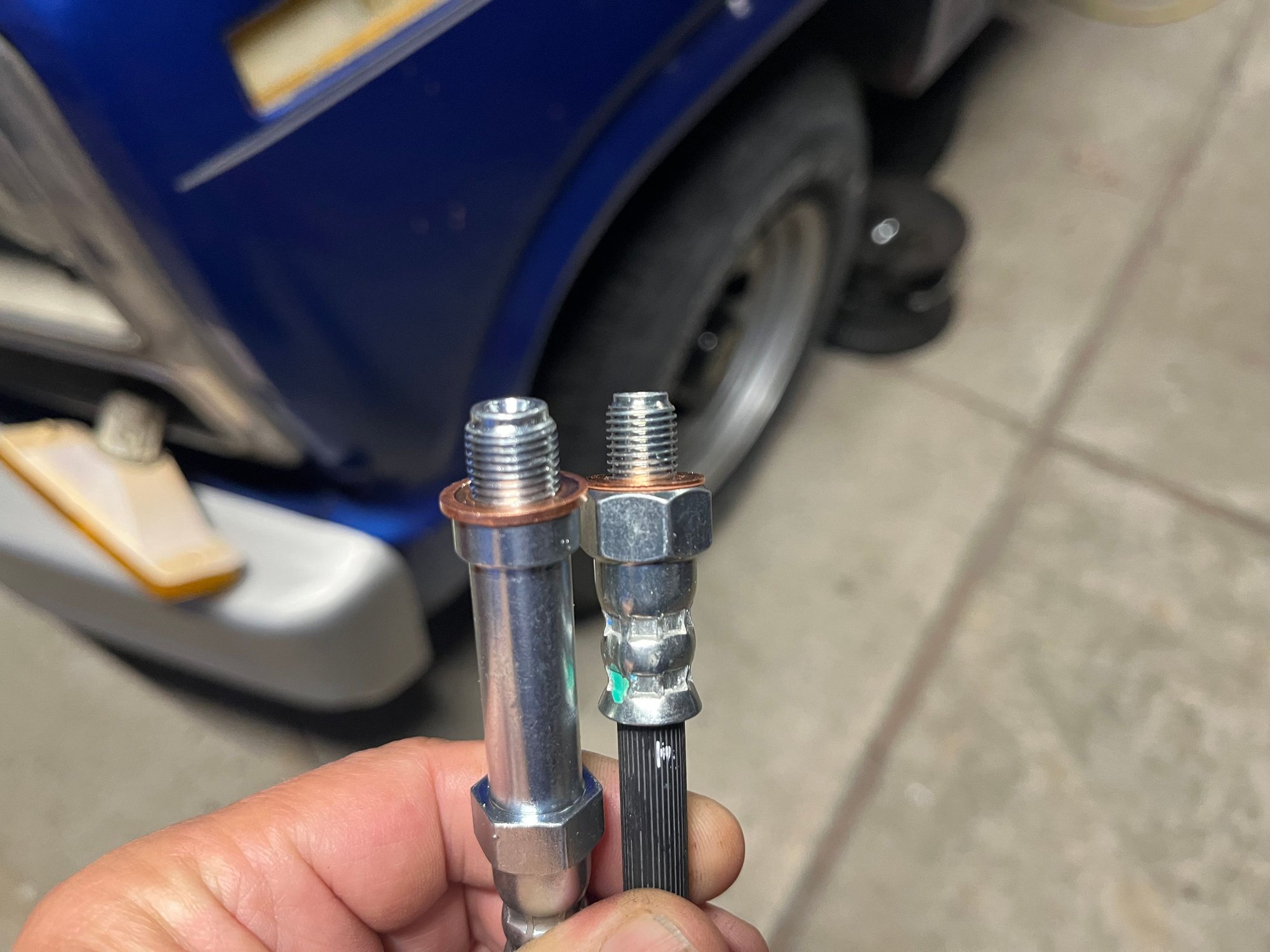

The brake hose ends are 1/4 instead of 3/16, so my line won't thread in. I can cut the ends and add the larger fitting and reflare it, but instead I wanted to try something. I went to Autozone and had them check the part number for a factory 66 Mustang with Kelsey Hayes disc brakes, they got the hose for me and let me check it, and my brake line fitting threaded right in. Perfect. So I bought 2 and headed home, only to have my hopes dashed. The brake line end is the right size, but the caliper end is wrong. These calipers have the larger opening for the 1/4 fitting, but the replacement stock hose from Autozone is made for smaller 3/16 opening. So I don't think these are factory replacement calipers.
But I found another option; an adapter to let me connect the hose to the line without having to cut and reflare. It will just add a little bit of height but I think it should work fine. Tomorrow I will go pick up a couple of these from O'Reilly.
Even with those problems you gotta admit these brakes look sexy!

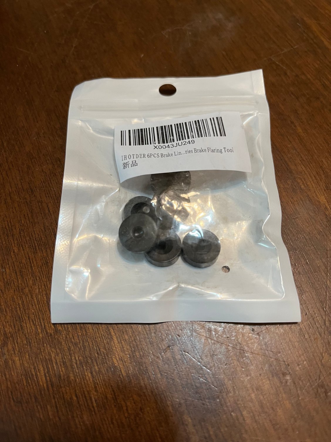

James, as for the ugly 90 bend, I found something online that might be of help to me here:
