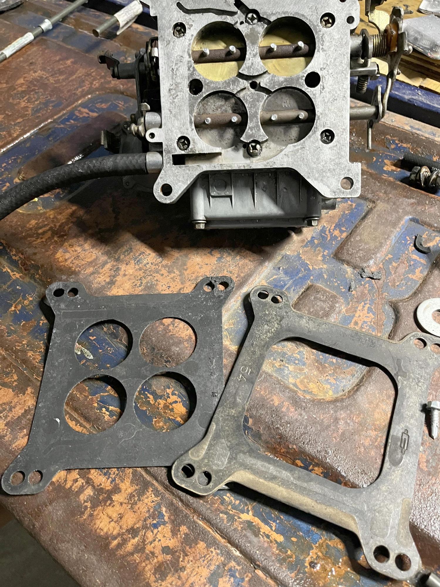

Ok I apologize for my chicken little "the sky is falling" drama post earlier; the throttle blade is not off kilter and the screw is not missing, it was just shadows and imagination.
But the primary throttles were staying open a little, one blade was not seating properly. The blades will only go on one way, they are angle cut around the edges I guess. And I could not get both screws to line up perfectly AND have the blade seated properly at the same time. It was a choice of seated properly and one screw in place, the other you can't start, or both screws started but the blade slightly askew. So I took the blade back to my drill press just opened up the holes a tiny bit, just to the next size, and then I was able to get both screws started and snugged down with the blade seated. But I still don't like that the secondaries can flop open 10 degrees. I suppose the vacuum thing is supposed to keep it closed unless forced open by the throttle, or allowed to flop open by lack of vacuum. I have not put it all back together yet though.

The throttle being held open from the blades not seating right cannot help with not able to get the idle lower.
That picture of the bottom are there 2 screws missing holding the throttle plate to the carb body?
I see 2 holes in the center between the 4 openings for the throttle blades that look like they should have screws in them.
I dont think there is 1 in the vary center just the 2 to the outside.
Also looking at that picture on the left side between the linkage I see a screw with a spring on it that looks like can only be adjusted from the bottom.
Could that be the choke fast idle speed adjustment as it also looks like the step cam for it right there above it (gold step?)?
On the secondary throttle moving with the carb turned right side up remove the cap on the vacuum.
There should be a spring just under the cap pushing down on the diaphragm IIRC. The springs have different colors and spring rates and how you adjust how fast / slow they open.
Too light a spring and they open too fast and you get a bog. Too heavy a spring and it may not open or open to slowly and not all the way.
I am thinking the spring is not there, to weak to push it back down or it installed under the diaphragm.
Somewhere I should have the carb I took off the Javelin that ran too lean and it may of also had a high idle, cant remember now after over 10 years.
If I remember it is a double pumper as the car is a manual transmission, autos should use vacuum secondary carbs.
If I can find it, did not see it when looking the other day but was not looking for it but a big bin, maybe if what you just did dose not work we can bolt it on and see what that dose.

Well I would say it's interesting, just from glancing over it. But I'm not 100% clear on it, I can see it's a data logger etc.
There were no screws in those 2 holes initially and the screws that hold the base to the body won't fit in there. I don't think it has anything in there. I googled for Holley 1850-5 and started going through pics and looks like they are all left open.

On my carburetor, does it matter if I use the square opening type as the base, or do I need to use the 4 round hole style? The one with round holes got torn but I have 3 of the square hole style in my parts box.

No, the gasket should not make a difference but the only thing to check is that the gasket covers the full base of the carb.
Flip the carb bottom up and place the gasket on it to make sure it coves the full base.
Then do the same on the intake manifold. A Holley has a square bolt pattern as dose the intake so should not have any problems with that.
Where I have seen problems is when using an adapter between intake and carb. Sometimes the adapter bolt holes are not covered / sealed by the gasket.
My sons Jeep had that problem as he is running a Holley 2300 v2 carb and needed adapter from the Jeep v2 intake manifold.
But a gasket leak like above would show up when you cover the carb like I did as the RPM would come down. Yours did not it was more like the choke was on with no fast idle as it started to run ruff / rich.
