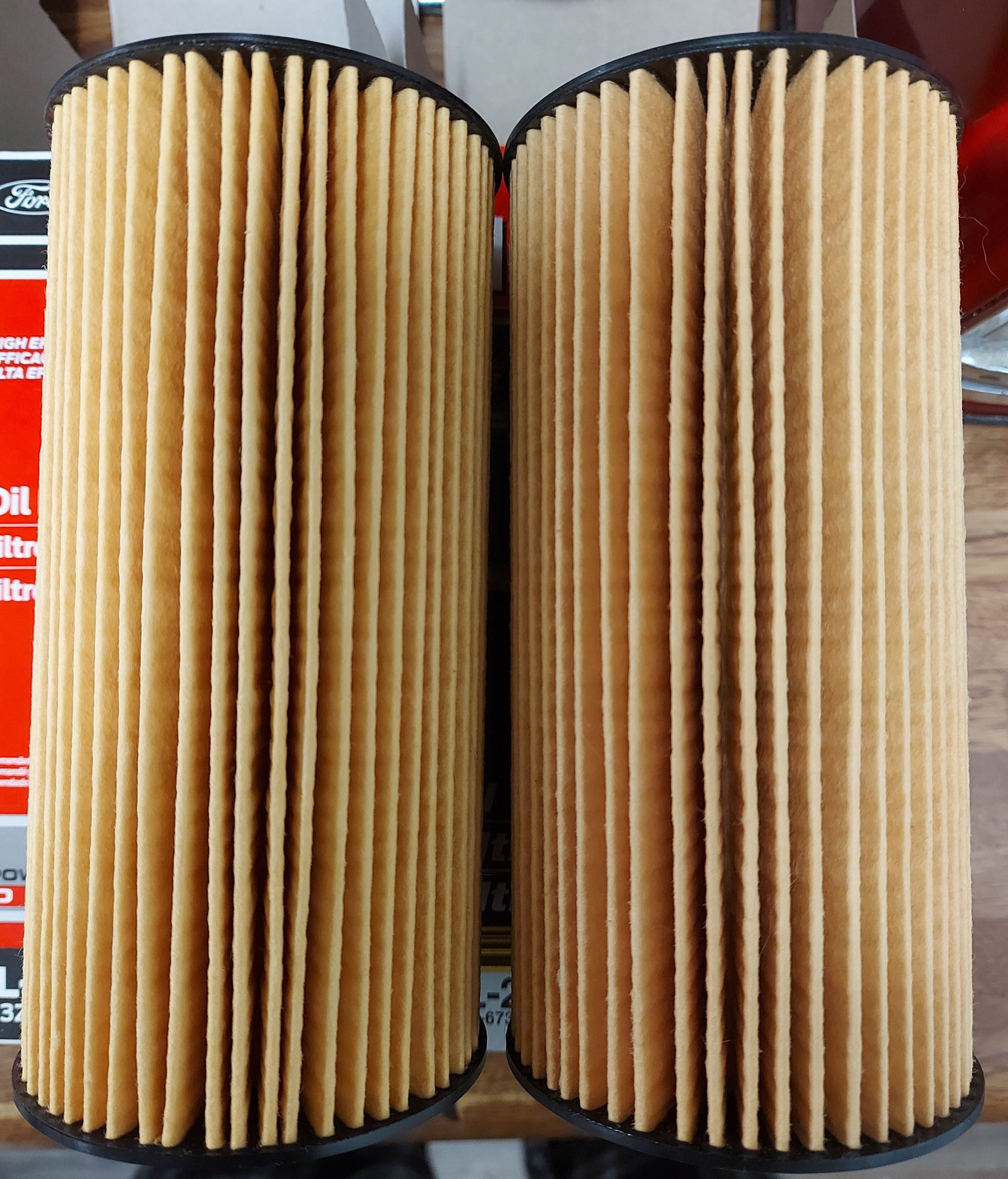

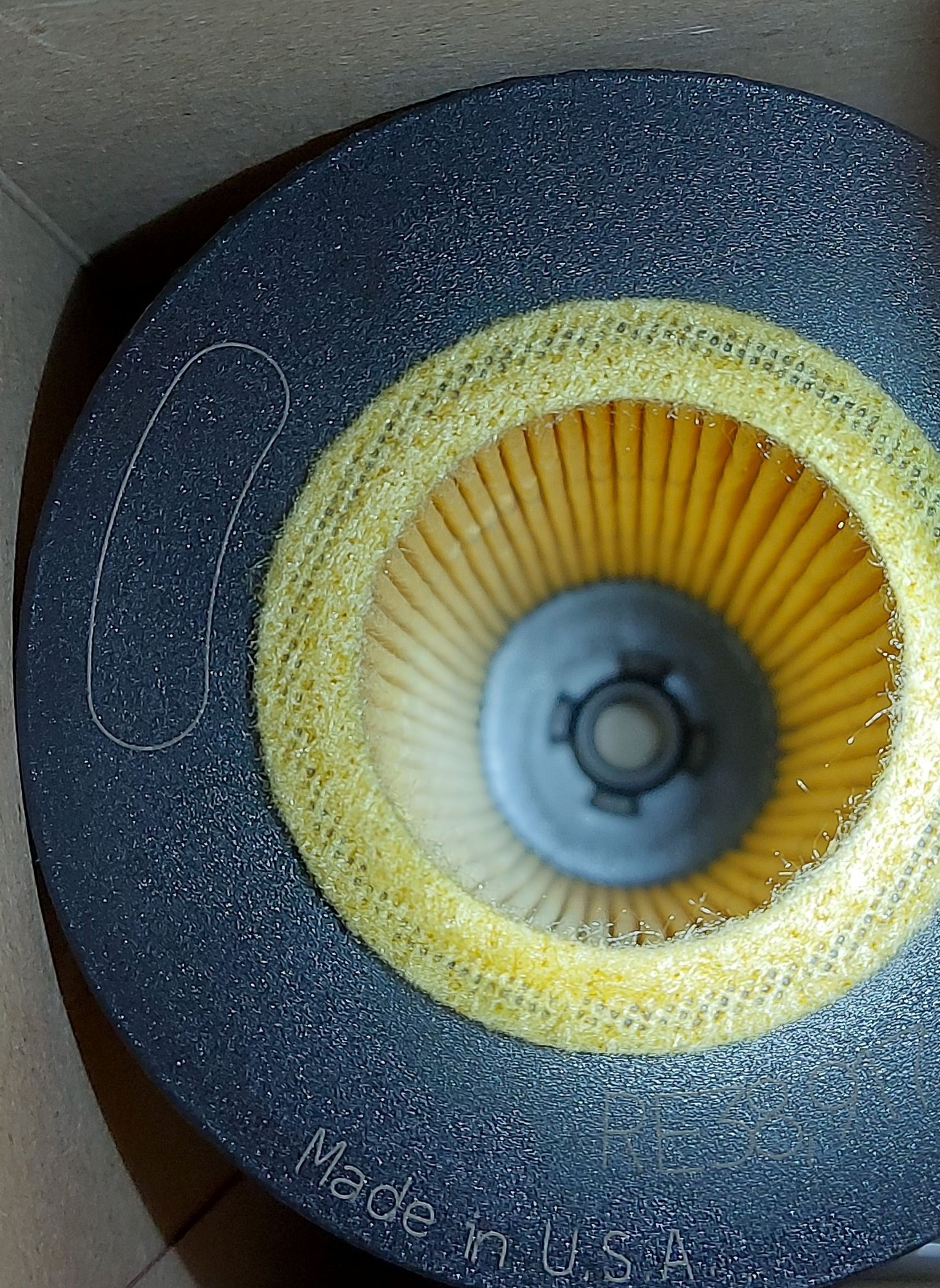

Originally Posted by BigGreenEx
Local parts store, O'Rielly's, I got it there because it was Motorcraft. I started my 6.0 journey by watching all of Diesel Tech Ron's videos so I've always used OEM filters. I just went to see if the box was still around, but it's already been taken to the dumpster. My fuel filter box was still there though and it says Motorcraft.
OEM filter will say MADE IN USA and they will have the 4 point ridge on the inside, pics for reference.
