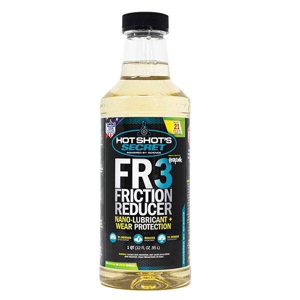

I've been using the Archoil ar9100 now for 60,000kms give or take and I've always purchased mine from amazon and there's never been any clumping or crystallization and I have no idea what's causing that in other bottles, but maybe just age/settling and some chemical reaction.....I dunno?
This 0w40 T6 with 16oz of ar9100 added has around 7000kms fresh from the Fumoto valve on my oil pan and it's got no chunks at all and the color is the typical black we all see after this mileage. I use 0w40 year round and never go over 8000km OCI's so I doubt I'll ever have major stiction issues and I most likely gain little benefit from the ar9100, but dumb dumb that I am I like to run something in my oil just for the warm fuzzies lol so I'm going to try out Hot Shots FR3 friction reducer on my next oil change and that stuff is a clear liquid in a clear bottle so never any chance of dumping clump junk in the engine block
