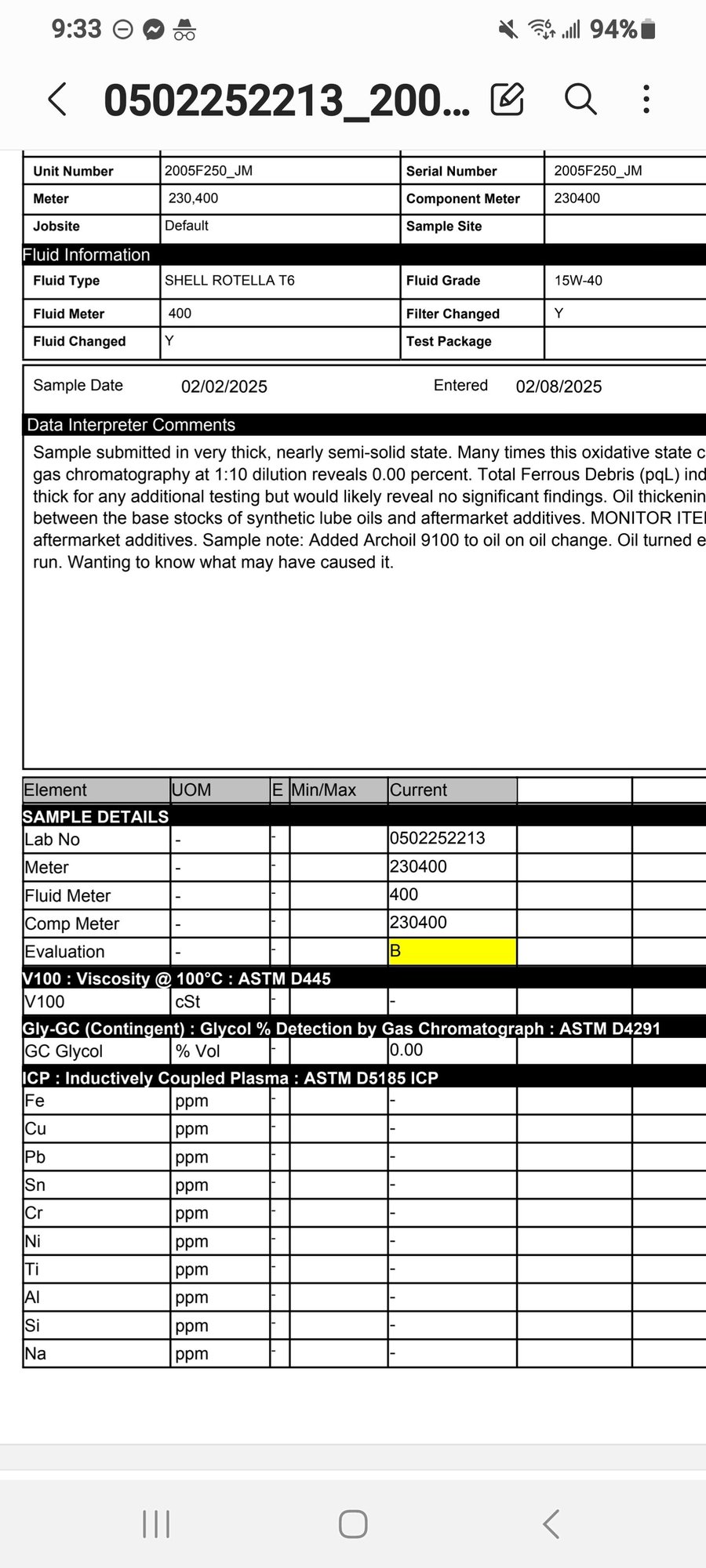

for all of you who asked, this is my oil analyst that came back from Caterpillar, it is NOT Coolant, water nor lack of maintenance. They attribute it to the ADDITIVE as the only possible cause. As a side note, per the lab and my own personal observation from seeing it and sending out samples....the oil is getting thicker as it sits

So no analytical result numbers except the glycol? Another possibility (IMO) is getting a fake/bad dose of an additive is very possible depending on where you buy it (eg some Amazon sellers). An important note from Caterpillar is that glycol CAN contribute to it. And as an fyi, glycols can react away quickly, so a water analysis is typically done also.
Anyway, the Caterpillar assessment didn't come across as conclusive to me, just a possibility (ie - "Oil thickening can also result from incompatibility between the base stocks of synthetic lube oils and aftermarket additives). CAN, not DID.
Clearly it is technically possible for some additive to do this, but this simply goes against many, many experiences (many thousands) with Archoil. Extreme heat can do it also. In fact Ford had a training video in the early days that shows oil like this in an engine they disassembled (heat and lack of proper change interval). Lack of oil filtration can play a part as stated previously (ie using aftermarket inserts in the standpipe).
The oil I added the Archoil residual to, after 2 weeks it is just fine, and absolutely no material falling out of suspension, or any thickening for that matter.

sample sent to Caterpillar,Blackstone and to Archoil ,so far only Caterpillar has come back with results and has noticed just like I have that the longer in sits in a container, the thicker it's getting.

that is correct, if you read the findings the technician stated that the oil was too thick to conduct further testing. His words as a oil analyst for many many yesrs. I'll wait for Blackstones results

Samples can be thinned (just like it was done for glycol), I suppose it just gets cost prohibitive.
