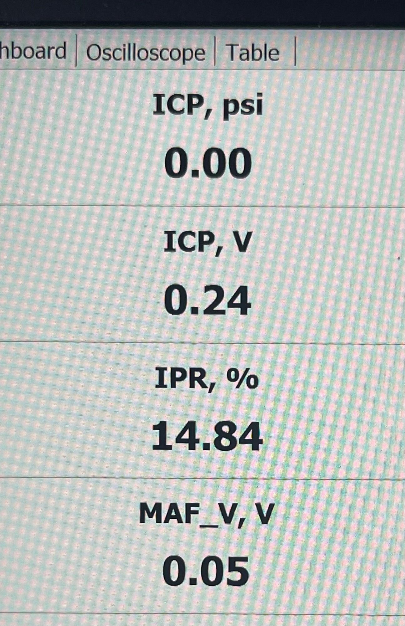

>> I would be interested to see what the IPR and ICP pressures are with all the gunk in the system. Kinda surprised it even starts anymore.
The HPOP screen should be interesting.

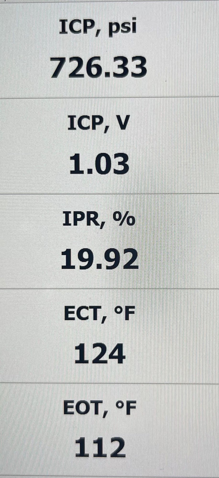

Originally Posted by Fuzzpuss
Since it now looks like the motor oil is bypassing the filter AND nobody is talking about the weirdness at the top of the standpipe:
https://www.ford-trucks.com/forums/a...5&d=1486048785
After running 5 min or so
Cold before start.
