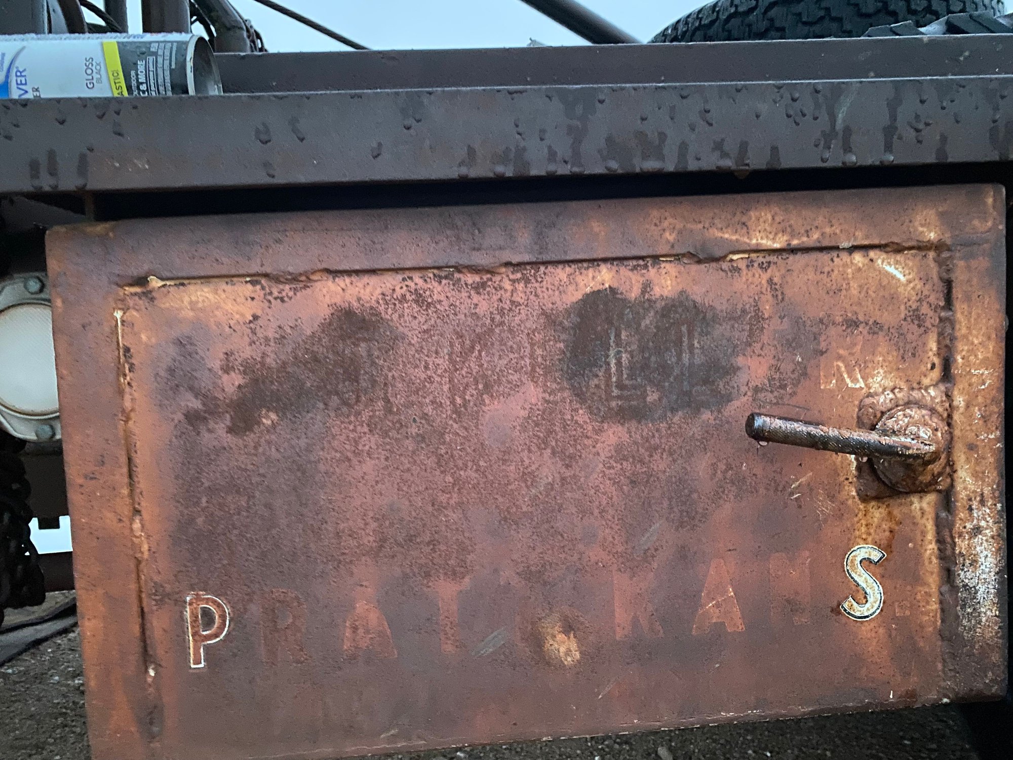

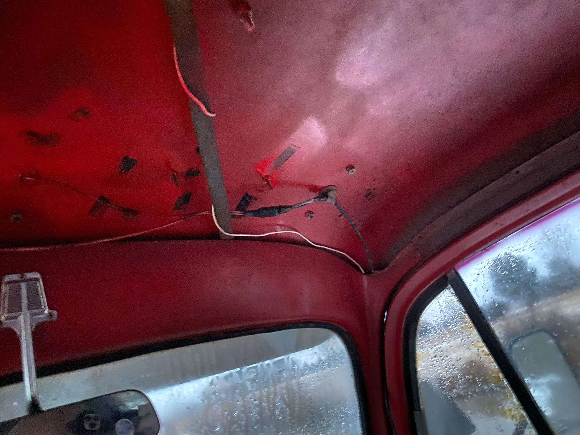

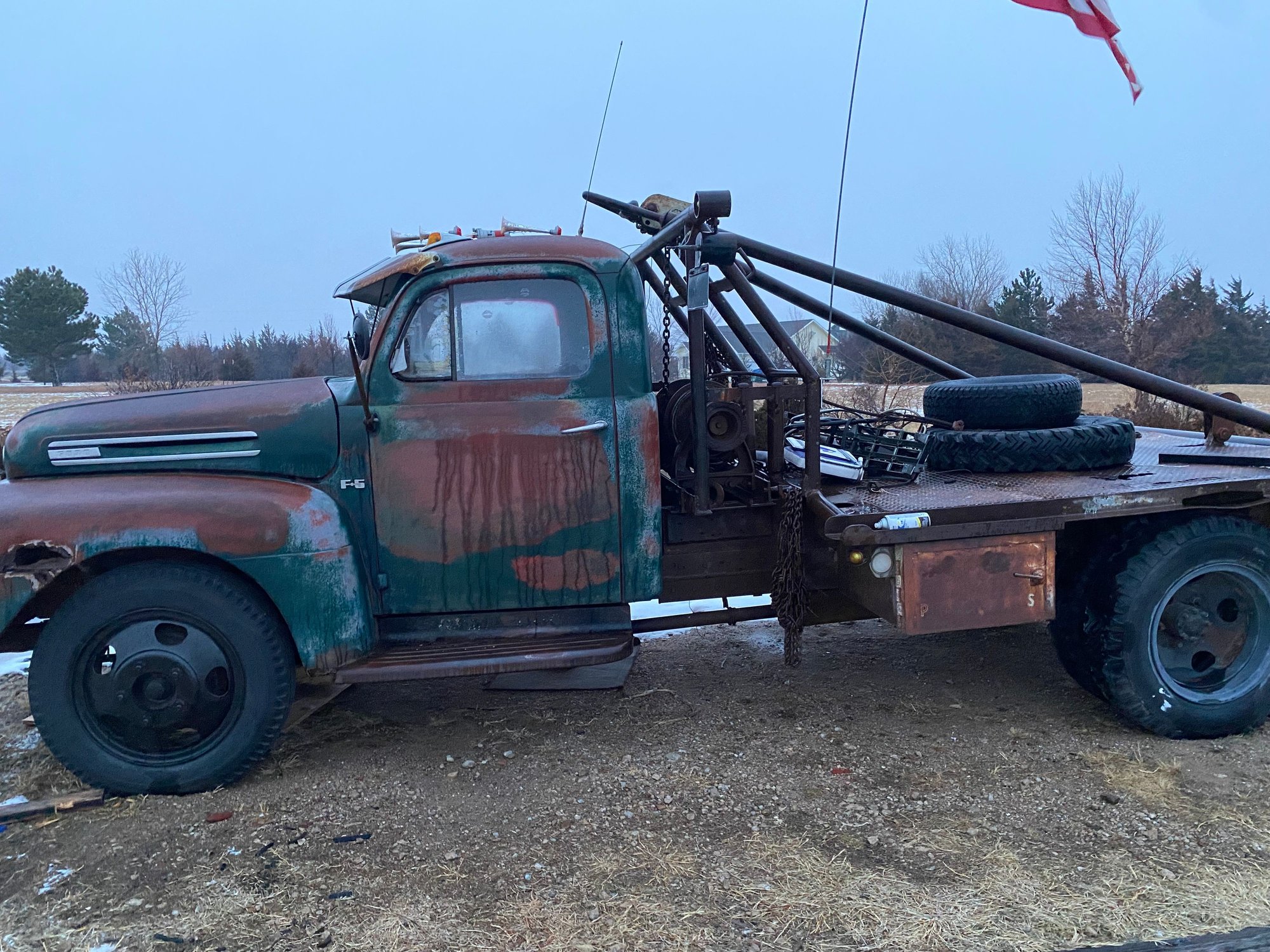

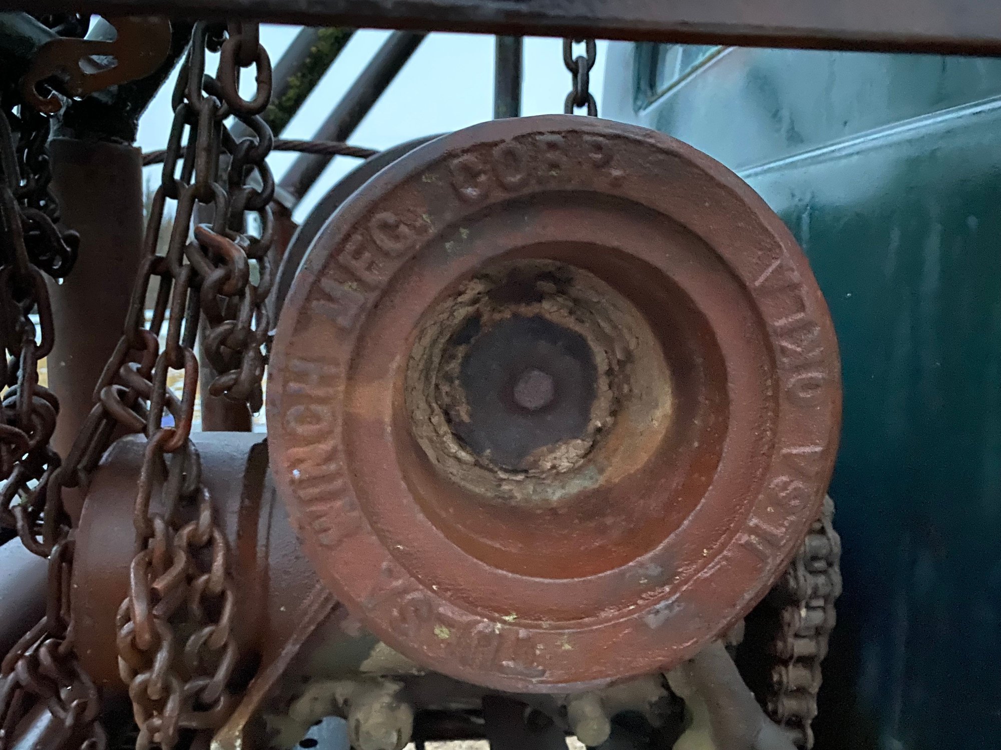

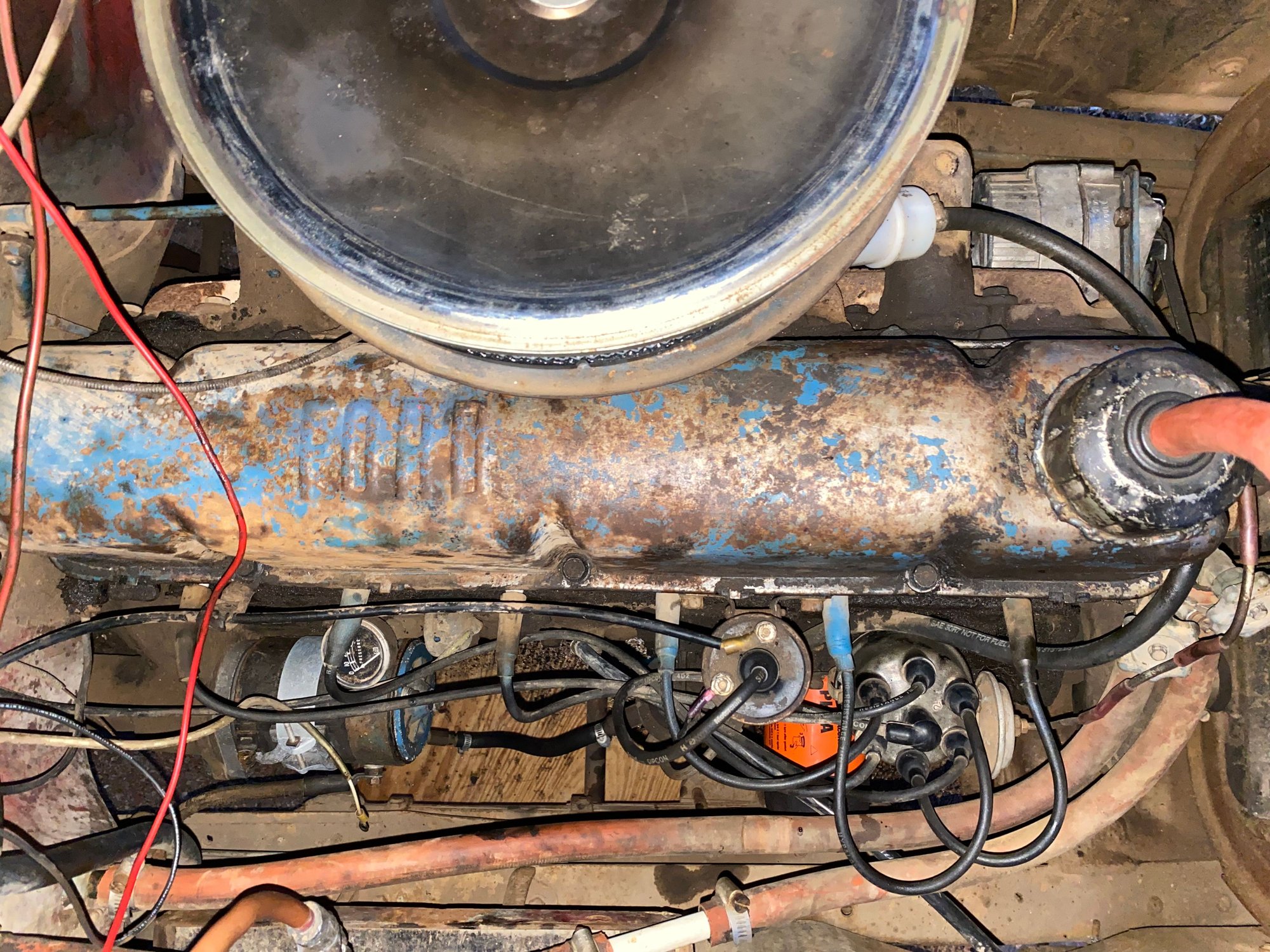

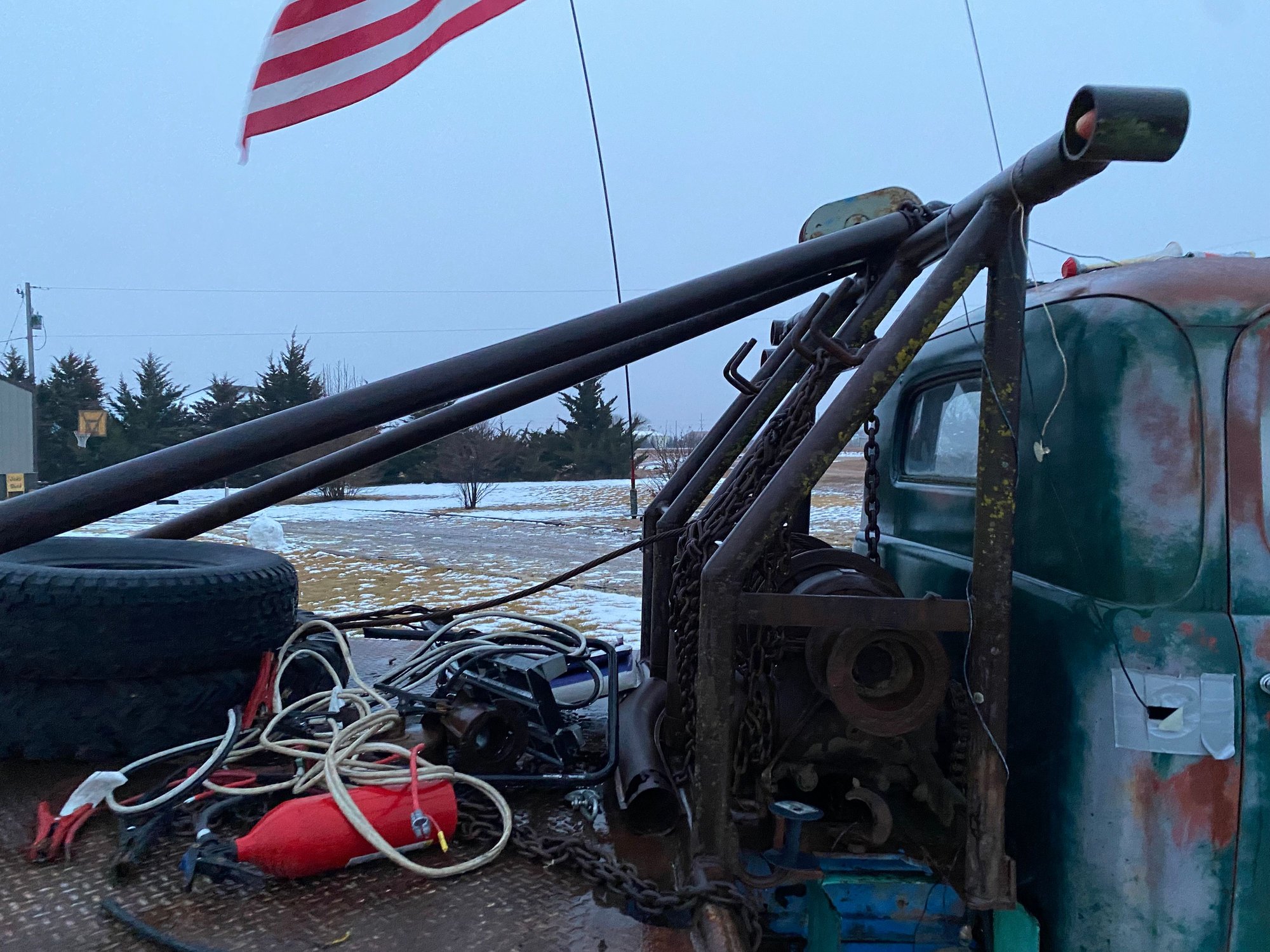

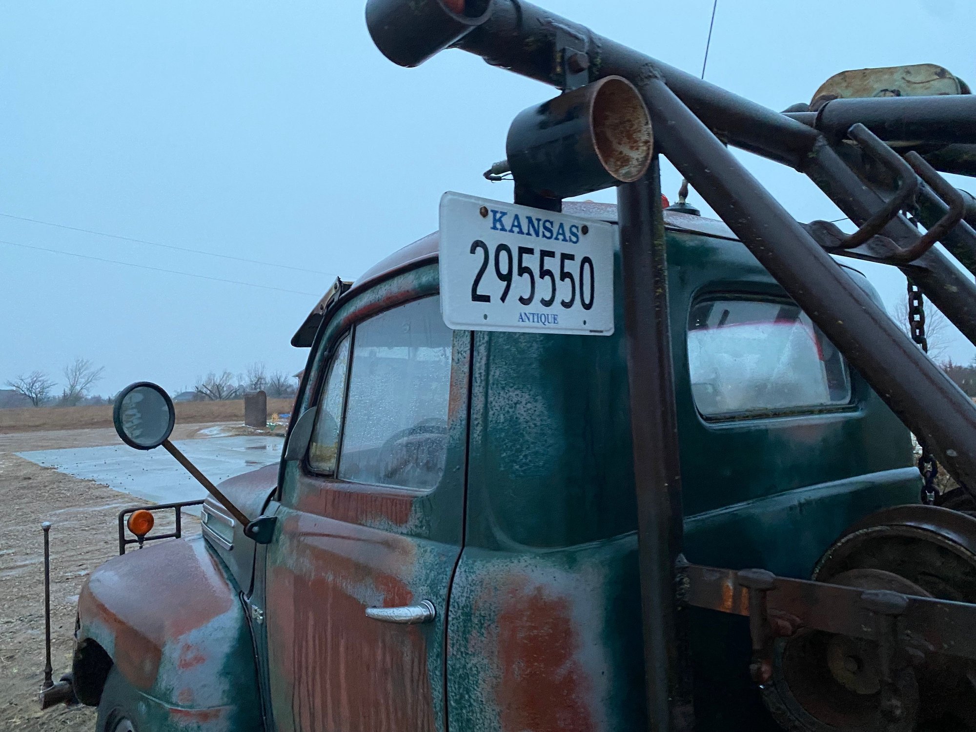

Old Jan 25, 2023 | 12:15 PM
  #80
DieselDog409's Avatar
DieselDog409
Joined: Sep 2022
Posts: 955
Likes: 199
From: Pratt Ks
Here you go.
Old Jan 25, 2023 | 12:28 PM
  #81
bmoran4's Avatar
bmoran4
Parts Nerd Extraordinaire
Joined: Sep 2010
Posts: 4,383
Likes: 1,791
From: Western NY
Awesome pictures! So nice to see what we are talking about. Plenty of promise can be seen for sure! Please be aware that you have a dreaded Firestone RH-5° honest goodness widow maker rims. They are essentially ticking time bombs that can go off at any time, stationary or not. There is a current companion post discussing safe alternatives: https://www.ford-trucks.com/forums/1...5-project.html

Old Jan 25, 2023 | 12:46 PM
  #83
bmoran4's Avatar
bmoran4
Joined: Sep 2010
Posts: 4,383
Likes: 1,791
From: Western NY
Originally Posted by DieselDog409
No i have checked they are the twist ring split rims that semi shops will still service
You need to triple double check all your rims again. Only one that I see not being a RH-5° is the outer rear right. The outer rear left is definitely an RH-5°. Both fronts don't look to have lock rings and likely RH-5°. The spare seems to show the RH-5° split as well. Obviously, we can't see the inner duals, but....

That thing is a beast, Diesel Dog. Thanks for the pictures.
