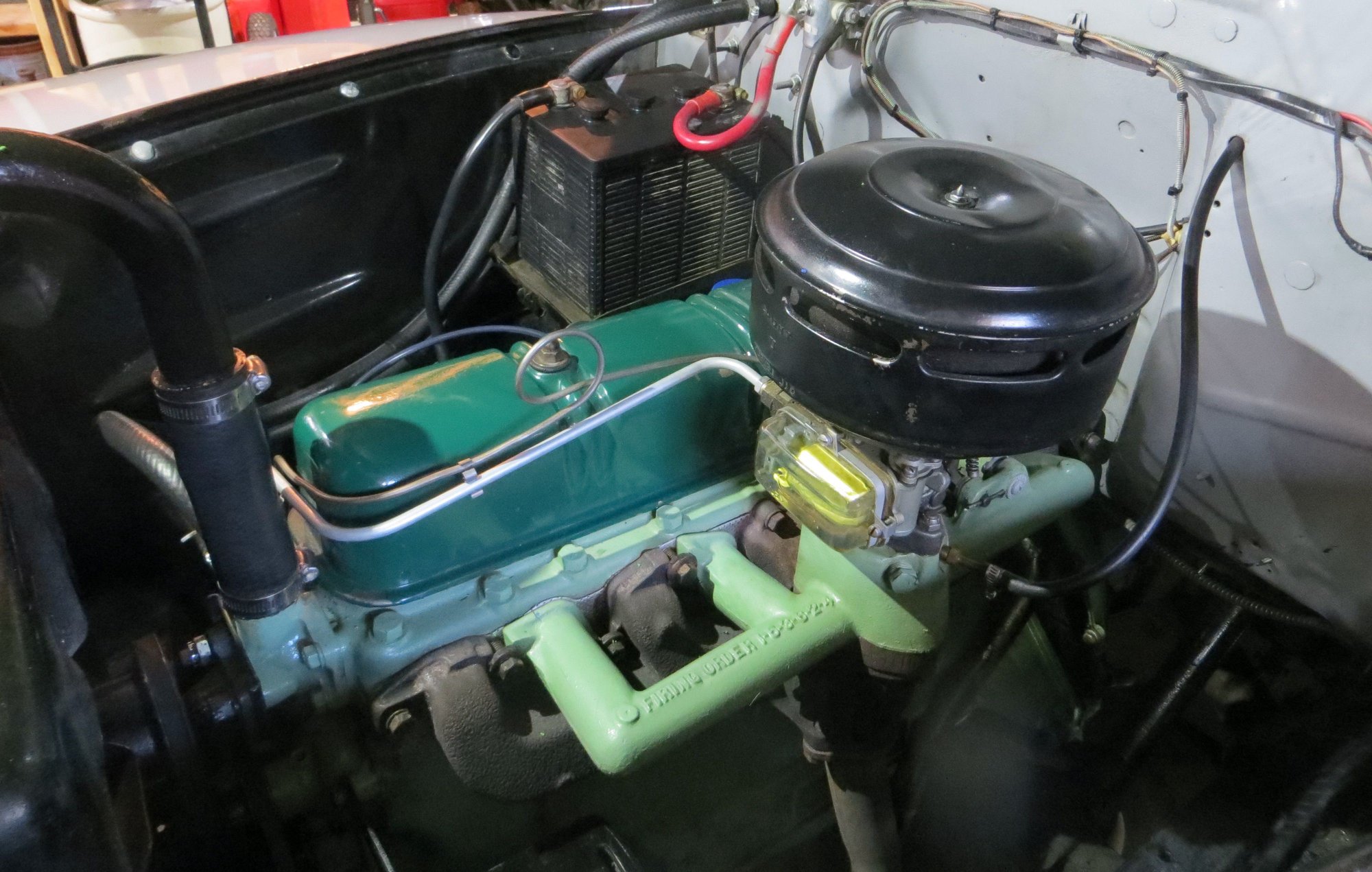

I had a 215 rebuilt about 6 years ago. I did some of the disassembly and assembly and a friend helped me get the engine out and back into the truck. The machine shop charged about $2300 for parts and labor. It seemed like a lot to pay at the time, but I'm happy now with the investment. Swapping in a different engine might seem like a cheaper option, but there are likely to be unexpected expenses involved fabricating motor mounts, mating up the engine to a transmission and drive shaft, and getting everything else just right--and then of course, the engine you swapped in probably isn't rebuild and may have issues and expensive repairs that need to be made.
This is what a rebuilt and painted 215/223 engine looks like:
Good luck.
Jim

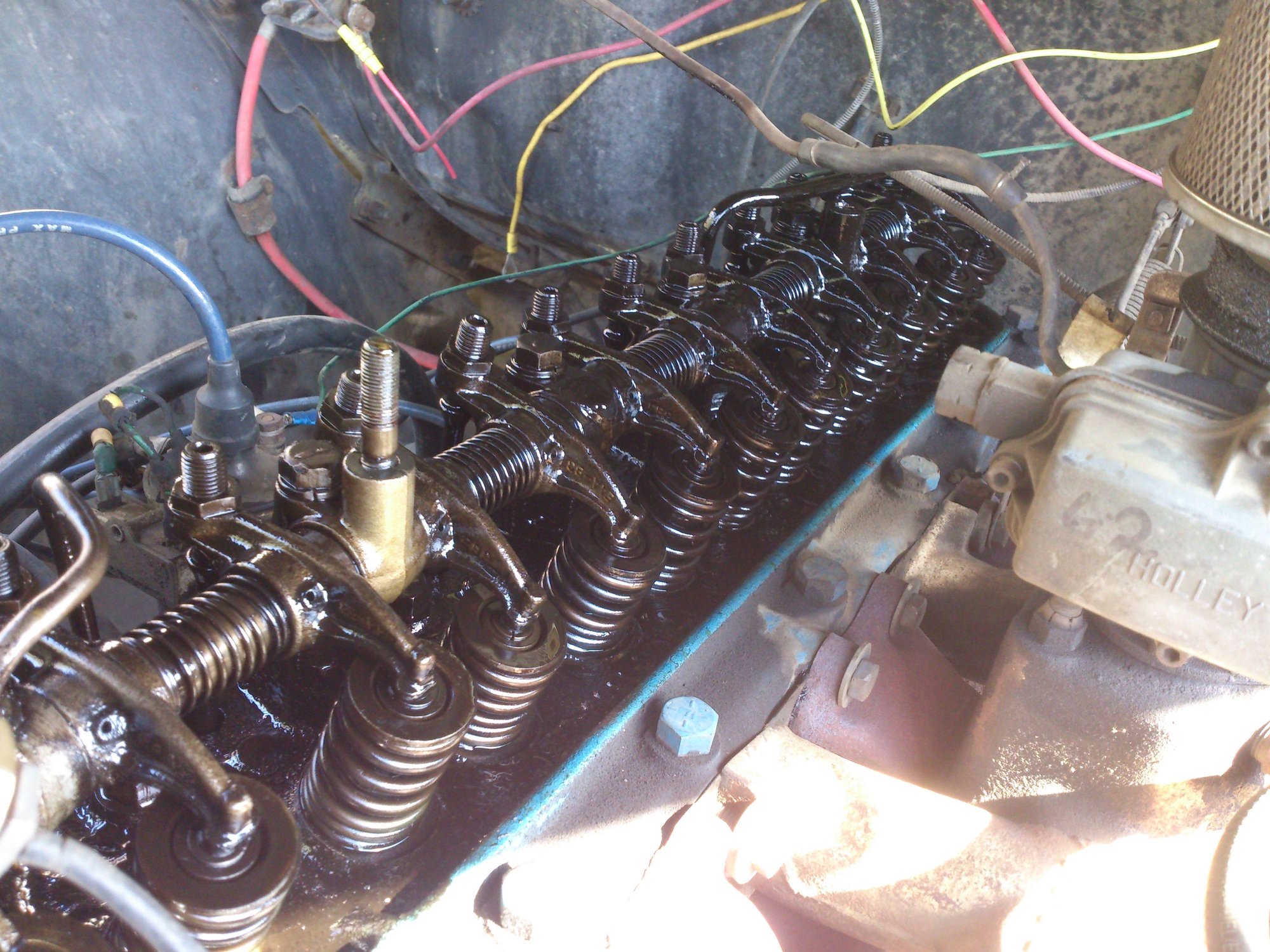

Beyond a compression test and doing rings etc, if you have a chance take the valve cover off and take a pic of whats going on if you can. Anyways, you can easily take off the rocker shaft assembly, or at least one of the feed/drain tubes.
The rocker shaft tube is hollow to allow oil to flow to each rocker arm, but the ends of the shaft are sealed with pressed plugs, in other words it's not actually that easy to simply look inside or clean out anything inside. Nonetheless you don't need to take it off, but if you want to it isn't hard. But even with it off it may be a bit involved cleaning it out.
There are two feed tubes, in my pic the one on the left side of the pic is the drain tube, and the long elongated one on the right side of the pic is the dreaded feed tube. This tube is sealed with a small o-ring that is deep in the engine, these o rings harden and make getting the feed tube out very not-fun. Treat the tube like it is salvageable, so BE NICE. Try and get it out without bending it too bad, if you find it is clogged solid once it's out, you can do whatever you want with it. Hopefully it's not clogged and not hard to get out for you.
This assemblies cleanliness and ability to flow oil is probably the 223's biggest Achilles heel, this is why I'm really going in depth. If you have any more questions I'll try and look at this thread every day.
The original tube from my first engine was clogged completely solid; the tube from my spare engine was PERFECTLY clean but an absolute PITA to get out of the block. Ya never know what you're gonna get, so be gentle.
If you are resourceful you can try sourcing new end plugs for the rocker shaft, take the originals out and clean it real good.

Old Jan 13, 2023 | 10:02 PM
  #30
mOROTBREATH's Avatar
mOROTBREATH
Joined: May 2008
Posts: 2,491
Likes: 337
From: Bakersfield, CA
This edited picture shows the feed tube highlighted in red.
