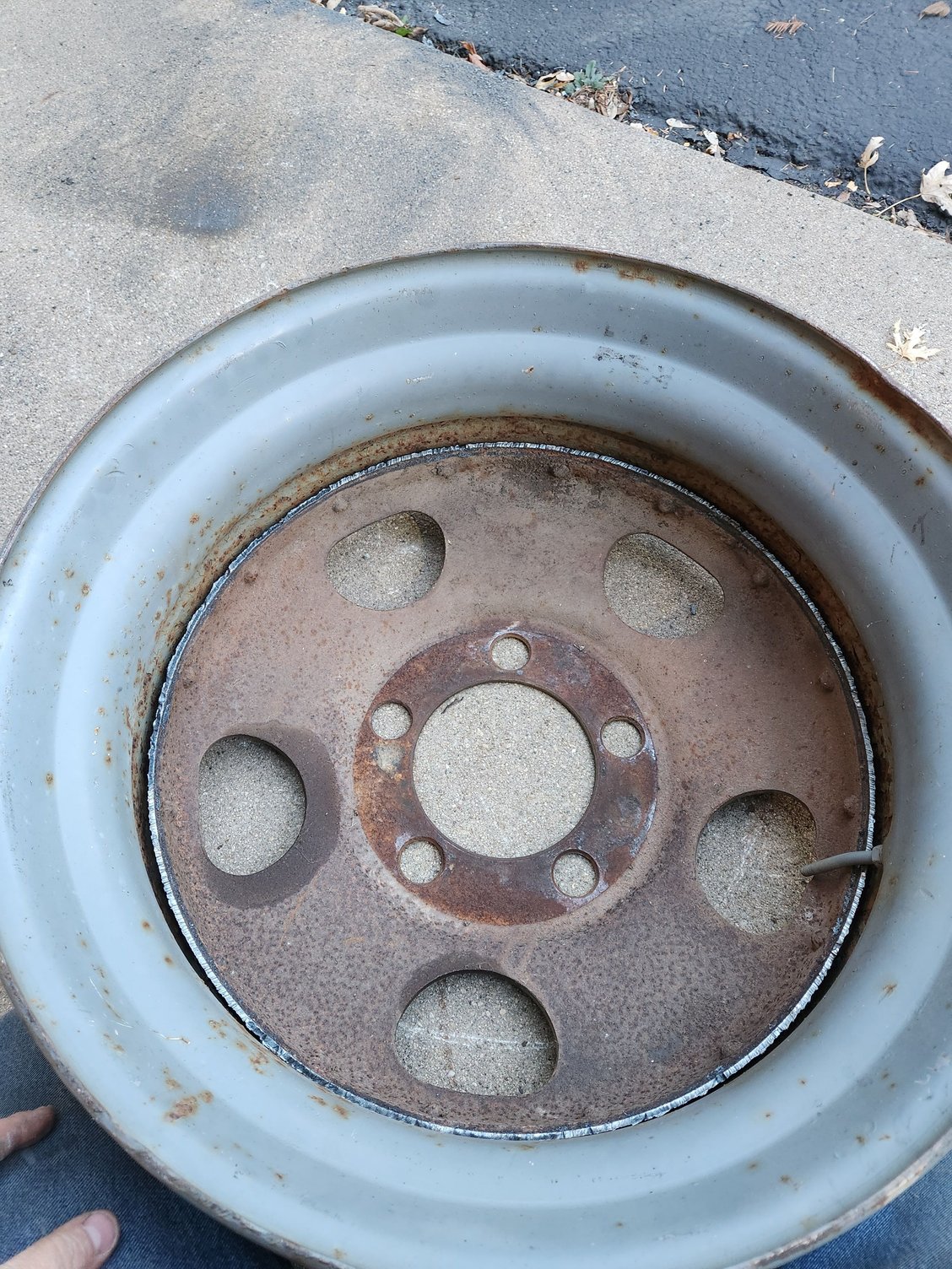

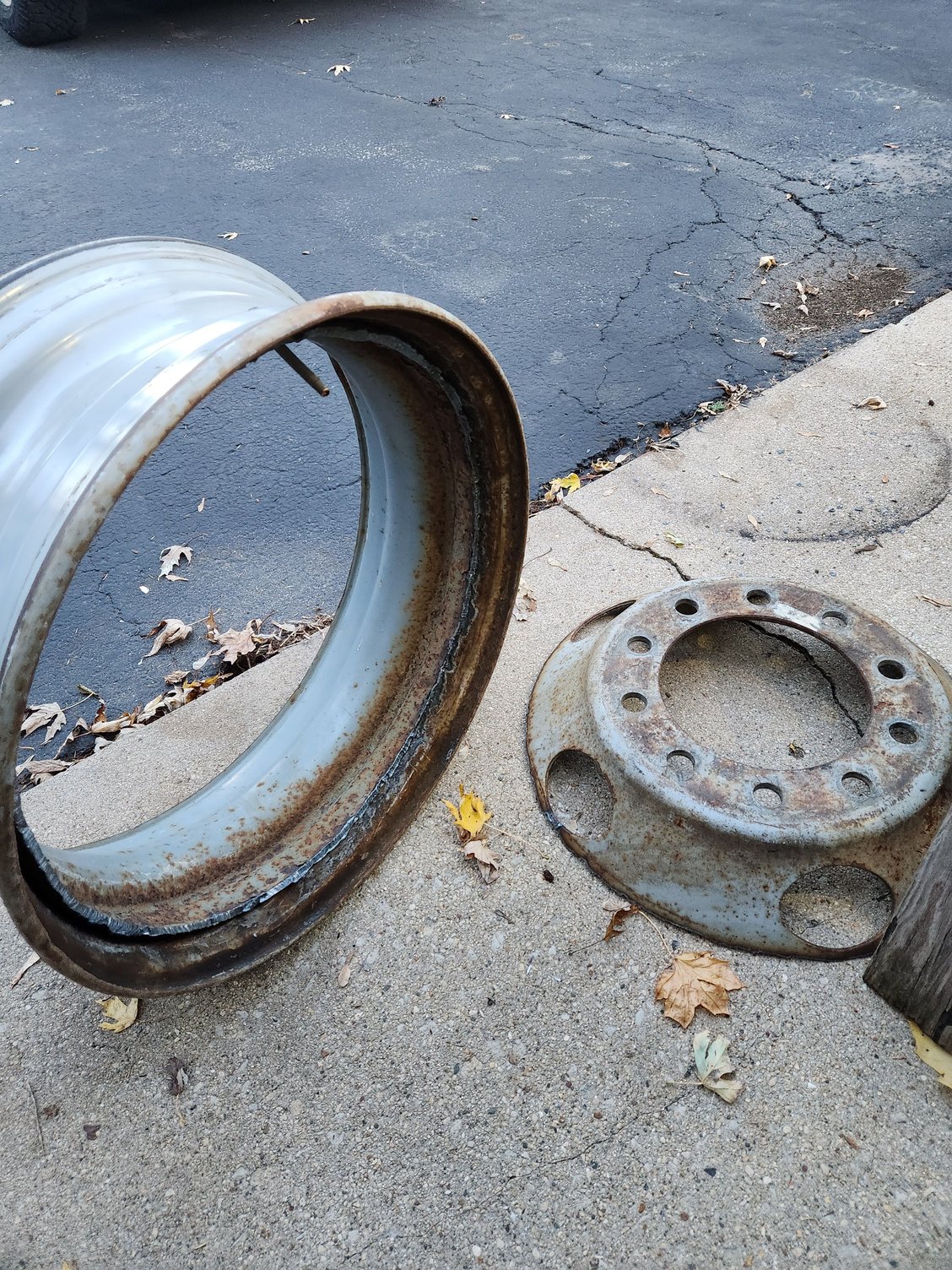

I went through the same struggle! There are new wheels available from Wheels Now in Wisconsin. The problem is they have a huge hub face and only two small grab holes. In my opinion they look terrible compared to the original 5 grab hole rims. They are also $400 a piece to boot! So on a dually, you are looking at over $2500 in rims and then add $300 tires to that...at the least...now you are at $4500. Those rims are 22.5's which is what you really want to go with, that will slightly raise your top speed...which is a good thing since top speed isn't really a great phrase for an F5 lol. 19.5's will lower your top speed. My solution was to cut the centers out of a 22.5x7.5 truck rim and weld the outer half of the widow maker into them. This is not really for the faint of heart though. For each wheel you want to make, it will take about 18 feet of cutting and 18 feet of welding per wheel. Also takes a lot of patience to get them straight and true. At the end of the day though...I only have about $50 into each wheel.

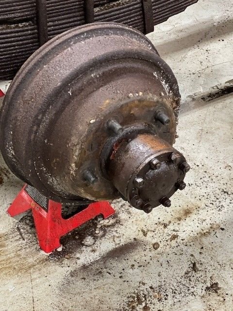

So oddly, I found that my right hub is a floating type drum and left side is axle mounted drum. is this normal? I'm told the floating drums didn't come out till the 70's
