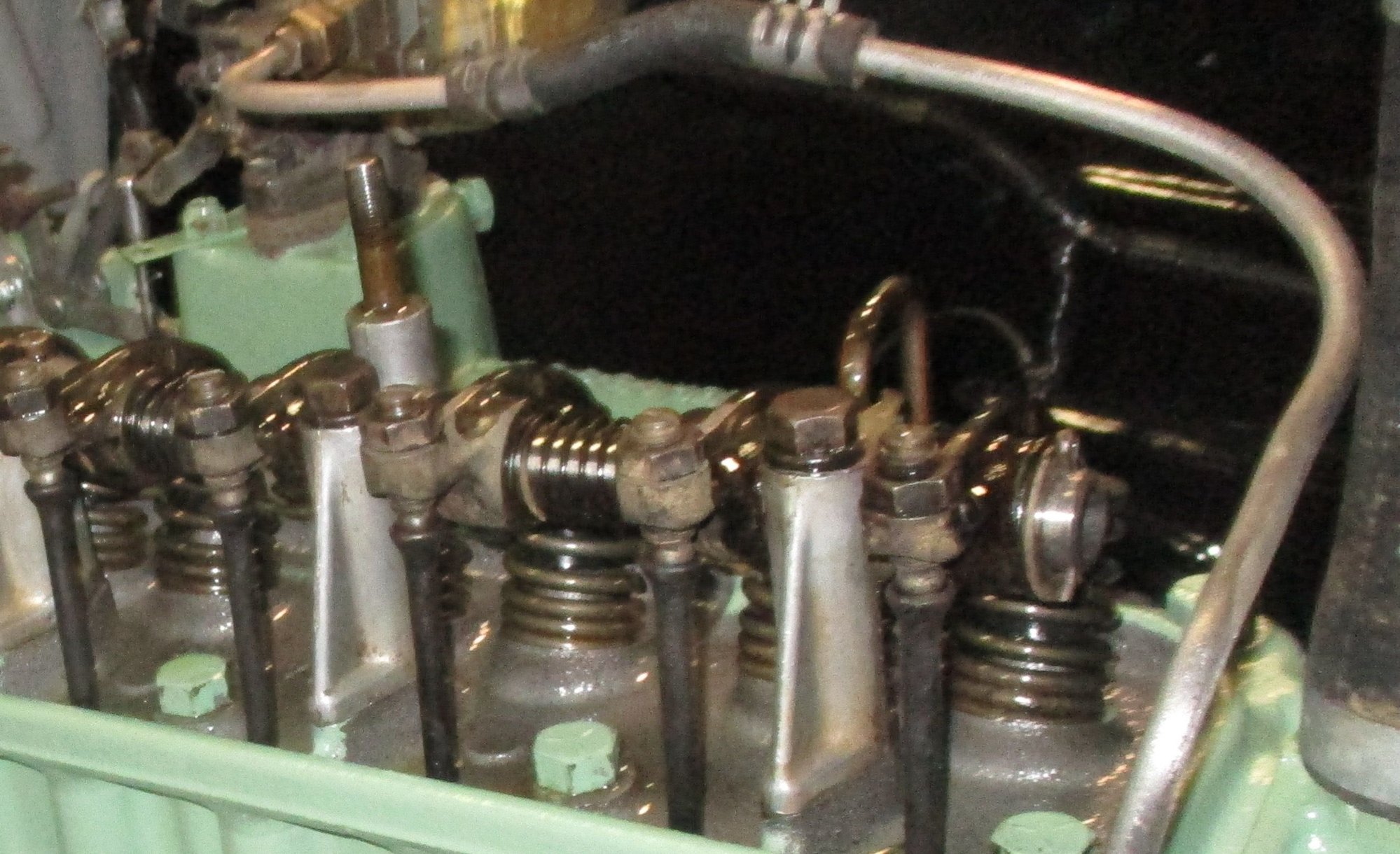

Just for comparison, this is what my valve train looked like the first time the valve cover was pulled. The engine had about 80,000 miles on it and was pretty well worn out. I would think though, being a military truck, it would have been serviced regularly. For the rebuild, I believe all the various parts of the valve train ended up within spec and were reused.
Jim
ps Correction. Some of the valves were replaced.

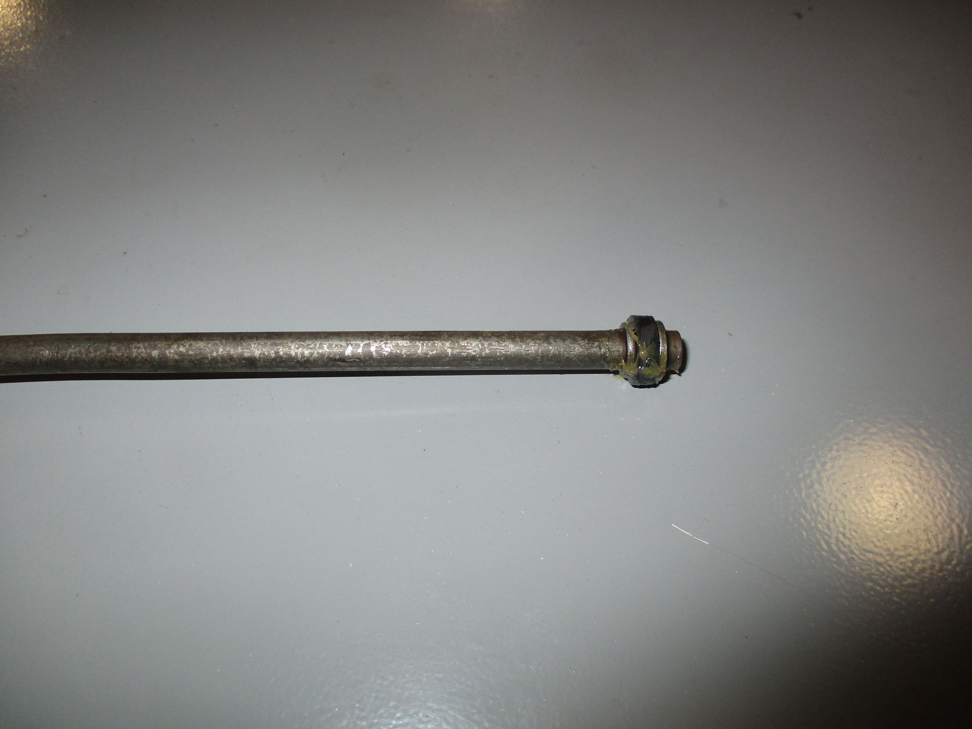

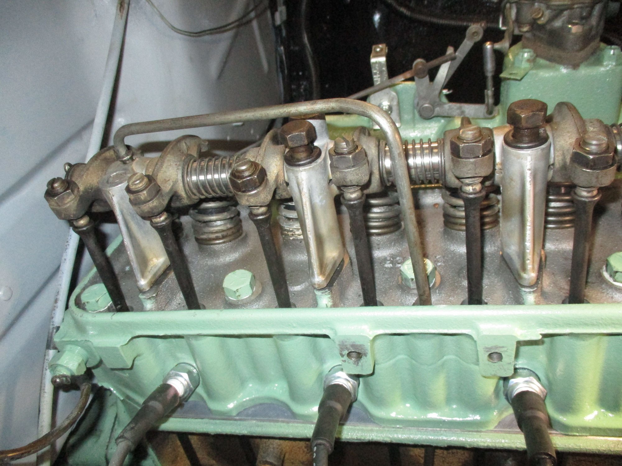

Here are some more pictures of the oil feed tubes we were talking about--there are two of them--one on each end of the engine:
Jim
Jim
Ok my oil tubes are rusted through in multiple spots, and i already took the top end apart and cleaned the 1 in deep sludge out of the head and put it back together. Ok wow only 80,000 miles, mine has over 150,000 miles and still pulls strong. I will make new tubes out of fuel line that i have laying around.

OK, read some more and i think my current oil tubes are homemade as they had no o-ring or retainers for one and were the same size as the fuel line on the truck.

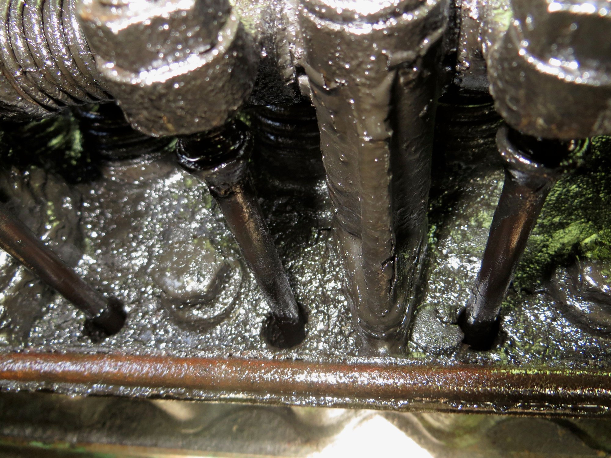

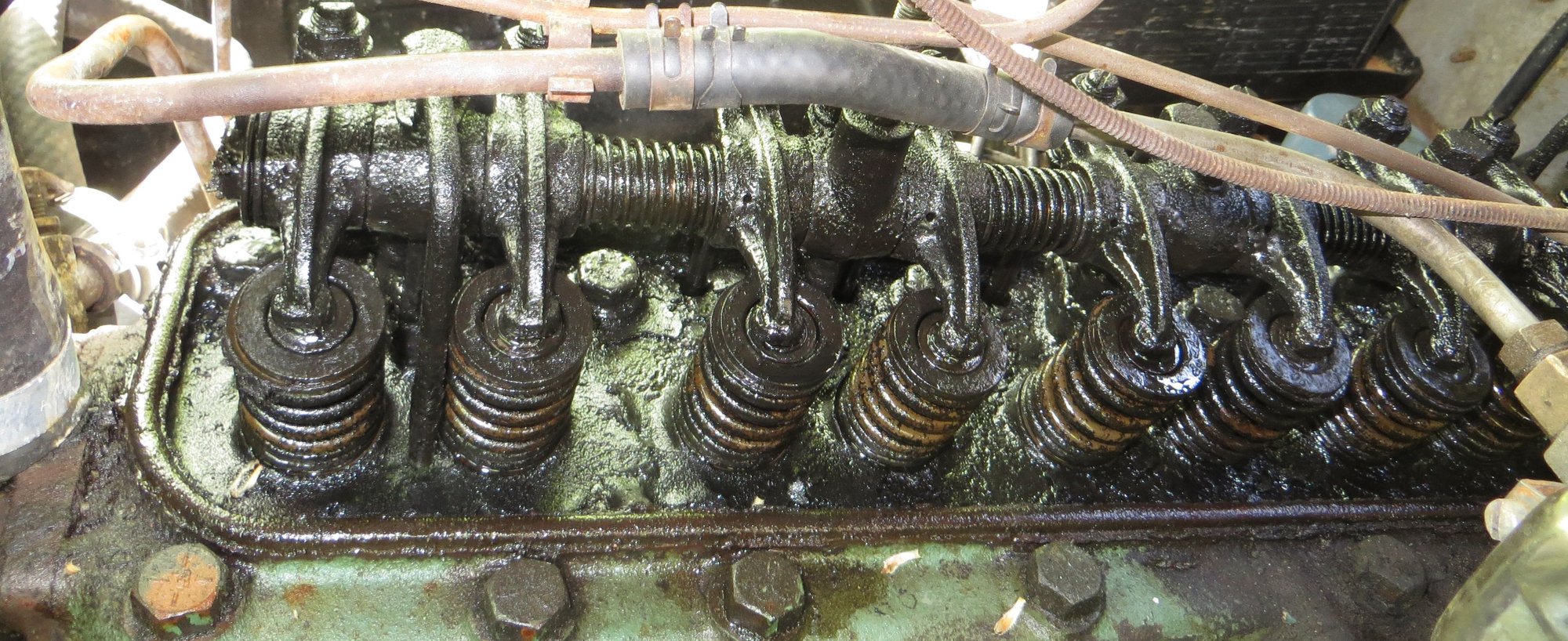

I found some better pictures of the sludge in my engine. As mentioned, I didn't have to replace any of the valve train parts in the rebuild. Everything was just cleaned up and re-used. Good luck fabbing up replacement oiling tubes. Hopefully you'll be up and running again and be able to stay within your budget.

I'm no expert and can't comment on how important the o-ring seal is on the oiling tubes. I do remember that there are little metal clips that hold the tubes in place. The clips keep the tubes from moving, not the o-ring seals. It's likely though that the oil is moved through the tubes by vacuum or pressure, in which case, some type of seal will be required.

heh wow you can see the bolts for the head
mine were covered in sludge
