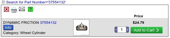

That is the original Wagner Lockheed kit number. You probably don't want an original stock kit as the seals may have deteriorated. Additionally, a generic 1 1/2 bore kit marketed as a Wagner Lockheed K-5379 replacement may not be of the best quality and have a less than desirable fit, and some even skip out on what is included. Heck, even more reputable kits by named brands have these issues, including fitment especially if the wheel cylinder is of a different name brand. Hence my recommendation to go with a complete cylinder to avoid headaches on such a critical system. Thinking further on you every penny counts budget, if going the kit route, you need to factor in the copper crush washers - the 91A-2149 with a .45" inner diameter and a .69" outer diameter - which are not reusable. They are generally included with the new wheel cylinders. A few bucks here, some shipping there, and all the sudden, the kit savings over new cylinders significantly diminishes or even evaporates. This is not even considering additional costs incurred if the kits are duds or a cylinder is found not to be salvageable.
Going back to the generic kits, many pictured on the internet auction site seem to show pictures of NAPA parts - when looked up, things don't quite line up:
UP 725 for the cups - 1 1/2 bore - plausible
UP 5975 for the boot - Interestingly a bore diameter listed as 1 3/8 and not 1 1/2... this should set off some well deserved skepticism.

The wrong parts are the wrong parts regardless if cheap or DYI... and brakes are a CRITICAL SYSTEM impacting SAFETY! Save up and do this right.
Reiterated: A few bucks here, some shipping there, and all the sudden, the kit savings over new cylinders significantly diminishes or even evaporates. This is not even considering additional costs incurred if the kits are duds or a cylinder is found not to be salvageable.
Really, $24.79 a cylinder is breaking your budget? Kits on the internet auction site with boots, cups and springs are $14 or so... add on the copper crush washer, shipping and taxes and and it just doesn't make much sense...
