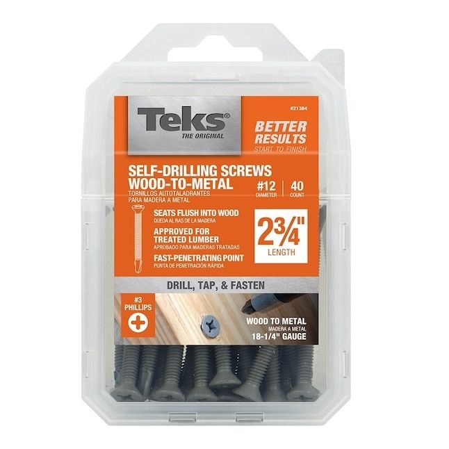

It looks like Lowes has the fasteners as well.
https://www.lowes.com/pd/Teks-12-x-2...-Count/3316526

They are probably cheaper in price also. Teks are a strong screw

I used them when I put a new wood floor down on my car hauler. They worked great and saved me from drilling mounting holes into the steel floor braces. They do pull down tight and bury their head flush with the wood

Maybe it's just me and an issue I have with working over my head, but I don't usually have a lot of luck with self tapping screws of any kind in thick steel on ceilings. I used Teks screws for my trailer bed and for putting 2x4s on the side walls of my steel building which worked out great, but I tried them when I needed to put up a few 2x4 stringers for ceiling fans in the steel and I couldn't get enough leverage for them to bite. I ended up drilling 1/8" pilot holes first and then I was able to use the Teks screws.
Of course I was working alone, standing on a extension ladder 25 feet in the air so maybe a scissors lift will be better and provide more leverage but I'm not sure.

There is different types of tek, or self drilling screws. You may have the wrong ones.

Used the same ones I used on the wall, same steel. Wall ones went in fine, I think it's more me than the screw, working above my head with bad shoulders (bursitis in both), can't get the push force over my head.

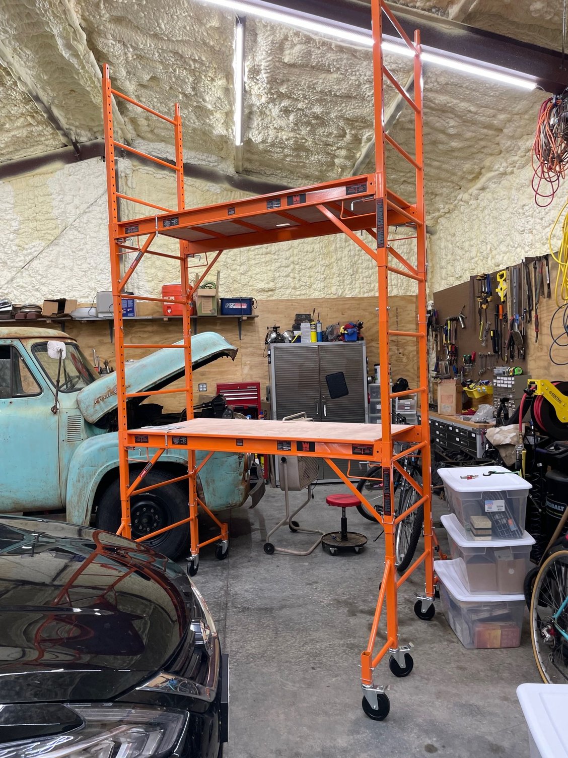

Well after talking with a bunch of enablers at the Ozark Mountain Run I decided to buy a set of scaffolding. I figure I can sell it when I'm done. Also with this I can work at my pace. I can't threaten my membership of the procrastinators club.
Renting a scissor lift would be pretty just as much unless I would get the work done all in one weekend. Yeah, like that would ever happen.
Notice my wife's storage tubs encroaching more and more. Those tubs are stuff from her office while they do a remodel. They have been there for 2 to 3 weeks now.

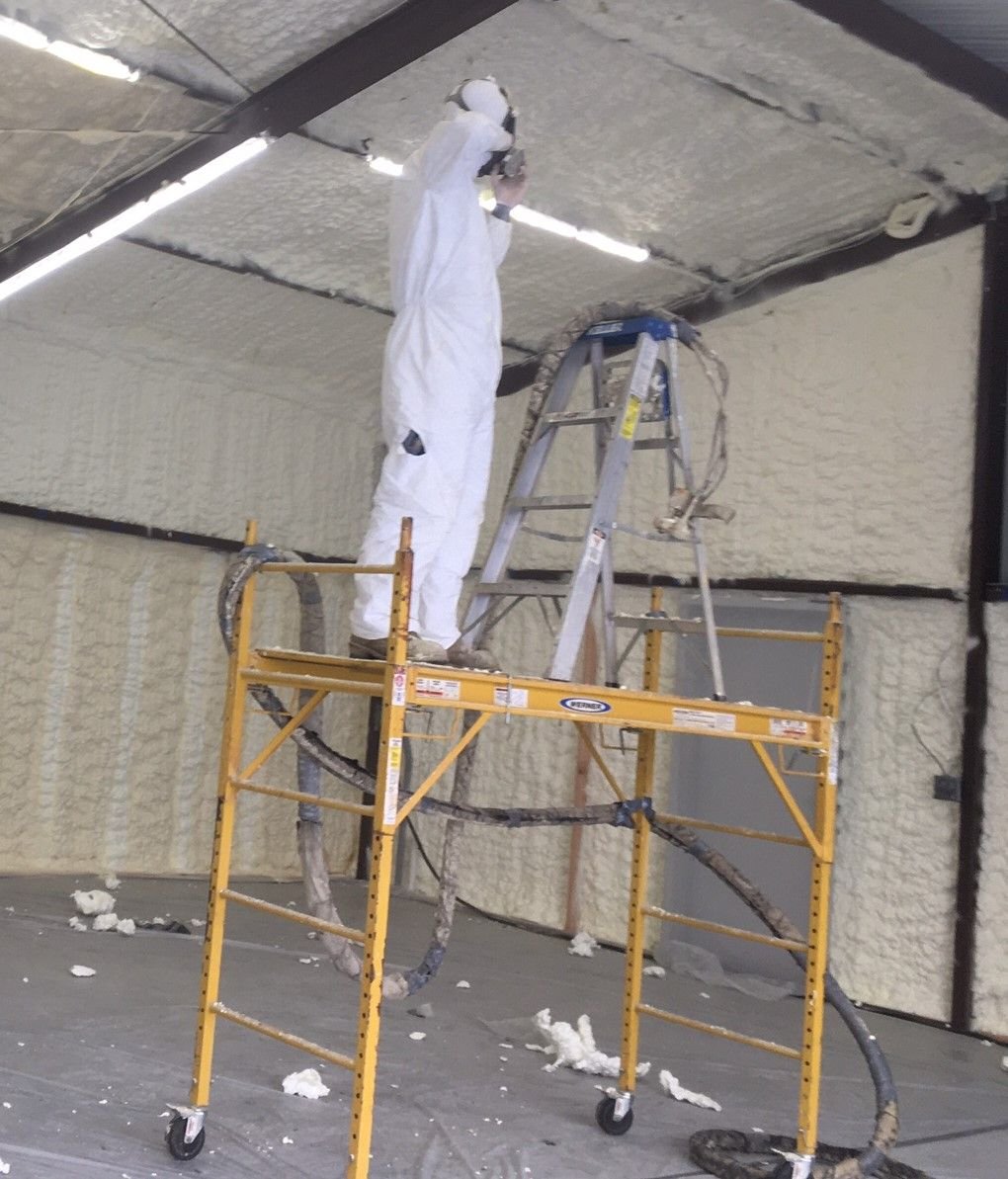

The two level scaffolding seems a little safer than my insulation guys with a ladder on top of the scaffolding.

If you are using that scaffold 2 sections high, be very careful. Those have a habit of flipping over. When you are that high. Also consider putting some sort of guard rails around the outside at the height you are working at. could be something as simple as 2 x 4 wired to the scaffold
Safety is no accident..
also, they make outrigger wheels that attach to the scaffold sides that help prevent tipping....and make sure your floor is swept well, a 1/4" washer can stop you cold.
