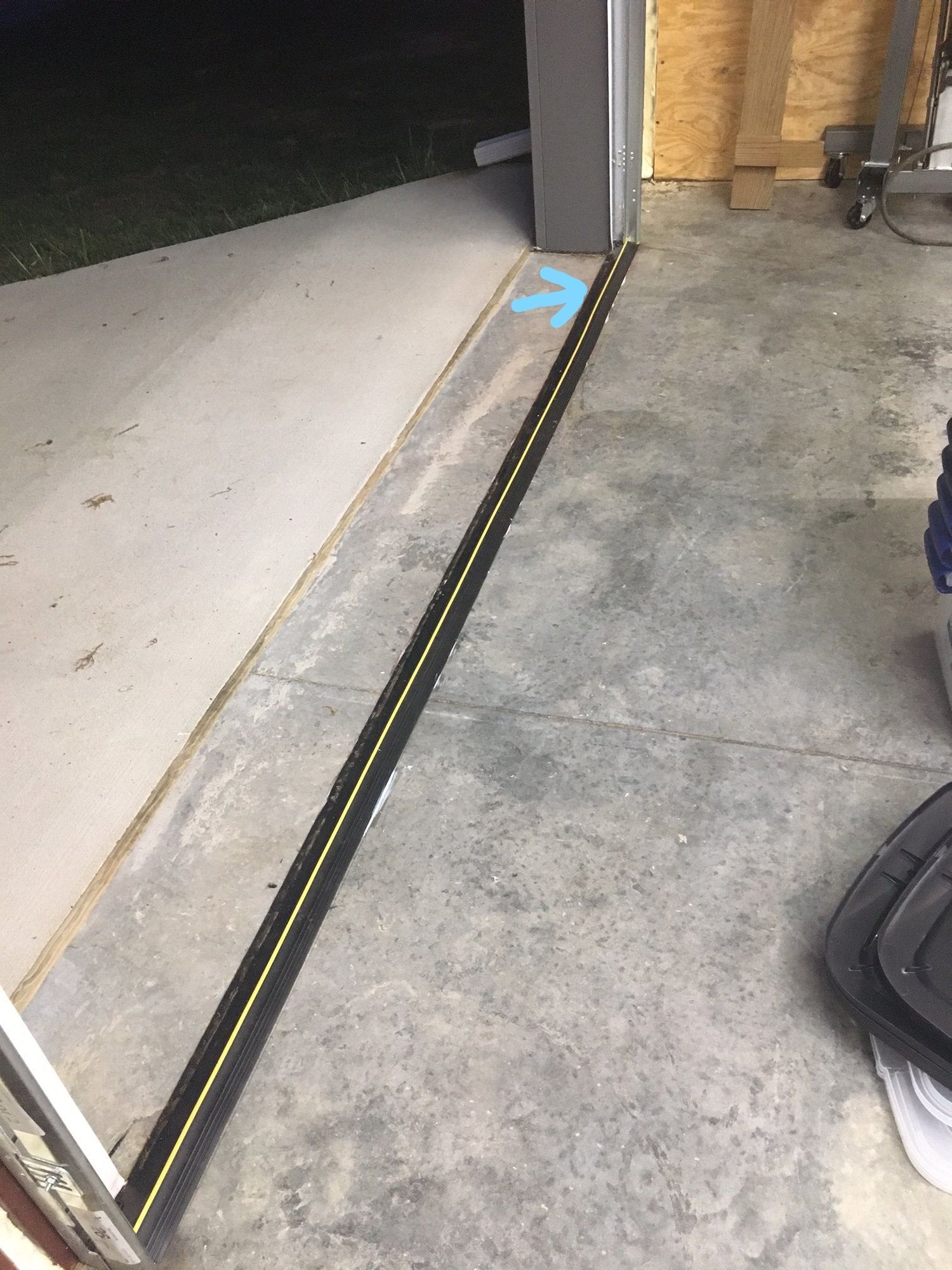

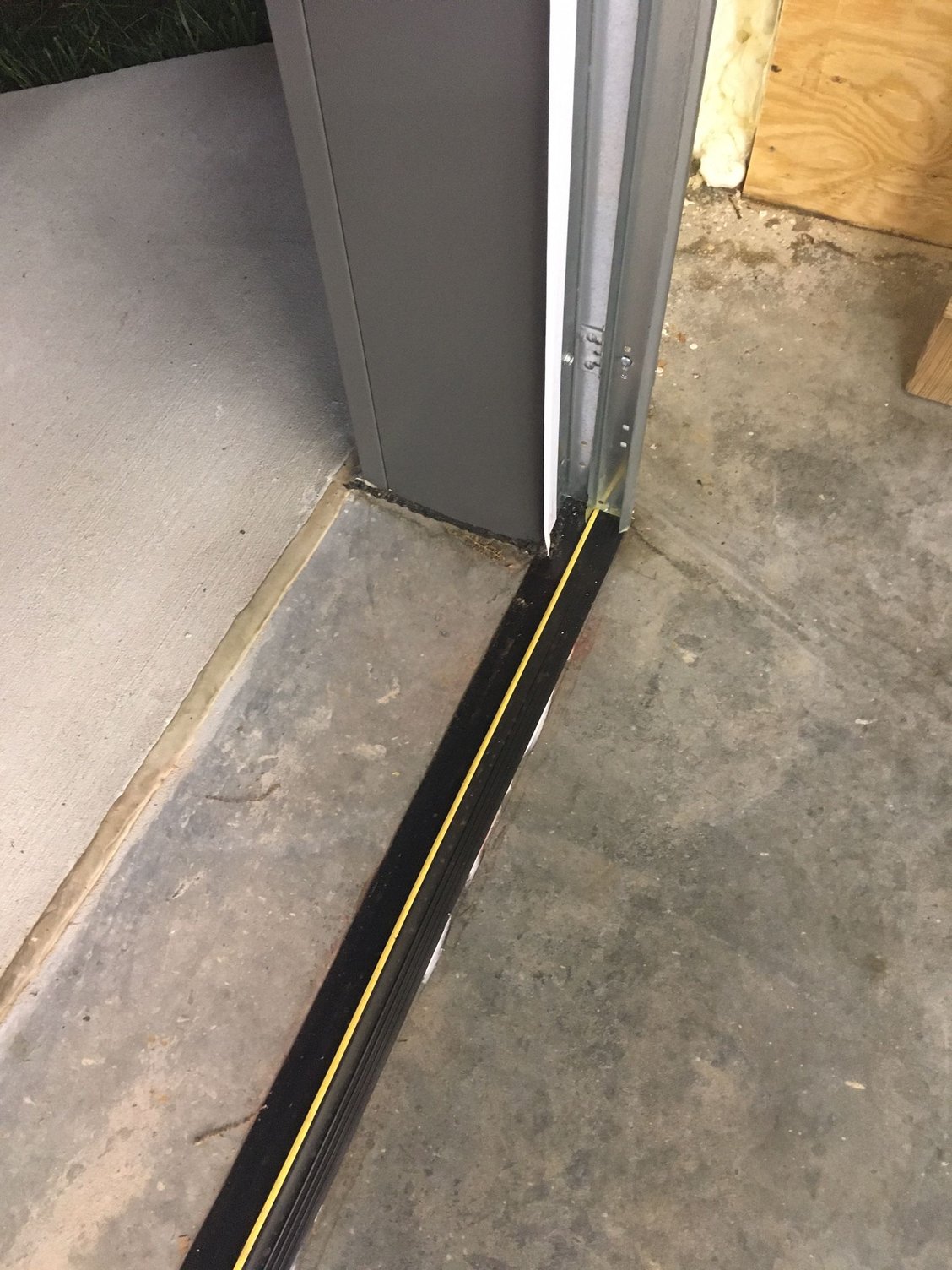

So my concrete pad slopes slightly towards the door and that has been causing lots of water to get into the garage. The pad has a low spot near a corner of one of the doors to make the problem even worse.
So, I bought some
garage door thresholds garage door thresholds
. I got them installed the other day. They do a pretty good job, but we have only had one rain since I installed them.
That time, I had a tiny bit of water in the garage and some water sitting outside the garage at the threshold. We will see how it goes when we get more rain.
The blue arrow indicates the main direction of water flow.

Looks like yours is sloped in the proper direction. My doors have a bottom seal on them, but they just weren't cutting it. It was mostly going around the ends of the seals. You will most likely be fine with the slope you have and the standard garage door bottom seals.

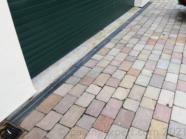

There is a fairly elegant option to address your drainage needs, it's called a linear channel drain. While these devices are easy to install at the time the pavement is poured, it is still possible to install them afterward, you just have to cut the channel in the concrete. Here is a pic of what one style looks like...

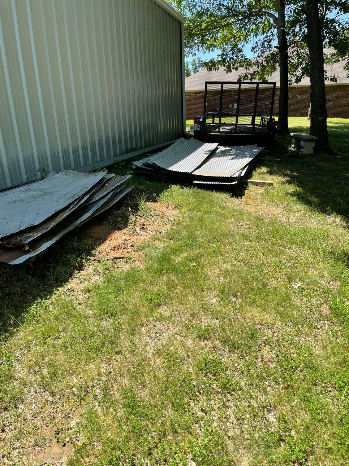

Well, the boss wants barn tin lining the roof and upper sides to hide the ugly insulation. So, I found a deal on a bunch if used barn tin. They are 11 feet sheets about 26" wide.
Now the challenge is getting them put up. I figured I would start at my loft since I can get closer to the roof a lot easier there. I'm pondering if I could use a drywall lift, but I'm not sure one would go high enough for me. I might end up renting a scissor lift.
On Monday I went out and got a sheet up in the loft and was pondering how one person can get something in place. It was in the mid 90's so I didn't last long. This week will have several days over 100. I'm beginning to think this should be a fall project.

A drywall lift will not do this. A scissor lift will be your best friend here. Best done with two persons.
