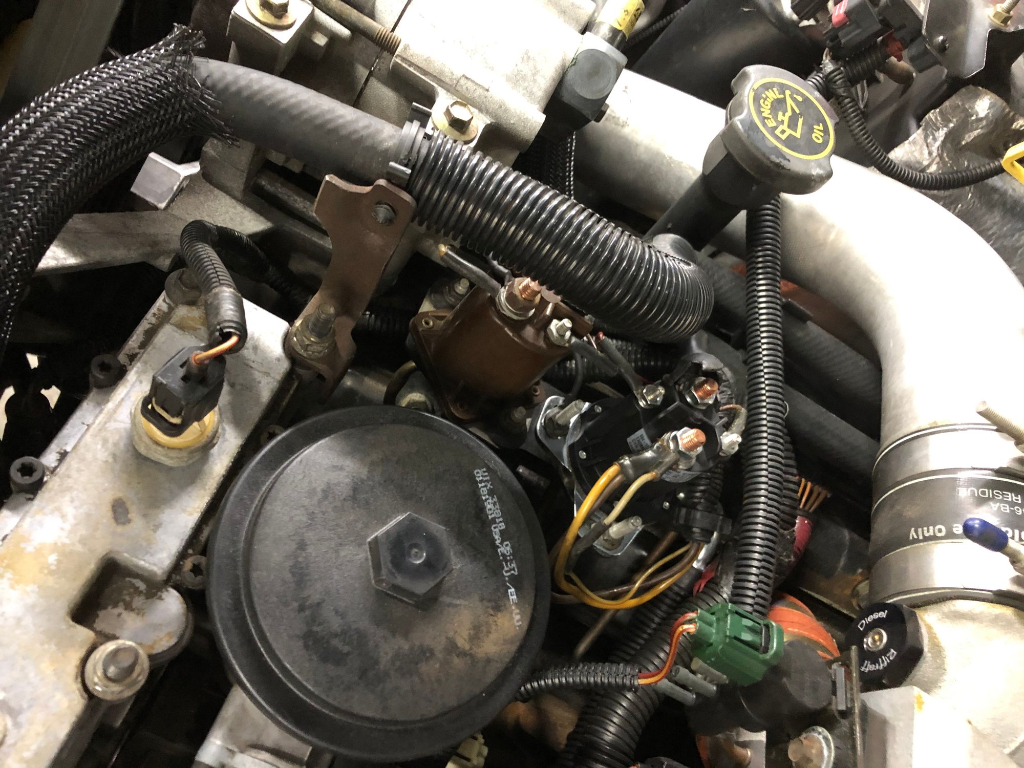

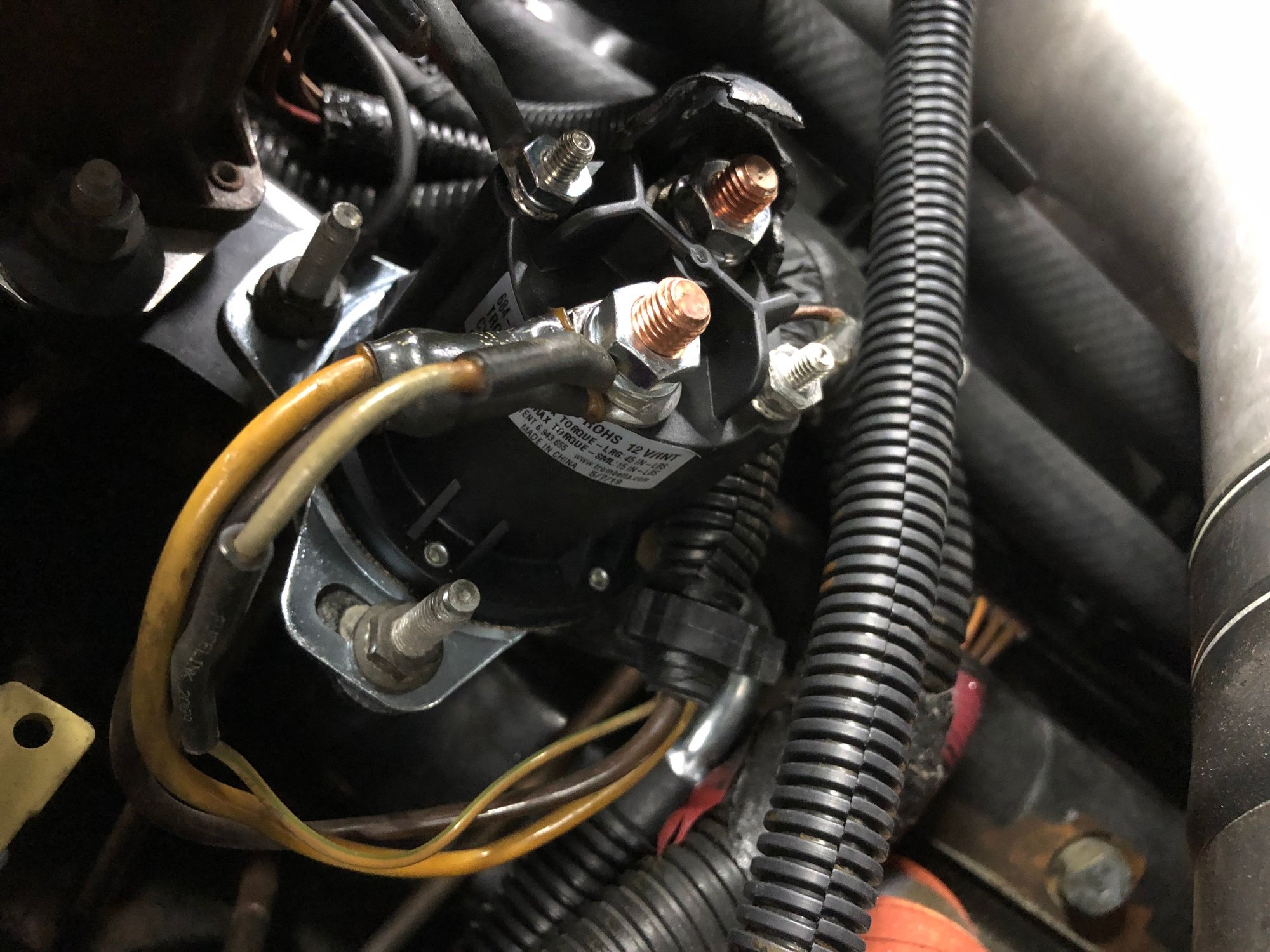

Trombetta glow plug relay install
Dont get much easier
trombetta part # 684-1241-212
$18.35 on amazon
https://www.amazon.com/gp/aw/d/B007W2NCMC?psc=1&ref=ppx_pop_mob_b_asin_title https://www.amazon.com/gp/aw/d/B007W2NCMC?psc=1&ref=ppx_pop_mob_b_asin_title

Where's the photo with the newly installed relay? Did I miss it?

Do you know the amp ratings for this relay? I am curious how it compares to the Stancor

This is what I found for the...
PowerSeal Family
RoHS Certified
800 A in rush, 150 A carry
This contactor is sealed IP66/67 and a great value for many applications
Intermittent Duty
  • Carry Current 150 Amps, Inrush 800 Amps
  • Available in 12 or 24 Volts
The power you need for high amperage applications along with the sealed construction gives the PowerSeal its name. The PowerSeal’s unique design gives it the longevity to last and be used in the harshest environmental conditions. Intermittent duty PowerSeals are used on hydraulic power packs, RVs, heavy truck starting and grid heaters, and lawn and garden applications.

Sorry guys was busy finishing headlights and grill

For those who are curious and so that information can be found in one thread;
the stancor is rated for 200 amp carry and 600 amp inrush.
Nice job on the install. It is coming along well.

You used the intermiitent one .most are using the continuous solenoid. .the continuous uses less than 1 am. The intermiitent uses like 3 amps? Wouldnt continuous be easier on battery?

Nice work Chris! Why did you choose this over the Stancor? I went with the Stancor when my GPR died. Just curious...
Old Mar 24, 2021 | 11:21 PM
97vanswap's Avatar
97vanswap
Joined: Apr 2015
Posts: 341
Prob because it is 1/4 the price if a stancor and a direct fit.
