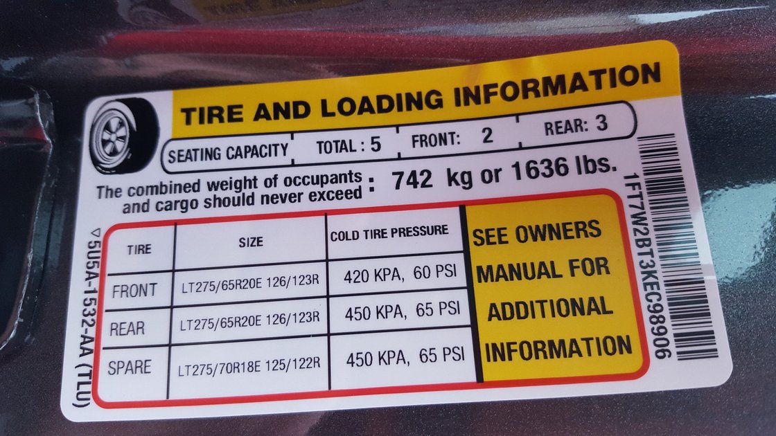

Well, my 250 with the high capacity tow package has a payload of 2355. Not what you will get in a 350, but still well above 2k. To get down to 1900, that would have to be a lot of bells and whistles added on (Possibly the long bed too).
You can get it down to 1636 if you go long bed and check enough boxes on the build sheet!
🤣 throw on some aftermarket accessories and its a diesel mini van.
Wow, that's low. That's 600lbs. less than my CCSB Lariat Ultimate F250.
