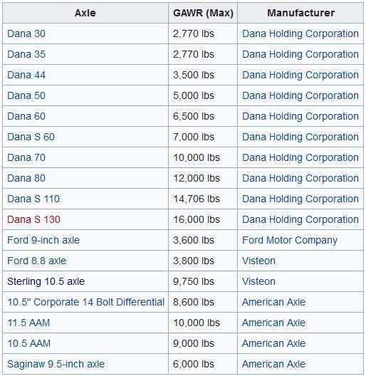

The Sterling 10.5 axle has a GAWR of 9,750lbs.
Think about it. The payload on my truck is almost 4,300lbs. Add that to the weight of the truck, and I'd be at or over your 6,340# figure. Ford isn't that dumb. 6,340# sounds like the tire ratings on the rear axle to me...

https://en.wikipedia.org/wiki/Gross_axle_weight_rating
http://www.fourwheeler.com/how-to/tr...nch-axle-tips/
Just a couple for now...gotta head off to work

Originally Posted by ATC Crazy
Interesting. 9750lbs it is from 1999 on. Looks like they rate it to 26,000 GCWR.
More than good for me.... glad I got this crap wimpy F250 diesel.
Hmmmm. So what's the manufacturer rating (not the Ford rating) on my 2017 F350 DRW? I gotta go look up which axle it is again. Last time I tried to find that data, no one had it published yet.
