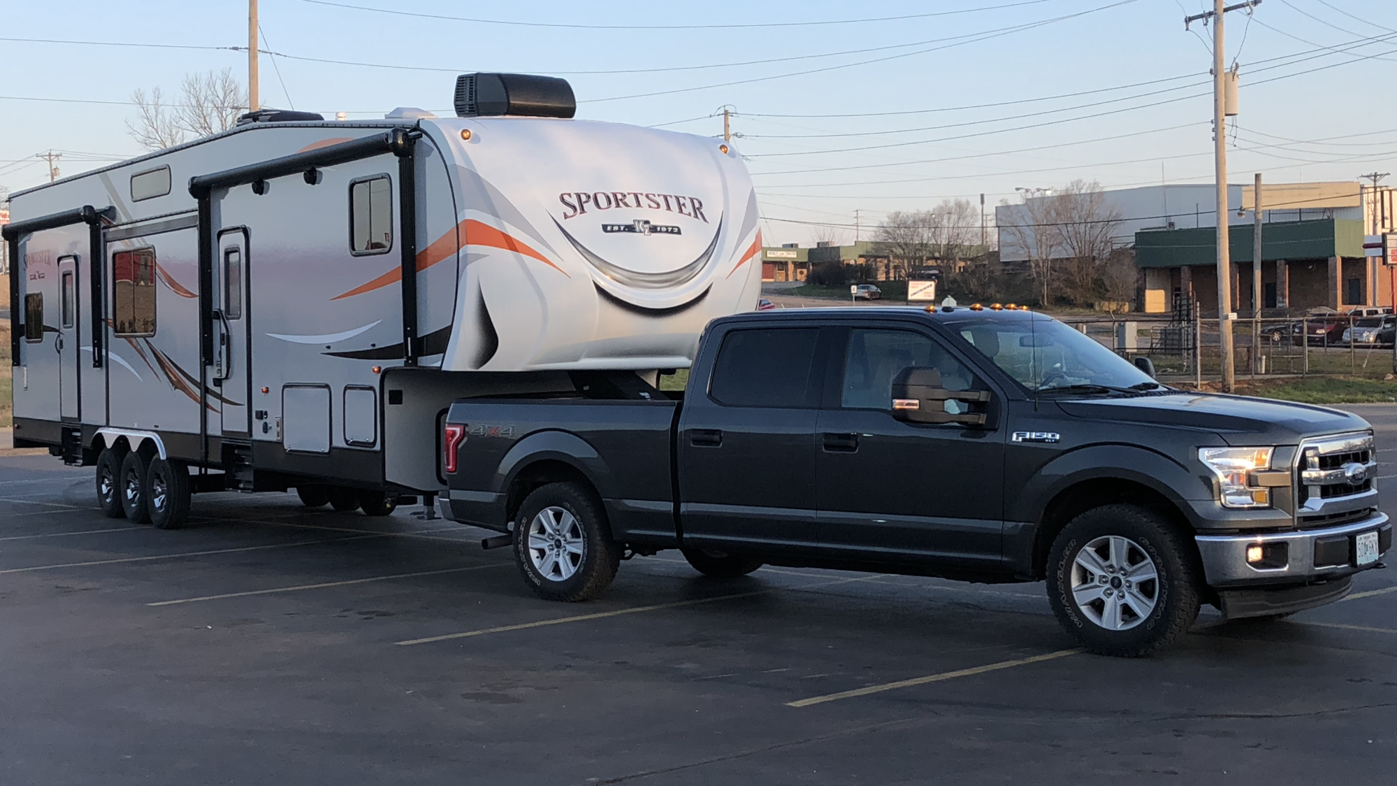

When I had this 17 F150 Heavy Duty Payload Pack 5.0L truck, i was attacked daily on the F150 side of the forum. Was told im going to crash and die and then be sued to hell and back. 🤣
I was always within 100lbs of the door jamb payload sticker of 2,523lbs. 8,000 miles of towing in 10 months and Never had problems with breaking or handling. GCWR was exceeded by about 1,500lbs when trailer was loaded. Power was great, mileage towing was the same as my dually when dually was stock (7mpg).
People would tell me im a liar and no way it had 2,523lbs payload. Blah blah.
Its all about what your comfortable with and if it handles the load well or not.
Traded it for a dually PS bc the Coyote kicked the bucket in Colorado while running 89oct gas thru it with a 93oct tow tune. 🤦🏼*♂️ My fault.
