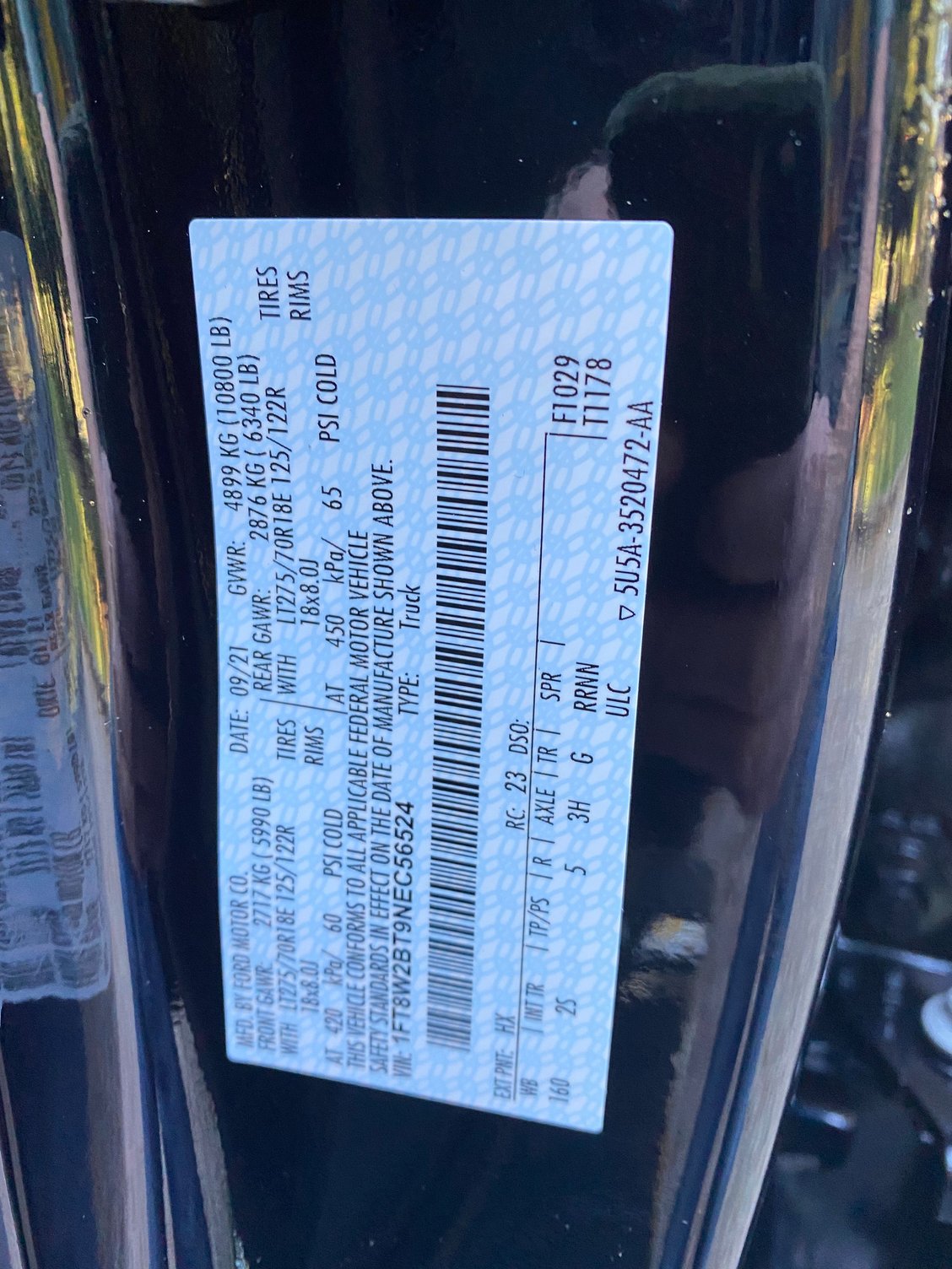

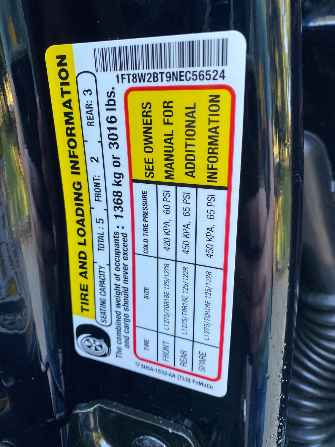

Originally Posted by willhh3
Hey All: Just got back and catching up from my original post. Reading this statment:
"250's come with a 10000 GVWR unless they choose the HCTT package which makes it 10800 lbs. No 250 will have a listed GVWR over 10800 lbs."
My 2017 F250 Crew 4x4 which has a GVWR of 10,000 on the sticker. I have the HCTP and my payload is only 2225. Also just noticed the hitch on the bumper says 21,000lbs. So am at 10,000 or 10,800 as the comment suggests. Wish this was easier! I'm looking to get a 13,000lbs (gross) 5'er with a 1817 pin weight. Anyway I shake it, I'm over on payload. I'm confident it can handle it, but no matter what I do the payload will be over. Blah! Wrong truck. With that payload I'm probably better towing a bumper pull.
Sorry, I may not have made it super clear, but in this post that you quoted I was referring to my 2022. The GVWR’s changed for the 2020+ F250’s when adding the HCTT package. Your GVWR will be on the door jamb sticker. Here’s a picture of mine.
Also, I posted it earlier, but the payload on my 250 ended up at 3016 lbs! I’m pretty happy with that number (considering it’s with the 6.7), although I am towing a relatively light bumper pull and have no plans for a 5th wheel. We like the smaller campers so bumper pull will (likely) be all that we are interested in… Here’s a picture of that sticker.
Thanks for clarifying. Mine is 10,000 GVWR and Payload of 2225. Pretty low and disappointing considering the HCTP, extra leaf, etc.

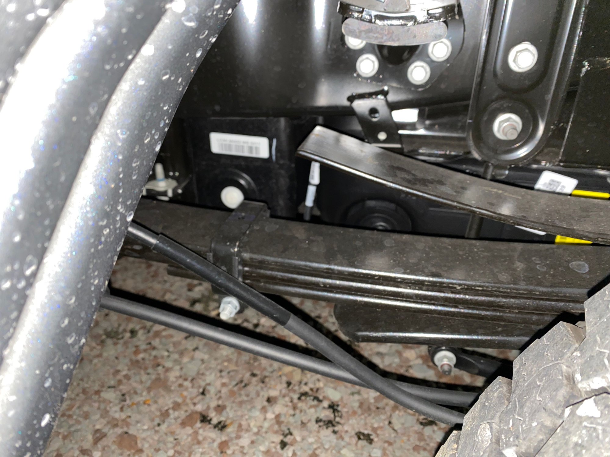

Originally Posted by 67L48
Are you sure about that? The last time I saw the spring pack guide that someone posted, the 350 still had one more spring. The only 250 config that had the same spring pack was the F-250 2WD LB Gasoline HCTTP ... which, of course, is only available when delivered by unicorn-riding leprechauns. Maybe they updated the Spring Selection guide?
I'm not sure if the guide was ever corrected but as far as I know, in 2020, along with the increased GVWR of the HCTT package also came 5 leafs.
Would you mind posting a pic of your leaf springs?
Old Sep 28, 2021 | 03:15 PM
  #232
JD'sBigredv10's Avatar
JD'sBigredv10
Here ya go. From what I told (in another thread on this forum), this was 5 springs. But, it was the camper package that added the extra springs. The HCTT package only added the Dana M275 rear axle.
Actually it is the HCTT that made it 5. The camper package(without HCTT) just adds that top leaf, making it a 4 leaf pack.

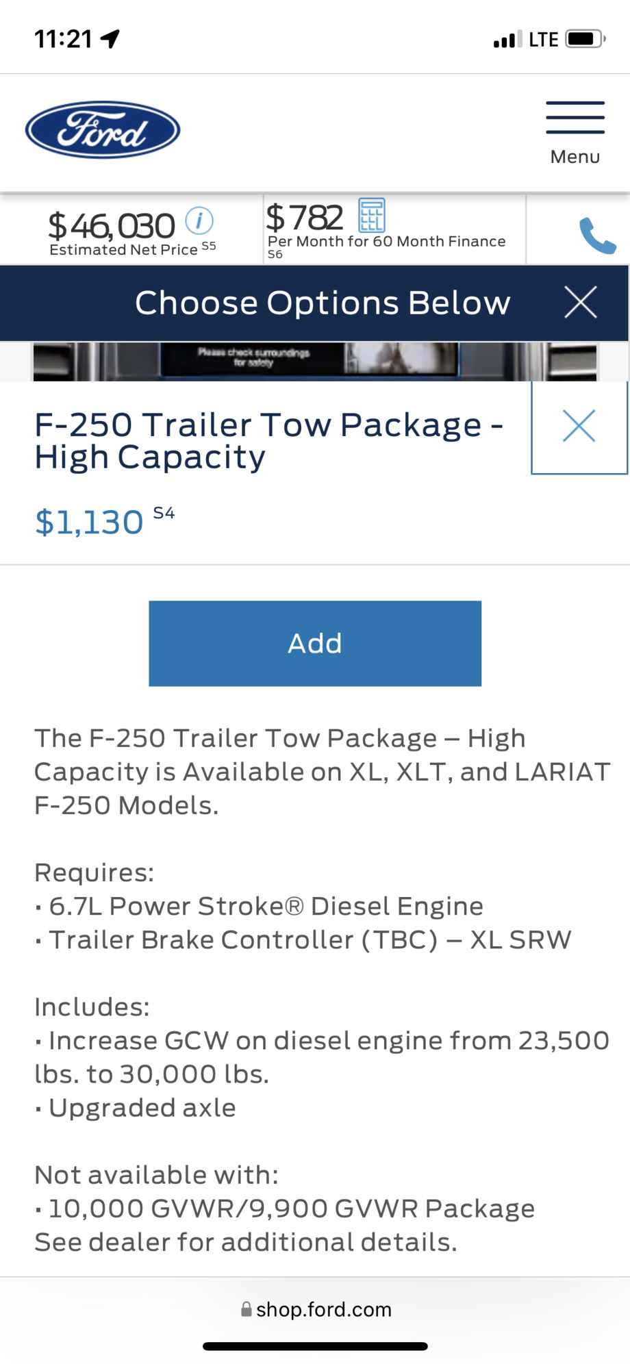

I guess that is what the “Increases GCW on Diesel engine from 23500 lbs to 30000 lbs.” refers to then? It only mentions the axle upgrade. I figured it would have specifically stated it added a rear leaf spring like the camper package does.
The package increases the GCWR, I assume from the combination of parts (axle, leafs, reciever). It also gives you a 3" reciever rated higher than the 2.5". It's not a new package, and I don't recall it ever including the additional spring(s) in the package description.
What is new as of 2020 is the number of leafs. 17-19 the HCTT got 1 additional leaf over the standard 3 leafs that come on an F-250 (making it 4 total), 2020+ it increased to 2 additional leafs, making it 5 total. It's possible that had some influence on the increased GVWR with the package as well, who knows.
In your case, having the HCTT pkg, adding the camper pkg was like adding it to an F-350, it got you a rear sway bar, 1-up front springs and a camper certification paper.
