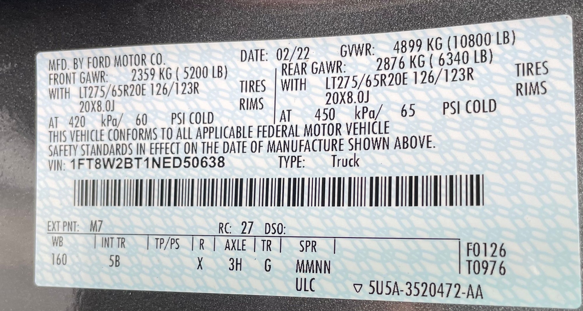

I’m surprised at how many low payloads you guys are reporting for your F250s.
Here are the stickers from my 2022 F250 6.7L diesel Lariat FX4. 2,814 lbs payload.
My GVWR is 10,800. I suppose a lot of guys go for the 10,000, and lose 800 pounds of payload, at least on paper. No problem registering or insuring the 10,800 here in Maryland.
Besides the fact that not all 250's are optioned with the higher GVWR package, this is the 17+ forum, so some posts are from owners of 17-19 SD's. No matter how a 250 was optioned 17-19, they only came with 10k GVWR.
To add to that, this post is FROM 2017 (someone dug it up from the graveyard a few days ago), so those first few pages all of those trucks were 10K
