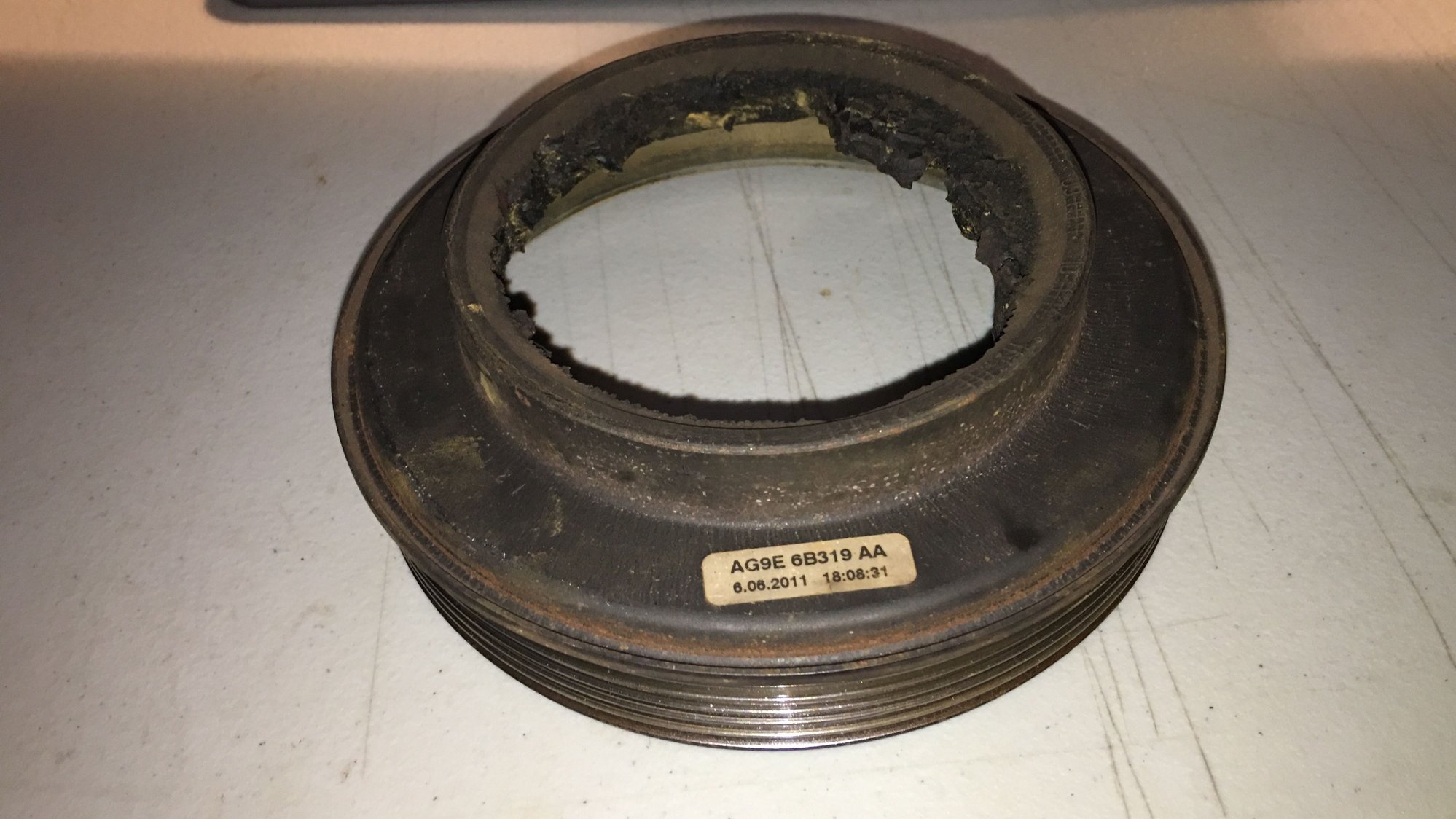

I think I jinked us.
I got a call from my wife on her way home, not far away. A loud bang and some noise. Pulled to the side of the road and shaken.
Nothing under the vehicle or dragging; I had her start it, and it sounded OK. We switched cars, and I drove it home. When the A/C compressor would engage, it was noisy, so I turned the A/C off.
When I got home, I started to hunt for a new A/C compressor and then looked under the hood. I could figure out why the belt was fine, but a pulley was between the frame and the A/C compressor. It wasn't the A/C compressor; the harmonic dampener/pulley came apart. The pulley ejected, the rubber mounting tore, but the fan belt came off the pulley and landed on the dampener part under it. So the belt's ribs ran on the smooth surface, and the tensioner took up the slack.
One of Ford's extraordinary designs, the harmonic dampener/pulley, is not keyed to the crankshaft, so when you remove it, the camshaft's timing gear behind it can move. So to replace the pulley, you have to lock the crankshaft and the camshafts in place. And the pin that holds the crankshaft can't be stressed, or it breaks, so the procedure is to use a strap wrench over the pulley to keep it from turning while you deal with the crankshaft bolt.
They say you must use an impact when removing it, but hand tools when installing it, without moving the pulley or crankshaft. 74 lb-ft, then 90º.

Les was still freaked this morning.
It don't look right.......

What motor is this? that sounds nuts!

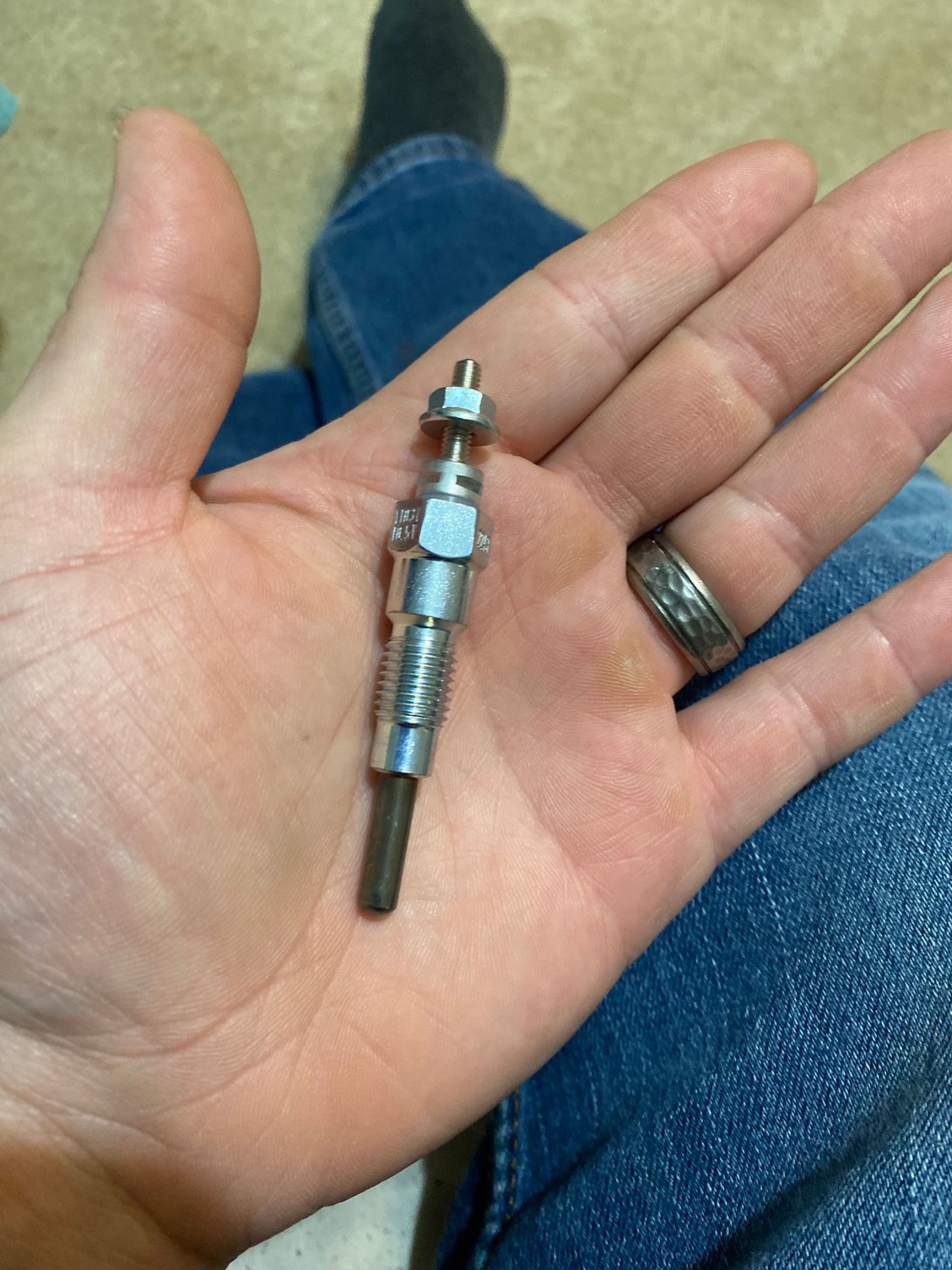

koochie koochie coo. Its so cute. Little baby glow plug.
