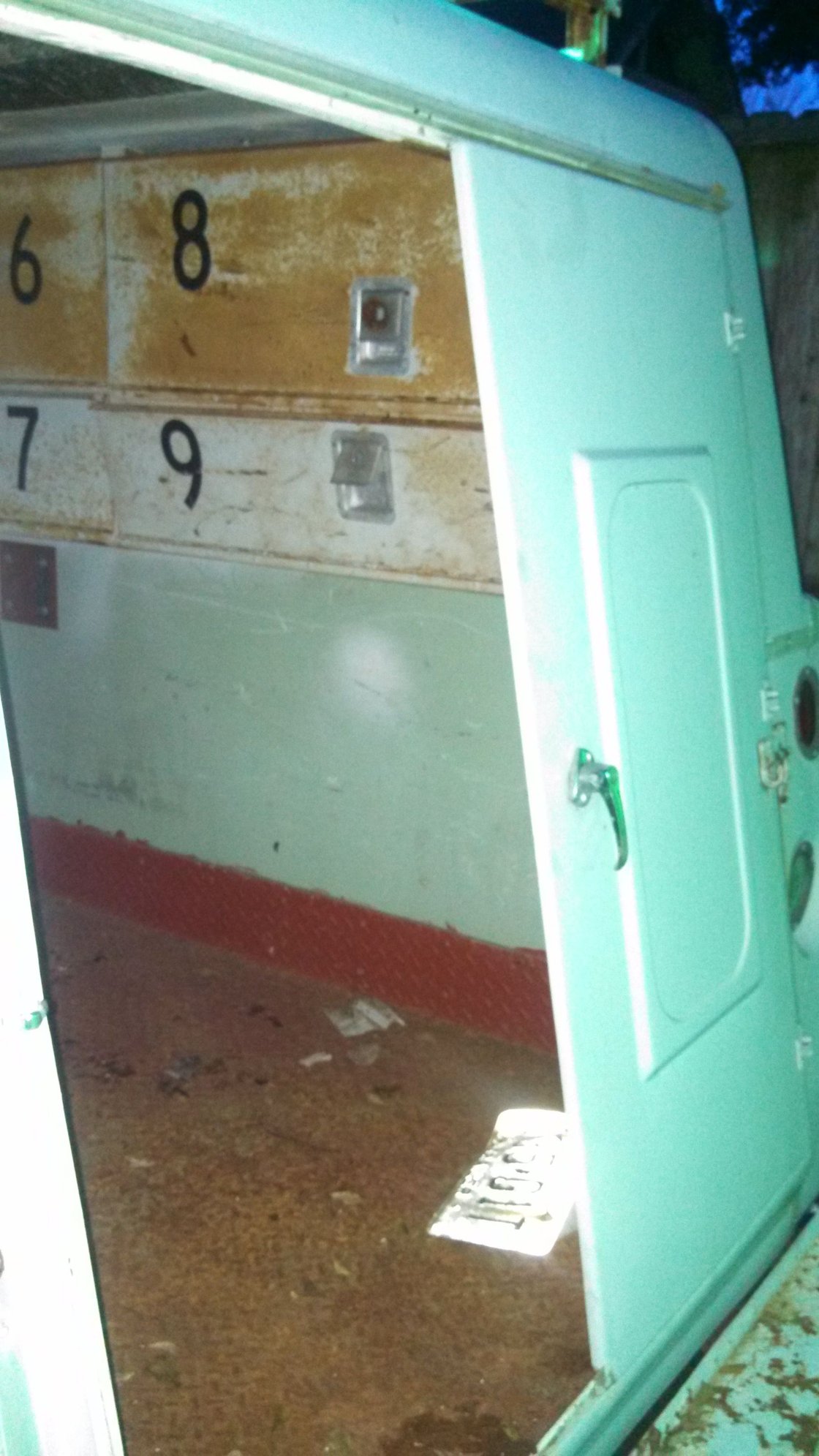

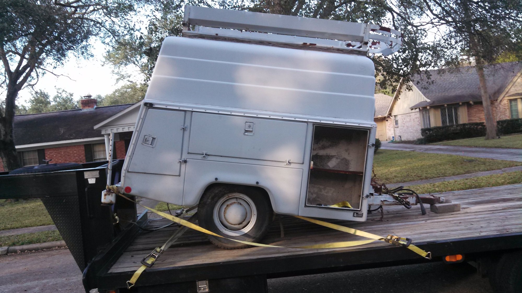

Have I ever posted this? My plan is to turn it into a "chuckwagon" that I tow behind my camper. Made by the Astoria Company many years ago (I forget) as a lineman's trailer. It's got a single 7000lb axle and all steel floor and insides. I pulled off the brackets where the reel spun cable out the back door. It was pretty rusty, so I'cleaned it up all over, under about as well as can be done without taking it off the frame. Acid washed and painted all the metal.
The only problem with it is a couple of missing doors. One of the big back doors and one up front. I could get a fiberglass shop to replicate and replace, but I might customize it and outfit it a different way. I want to work on this after I get my ambulance running. Sleep in the ambulance and create an outdoor bar/kitchen/hang out space around the chuckwagon. Bad pics, but maybe you can see the potential. I paid $400 for it.

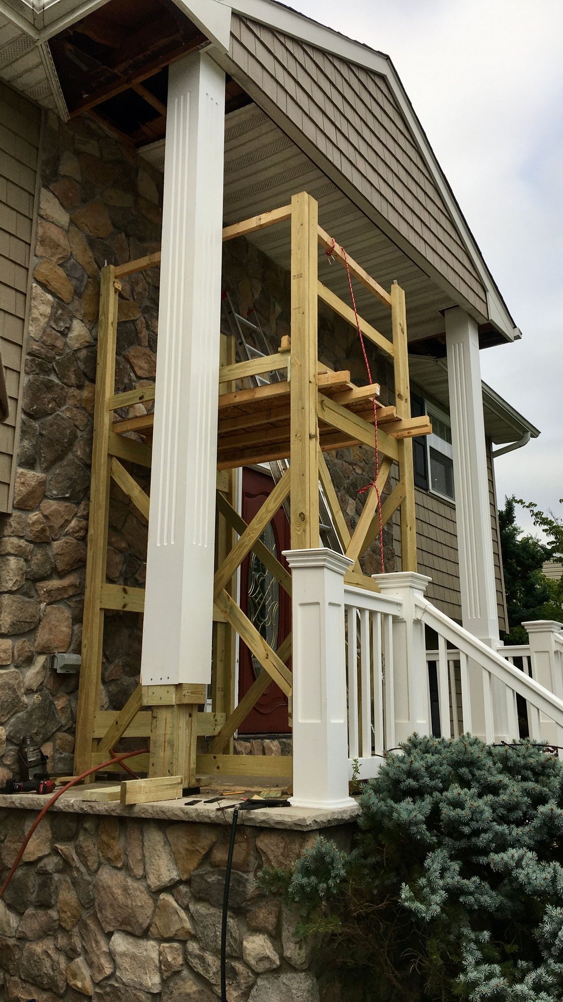

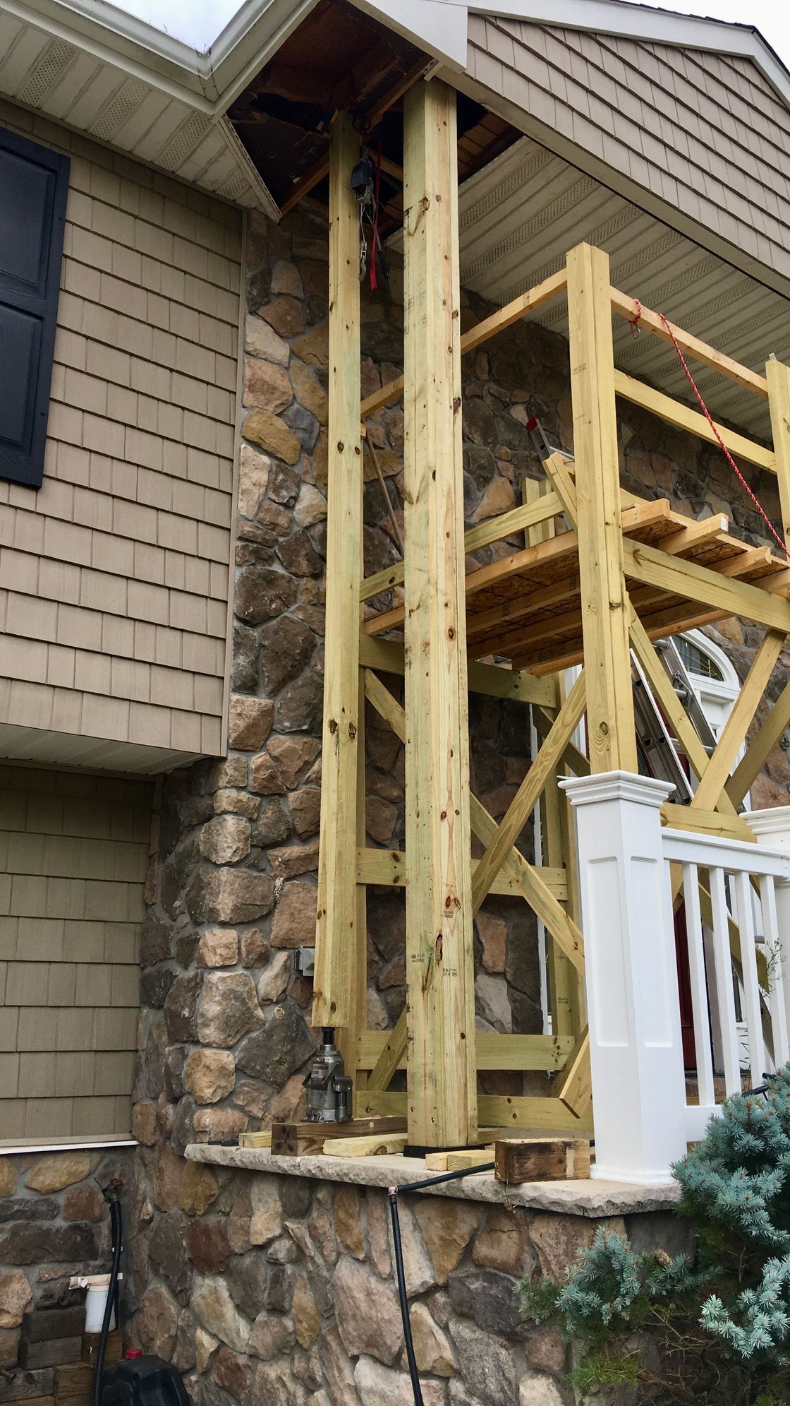

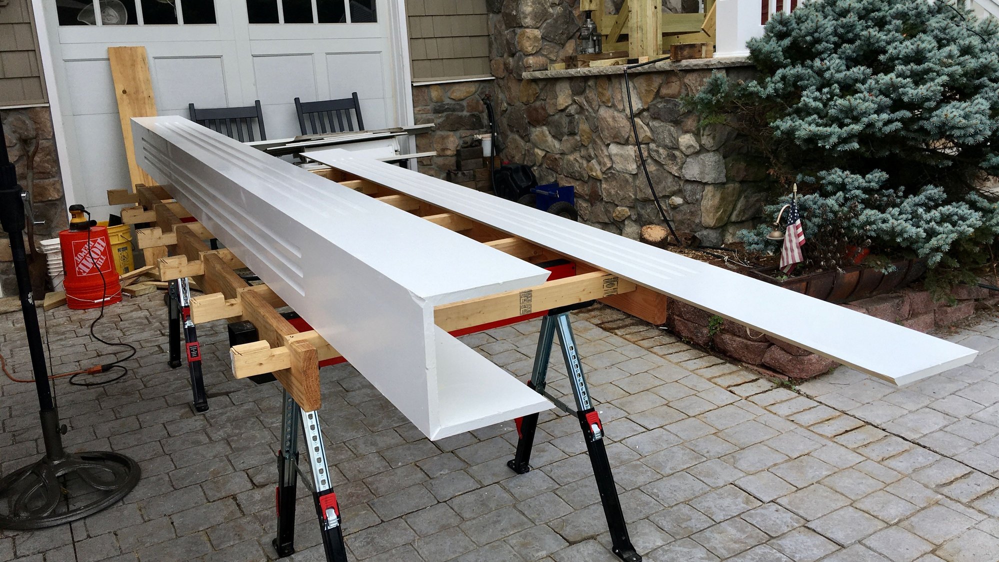

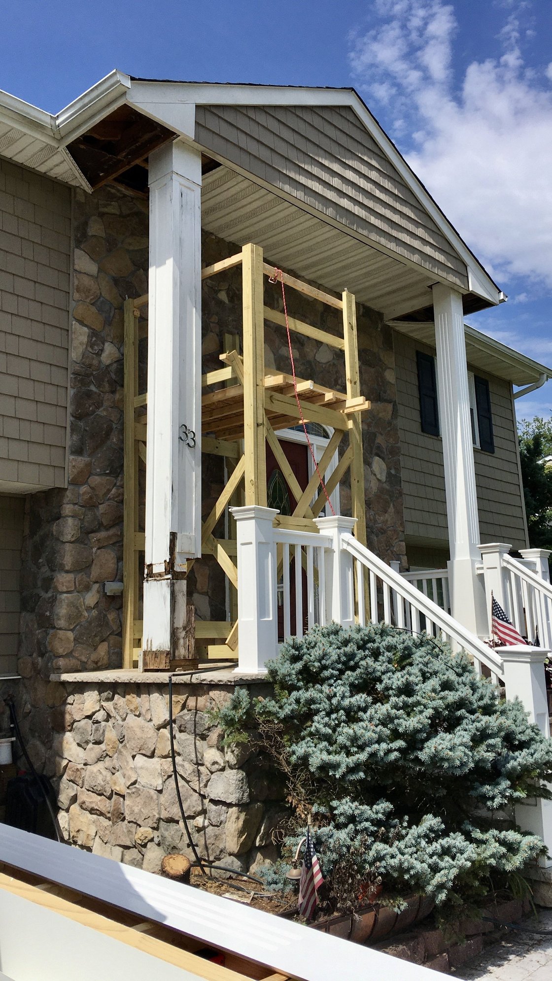

Other than working on the farm and repairing the farmhouse damage from the kids, replacing the front columns in front of our home has been delayed for too long.
The original posts were boxed 1x12 pine. They don't hold up the roof; the roof structure does that. When neighbors had them replaced, the contractors removed them before installing the new columns. I didn't; I lifted the roof slightly with the 4x4 so there would be some load. The originals were never fastened to the concrete. I also removed an existing plant. The second column was already being cut and removed from the bottom up, in 18" sections. Good wood up top nailed well.
While it would be expected to use a 6x6, at least around here, they seem to bow no matter how well you choose. So I boxed with 2x4 and 2x6, positioning the boards so any bow was opposing, and clamping to align everything. The pressure-treated boards were stickered to dry for three weeks before the installation to get the moisture down to under 10%. They were rotated every day.
I used a come-a-long and straps to hoist them up by myself.
I used a Simpson composite lift plate to keep the boards off the concrete. Boards screwed and nailed with 3 1/2" stainless ring shank. Since it's a box, I vented at the top and bottom. The lower PVC trim boards will be drilled for the vent screen. 2x4s gapped inward to have a vent channel.

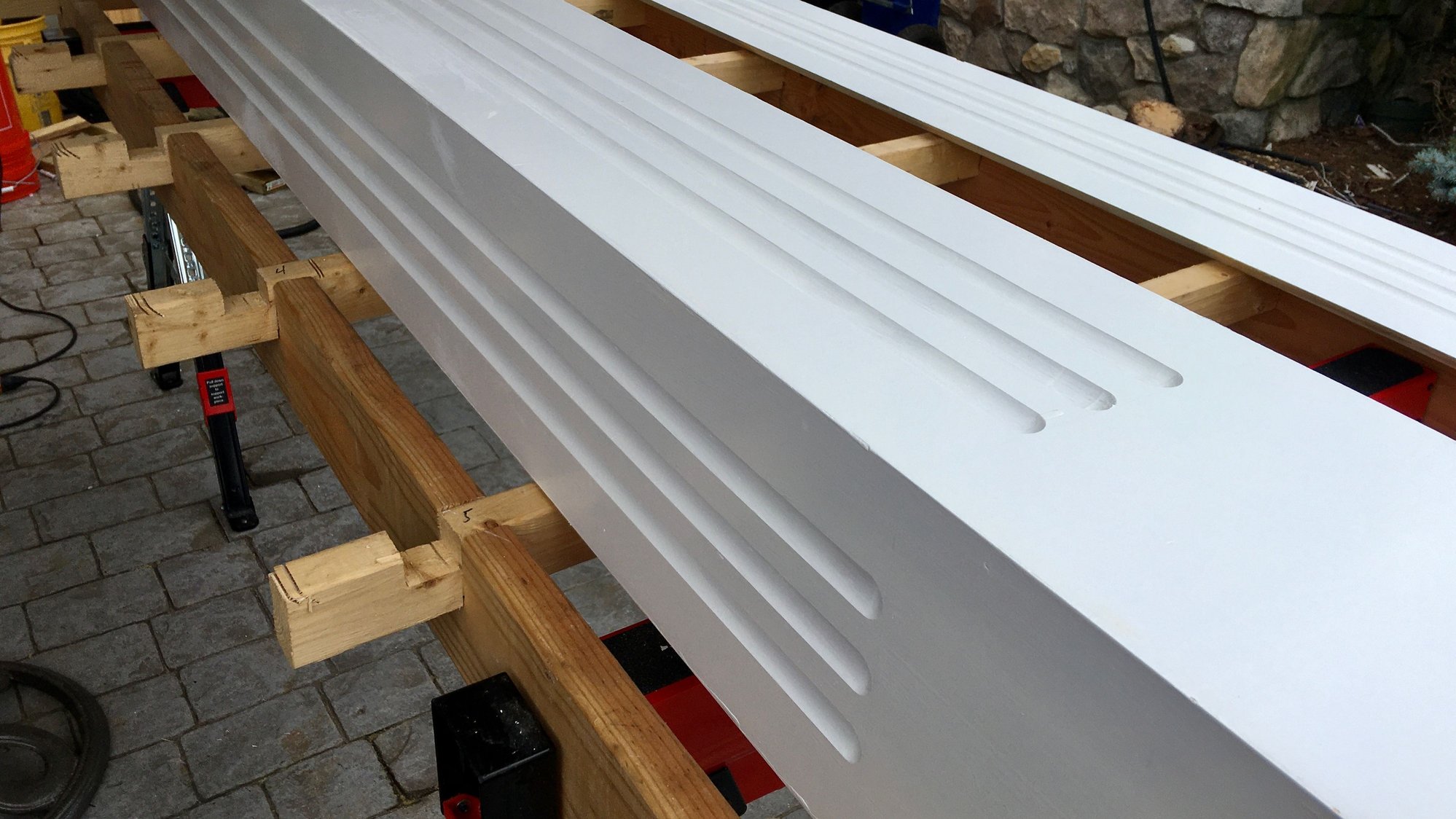

We could not find PVC wraps the size or style we wanted to match the stairs I made years ago, so I used FJ pine, mitered, glued, and routed flutes. I could have made them from Azek, but I'd be in tears if I screwed them up during routing. And there's the microplastic...
These wraps are staying well up from the concrete. Everything down below will be PCV. There is also a venting gap between the actual posts and the wrap. Blocks are there to hold during the installation, but I will put other blocking there later. The wrap is tied to the post at the top and bottom, so if the PT post warps, it should not affect the wrap.
Still have work to do....

Prime those puppies with Kilz Premium 3. It is literally waterproof.

They were primed, did the Kilz 3 inside and out, and had the first topcoat before they went up. Glued with Titebond III. They'll get another topcoat before I'm done.

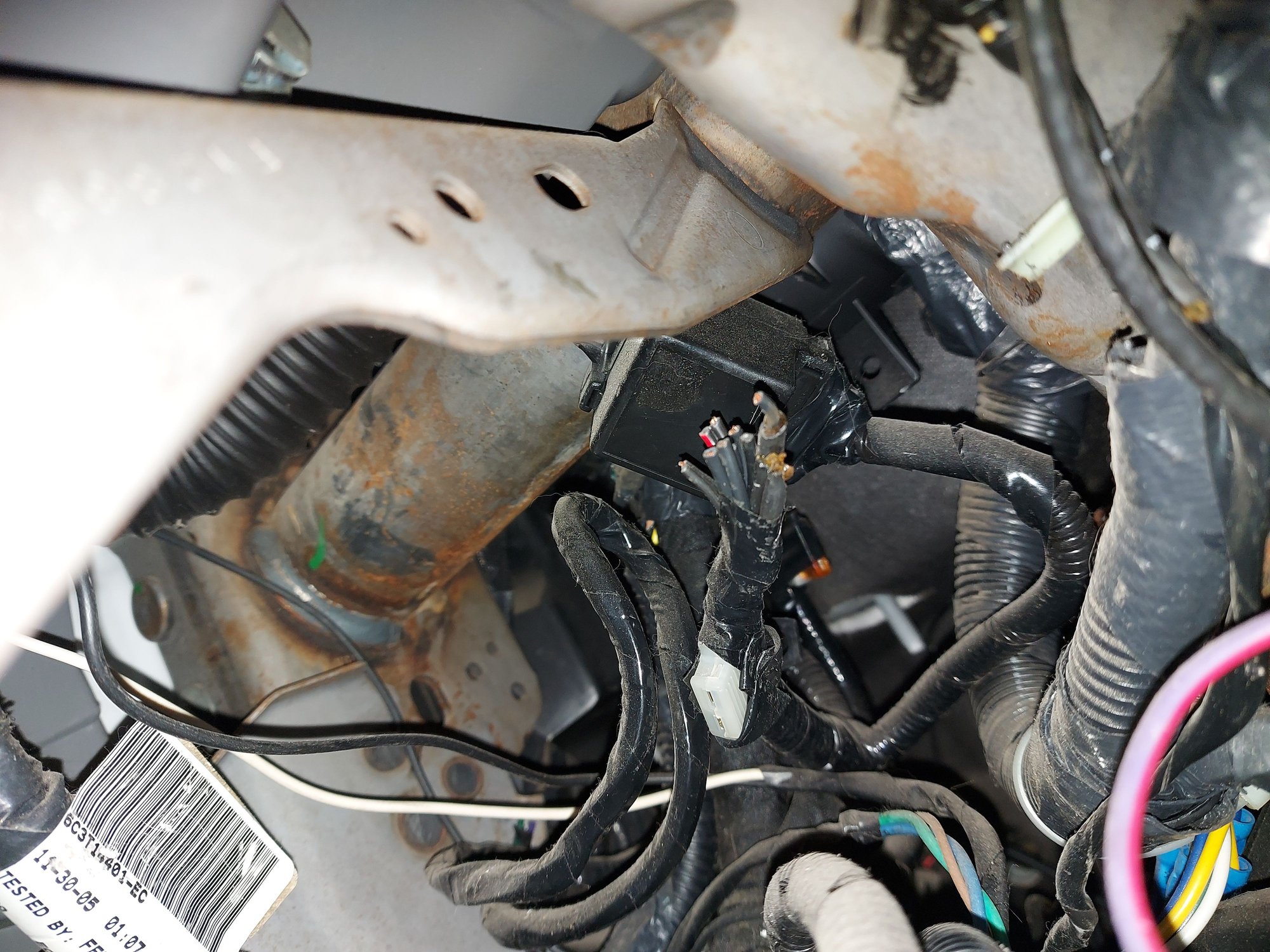

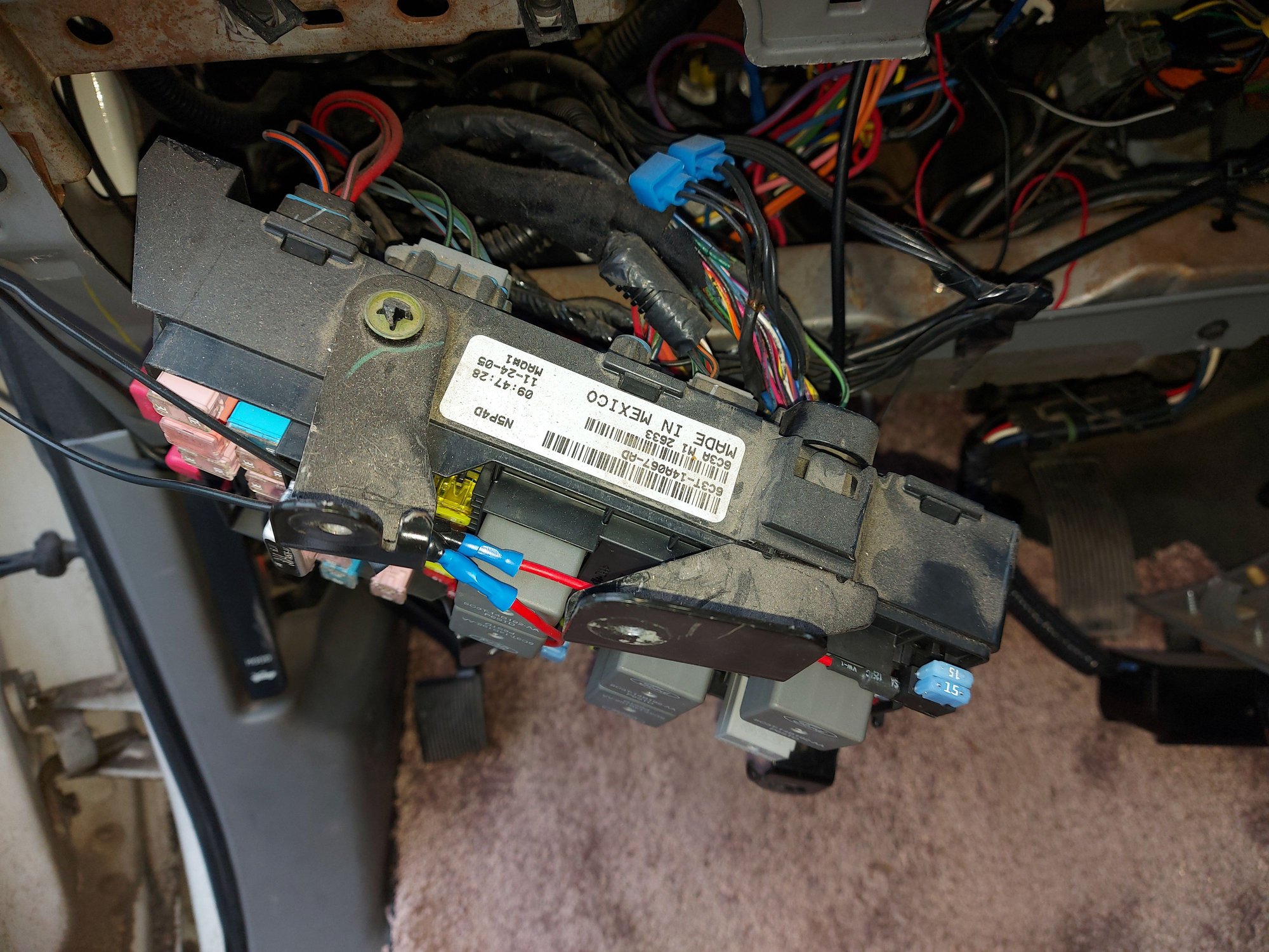

Oh man I feel this lol.

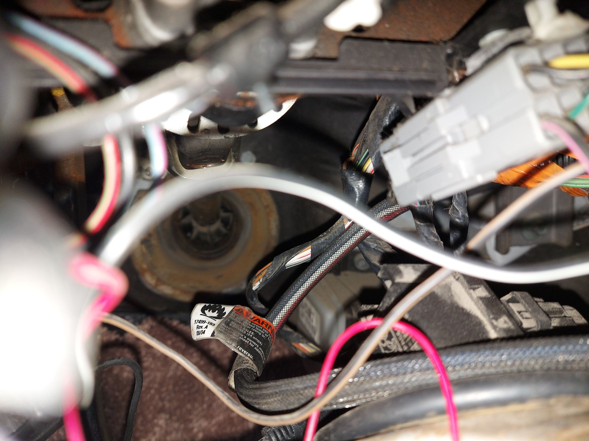

My truck has a remote start that doesn't work and this is the mess I have to clean up one day

A good You Tube watch is South Main Auto https://www.youtube.com/@SouthMainAuto
Eric is constantly complaining about the hack install jobs and problems remote start systems cause.

Yeah I think I'm just going to figure out how to do the high idle mod and leave everything else be for now as this spring I'm planning on putting on a rust free cab from.down south so I'll just buy one without a rats nest of electrical and not have to deal with my current situation lol.

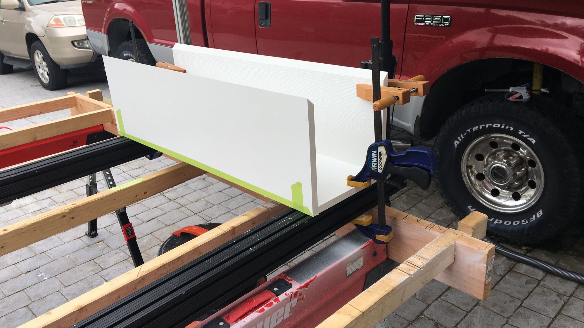

Making the lower PVC box section today.

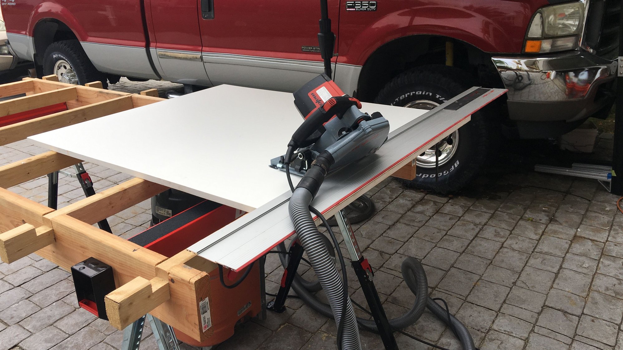

Table saw, dude... table saw.

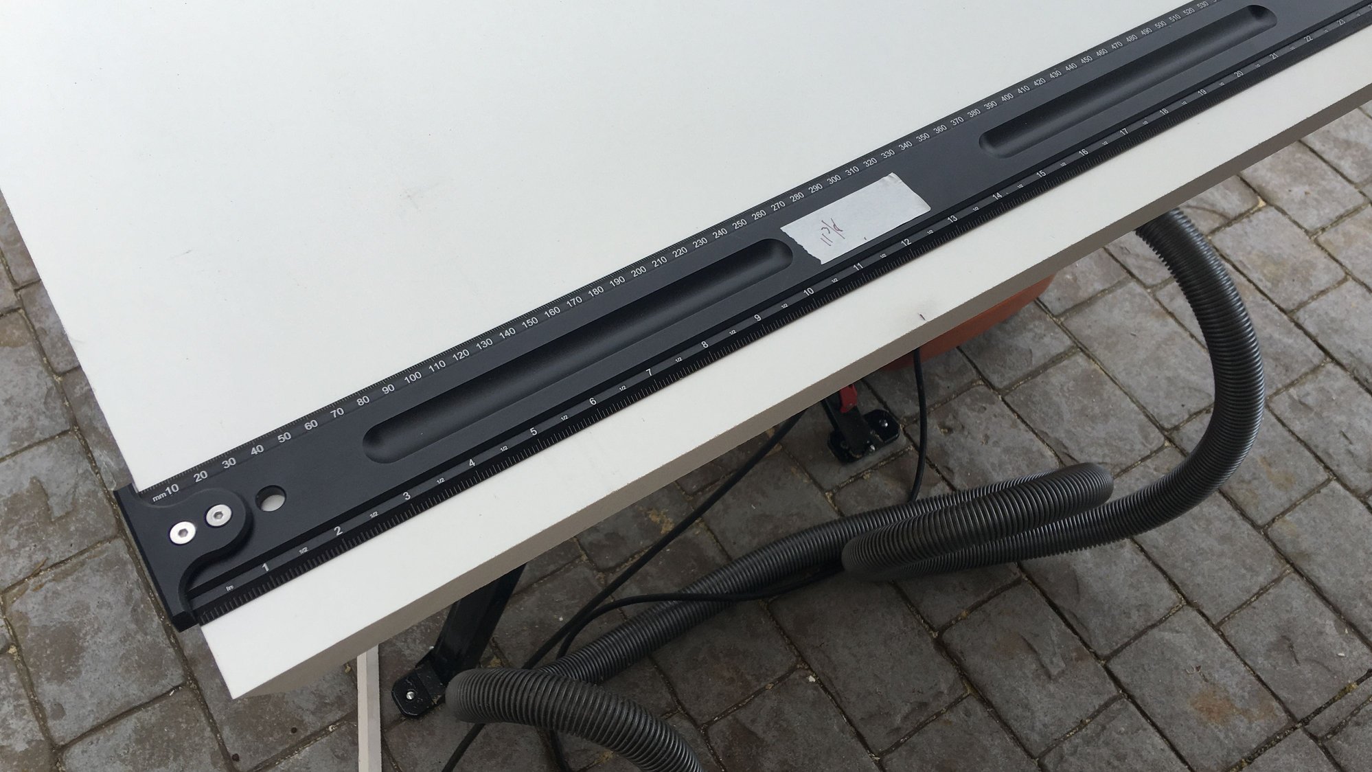

I have a smaller portable from decades ago but hardly use it. I've been using track saws for over two decades, building cabinets and everything else, using the tracks with saws and routers.
Have you ever used a track saw?

Track saw seems extremely accurate. I’ve never used one, though I’ve used various guides.

Nice work table, great idea.
