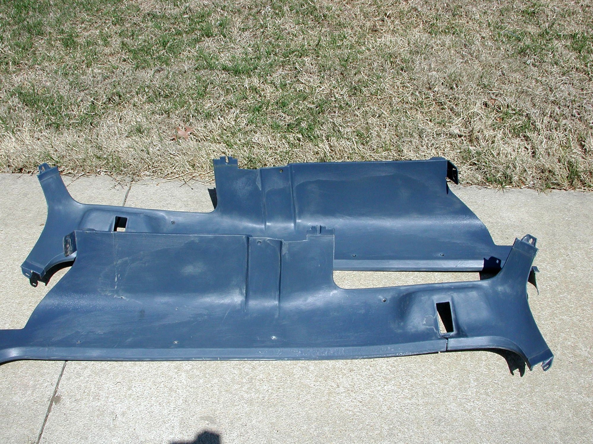

Didn't get much done today, but still got some things done. First, I got the corner trim pieces cleaned up. They are pretty, but they are far better than they were a few days ago - see below.
Second, I reinstalled those trim pieces as well as the others I had to take off to get the headliner out - except for the dash pad. I'm leaving that off until I check out the HVAC system because it doesn't seem to go into all of the modes, and it may be easier to see what happens with the pad off.
And, here are the trim panels:

Wow!
That is a pretty amazing transformation.

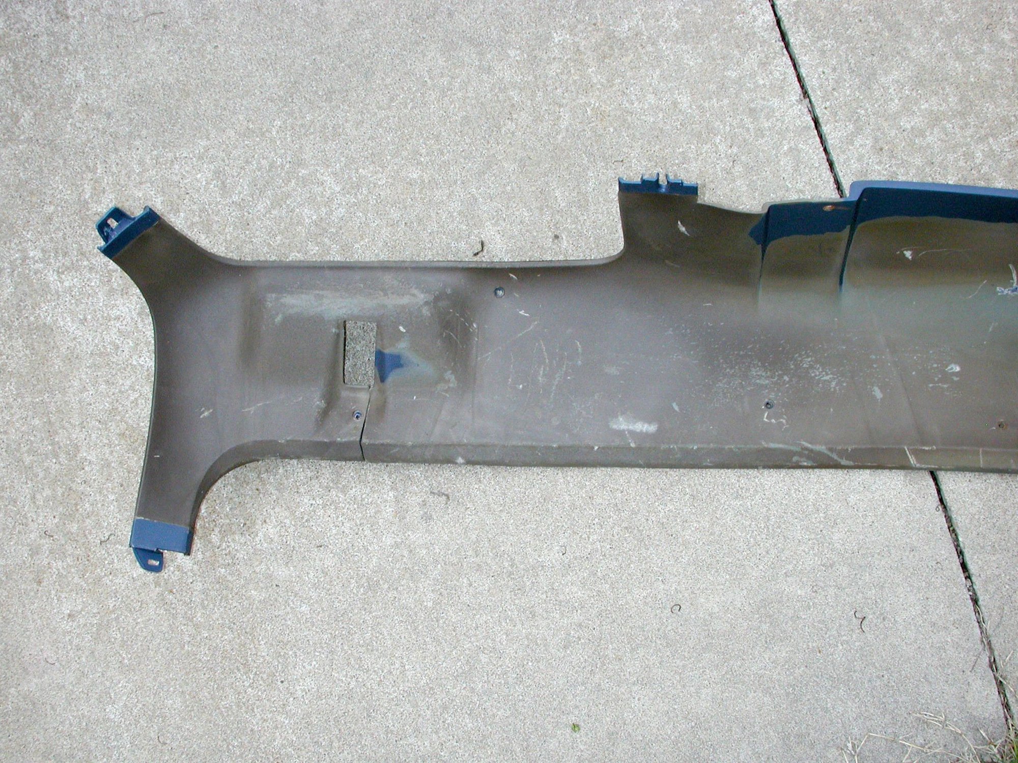

Thanks! And since the "before" was on a previous page, here it is again. All done by mechanically removing the dead plastic. In other words, I sanded the goodie out, or off, of them. And that took quite a bit of 80-grit paper because it loaded up instantly if it wasn't sanded wet. But the cheap Chinese paper I had fell apart when it got damp. Finally I found some good American sand paper and a 1/4-sheet strip of that did both trim pieces.

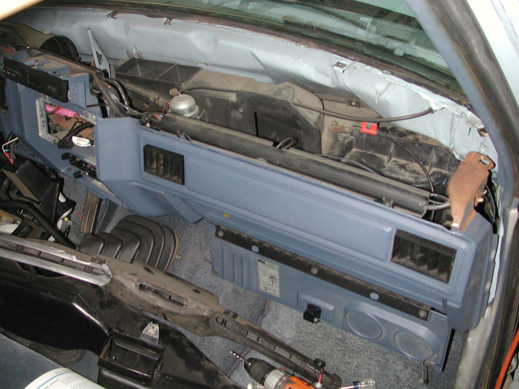

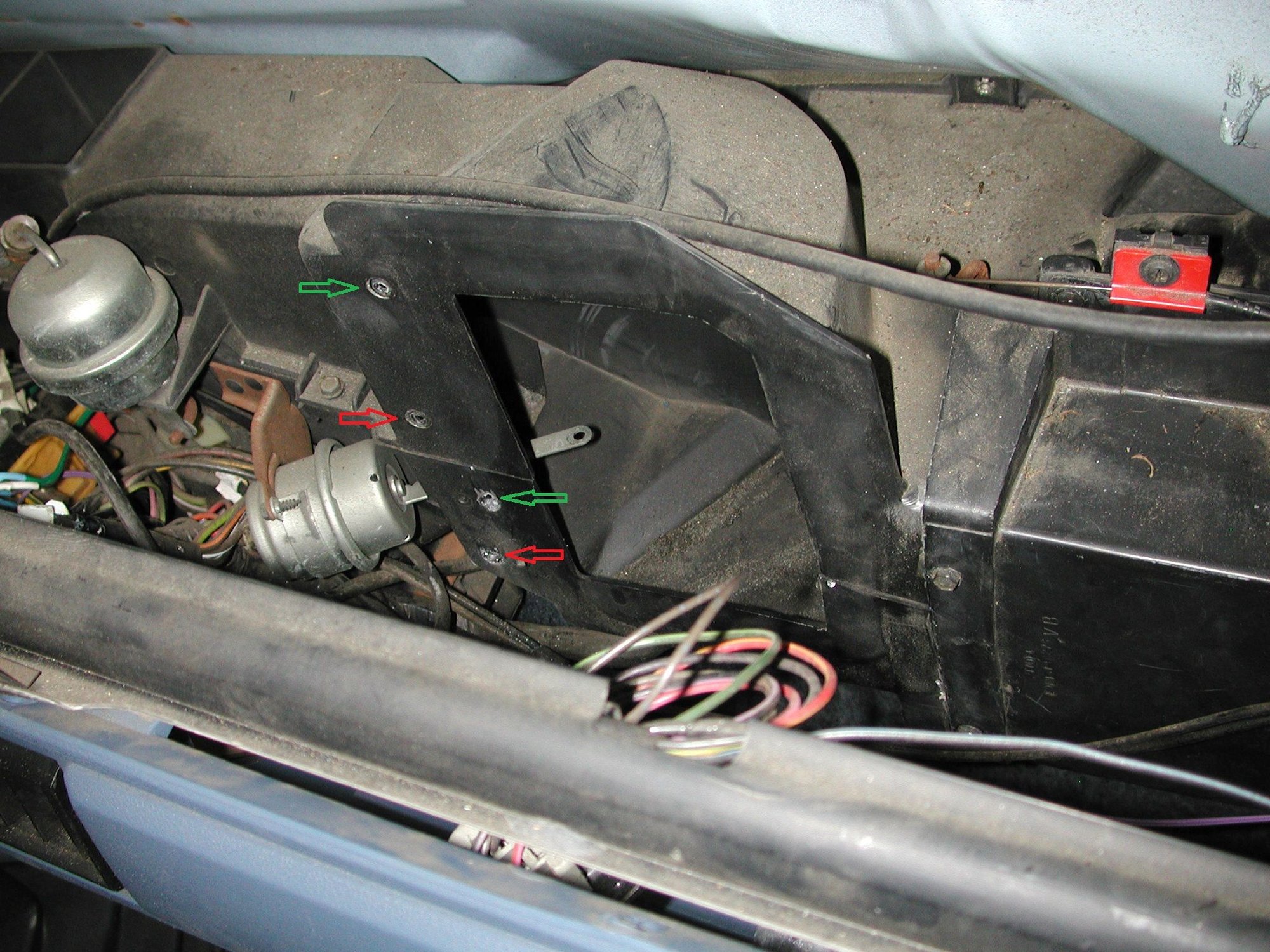

Today's plan was to discover which vacuum motor in the HVAC system was bad as it wasn't working correctly. So I turned the blower on Low to see where the air was going to come out - and nothing happened. I continued to turn the switch up a notch and nothing happened until I got to High, and then there was an awful shrieking sound. I quickly turned it off and pulled the blower motor - essentially frozen. So I lubricated it and it started spinning nicely. And, as I was re-installing it I found the connector to the resistor pack unplugged. I put it back on, went up to the attic and found a spare "hose" that goes from the motor to the housing and installed it. Sure enough, the blower motor now works perfectly and operates on all speeds.
But, with air flow I quickly found that you get air out of the vents or the vents. No defrost nor floor. And yet the vacuum motor to the panel door was moving perfectly. Hmmm, all that can mean is the hinge is broken on the panel door.
And, after removing 12,357 screws and most of the duct work I had proof.
That door goes here. The top two arrows point to where screws hold it in, and the bottom two point to the remnants of rivets that held it in. The plan is to use two small hinges, with the top hole of the top hinge attaching via the top green arrow, and the top hole of the bottom one attaching via the other green arrow. And holes will be drilled for the other hole on each hinge. But, I'll 'splain all that in excruciating detail when I do that.
And here's what all had to come off to get to that:

Question for y'all: I'm planning to put the door back in without any foam on it. Apparently from the factory it had foam on both sides, but that is as gone as the foam on the headliner. And I haven't found anything that I think will work, so I think I'll put it back without. Anyone see any problems?
Old Mar 30, 2017 | 05:39 AM
  #645
WhatsAChevy?'s Avatar
WhatsAChevy?
Joined: Jul 2015
Posts: 2,239
From: Northeast Ohio USA
NAPA carries an all metal replacement door for the 90's Explorers and Rangers. I wonder how much if any size difference there is...hmm.
