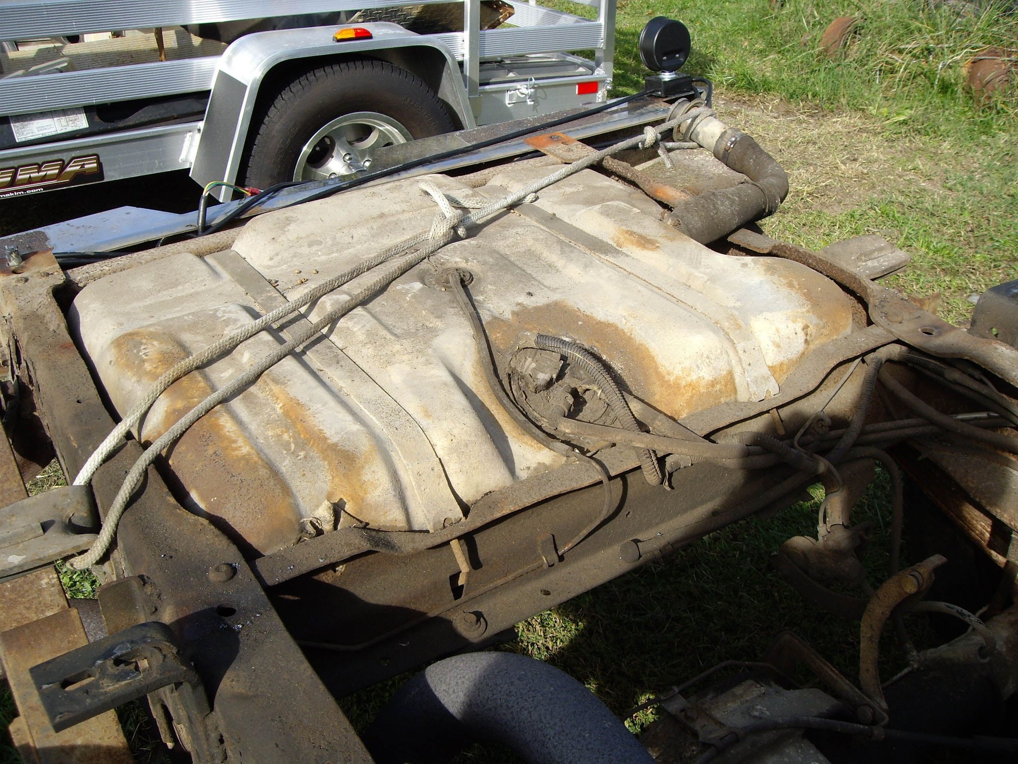

Bill - I'm in absolutely no hurry as I don't have an immediate use for them. And, here's a view of the tank:

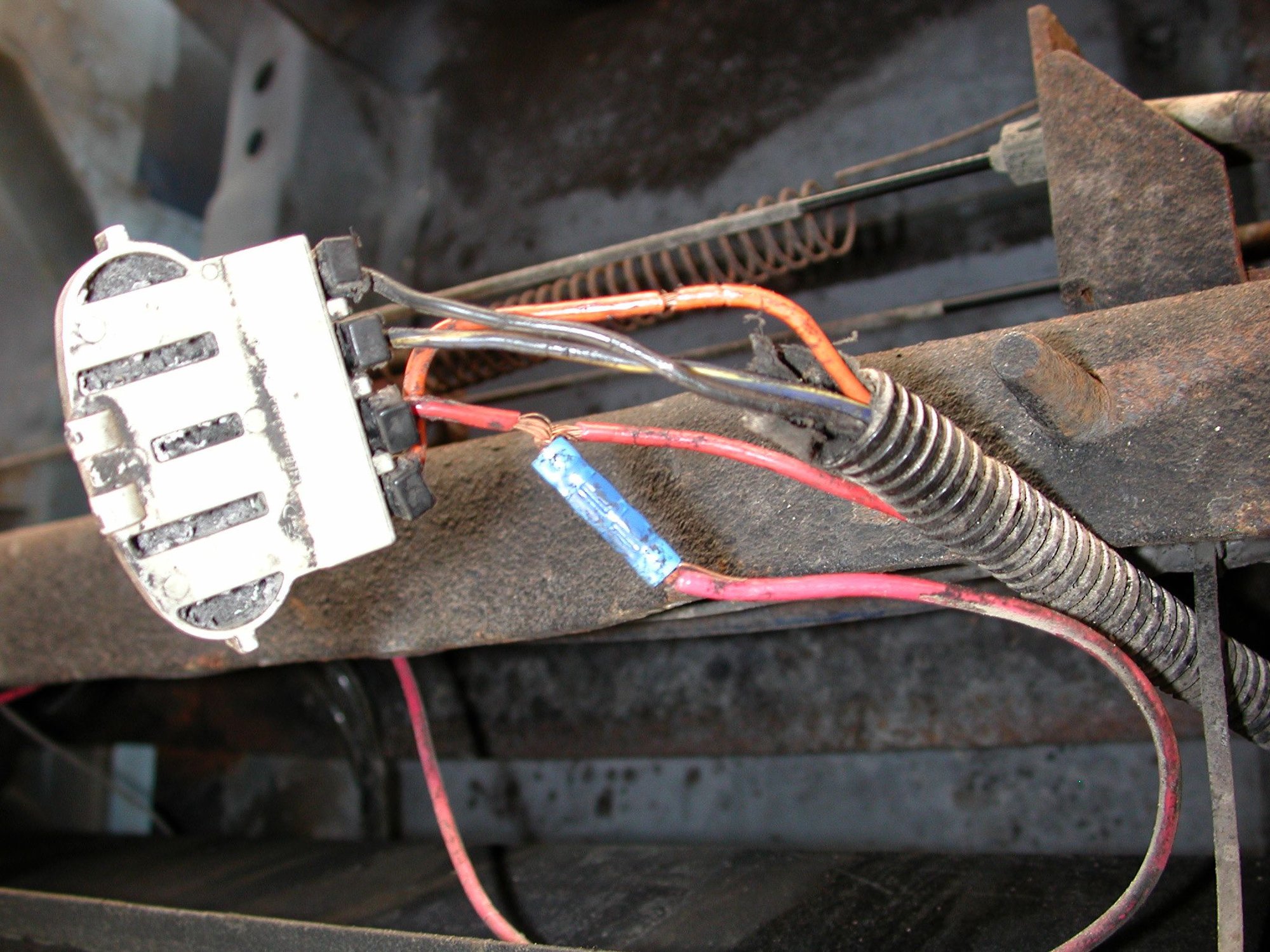

The Good: Turns out that by disconnecting the hacked-on wiring from the inertia switch and bypassing the inertia switch and the oil pressure switch the fuel pump runs. So, my plans to fix the wiring while waiting on the red/yellow wire to come in are good. In other words, I just have to fix the abominations shown above and I'll be ready to run the wire when it comes in.

Gary,
In your second pic, it looks like the sender wire could use a little tlc as well.
(I sometimes wish they would ban those cheesy crimp connectors, but then I'd expect to see even more household wire nuts on these trucks )

Jim, red is front pump power, orange is ground. Rear tank pump power is brown/white, orange is still ground. Dark blue/yellow is front sender, black is ground, rear, yellow/light blue is sender, black is ground. All for grounds tie together and go through the plug to G701 which is the one inside the cab on 1986 models.
He has the cure for all that, he just has to shorten the section between the transmission cross member and front tank 35", it is the original harness from Darth.

I think the tank is fairly new, so while I may have to drop it to change out the sender, I don't think it needs coated. As was pointed out, dropping it with the lift is easy - just lower the truck down until the tank sits on the roll-around toolbox, disconnect the tank, and raise the truck.
And, it may well have a serious pump in it. When running a full 12 volts it has enough volume to easily hold 5.5 psi at the regulator after the vapor separator. In fact, I jumpered the inertia switch with my test light made from an 1156 bulb and that ran the pump well enough to hold 1.5 psi after the vapor separator. Maybe I'll crank it up tomorrow and see what it'll do.
As for the wiring, Jim is right that things need attention. But, Bill sent me a replacement harness, so I'll put that in and not have to worry about splicing things. Thanks again, Bill!
