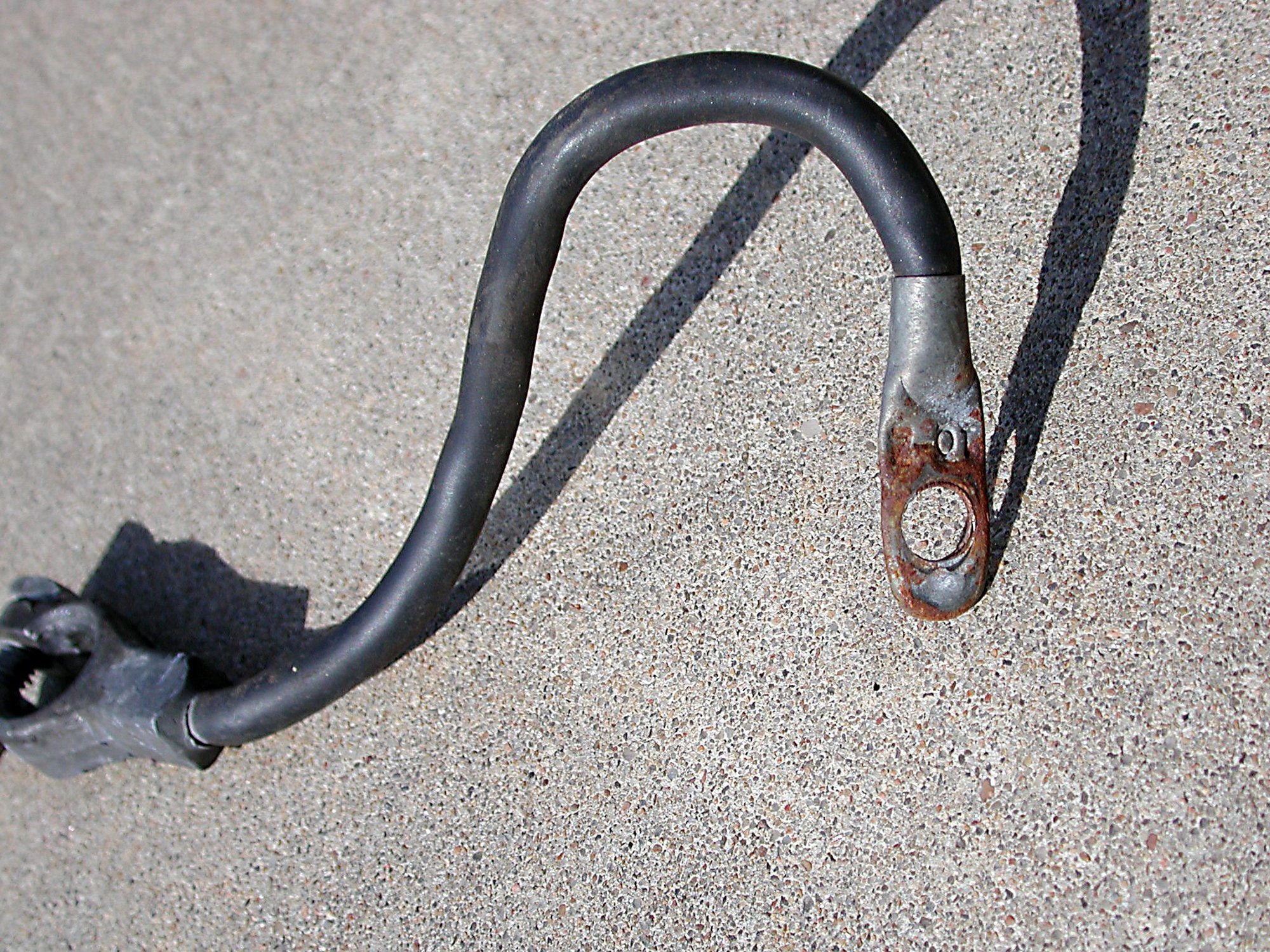

Now for the update: Two more layers peeled. Replaced the starter relay/solenoid and found both poor connections (see below) and bad grounds. So, I cleaned all of the connections including the battery posts, replaced the solenoid, and coated all connections with aluminum anti-seize.
And, while I was "in the neighborhood" I checked the regulator. Bad grounds, not poor grounds. So, I cleaned those as well and treated them to anti-seize.
It starts well now, so we are taking it on an outing this afternoon. Just exploring the Okiehoma countryside in Spring.
