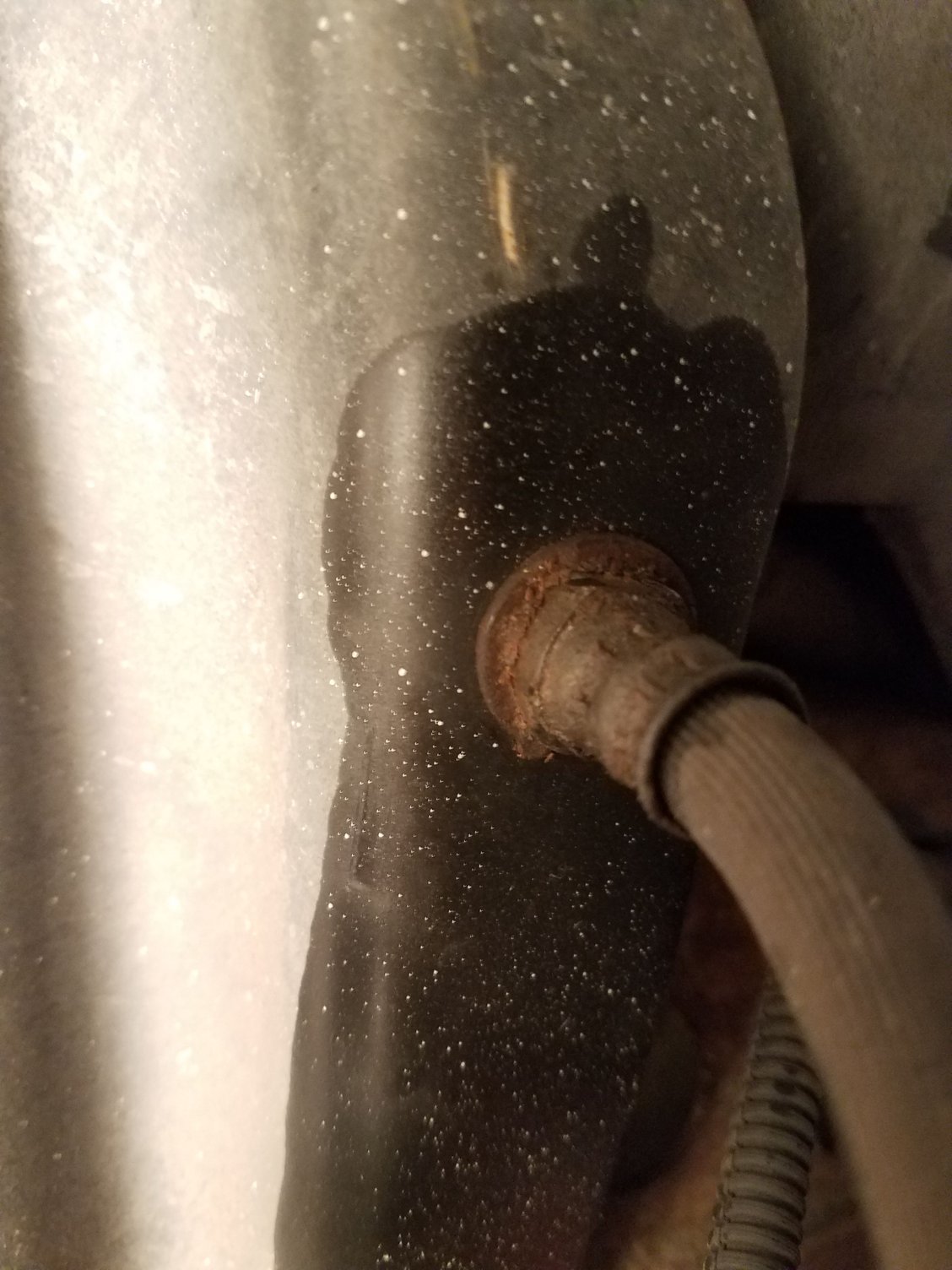

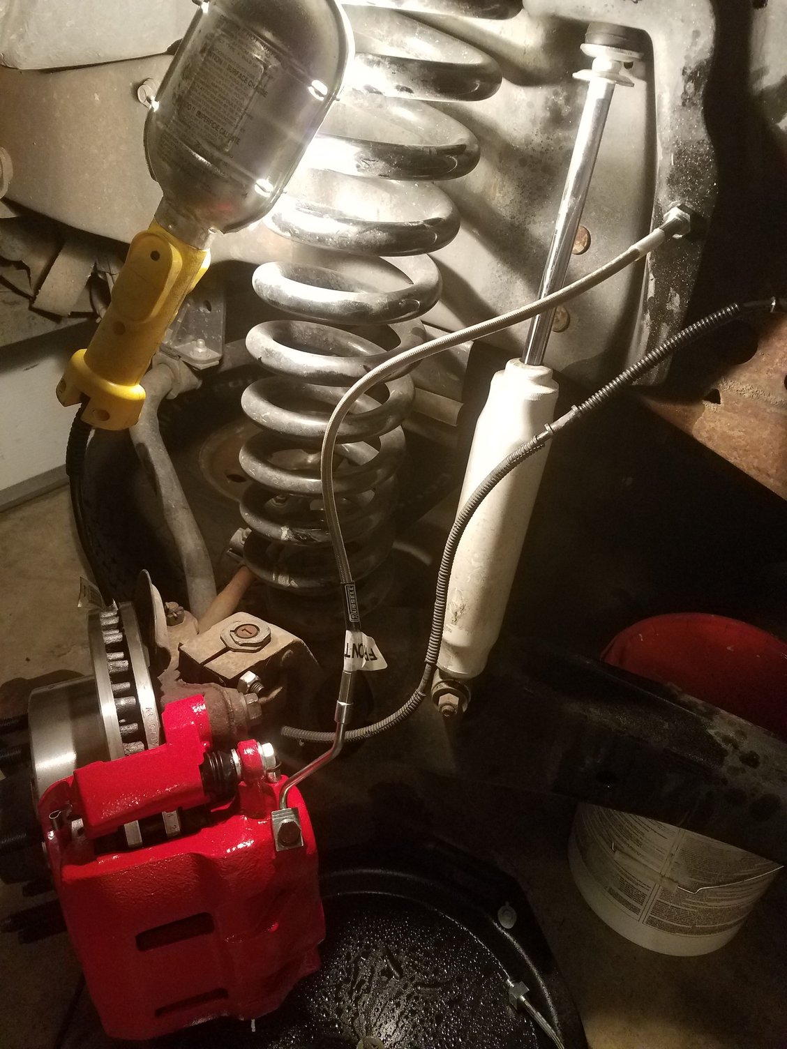

@Bently - good news! That nut is just part of the hose to get a grip while tightening from the nut in the back, a detail i overlooked because I'm a noob. I didn't realize you undo the line in the back and it just slides out, then the bracket clip pops right off and the hose pulls right out. Check out my recent comments over in the What'd Ya Do Today excursion thread. I had a riddle to solve with the front hose labels on the Russell lines... think i figured it out.
i just use wd40 cuz it's what i have. Not very much, things have been coming apart fairly ok, I've used my floor jack handle a few times when my 3foot breaker bar or air wrench can't fit.
turbo has the special bleeder tool so I'll keep going on the other three brakes in the morning and whenever I'm done he'll come over and bleed my system.
I'm turning this ship around, slowly but surely!
Yes, i put zip ties in the two hoses after this pic

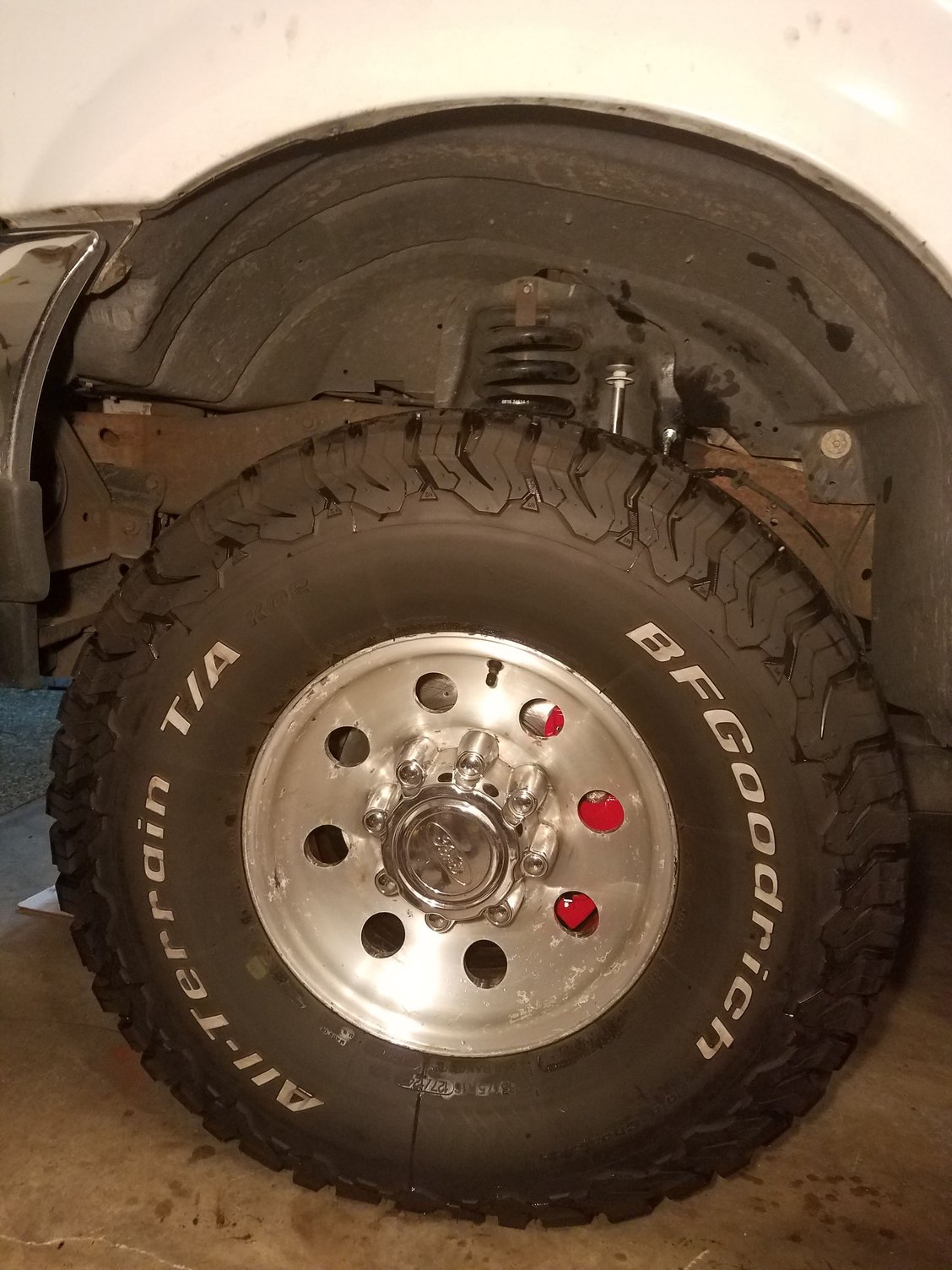

All put back together and torqued! Even cleaned up the ol rims as best i could at 1215am lol

You must have been in the zone burning the midnight oil. Next time your at the hardware store at least grab some PB blaster. It's much better for rust compared to WD40.

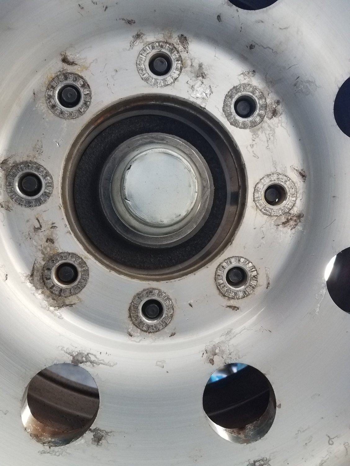

Got the driver rear and passenger front done. As if i need more things to go wrong, one of the wheel studs on the new front powerstop rotor seems a bit cockeyed and i cant get my wheel on. Not really sure what to do now.

Welp, got me a handful of washers and a big 1/2" drive flex ratchet. Let's see if that stud will straighten out.

If the washers don't work, try a propane torch to heat it up, then use a pipe to bend it.

Air tools for the win

Now the question is can you get it off and back on at the side of the road.
