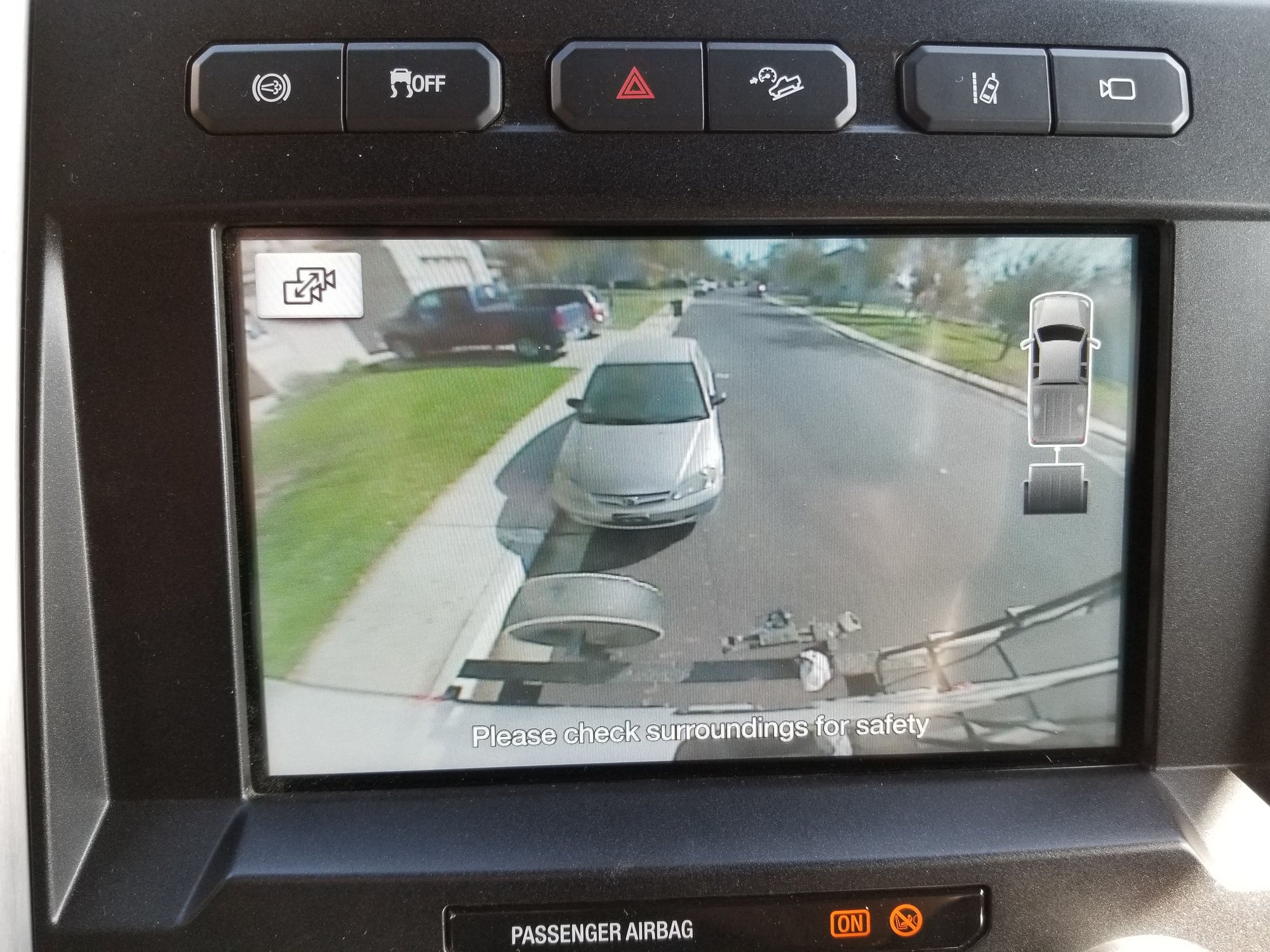

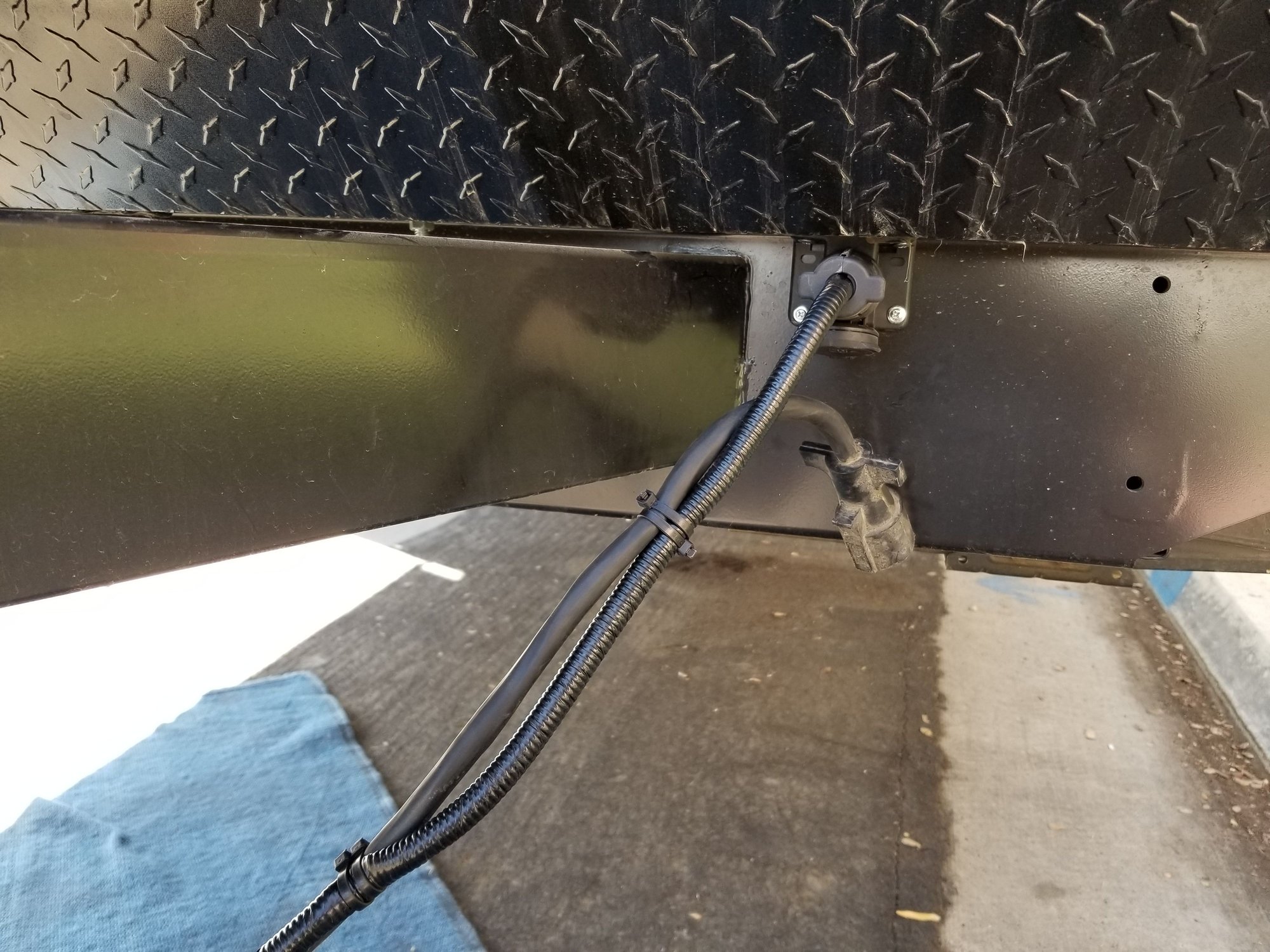

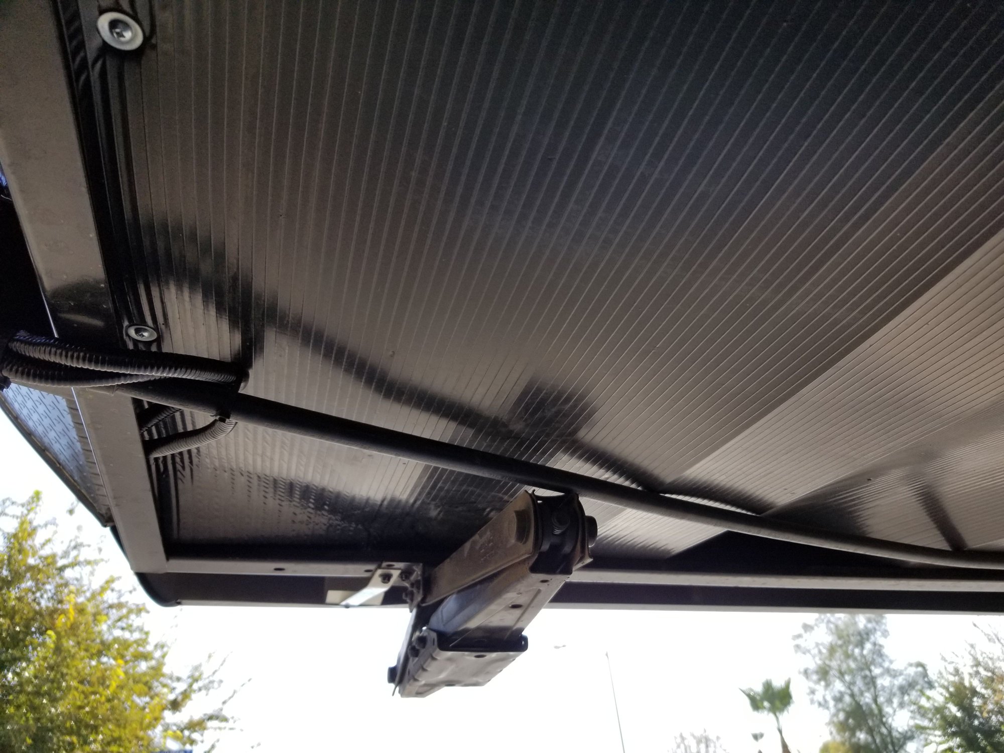

installed today. Took about an hour, maybe 1 1/2 hrs. I put the extra wire under the insulation, coiled up & zip tied. Feel free to ask questions ofnyou have any. I haven't installed psi sensors in tires yet. Waiting for rtv to dry. Camera is about 7 ft off the ground.
BAM! Worked good!
Zip tied camer and trailer cables together..
Used some self tspping screws to attach dock for camere input
Found a spot up front for extra cable
Tucked inside of insulation
Tucked into the frame, zip tied to propane line in a fee spots

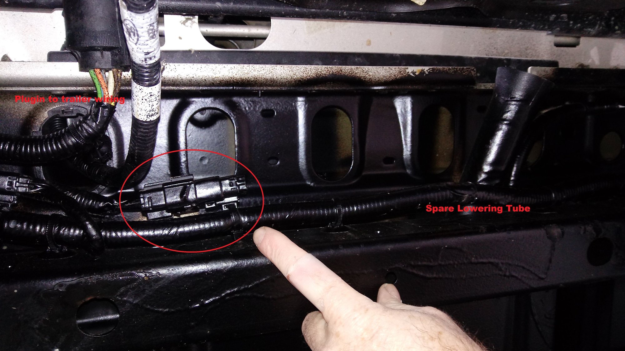

I just hooked up my TPMS camera. The first time I did it, I connected to the wrong connector. If you use the wrong connector, it doesn't 'fee' right. You are leaving a female connector to bare the elements, and it is the wrong connector.
To verify you have the right connector, your camera will work, even if you do not have the trailer hooked up. Your tailgate release will also still work. On my first attempt, connected incorrectly, the tailgate would not release. The correct connector is connected to a plug cover.
Here are a few pictures of the correct connector, in the truck. My spare tire was lowered to make it MUCH easier. You should know how to lower the spare anyway. My truck was sprayed with an underbody coating.
I am going to use the in-bed box hookup, as I want to still use my 4-pin hookup without an adapter (that I may lose or forget where I put it). The only time I need it is when I have a fifth wheel, so why mess up the bumper connector?
