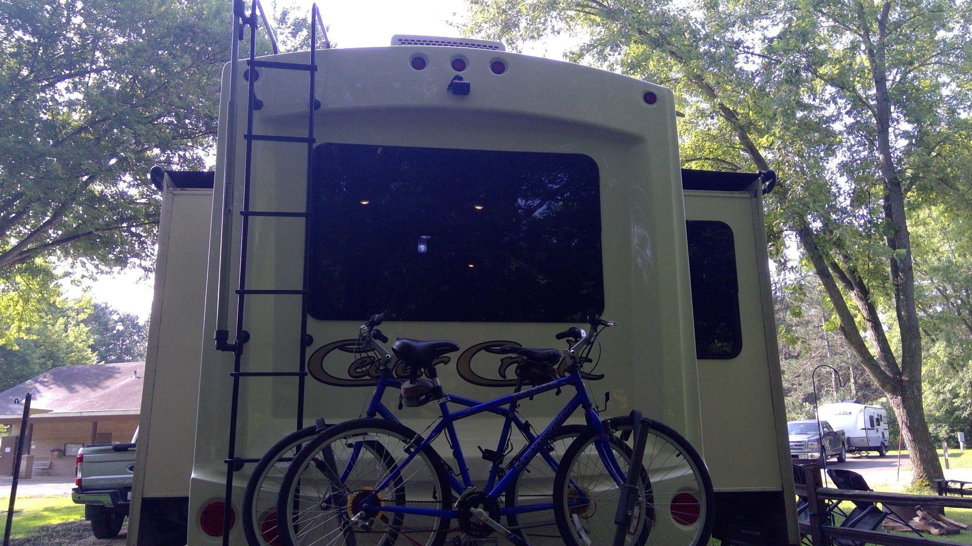

I am still working on fishing wire through front compartment to pinbox. It would be easier if I could figure out how to disassemble the connectors.
It took me about ten minutes. Remove any screws holding the fiberglass. Get a piece of flat bar (I used 1 1/2" aluminum) and slide it between the framing and the fiberglass. Twist the bar so it is vertical which will create a pocket. I slid two pieces of wire along the flat bar until they popped out at the pin box. Wrapped one around each connector and pulled them through. It took a little finagling, but not much. I was prepared for a struggle but it never materialized.
It took me awhile to figure out that there was no clearance for the plug because of the framing of the frame used on the cedar creek's. I was able to do a workaround that only exposes 20% of the wiring to the outside. While in arizona I bought the larger valve seems then went to discount tire and had them installed. They let me know that they could not inflate to 110 because their compressor only pumps to 80. Pitiful my compressor at home does 125. On trip back to texas and all systems work great!!
I had to drill a hole before the crossframe then bring the harness outside then drill another hole to miss the second cross frame. Camera and tpms sensors work great.
