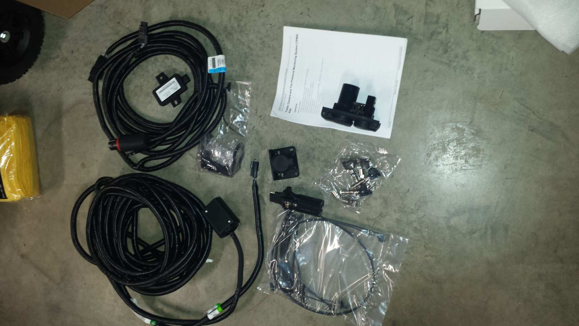

I got all this with my truck. Dealer told me to come back and they would install it for me. I told him that I would wait until I got a new trailer. When ever that will be I don't know still looking.

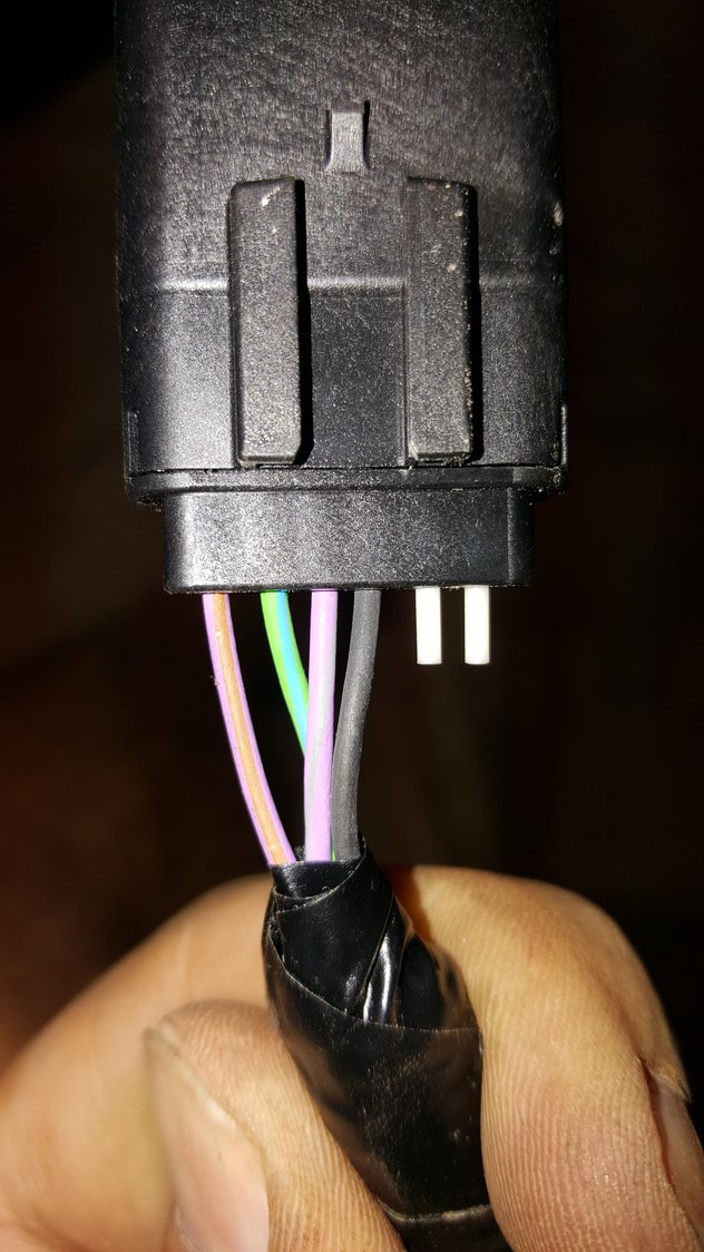

Originally Posted by gascan
Any information on the pinouts for the video camera?
I am not sure where they go but the camera has 4 wires to it. You can see the color coding from the pic.
Old Oct 26, 2016 | 02:10 PM
  #66
brdcrtr's Avatar
brdcrtr
Joined: Aug 2016
Posts: 22
They are probably power, video and two grounds. My 2017 will be my first truck with a trailer camera but I can't imagine them being any different than an analog security camera.
Old Oct 26, 2016 | 11:45 PM
  #67
wb6anp's Avatar
wb6anp
Joined: Dec 2004
Posts: 3,541
From: Weatherford Texas.
Why 2 grounds
Old Oct 27, 2016 | 05:52 AM
  #68
johndeerefarmer's Avatar
johndeerefarmer
Joined: Feb 2005
Posts: 2,898
Likes: 185
One would be power ground and the other signal ground.

scidlik, if you have an ohm meter see if you have continuity between the two purples, or any of the 4 wires. Also check for continuity between the pins and the frame on the truck side.

Would really like to see some pics before, during and after installation of the truck harness and connectors.
Anybody? Bueller? ...... Bueller?
Old Nov 2, 2016 | 02:10 PM
  #73
scidlik's Avatar
scidlik
Joined: Aug 2016
Posts: 47
From: Eureka, Mo
I don't have any pics handy but switching out the rear plug took no more than 1 minute and no tools. You unplug the existing wiring harness from the back of the plug. push the tabs on each side in and it comes right out. Push the new plug in place until the two side clips snap in place. Plug the light cable back into it. Reach right above the plug for the camera plug, take the cap off and plug it in. May sound like a lot but very easy.
I would love to help but electronics have changed over the years and when you check ohms or continuity you send current through possibly frying out something. A schematic may be a much better solution.
